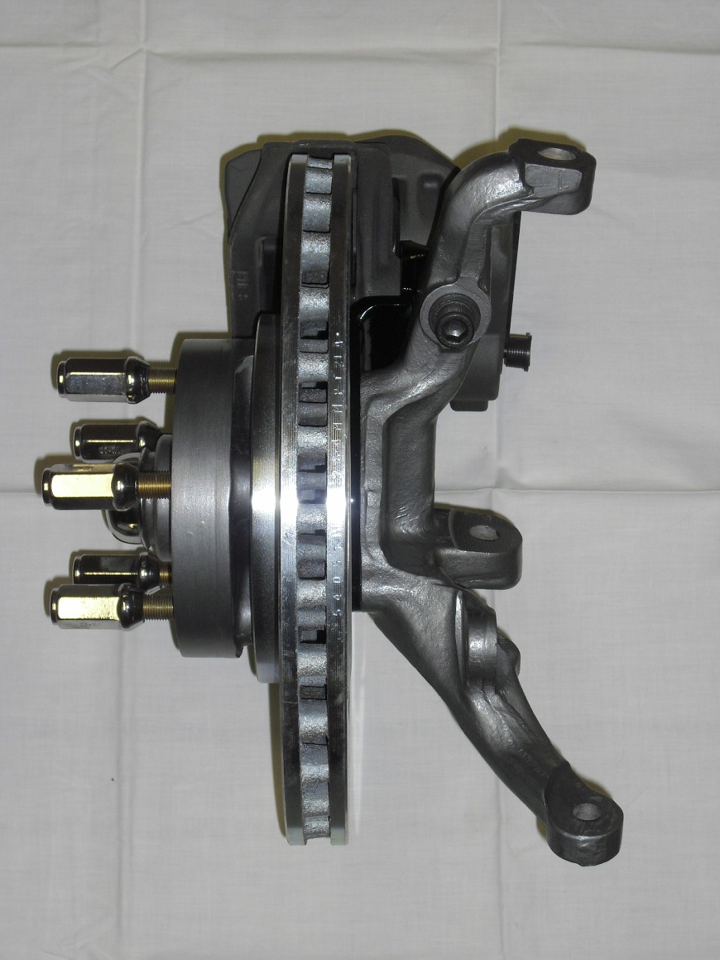

      Brakes are the area where more time will be spent. First off, the single MC will be replaced for one from a dual MC for safeties sake. The MC and combo block from the 83 mustang will do for the time being.
      The front brakes will be mostly SN95 stuff. The drums will come off and I'll slip a set of SN95 13" rotors on there. A little machining will make it work nicely. The SN95 dual piston calipers will also be pressed into service. Once I get the rotors mounted to the hub, I'll spin up a bracket to hold the calipers. I'll source a Mark VII MC to do duty pushing the pistons, or I may look for the same bore mustang MC with the plastic reservoir. Flex lines will just be the Mustang ones and I'll bend up some custom lines.
      I'd like to say I'll be the first, but I ran across a gent in Sweden who's already done it to a mustang spindle:
      Some nice work there. Great thing about it is the OEm spindles are used, which at least keeps the suspension/steering within oem spec (IE: ackermann, bump steer, KIA, etc).
      Rear brakes will be drums for the immediate future, a quick tear down and rehab will hopefully sort them out (only so much money in the pot). Rear discs will follow later on.
      Since I'm working in a single car garage, the car has to remain a roller. SN95 brakes are not going to fit in the OEM 14" rims. I've got a couple extra 300M sets of rims, one is a 17" BBS knock-off style. A little digging shows they have the same 5x4.5 bolt pattern, but a 35-40 MM offset. They'll at least do for some rollers in the garage with a couple cheap spacers. Maybe even work as drivers with good spacers (until I can afford proper rims with the right offset) as long as the scrub radius is good. They actually don't look too bad in a quick photochop I did up:
