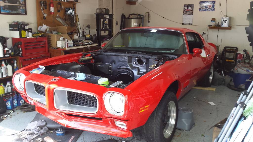

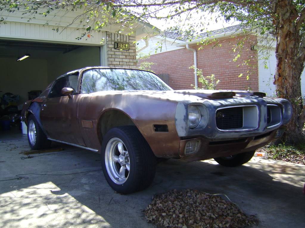

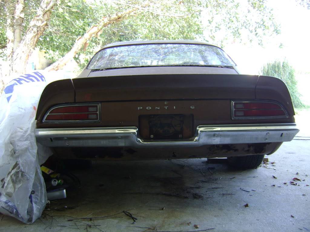

      Hello. I'm Ben. New to this site, but not to cars. I have a 71 Formula with an LS5. 455HO for the non-Pontiac people. Was an original 4 speed car. When I bought it...it was needing a new lease on life and I'm giving it to her. As you'll see in the pics....she's come along way, but she's not done. I'm deployed again, so she's just sitting there. The only things I'm had/having done for me was paint, body, seats recovered, shortblock, trans, and diff. Here's the run down.
      71 Formula
      99 Porsche Guards Red
      455HO
      Short block built by Butler Performance
      Roller cam spec'd by Butler Performance
      Fast EZ EFI
      LT1 T56 built Aston Martin mainshaft, Viper Tail Housing
      Built 10 bolt 3.08's or 3.23's haven't decided
      LS1 front and rear brakes
      Global West Upper and lower control arms, GW front and rear springs 1-1.25'' drop, All Del-a-lum bushings
      Koni adjustables
      Procar seats
      Ram Air Exhaust manifolds, 2.5'' system to chambered mufflers
      And the wheels.......I'm still looking. Lot's to choose from. Size is gonna be 17x9.5s
