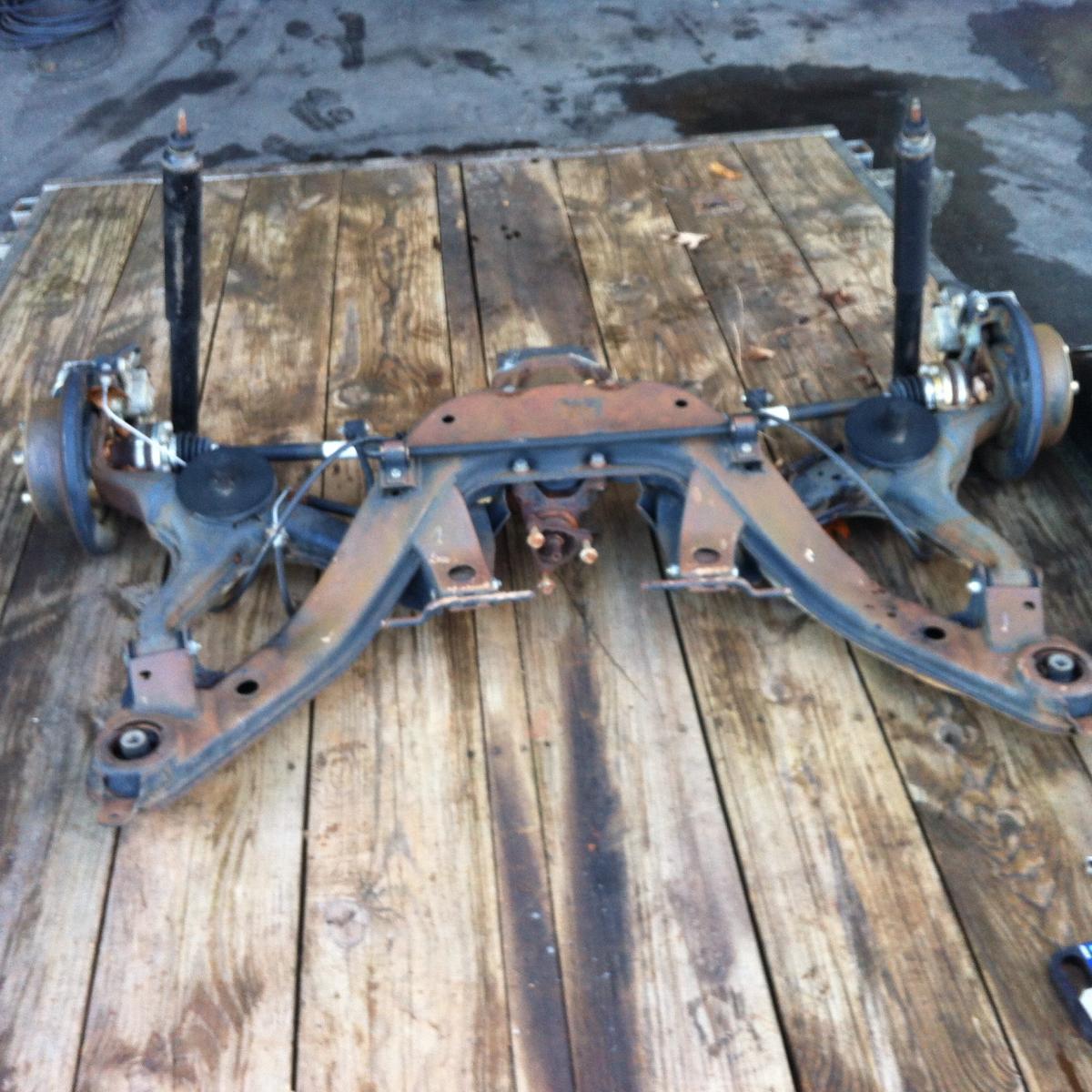

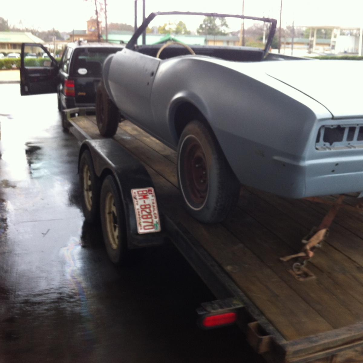

      OK this is day 5, didn't wanna bore you fine folks with rust/floorpan work......today I picked up this......

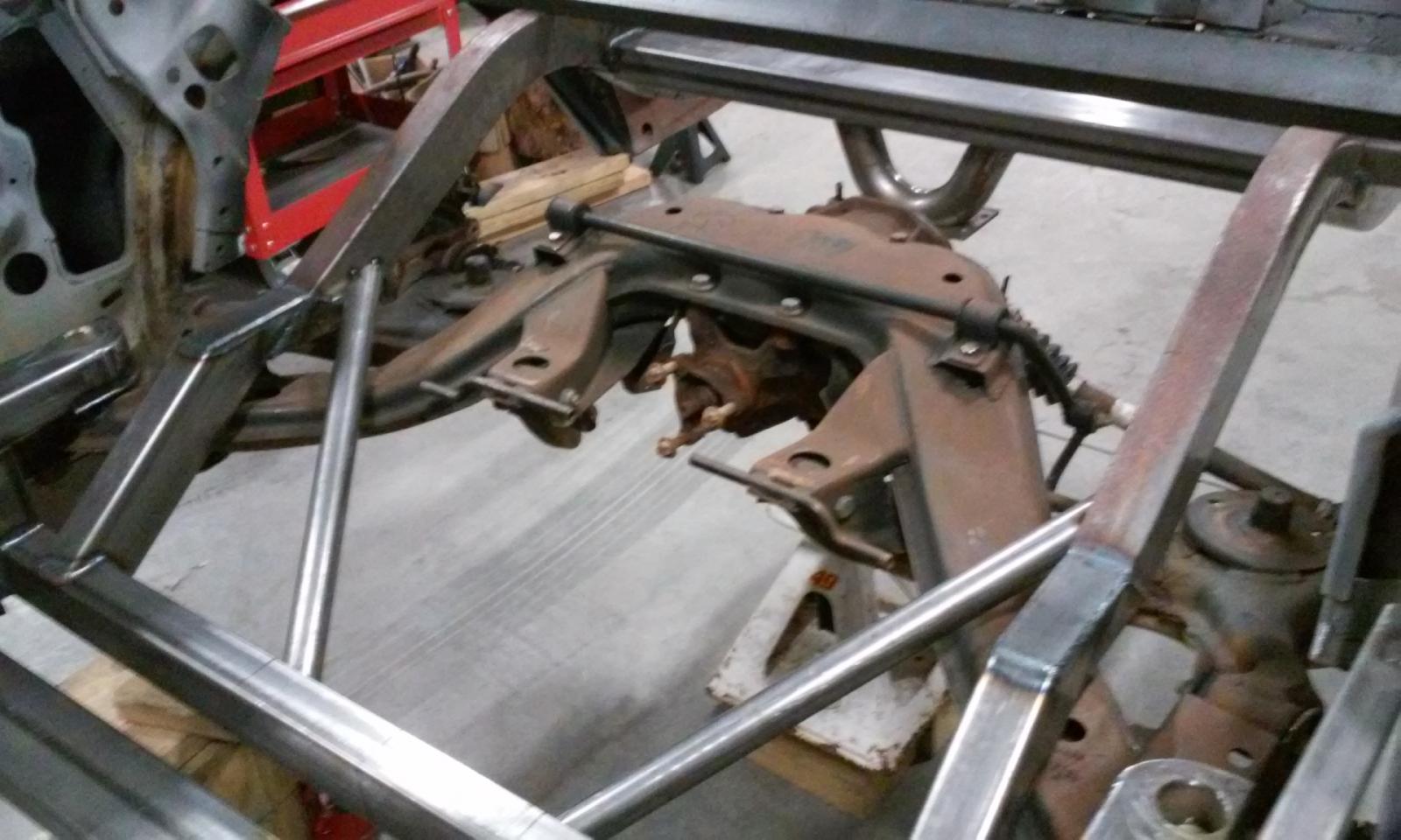

      took it to a friend's fab shop to put in this......

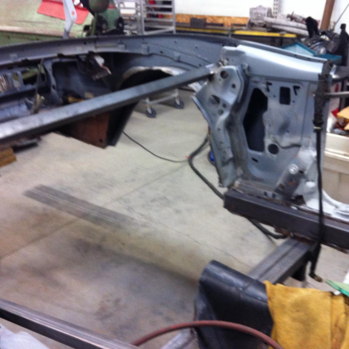

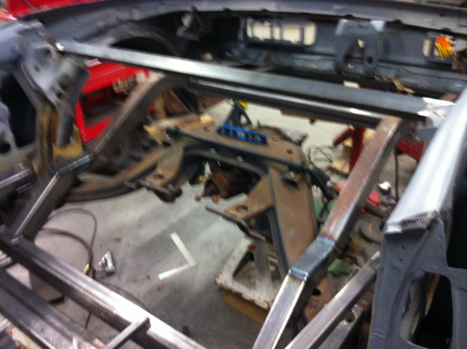

      since the inner rockers were bad, I am gonna weld in some 2x3 tubing then go from there.....
      will keep posting pix as progress continues.....

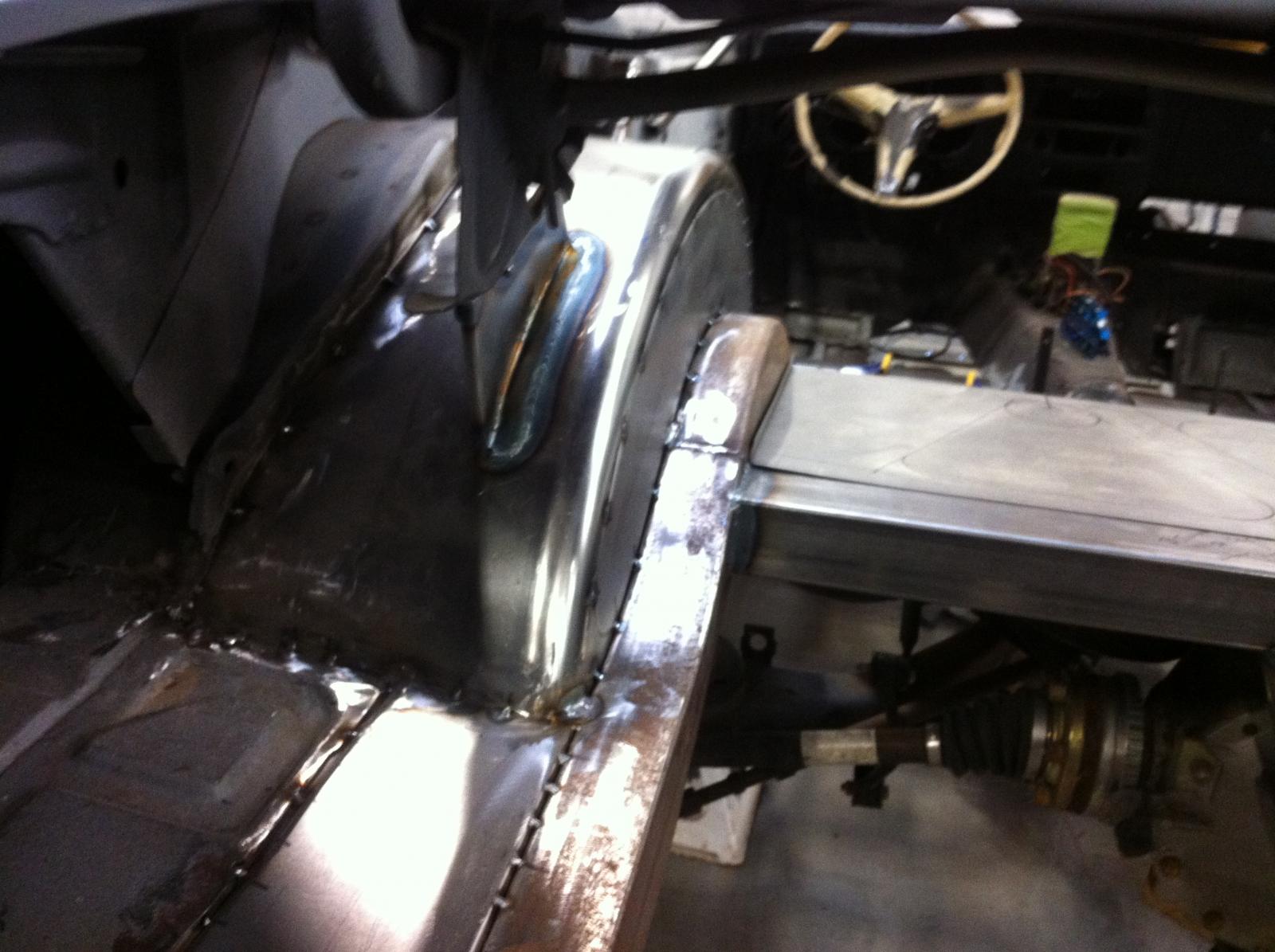

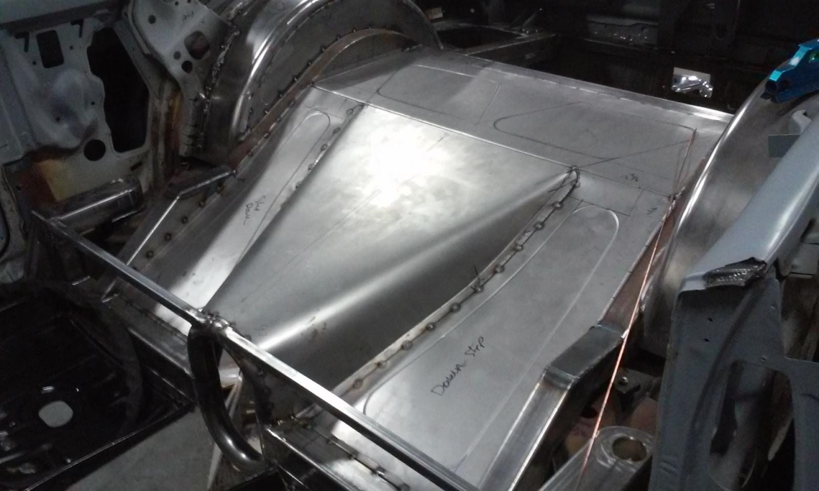

      & yet another 2 days in the shop......doesn't look like much progress, but I had to repair some of my body shops 'repairs'. if I knew then what I know now.....
      anyways, rear tubs installed, some of the zillion panels also made but not yet installed....everything will get welded together to re-create a unit body....Tom will finish Tig'ing the chassis friday methinks.....probably do the rear mount batt box & trunk floor tomorrow......

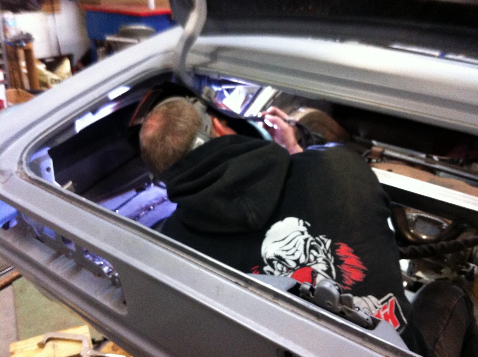

      Tom got the chassis finish welded today, he is a Tig contortionist to say the least.....he also helped me finish out the wheel tubs etc..... I didn't get as far as I wanted this week..nothing new there...

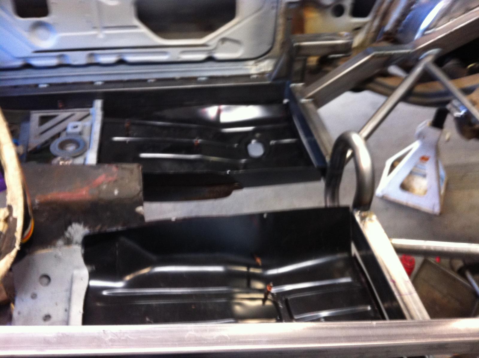

      some d/s hoop fun & putting in oe rear floors.....upper panel reflects some pullmax goofing around.... still looking at 'easy' rear seat cushion options...
      rear floor done.....rear 1/2 oe floor pans welded in....looking at seat bun options for rear sim-u-seat.... gotta bolt in top to assess headroom back there......

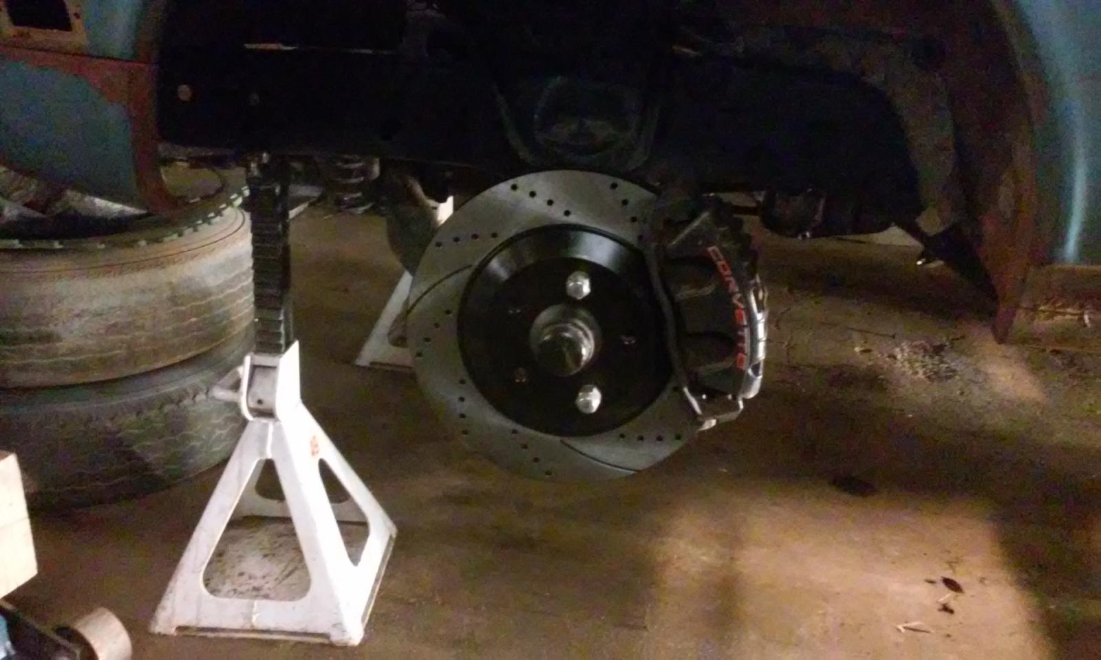

      gonna get ft ride height finalized & remove stock subframe to finish up ft 1/2 of rockers & floor replacement...thinking of 5 1/2" fm subframe to ground....looking at spring options up front. picked up a alum driveshaft & adaptoids fm a GTO so that will get cut down to fit... looking at exhaust options, the oe rear floors hang down a bit lower than expected....they are too low for me to exit the exhaust thru the rockers.....of course the shorty ss headers hit the stock manual box so am looking at real issues with the planned IROC box..... I imagine the Jeep box isn't any smaller externally..... did source a c5 master & booster & calipers....need to hang ft sheetmetal to see how far I have to drop m/c to clear hood....same w/intake....I imagine a cowl hood is in my future for intake options.....we'll see... still trying to find c5 ft wheel to travel on the rear & see if they will work.....

      c5 front's with a little help from Kore3

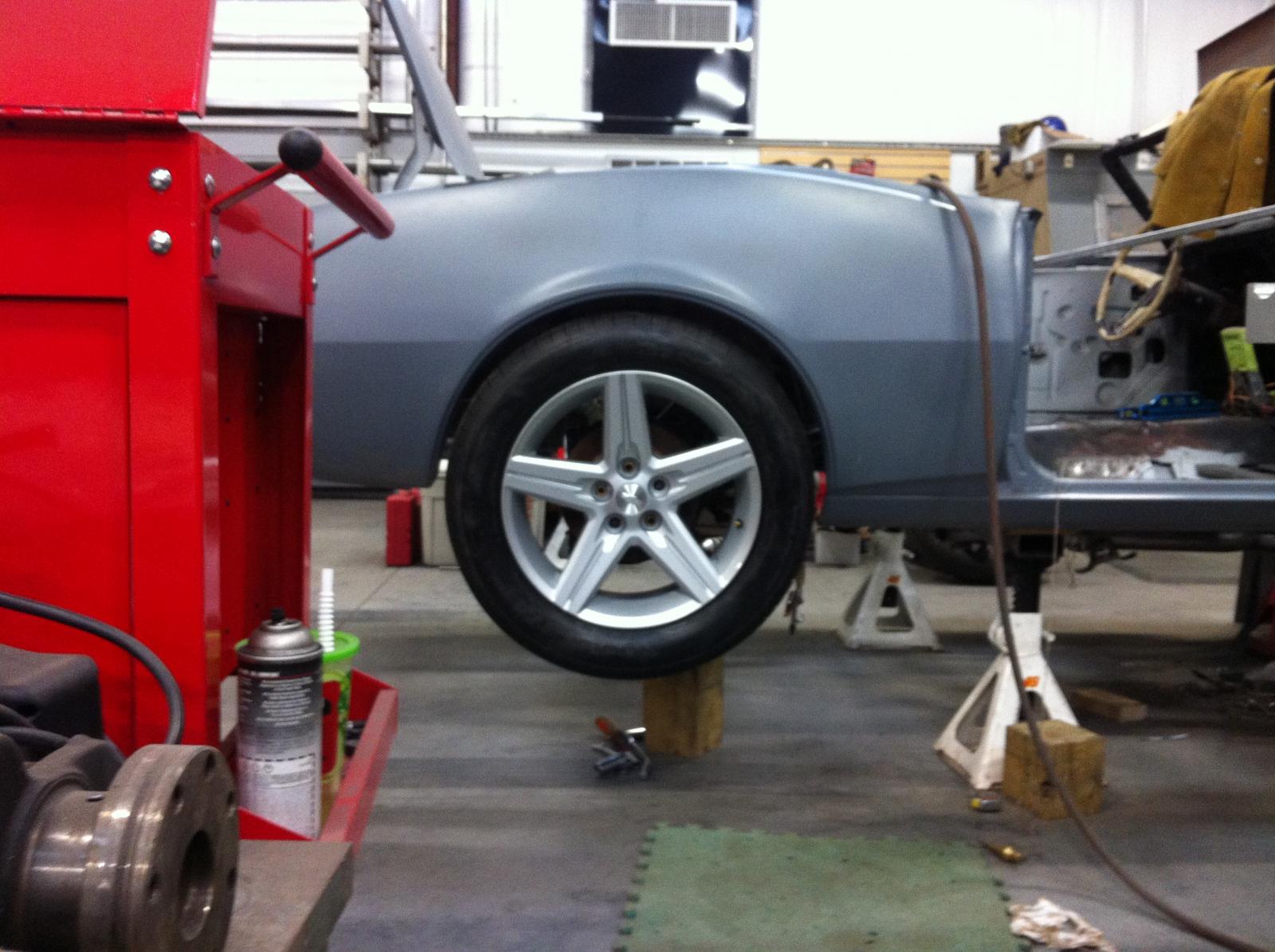

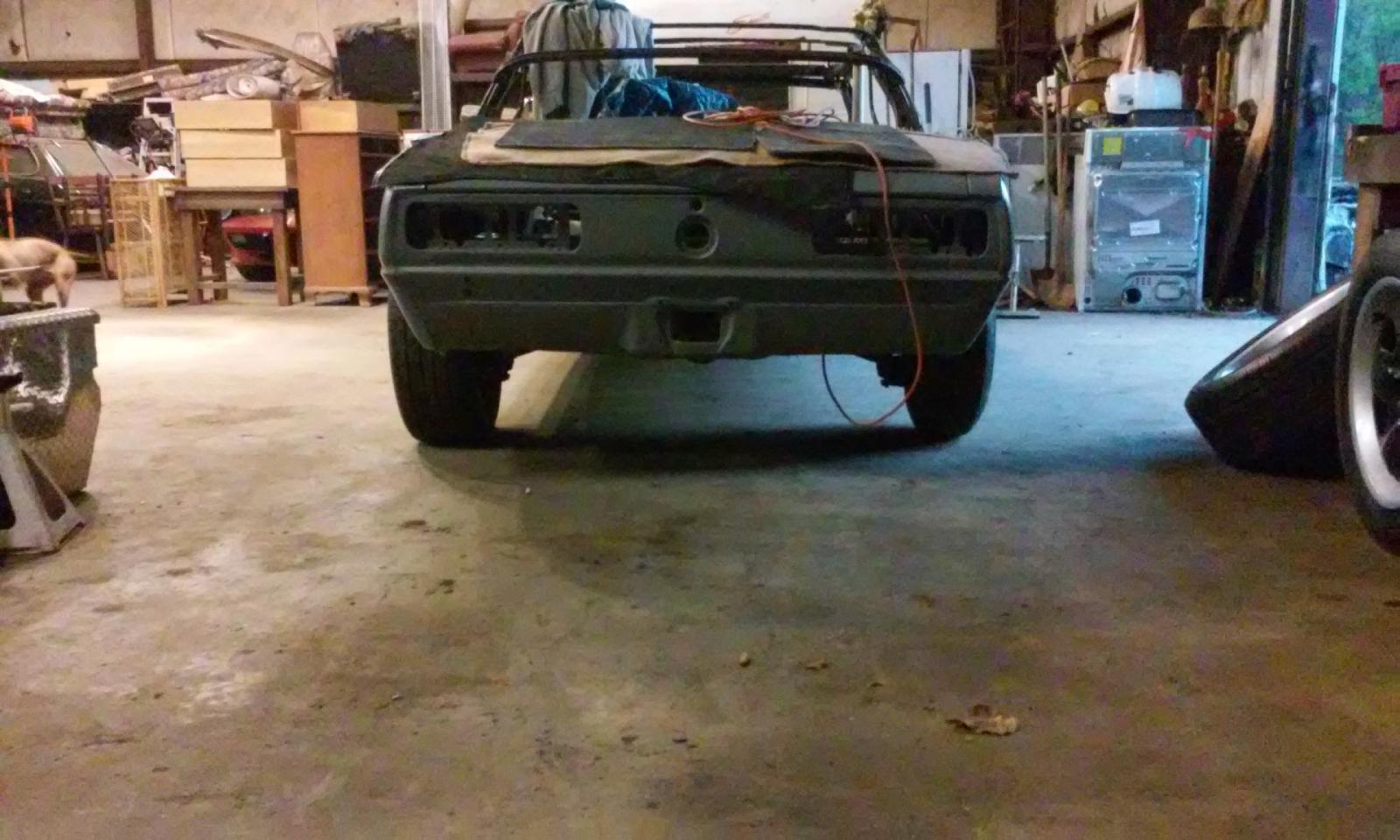

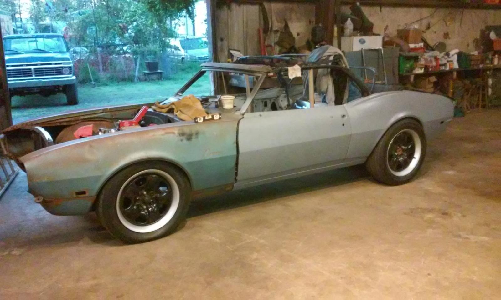

      Dec 2014
      80

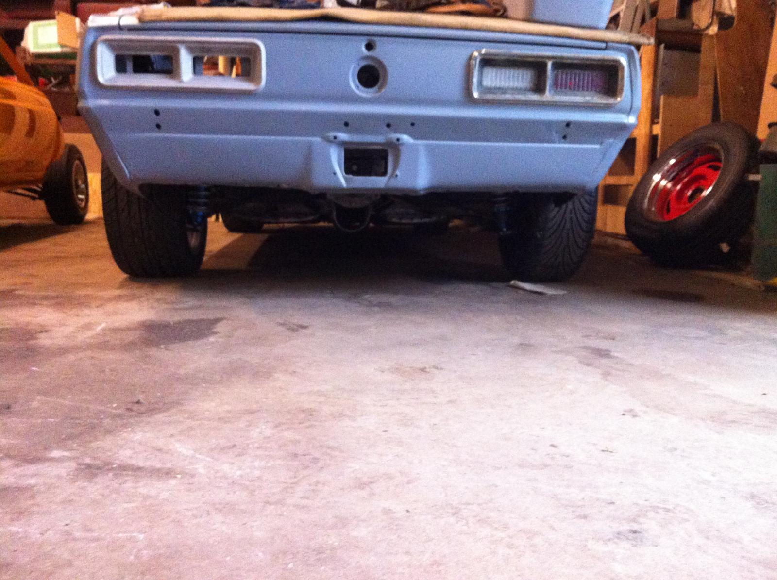

      approx ride height with too tall tires & ugly & cheap camaro steelies...245/55/18....Ignore all the crap draped over the top frame etc...have some 245/45's but saw a coupla GTO's running 275/35's at the Autofair... maybe that would work better.... wheels need a bit more offset in rearName:  0412150651.jpg
Size:  158.9 KBName:  0412150651b.jpg

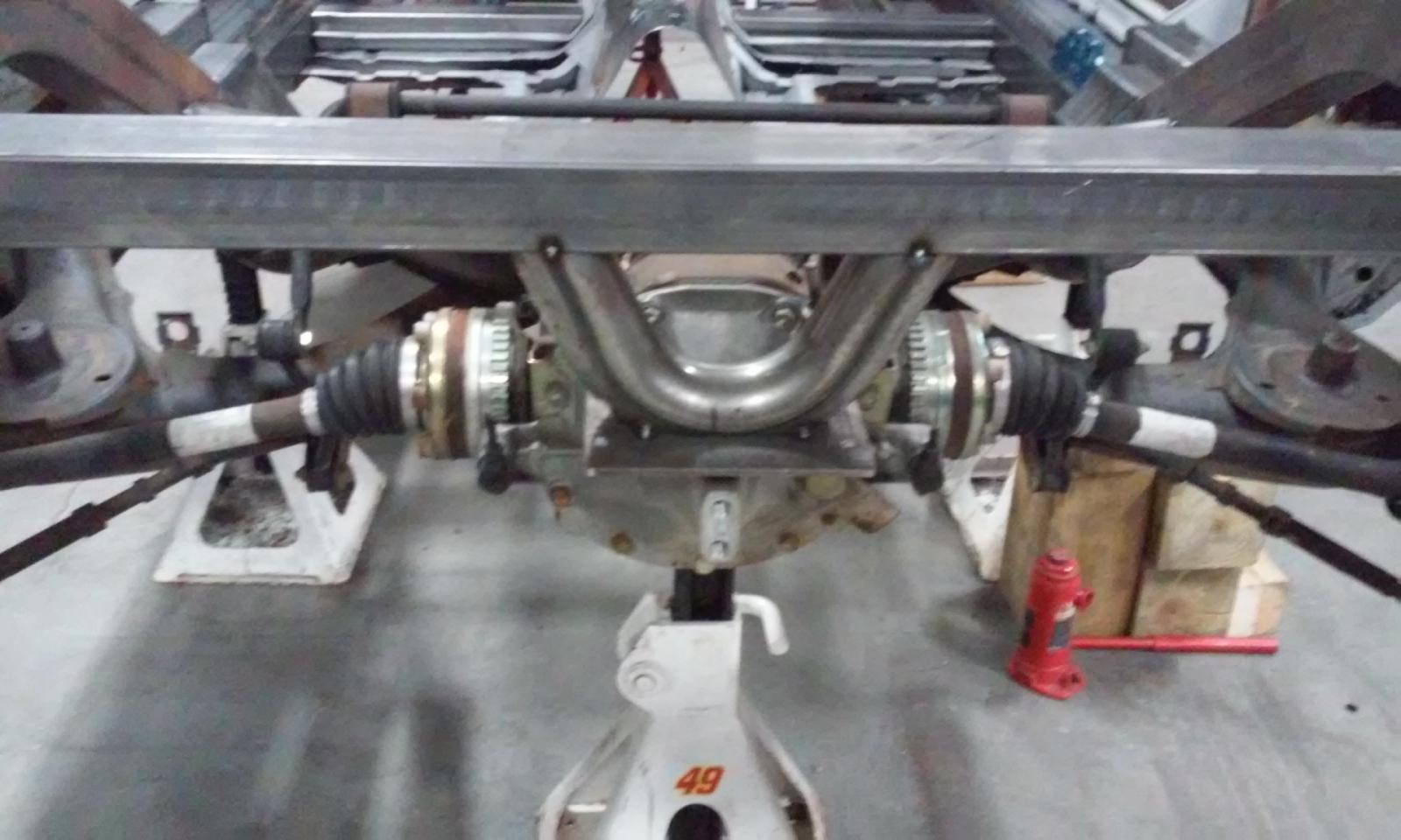

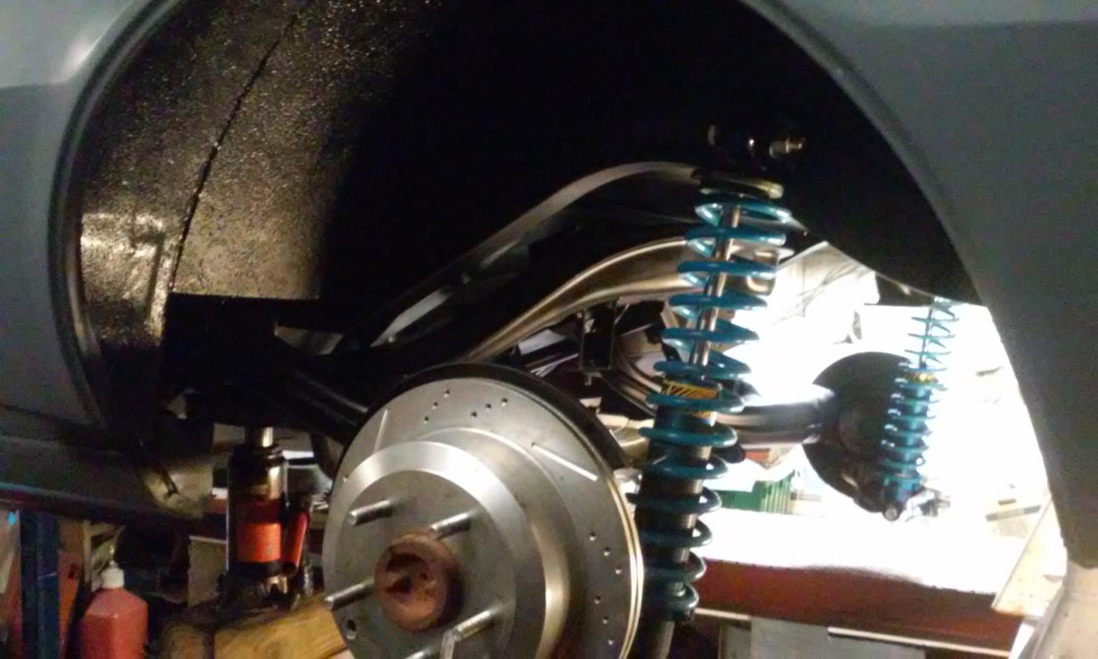

      gto IRS arms & subframe painted & finally installed.....
      '68 Camaro 'vert project

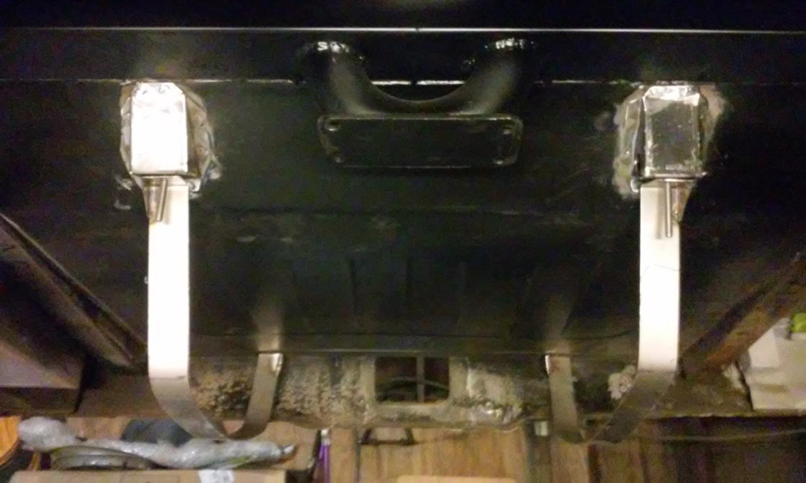

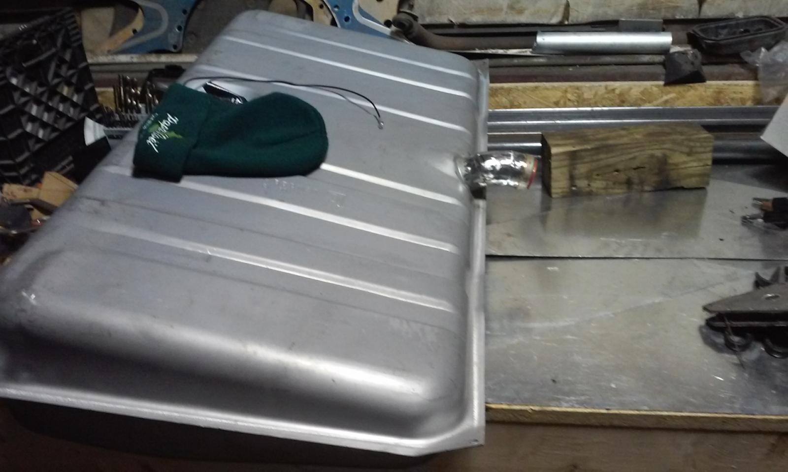

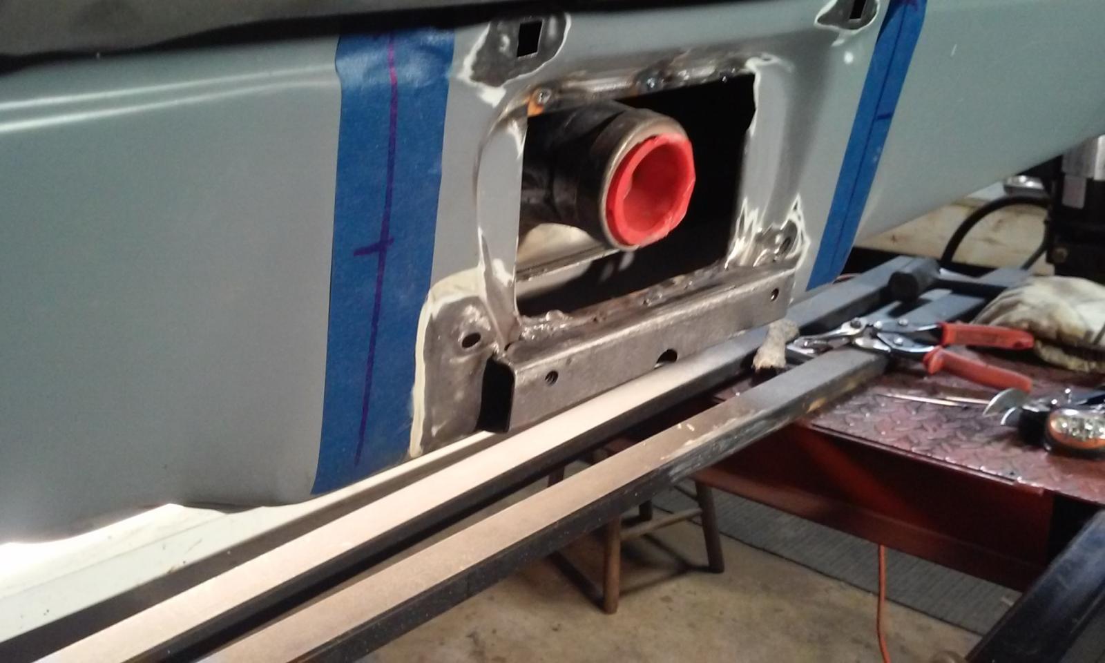

      gas tank fun.....funny(?) how long it takes me to fab up the 'small stuff'..... went with a '69 tank....Name:  straps.jpg
Size:  137.4 KBName:  neck.jpg
Size:  119.5 KBName:  0207161347.jpg
Size:  126.0 KBseems like I'm never gonna be done
