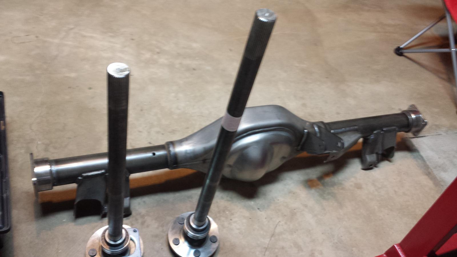

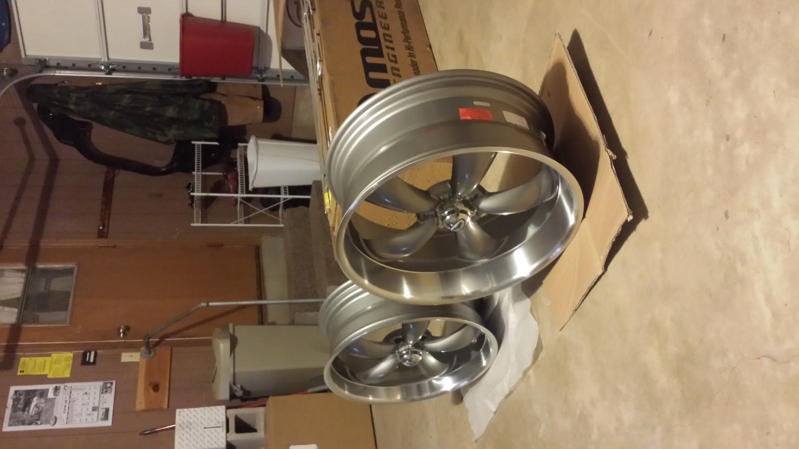

      Here is my build that I have been working on since 2006. Long story short, I started with a 64 impala ss. Took the body off the frame and completely rebuilt the chassis by fully welding the frame welds, beefed up the x section with 1/8th inch plate, powder coated frame and used Eastwood rust encapsulator inside the frame, global west control arms, CCP front disc breaks and 500 steering box, Moser 9in ford rearend with a spool, 35 spline axles, big bearing chevy ends. Coy C5 wheels 20x7 fronts, 22x9 rears still in the boxes. Once the Impala body was stripped I found it had been hit on the right side and needed too much metal work, so I sold that body and found a 64 Belair that was straight as an arrow. Put the body on a rotisserie and fixed all the rusted floors, body braces, trunk tail panel, tail light buckets, and floor braces. Sprayed Eastwood Undercoating with rust encapsulater under the entire car and set the body back on the finished chassis. The car now is the hands of my paint/ body man. Should get her back in February. I'm having him smooth the firewall, fill in all the side trim holes, soda blast the inside and out, and thats where she is at now. The lower quarters need to be replaced and that's what he's working on now. Meanwhile I bought a 5.3 Gen 4 ls, s475 single turbo, custom spec turbo cam, lunati springs and rockers, single custom full turbo kit using gto manifolds. Bought a stock ls1 radiator, swapped out the truck pan for the ls1 fbody pan. Bought a fully built TH350 and had NORTH TEXAS CONVERTERS build me a 3800 billit mechanical diode converter for my turbo setup. Trying to decide to go with air ride or coilovers. The car will be my daily driver except for bad weather days, ice/snow ect. I will be updating my build thread as this move along. Once I get her back from paint, things will be coming together fast. My paint color will be GM White Diamond. Thx for reading and I welcome any help, ideas, past experience, ect....
