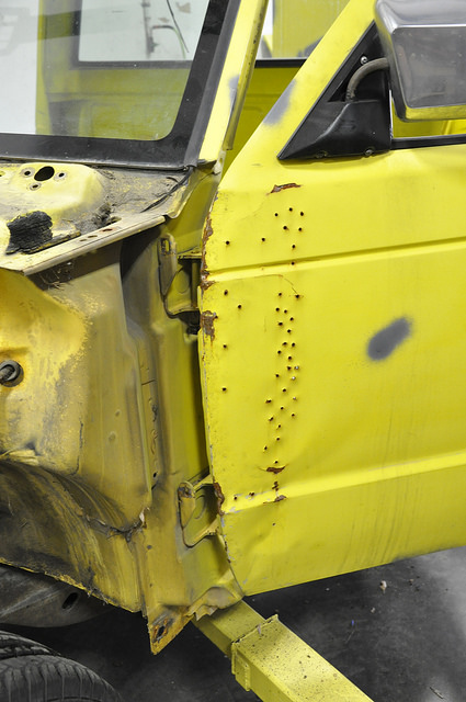

      Most of the S10's around us are rotted out. We hoped the one in Cali was rust-free, and luckily it was! All it really needed was a tailgate and a door which had been damaged.

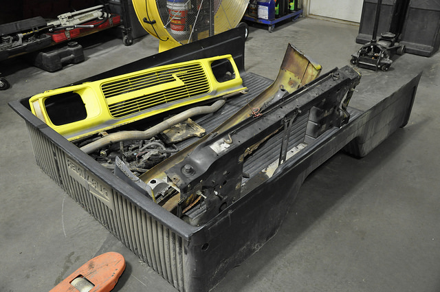

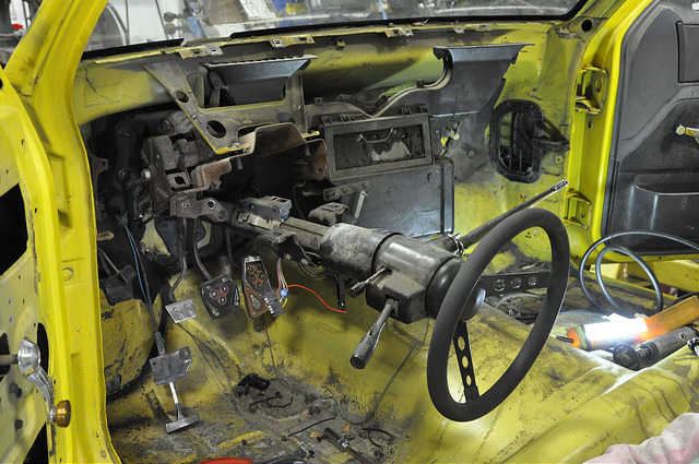

      The teardown:
      We literally found 3+ black widow spiders in this truck upon disassembly. We don't have those around Northern Illinois.. so most of us were really jumpy and often screamed like little school girls if one was spotted, or if we "thought" we saw one.

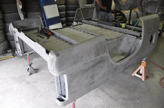

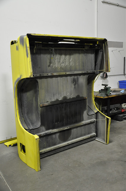

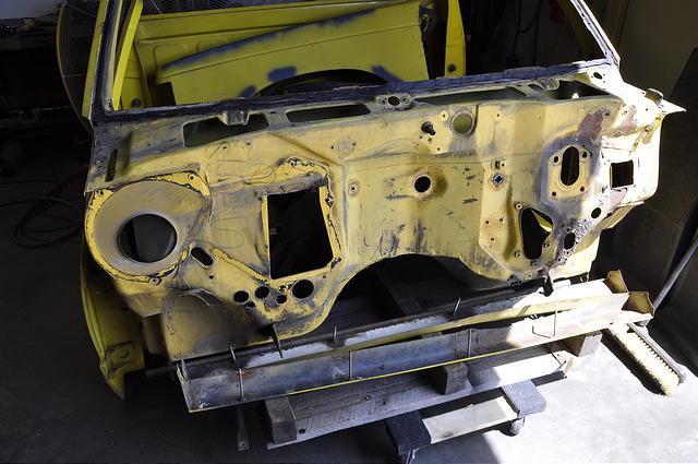

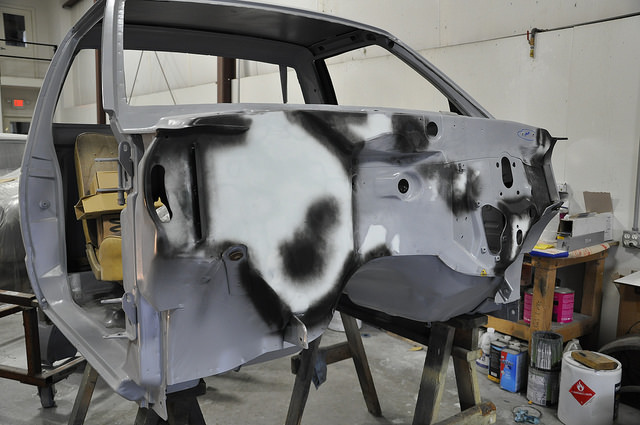

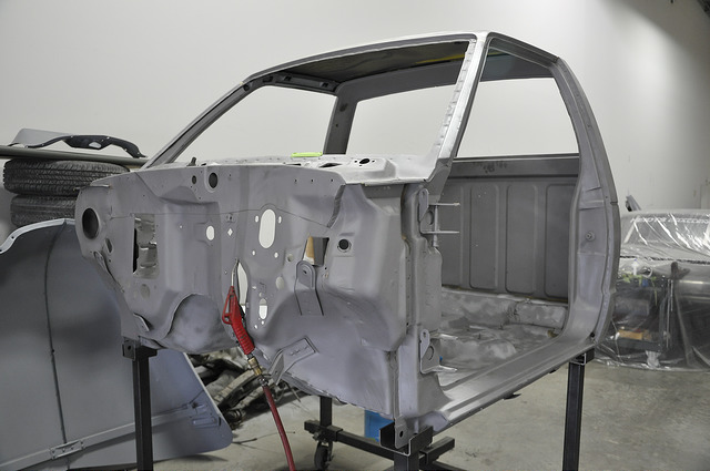

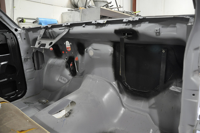

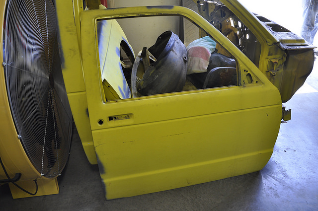

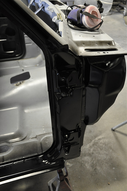

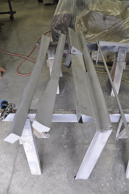

      Next is a bit of bodywork- blasting, priming, etc.
      The previous owner had fabbed up some neat ground effects, but our customer didn't want any of that.
      We smoothed a few areas of the firewall at this stage. Not much was done around the tunnel since we didn't know how the engine & trans placement would end up.
      Holes for AC/Heater hoses
      New door
      Some of the jambs painted
      At this point the chassis started being worked on. I'll touch on that soon.

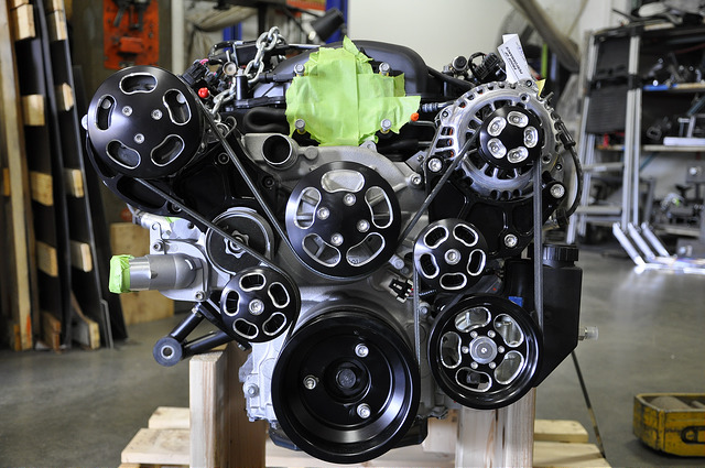

      Mmmm.. I can smell the dry sump lingering in the air.
      ....Was that too much?
      We're using a Wegner front drive system. These by far are the best LS serpentine drives on the market.. We have been using them for over 7 years and try to use them on every LS build. The cost is comparable or less than VA and BS, and best part is, we're a dealer for them.

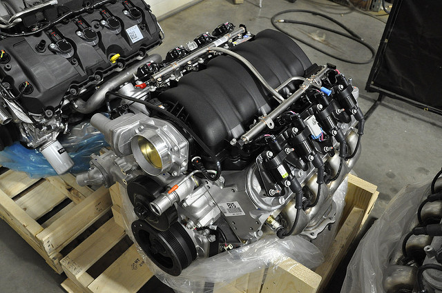

      This is going to be good! What is shipping going to cost to get it there? Also, what is the Coyote motor for?
      Usually around $4k-7k to ship over the ocean.
      Coyote is going in a 52 Ford F1 which hasn't been put on our site yet
