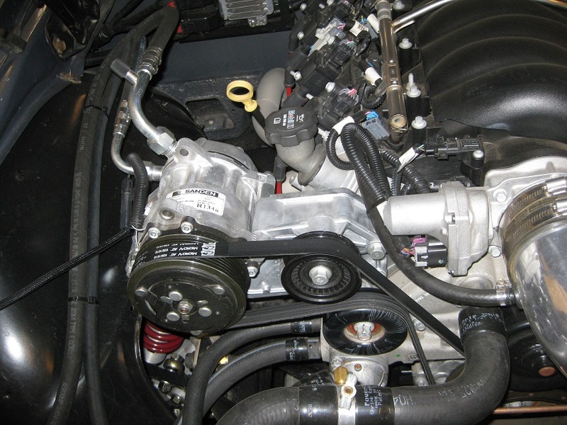

      Hi guys, I have a 67 Camaro with a LS. Iam working on installing the Holley a/c bracket with a sd7 compressor. I don't have the fitting/hoses yet. Iam just worried on how close the compressor fittings are to the inner fender well. Like to see what others have done with the similar set up, pictures would be great. Thanks, Roy

      Does this help at all? This is in a '68.

      Thank you for the picture,very clean!, but I have a sd7(peanut) compressor, and the lines come out the side. I should of just went with the compressor you have for more clearance between the inner fenderwell. I've been looking around and I haven't seen actual pictures, and I know it's been done before! Thanks again.

      That 508 has both side and rear hose mountings depending on the rear cover, look at their Website
