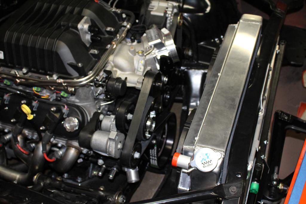

      The only way you might be able to get away without a notch would be to run the small sanden compressor down low but run it on the main accessory belt kinda like this setup but with the small compressor.
      http://www.lsenginediy.com/wp-conten...2015/03/37.jpg
