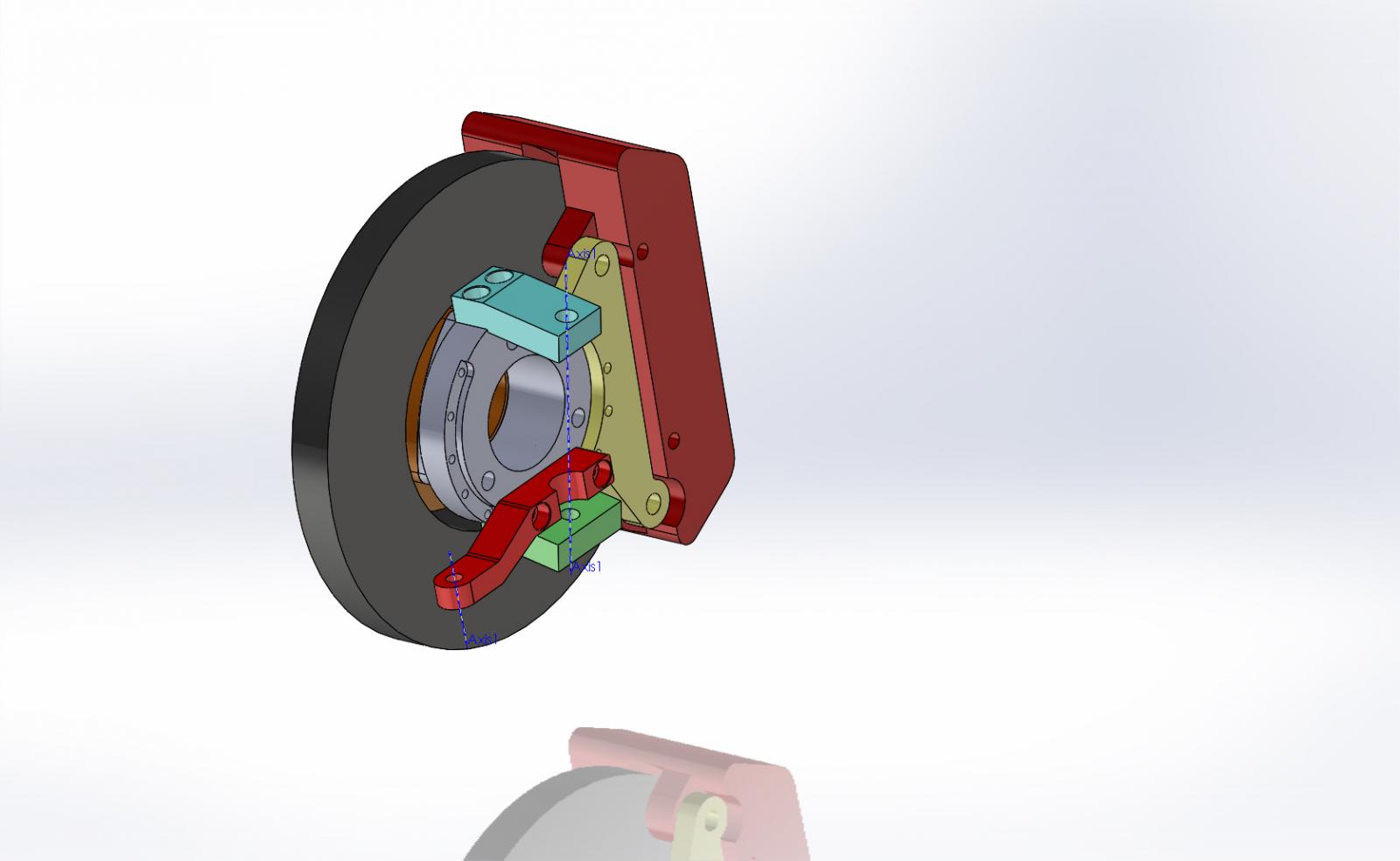

      I want to use the brakes from a Dodge SRT10 Ram on my 67. I already designed new spindles ( and had them made) that are the exact same geometry as the Wilwood pro spindle, but use the hub, rotor and caliper from the srt10.Name:  Spindle 1 Right Side color.jpg

      Why don't you send me the two spindles. There will be a mis-match of ball joints, and spindle height, but the steering arm position is very close. I can fit these in a Wide Ride for you. It would be a cool project.

      that will be really cool to see those brakes on that truck
