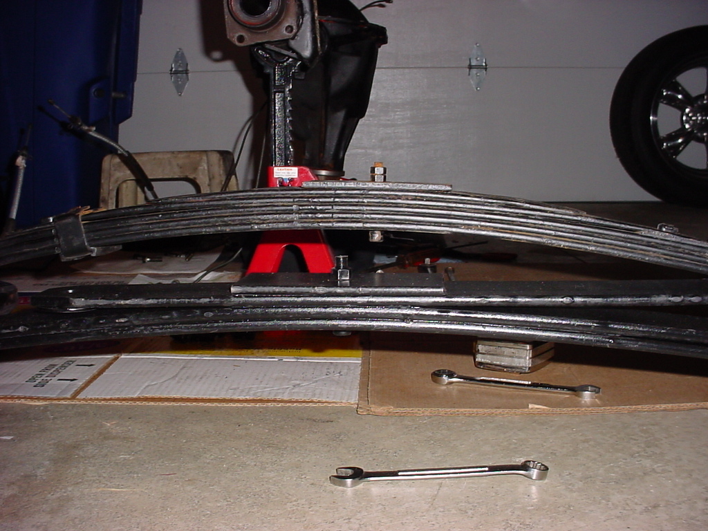

      I tried using my good-ole slapper bars after installing my Hotchkis drop leafs, but it was a no-go. The Hotchklis leafs were so flat in comparison to my factory multi-leafs that the slapper bars were ALWAYS under preload (http://www.danhardison.com/discs/DSC00769.JPG).
      I tried trimming the snubber all the way down but they still were under pressure and this made the rear-end very bouncy. I ended up having to remove them. Wheel hop isn't as bad as with the factory leafs, but there is definitely hop there. I plan on installing Slide-a-links or Cal-tracs before long to eliminate that problem.
