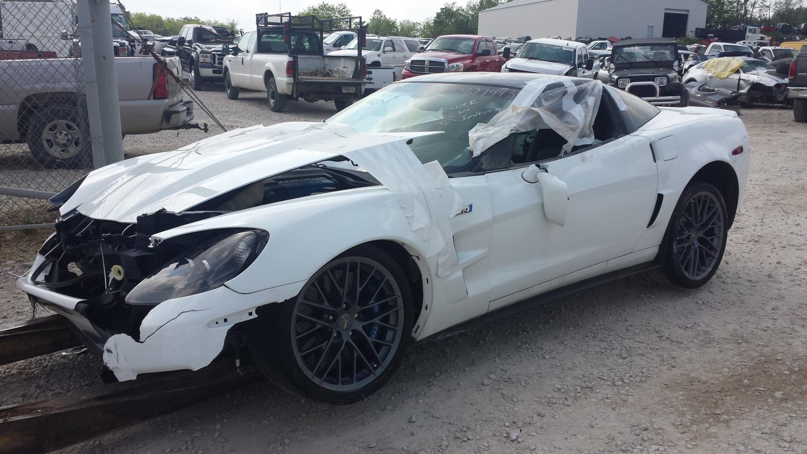

      The donor

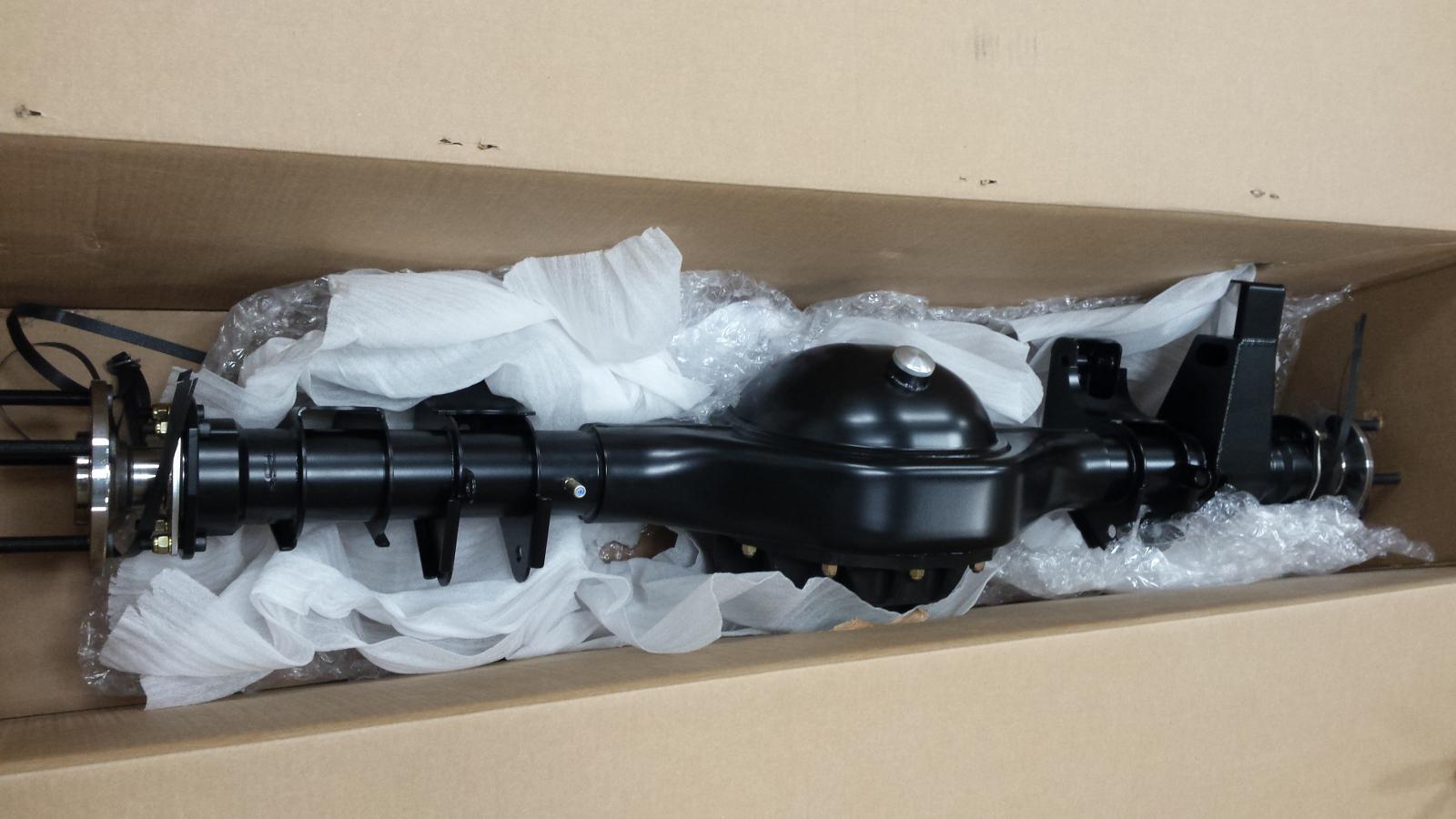

      The new dse 9inch narrowed with a tru trac diff and powder coated and the single adjustable jri shocks

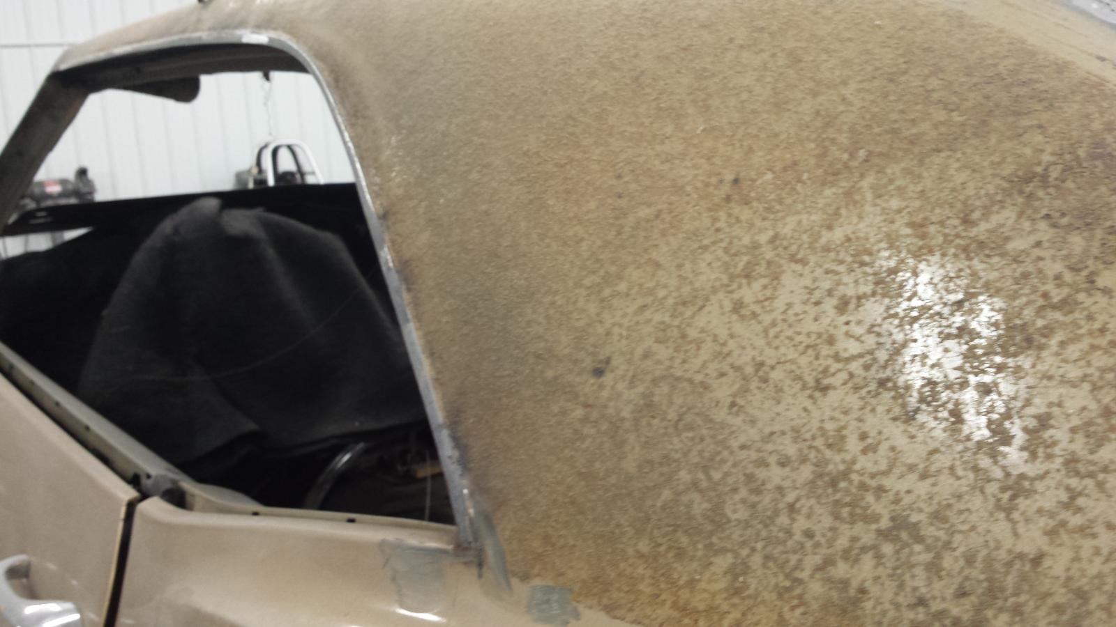

      Drip rails removed, welded up and rough finished. The goal with this build is to not make crazy drastic mods but lots of subtle ones to clean up the look...stay tuned

      The donor
      poor girl =(

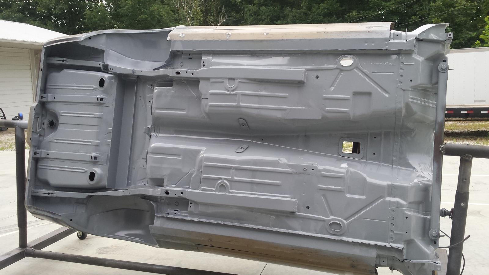

      Attachment 116713been awhile since ive posted any updates. built my own rotisserie, all the dse rear brackets welded in, sub frame connectors welded in, belly to bare metal, then a good coat of epoxy primer

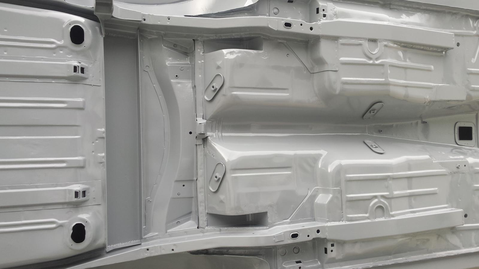

      heres a quick pic of the interior floor, same deal, blasted to bare metal, cut original seat pans out, welded in new lowered mounts for the seats, and cut out and boxed the inner rockers , then a coat of epoxy primer....im using late model seats, and they crowded the center console too much and sat too high. lots of work but now they sit low and look good in the car
