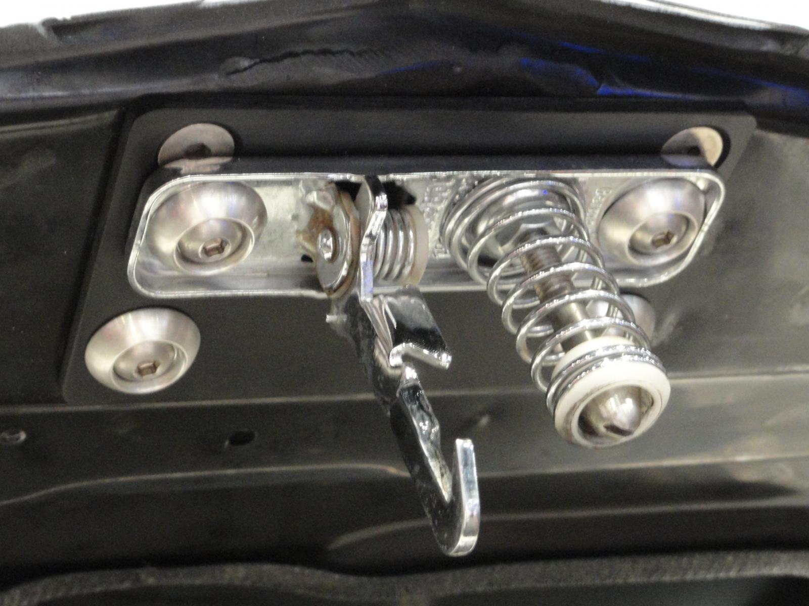

      Here is a picture of the OEM lower latch as I was lining up the VW lower latch.
      https://www.dropbox.com/sc/d3p3idxno...x2FXLT2J8RX2za
      Here is the top latch lining it up.
      https://www.dropbox.com/sc/dzhwg2lhm...5Ab-tKpfYwwXsa
      https://www.dropbox.com/sc/5xk3vto85...fAHuNabpMbwCna

      So now that I had the VW lower latch and OEM lower latch mated, I needed to see what I had to do to get the top pieces mated together. When just putting them together it was obvious that I was going to have to cut some of the pieces off from the upper OEM unit to make the VW upper work.
      https://www.dropbox.com/sc/uyadhymjj...gDKXuROHiA4cYa
      So looking at this picture you can see that all I did was remove the upper OEM latch, put one screw in to hold the VW upper latch, just so I could get an idea of what I needed to do. This told me that I needed to basically build something that was about 1 inch out.
      https://www.dropbox.com/sc/8k093xugs...KqEG-4UD_I9Nxa
      I cut the OEM upper latch apart so that I could basically weld a flat piece of metal to it. Then I could weld the VW upper latch on flat using the entire assembly and positioning it in the center so that it would mate with the lower latch assembly. Unfortunately, I didn't take any good pictures of this step but you will tell what I'm talking about from the pictures below.
      This is an illustrative picture showing that when the OEM lower latch and VW lower latch are mated, then installing the upper VW latch to it, nothing actually mounted to the hood, you can see that there is an obvious gap between where the latch is and where the hood is. This gap was made up by doing what I describe above (modify the OEM upper latch, weld a piece of metal to it, then weld the VW upper latch to it).
      So I went to my buddies and had him weld it up for me (I don't own a welder). We welded up the lower OEM/VW latch together just where the four screws were. This was because welding the entire unit together would have roasted the plastic bushings that are included with the VW lower latch assembly.
      https://www.dropbox.com/sc/uy19vj31d...nbeRmKaUaUE5ga
      Here you can see what we did with the upper OEM/VW latch. You can see we utilized the OEM upper latch that mounts to the hood, then welded a flat piece of metal to it (after I had already cut off the other pieces of the OEM unit basically just leaving a mounting bracket with a step up), then welded the VW upper latch in place.
      https://www.dropbox.com/sc/d9jvqypdh...0UU9tpQLwNscTa

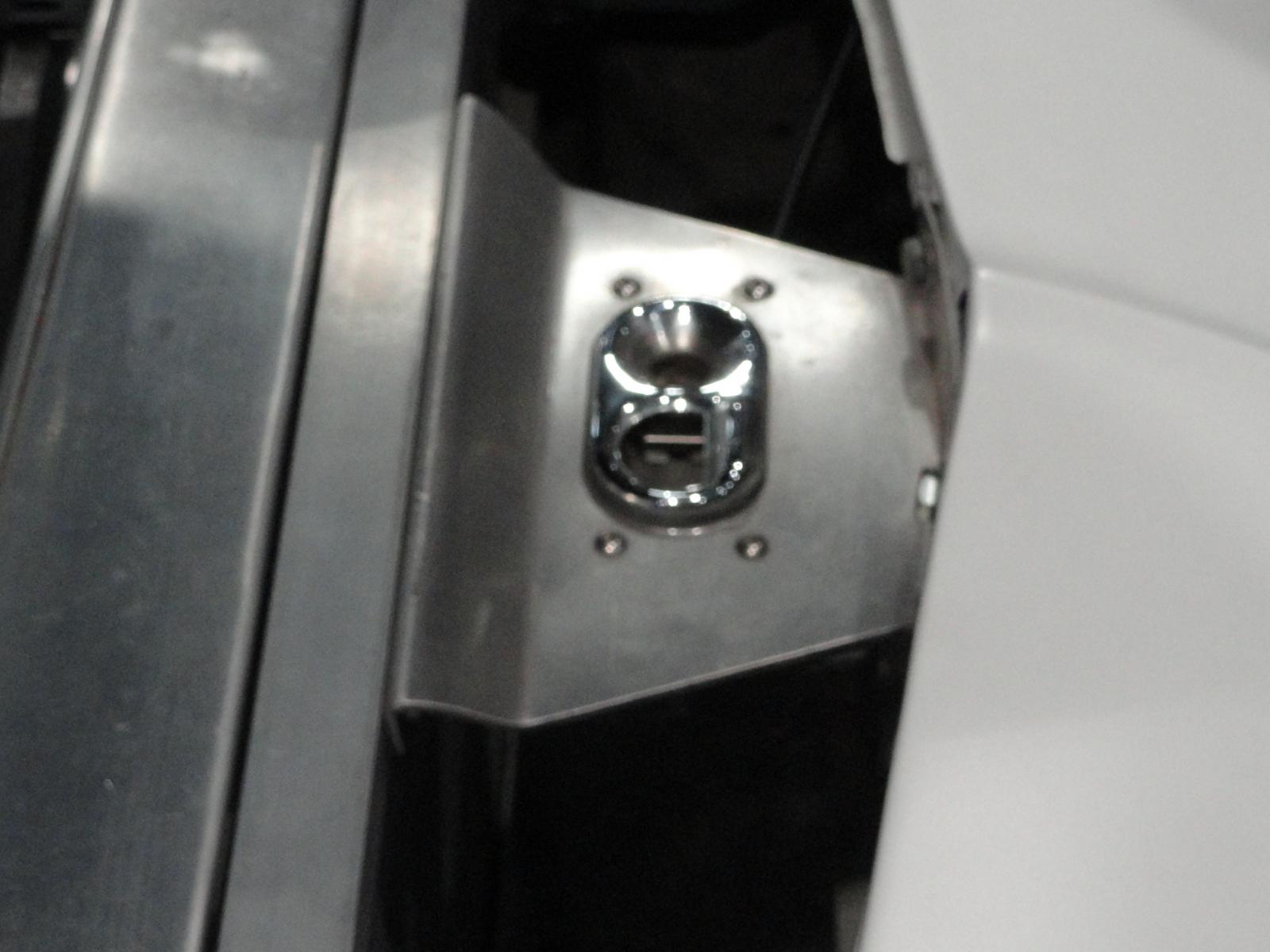

      Now obviously the chunk I took out of my head is only visible when I open the hood, and I honestly doubt anyone would even notice it unless I pointed it out or you own a first gen Camaro. But I think the thing that would jump out first would be the fact that I have an LS2 instead of the fact that there is a small finger sized hole cut out of the hood to provide access for the cable activated hood assembly.
      https://www.dropbox.com/sc/3129xuy1l...Wo0kxzdSxGxQ1a
      https://www.dropbox.com/sc/0ft71ted9...g2ogztgm2U6FAa

      So here is a picture of the cable handle mounted under the dash. I decided to mount it flush because I still have the foot activated e-brake and the handle is right there also. I also have an aftermarket lower kick panel with speakers mounted that protrude housing a small 6x5 speaker and tweeter. This flush mount style ensures that it is out of the way and my legs will never get caught on it.
      https://www.dropbox.com/sc/l7wusvqst...ouDGHdRm_kN16a
      https://www.dropbox.com/sc/tduxncwy9...naBN1F58AwOI0a

      I took these today at SEMA at the Felser booth.

      Nice pics! I like what they did with the lower latch support. Thanks for sharing.
