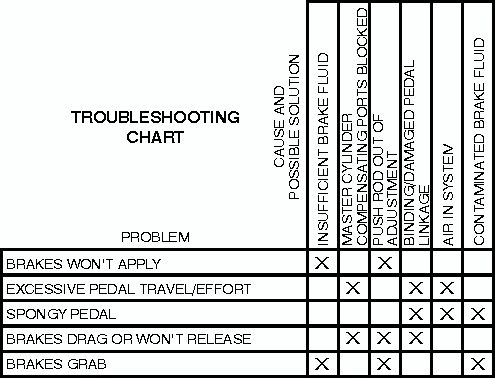

      Finally fixed, seems driving it and rebleeding a few times after I drove it did the trick. That was after I bench bled the MC closed, triple checked the adjuster rod, and pressure bled about 2 gallons of fluid through the rear. I found this chart and thought I add it, pretty much nails it right on the head
      Name:  Brake troubleshooting chart.JPG
