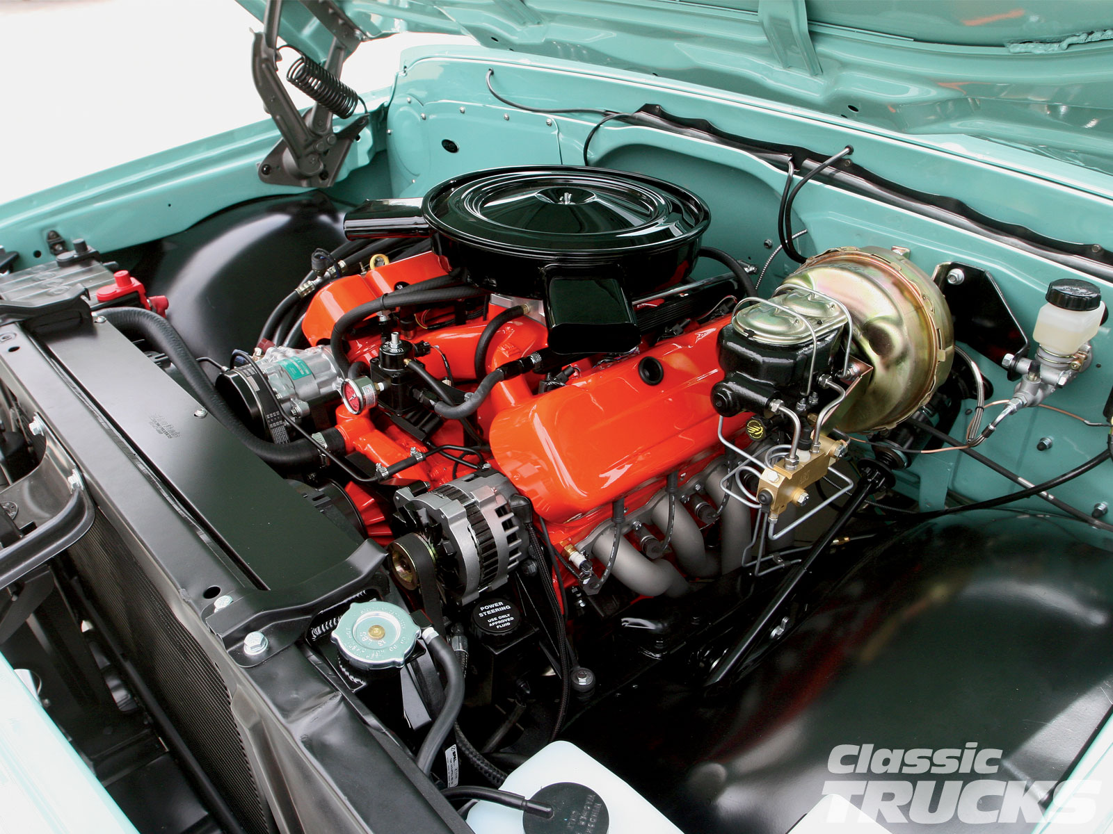

      It's going to be driven for sure. I want it to look similar to the LS in the Holley Performance C10. The sbc in my truck was painted and started to flack after about a year. I would like to be able to easily wash off the block and not have paint come off with it.
