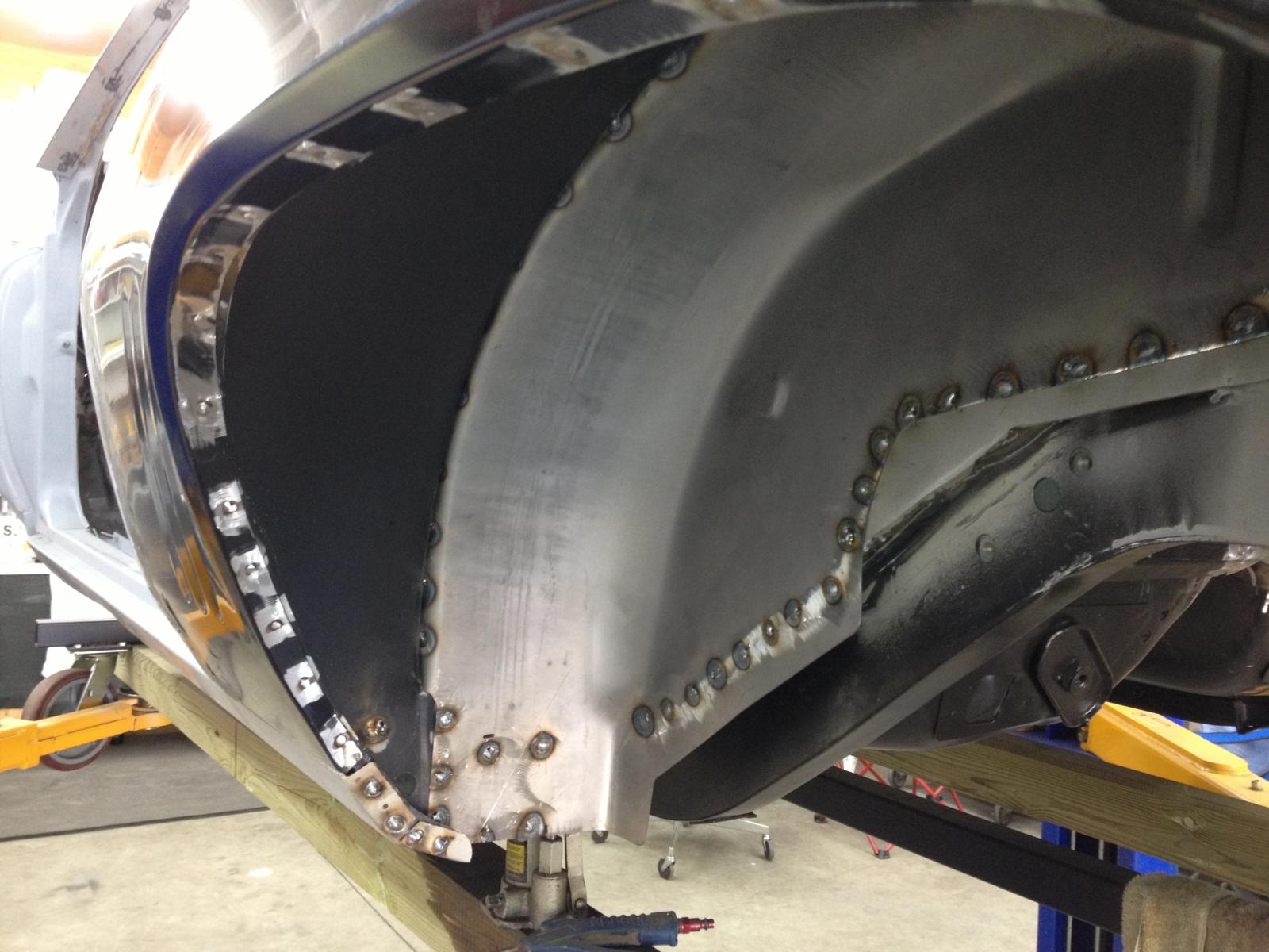

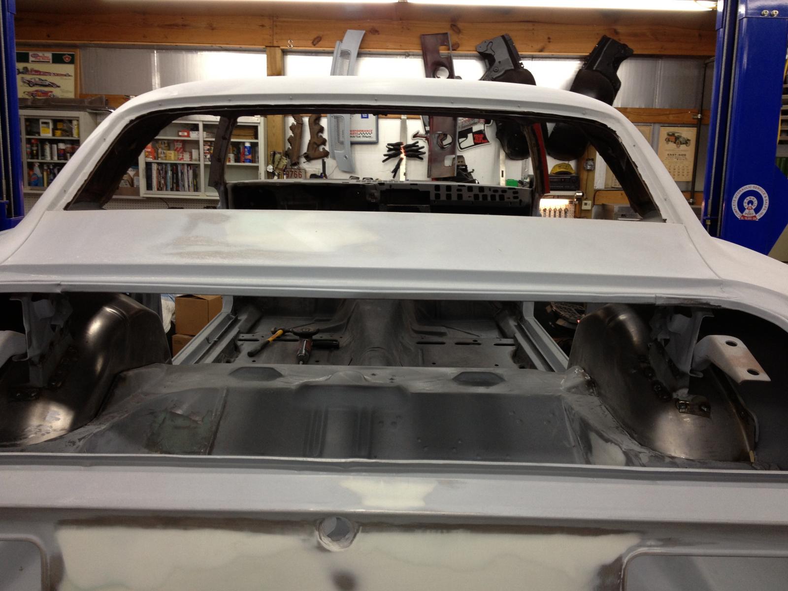

Size:  213.5 KBThat's them Dale. I bought them off ebay back before I ever heard of ridetech. I have all ready bought the ridetech rear 4 link and the HQ shock, DSE mini tubes. I think I'm going to try and sell the A arms and buy the strong arms, Truturn system , and HQ coil overs. Then I don't have to worry about compatibility between parts. Would like to share some pic of my project on here but can figure out how to put them on here. Thanks for all the replies.

      Nice project, nice work. Proud to be a part of your project!

      Thanks Bret, I bought the A arms about 8 months ago and before I heard of ridetech when I bought the car. I have always been into muscle cars and Drag racing. Pretty much anything with an engine. I have always done must of the work myself . I have restored a few cars I am almost 50 now. So I'm not new to this, just new to the Pro Tour aspect of car world. I really got hooked at the Columbus Good Guys this year when I got to see the auto cross up close and meet the guys at the ridetech Stand. I'm hooked on this look. That is the direction I am going with my 69 Camaro. I want the car setting low but not so low I can't enjoy the car on the street. I have a LS1/auto out of a 2002 Camaro that I plan on putting heads,cam and headers on. I'm not made of money so I got to do this in stages. Thats kind of why I bought the A arms not really knowing all the facts. These will be selling on craigslist if anybody is interested. LOL.
      I have a question Bret. From what I researched the Holley 302-2 will not work with the TruTurn. I have read it hits the pan at full lock. The Holley 302-1 works fine with plenty of room but you have to notch the factory cross member for it to fit. Can you shed some light on this for me ?
