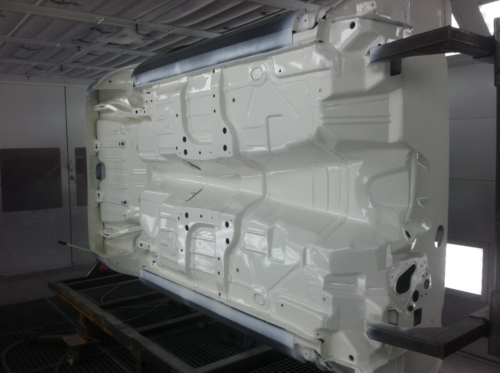

      16
      Here is the jig built to factory specs , at least all the underbody, but were adding a cage on exterior to locate critical points

      update on pace car build
      more of a time line in build on " project updates " thread posted with more pics
