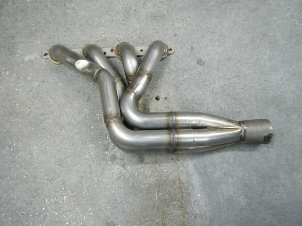

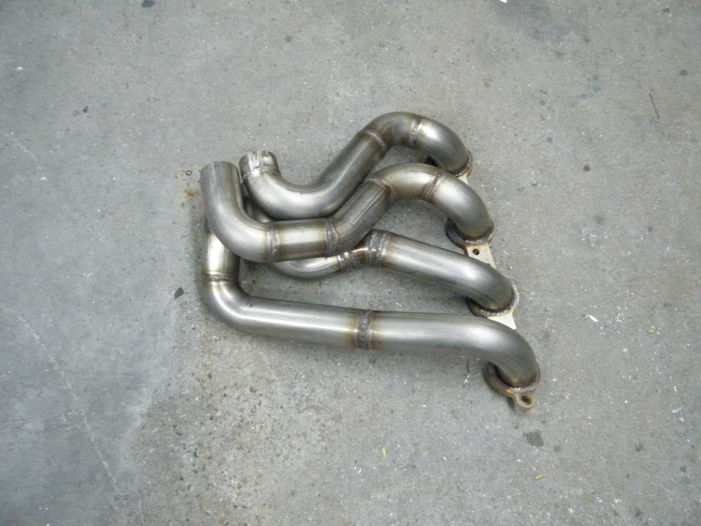

      Quote Originally Posted by NWEBER540 View Post
      Nice headers. Where did you source the collectors and flanges?

    16. #76
      Hamilton, NJ
      166
      I believe they were stainless works.
