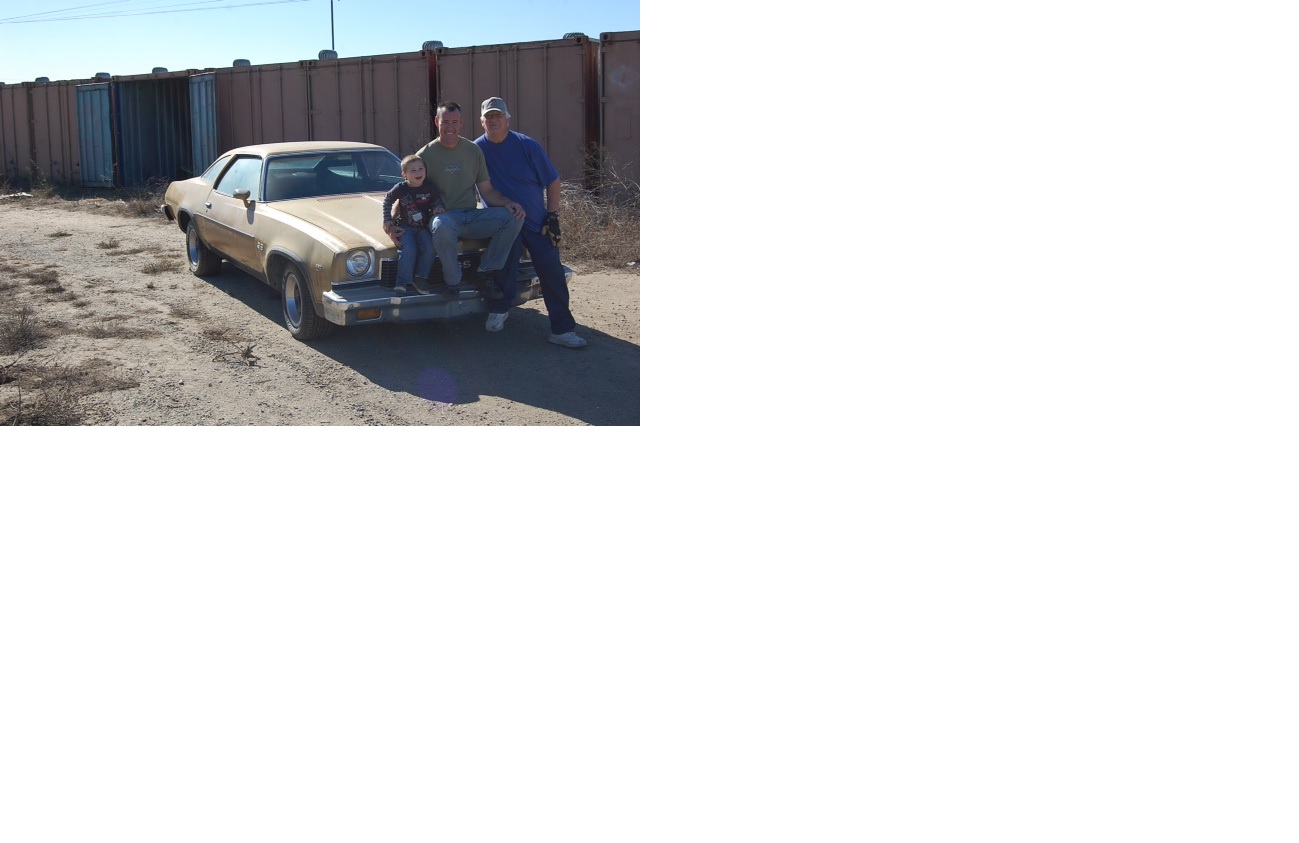

      Here is a picture of the beast with my dad and son taken a few months ago.
      Name:  73 Chevelle.jpg
