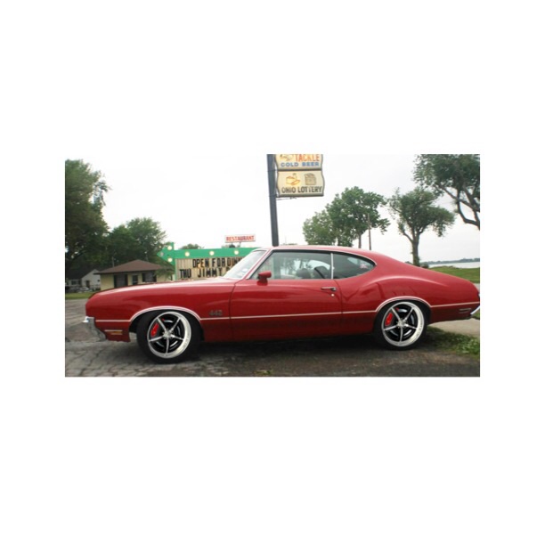

      Hi to all, just getting started here. My son and I are doing a restomod on my restored 71. Phillip McKee took this pic during PT. I'm looking at suspension and brake options, the ridetech parts look great. I've got Rushforth wheels on order Phil photoshopped the wheels, I've been running dog dish caps for years.

      I looked at the subject line and was confused. Space bar is your friend Let us know what back space you went with on the rear.

      Wheel and tire package; Rushforth Salt Shakers with matte black centers, 18x8 & 18x10's. I was going to use Nitto 305/45/18, they will fit but with 5 3/4 BS there wasn't much room at stock ride ht.. Now going with 295's. On the front 255/45/18's and I'm thinking 5 1/2" BS, or is that too much?

      I'm running 6" on the front. 5.5 will be good.
