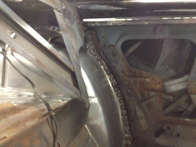

      I got the driver's side tub finished today, It's not the prettiest job but the satisfaction is that I did it myself..I work pretty cheap
      Now on to the passenger side. I got the inner tub removed before football started.

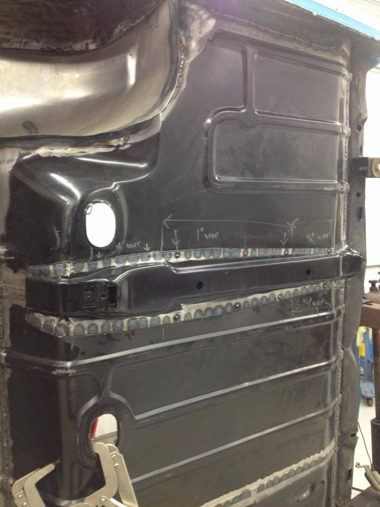

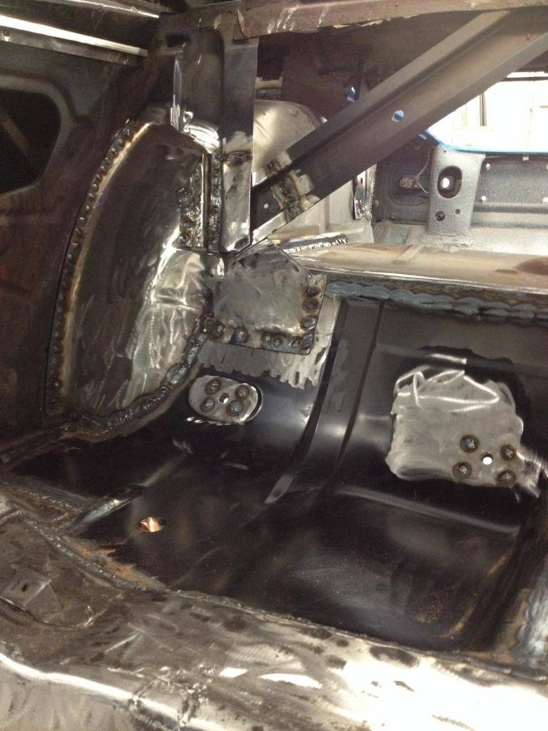

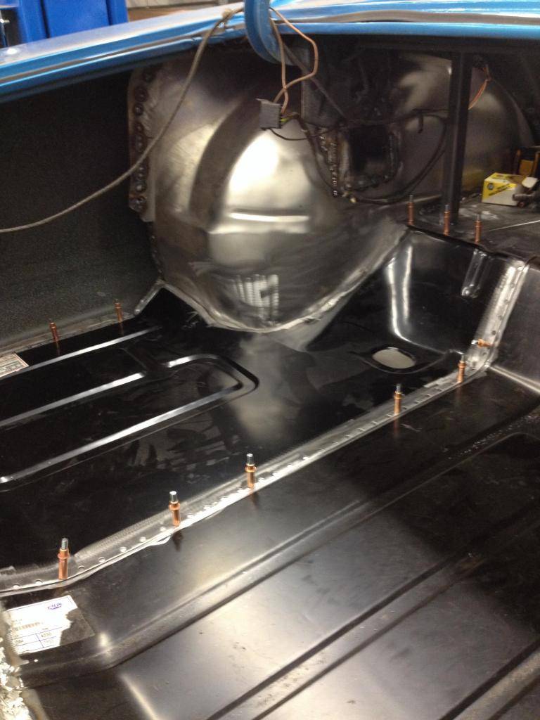

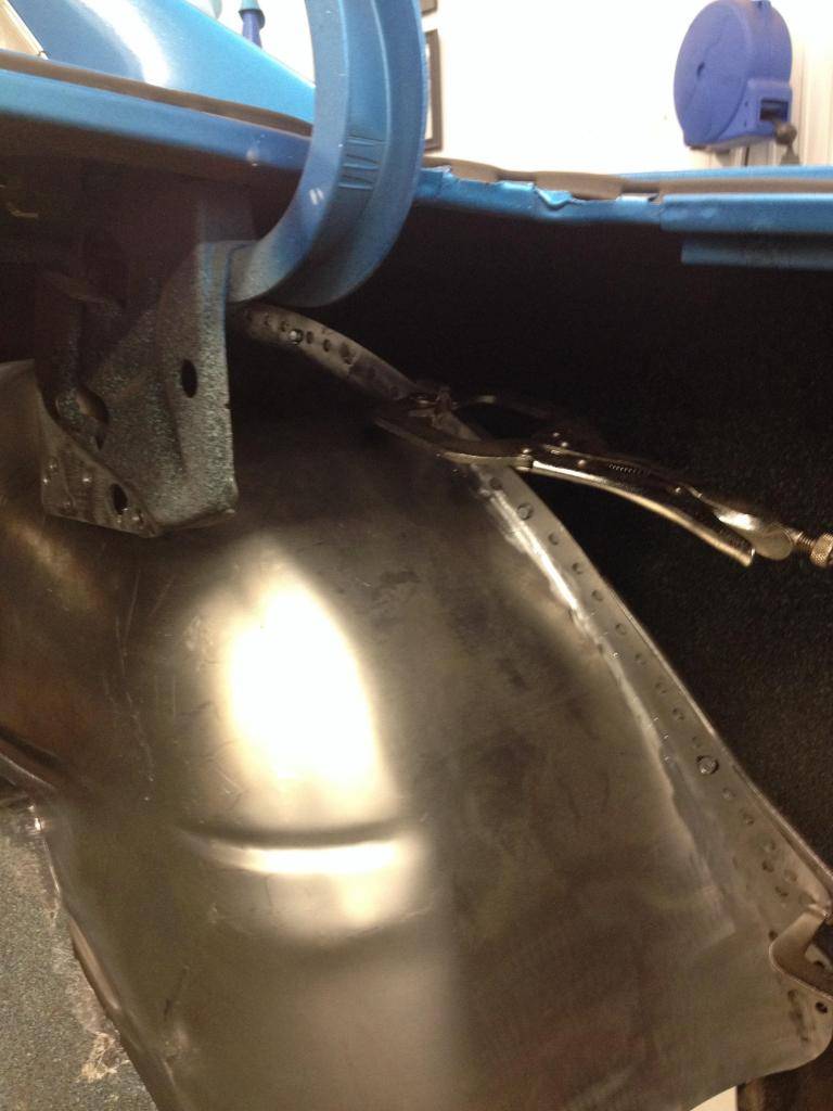

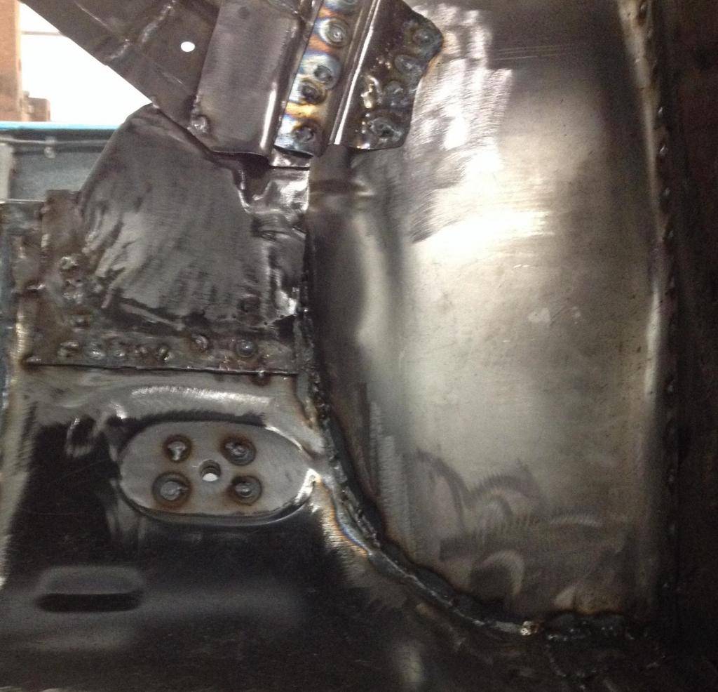

      I'm sure everyone is sick of seeing wheel tub pictures but I finished the mini tub install today and I wanted to show one more:D Overall everything went together pretty smooth but it was a little more involved then I thought it would be. Not to mention all of the hidden stuff I found which caused a few headaches. I was very impressed with ABC's wheel houses, they fit the stock outers perfectly. I probably went about things different then someone who does this for a living but I did learn a lot. If I do another one down the road it will be so much easier the second time around.
      I'm going to try to get out in the shop a few hours each night this week and then hit it hard next weekend and try to knock out the trunk pan install. I still have to do the frame notch yet and I have all of this nice Ride Tech stuff sitting on the shelf waiting to get installed. I'm very excited to get started on the chassis, it's another step closer to getting the body back on the frame.

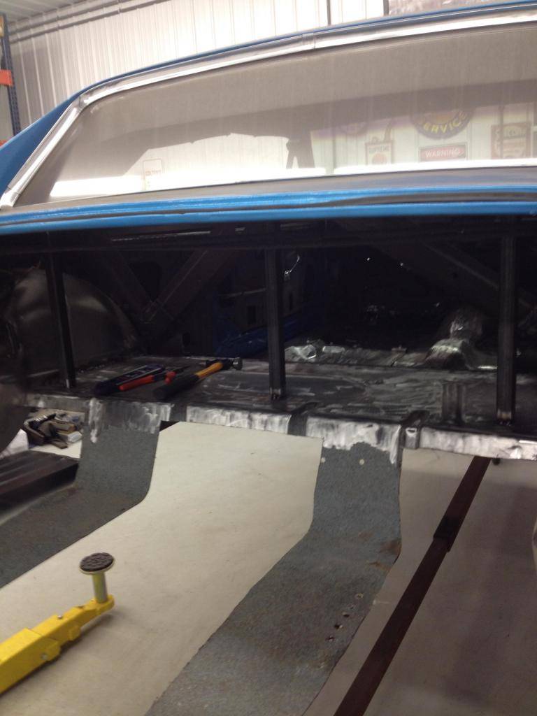

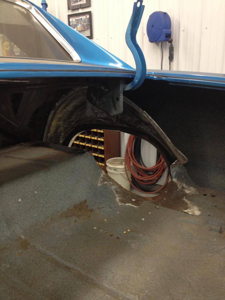

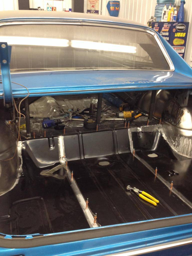

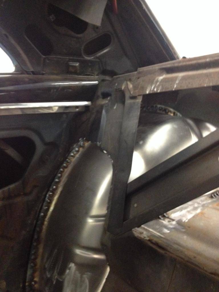

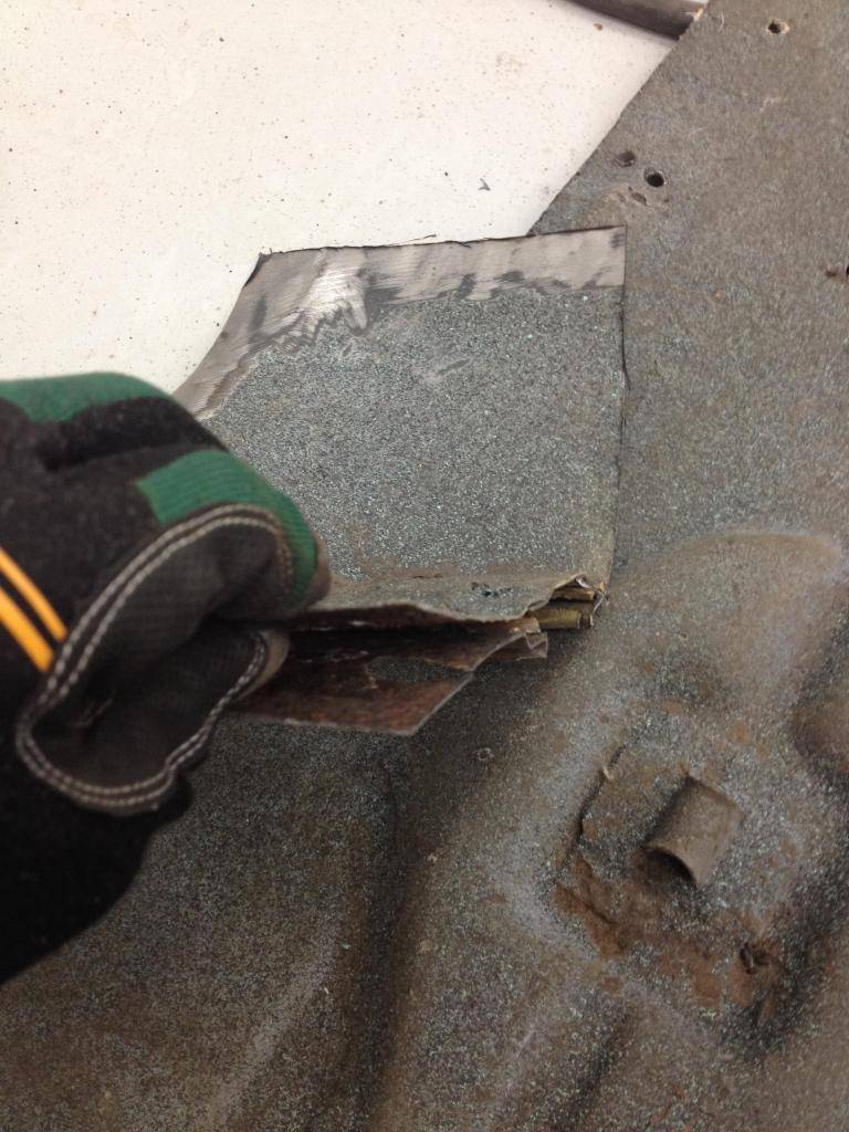

      I started on the trunk today. I cut everything out but the braces. I tacked in some vertical braces on the trunk shelf to insure everything stayed in place and I removed the braces as well.
      This is what a good portion of the trunk looked like. Most of the drivers side had a layer of fiberglass covering rust.
      I was able to get the passenger side and the center pan fitted today. Hoping to get back on it this weekend and finish it up.

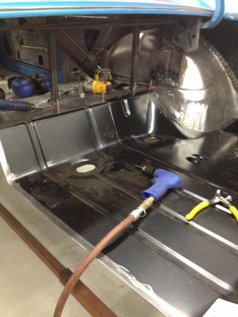

      I didn't get it completely done, still need to get the tank braces on but the trunk pan is done and welded in.

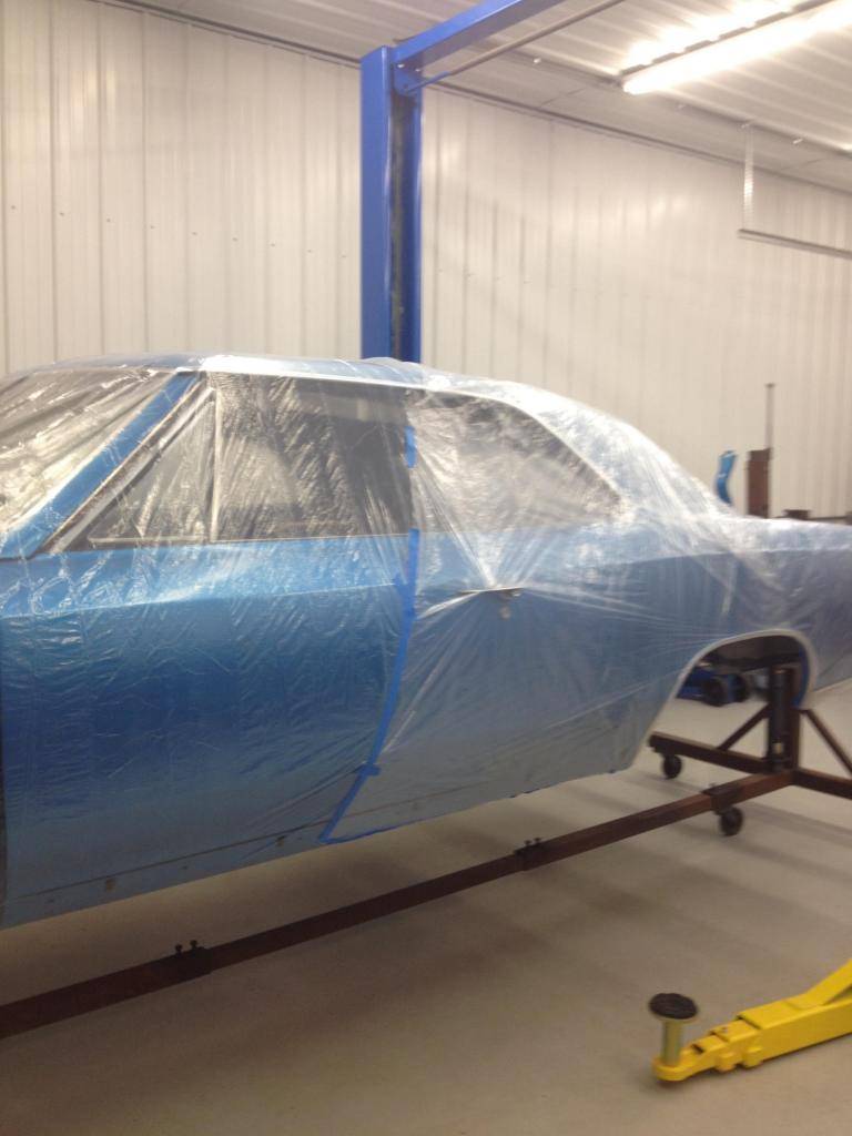

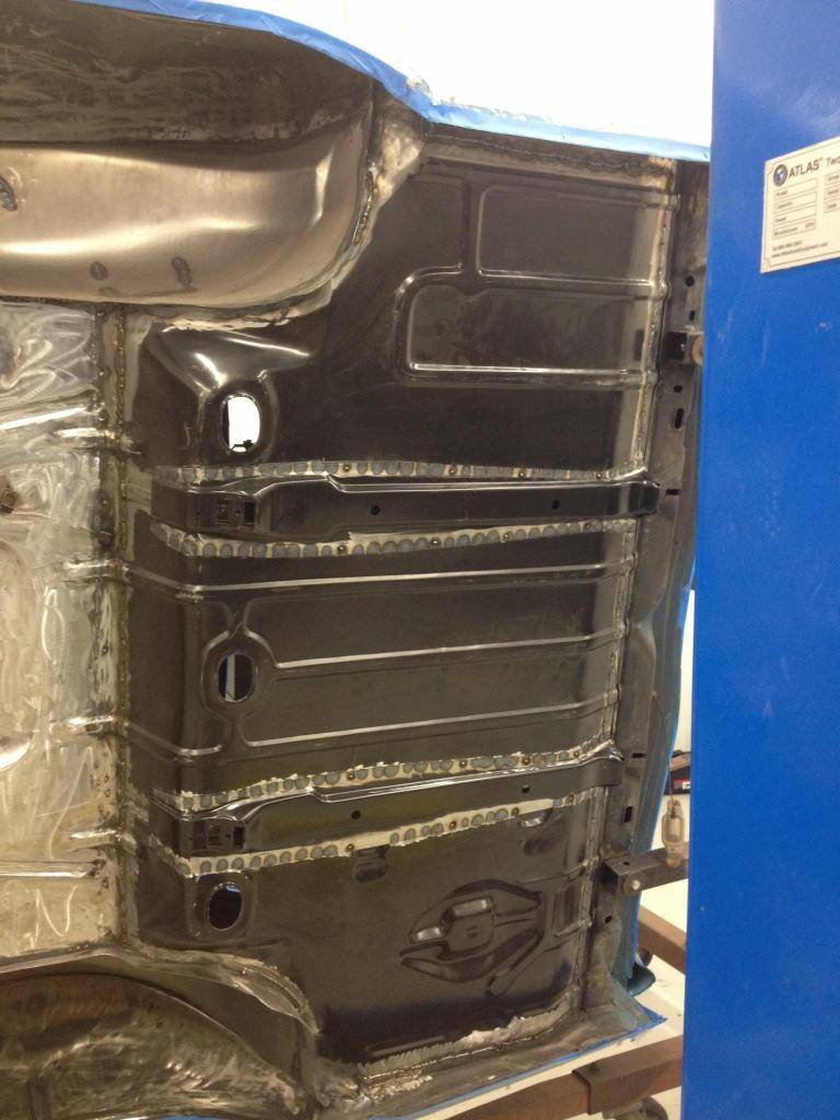

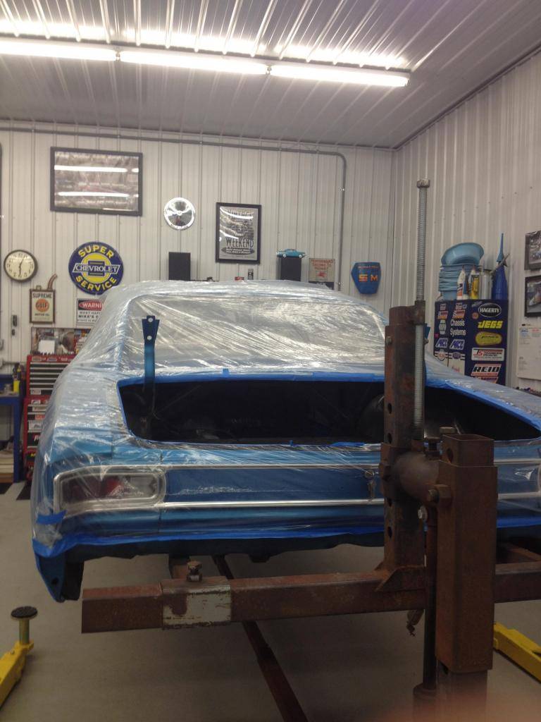

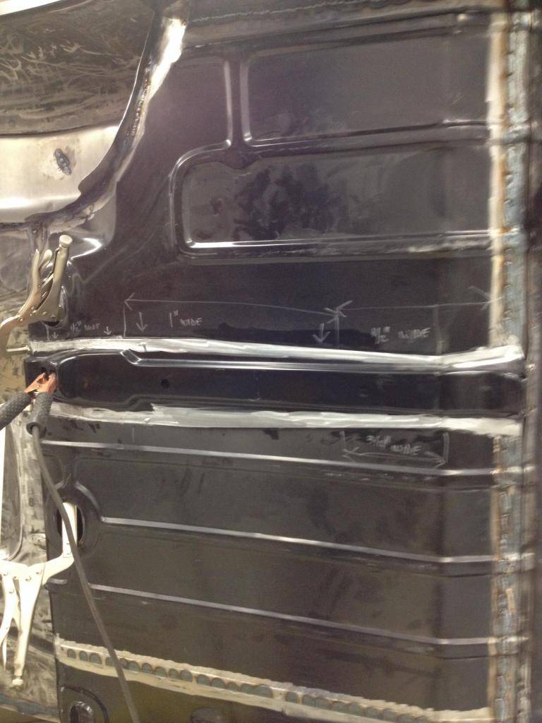

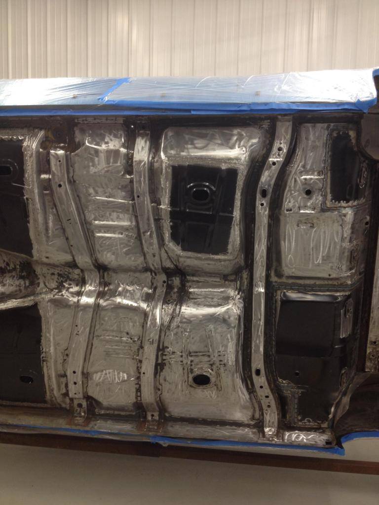

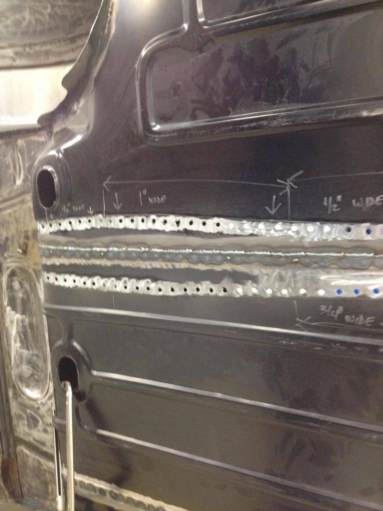

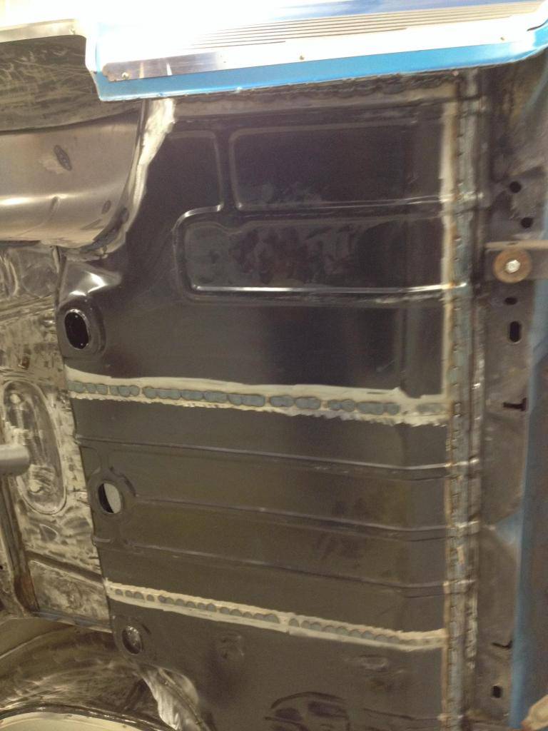

      Well I got called into work on Saturday but I was able to work all day today. I got the fuel tank braces done and the trunk and mini tub are officially done. It's masked off and ready for some etch primer/sealer. I know it didn't happen if there aren't pictures so here are a few

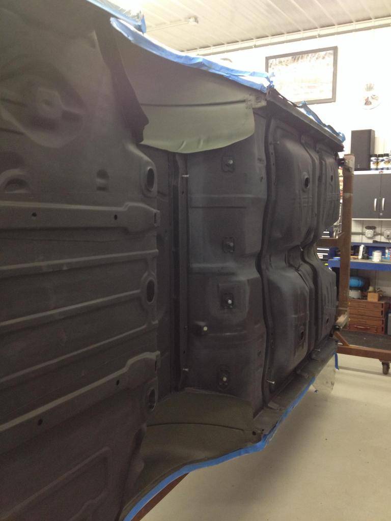

      Well this weekend didn't quite go as planned. My son crashed his bike and broke his wrist Saturday morning. It was very warm Saturday but he managed to find some ice that had not melted yet. We spent most of Saturday in the emergency room. I was able to get the floors in sealer today in between football and waiting on my son hand and foot. He is taking full advantage of his injury, living on the couch like a king and has full control if the tv remote
