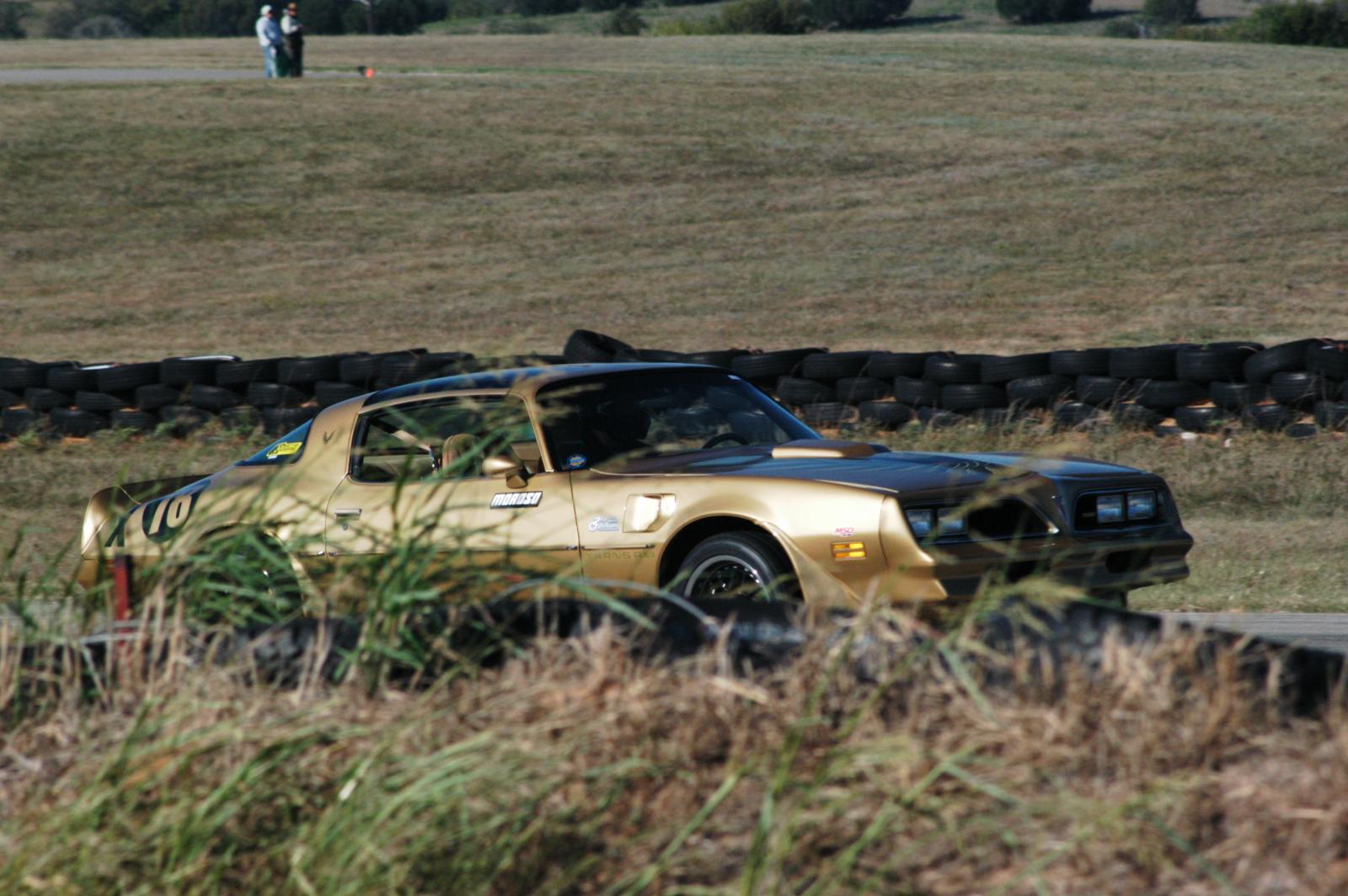

      Another Update to this thread. Carb seems to running great and I'm enjoying my TA again. I've been to a couple events recently and I felt like the TA did as well as it ever has...
      [ATTACH=CONFIG]103697[/ATTACH

      Glad to hear the car is running well! I'll be PMing you shortly for Larry's contact information.
