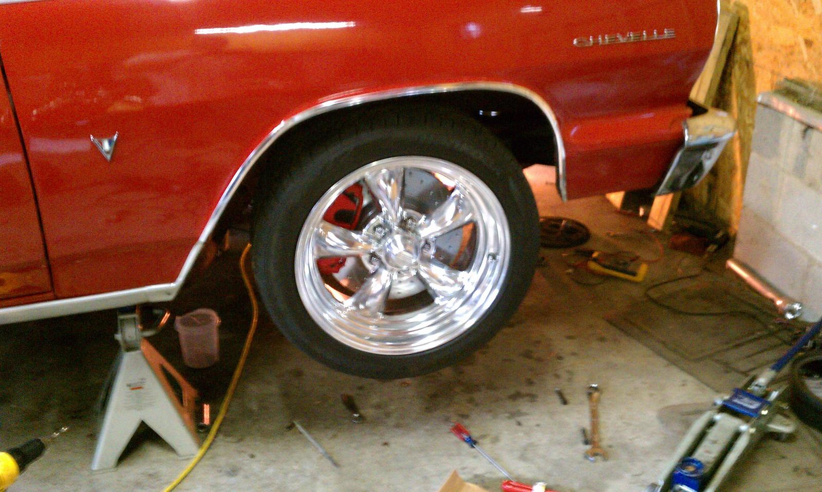

      What wheels are you running Rod?
      We have a few cars with C5 13" and 17's. Cars with TTII's required a 5/16" spacer to clear the spokes.

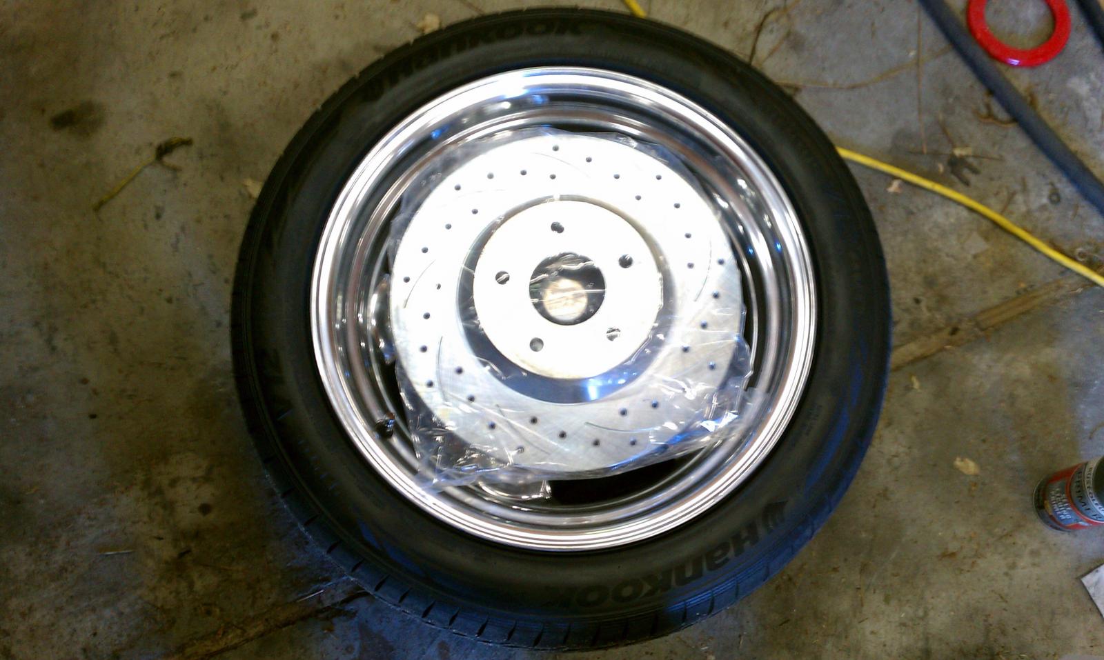

      Wheels
      Attachment 103326Attachment 103324Attachment 103325
