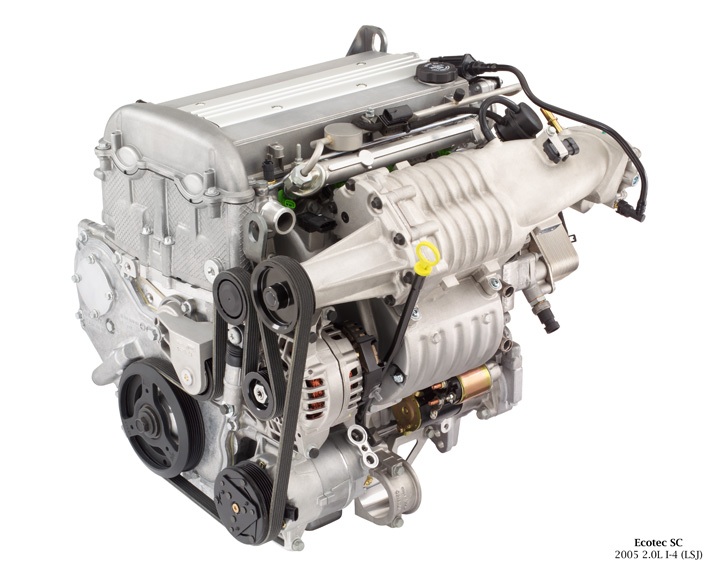

      Have you thought about the boosted Ecotecs? The supercharger hanging off the side would look pretty sweet!

      That does look pretty cool, and has been in the back of my head if I decide to go with a non-Ford engine. Was it ever mated to a rear wheel drive transmission or do they offer adapters?

      Quote Originally Posted by mitch_04 View Post
      The Pontiac Solstice and Saturn Sky had Ecotecs and RWD. The Redline versions had the turbo Ecotec that followed after the supercharged version. I imagine it's probably fairly straightforward to do with all GM factory parts.
