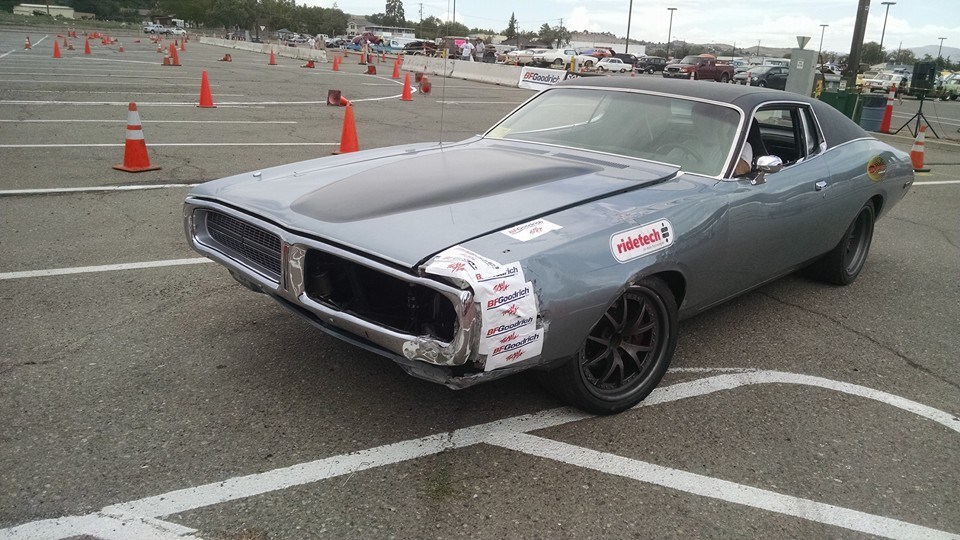

      Bill Howell 72 Charger hit wall in Reno HAN
      A Charger that looks like Mr. Howell's ride hit a wall in Reno, NV at the live stock during hot august nights. Can anyone confirm it was his sweet ride?

      A Charger that looks like Mr. Howell's ride hit wall at Reno live stock during hot august nights. Can anyone confirm it was this sweet ride?
      Pics, I don't think he was driving tho.

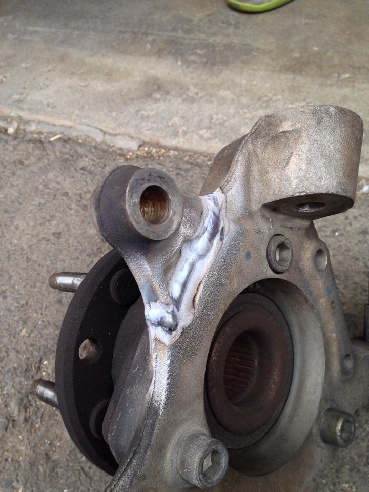

      Yes it was his, spindle broke at the caliper ear, locking brakes up sending him into the wall

      Is that what happened? From my perspective looks like the wall was too close to the track lane. He was going too fast around the bend, slammed on the brakes and hit. Didn't appear something went wrong. Were you there by chance?

      Fact, spindle broke

      No he posted on facebook about it with pictures. Looks like he got it welded up locally and hammered out the fender and is running it again. Welding scares me though? Yes I believe is was a Corvette spindle.

      Where you there by Chance? Hey I was there and saw what happened. All I said what it looked like to me. I saw the passenger side lock up and smoke. Is that the side the broke? It could have broke on impact. Btw he drove it about 100 hundreds yards to where you see it in the pictures and drove it to the tent area afterwards. By no means a pissing match here. Like I said, I saw it happen. I just would have thought if the brakes where stuck, he wouldn't have been able to move it.

      GM upgraded the C6 upright in 2009 and made that area thicker using a different casting process. Sorry it happened to Bill!

      no he posted on facebook about it with pictures. Looks like he got it welded up locally and hammered out the fender and is running it again. Welding scares me though? Yes i believe is was a corvette spindle.
      John,
      I would think those spindles are forged, but who knows...
      Do we actually know what happened?

      oh man that sucks! I wouldn't run a welded spindle myself, I hope for his sake it lasts!
