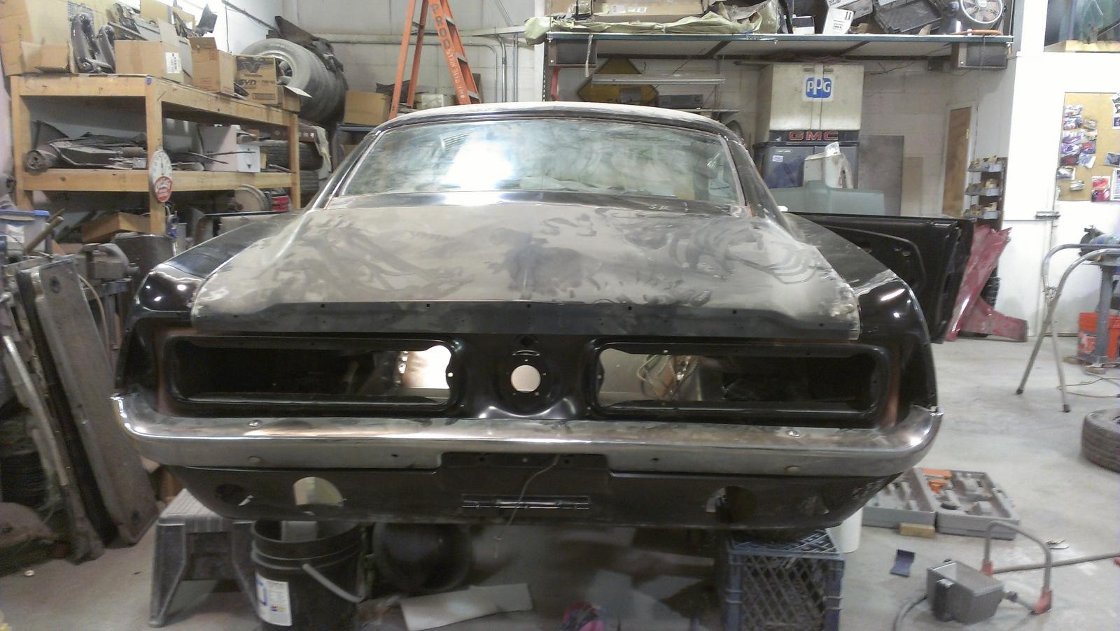

      Thanks guys, seems like I have a few options here!
      Carl- I think the widest tire I would try to fit would be a 305 or maybe a 315. The car is mini tubbed so I have an extra 1 1/2 to 2 inches. Also the exhaust is a factor because I fabbed up the rear valance from a 65/66 into my 67.
