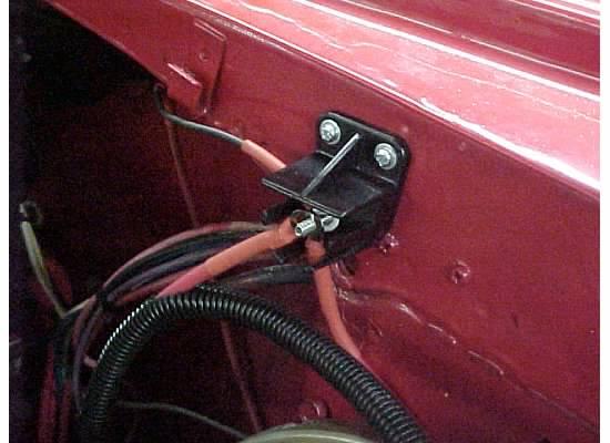

      What's the best way to connect the Power leads -ECU, fuel pump - to a Side Post battery? Is there some kind of Connector(s) that can be used? What about Fuses or Relays to protect the ECU and Fuel Pump? I've found a Side Post type connector that'll work for at least one wire but I'd like to do it right.
      http://custombatterycables.com/image...xtra_wire4.JPG
