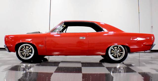

      1967 Rambler Rebel aka The Swamp Monster
      Had the car since I was 19. The past 5 years or so have been nothing but learning hotrodding and honing my fabrication and welding skills. Its all getting poured into this project. The goal is to have it ready by the next power tour. All fabrication has been done by me. Tube front end, c5 corvette front suspension, New firewall, Javelin Frame rails, all sorts of stuff. I have tons of pics. Let me know what you think.

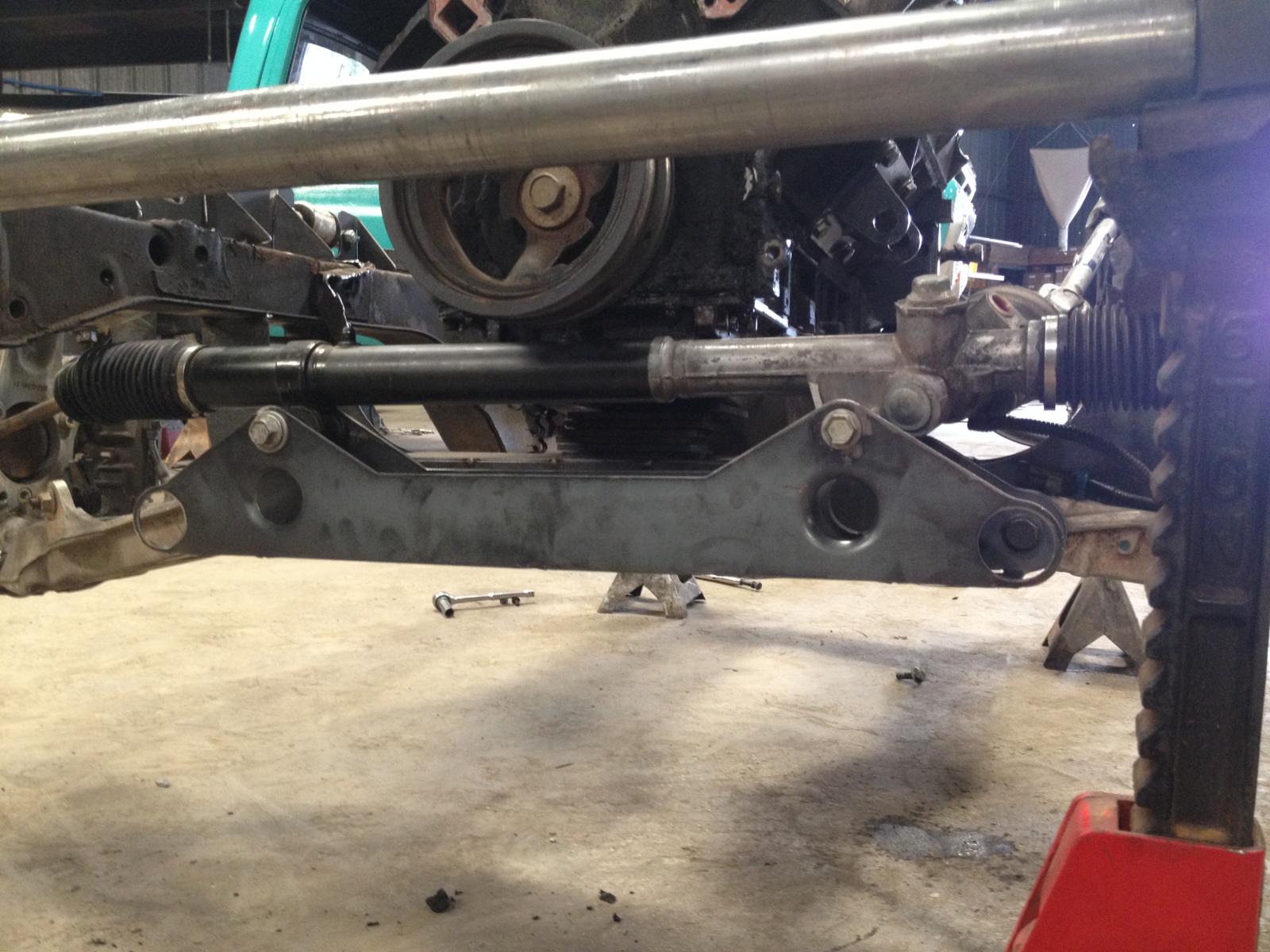

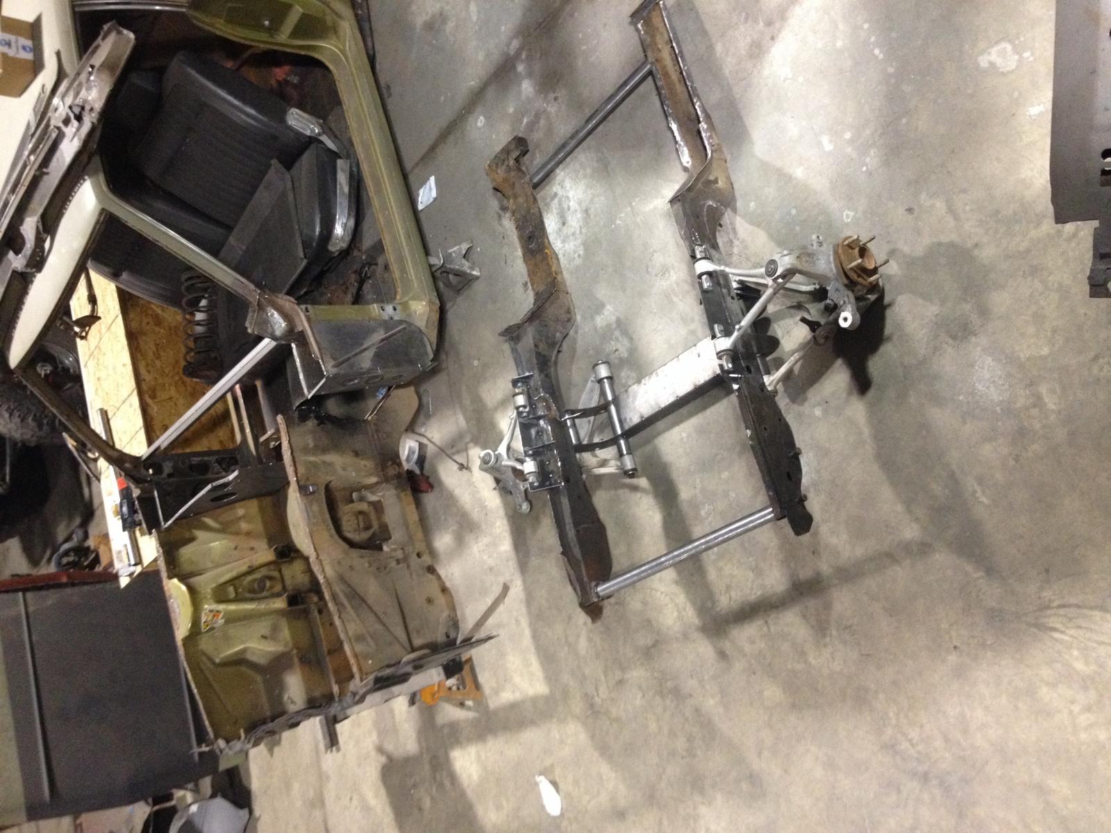

      The project started getting crazy when I bought a complete c5 corvette front suspension from my landlord for $500. I figured out all the suspension attachment points on paper and started brainstorming from there. This all started in November 2013. Oh yea ignore the -9* caster thing in the picture.
      Once I got the dimensions it was a matter of designing something that would work first and for most and also look like I gave a damn as far as craftsmanship is concerned. I used a cheap CAD program to lay out a design for a crossmember. The whole idea is to duplicate the C5 suspension as if it were on a corvette then set an AMC Rebel on top of it and fill in the gaps and what not.

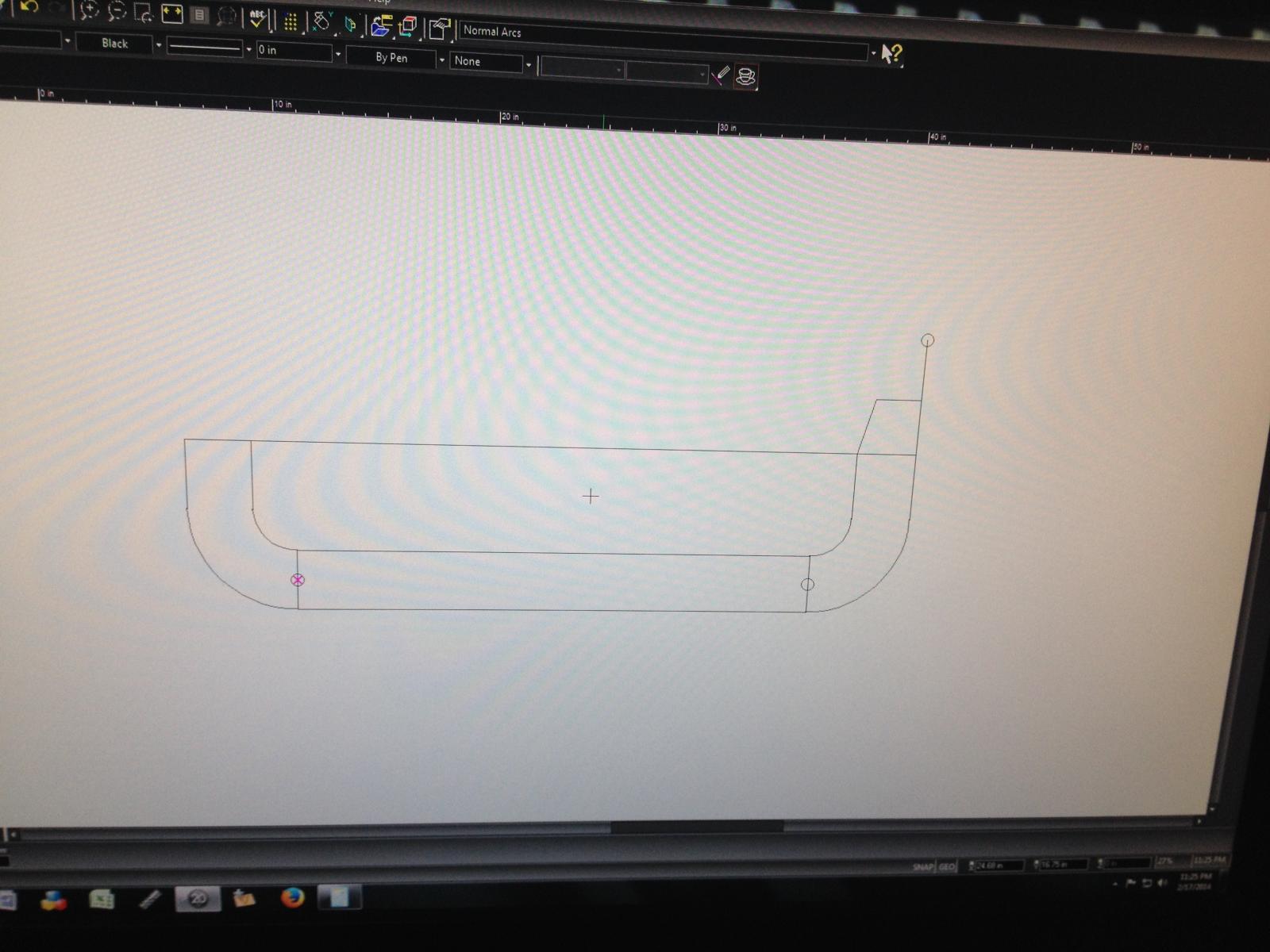

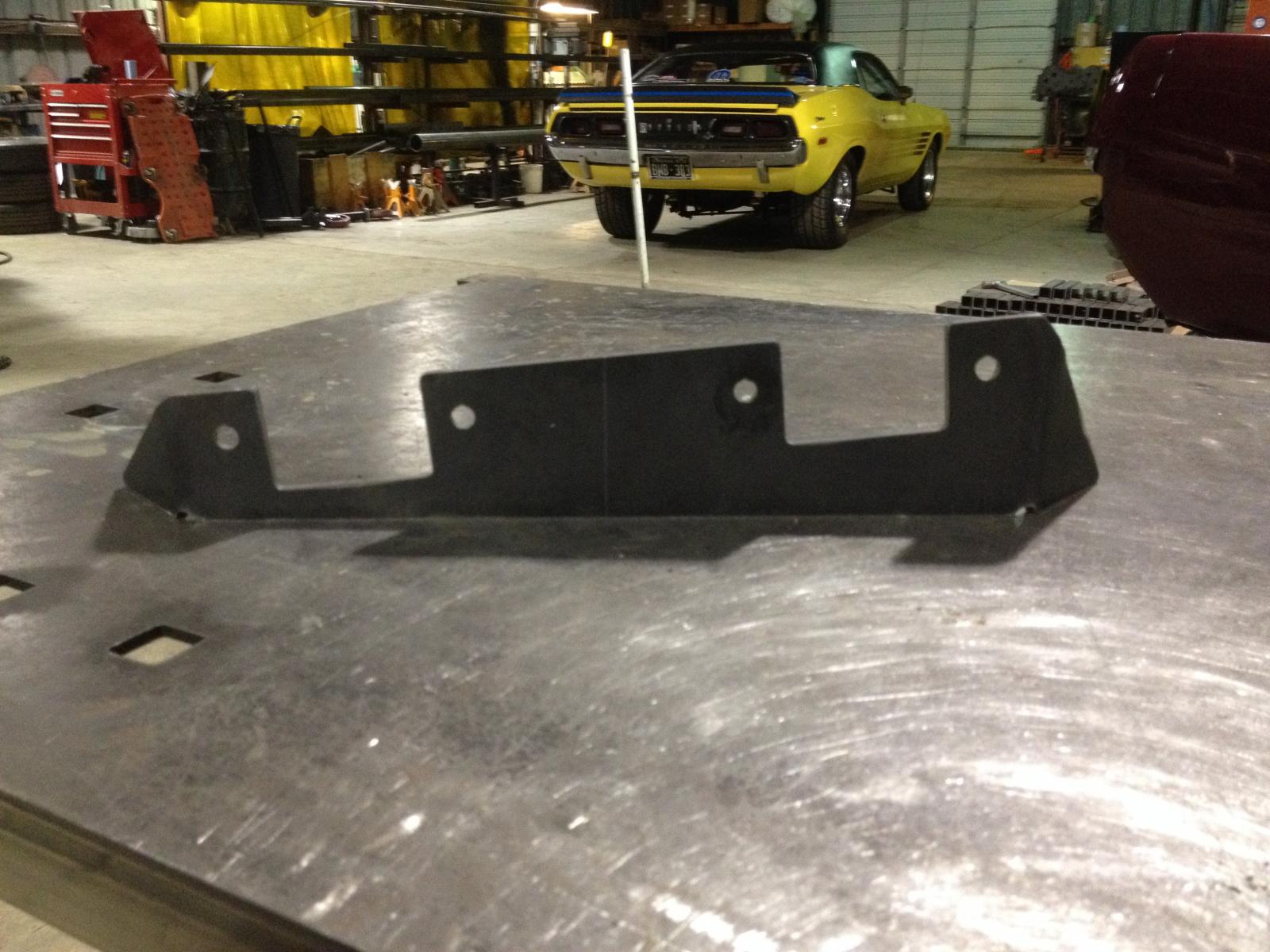

      I used the CNC plasma cutter at work to cut out the prototype crossmember just so i could get something real in my hands and start interpolating. That was a late night but this is what I came up with and it was painfully motivating.
      These frame rails are from a poor 70 something hump fender AMX, my landlord bought it for 1000 bucks with a 401 in it!! Back half of the car was JUNK so it got parted out. The frame rails looked beefier than the original Rebel's and they were the same dimensions (very minor differences)so I figured I would build the front end seperate and tuck it in the car when i was ready. FYI I have butchered 3 AMCs so far during the course of this project. A 77ish Hornet, A 70ish hump fender javelin, and (this one breaks my heart) a beautiful 69 Ambassador..Wagon. The Ambassador was in perfect shape, my rebel needed the floor, upper cowl, and lower cowl which were all perfect so we chopped it up :(.

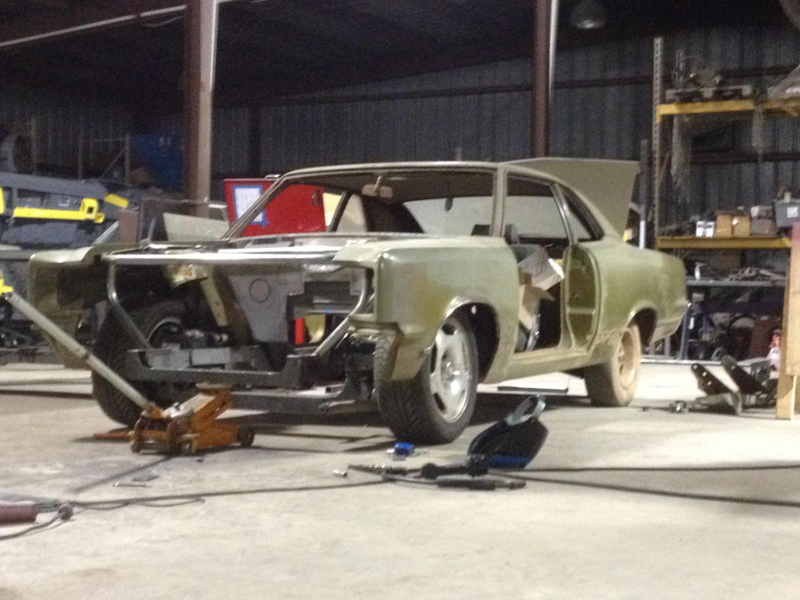

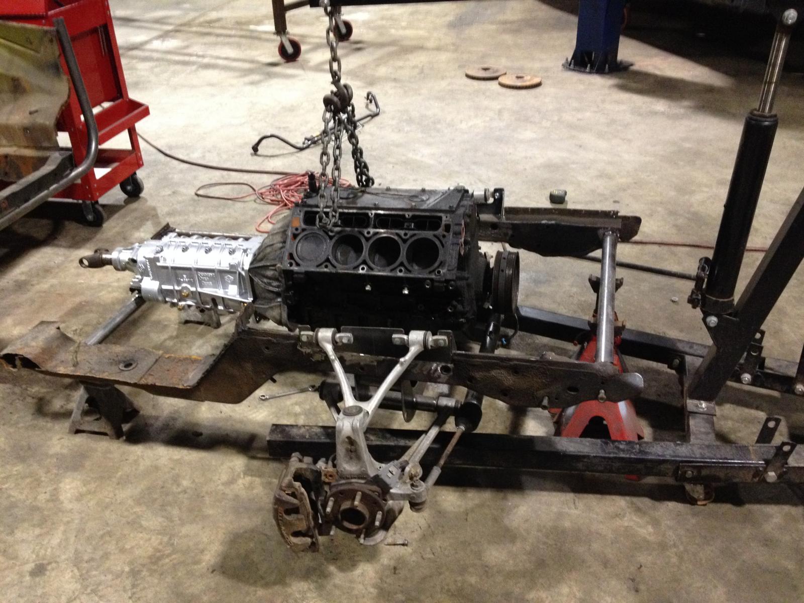

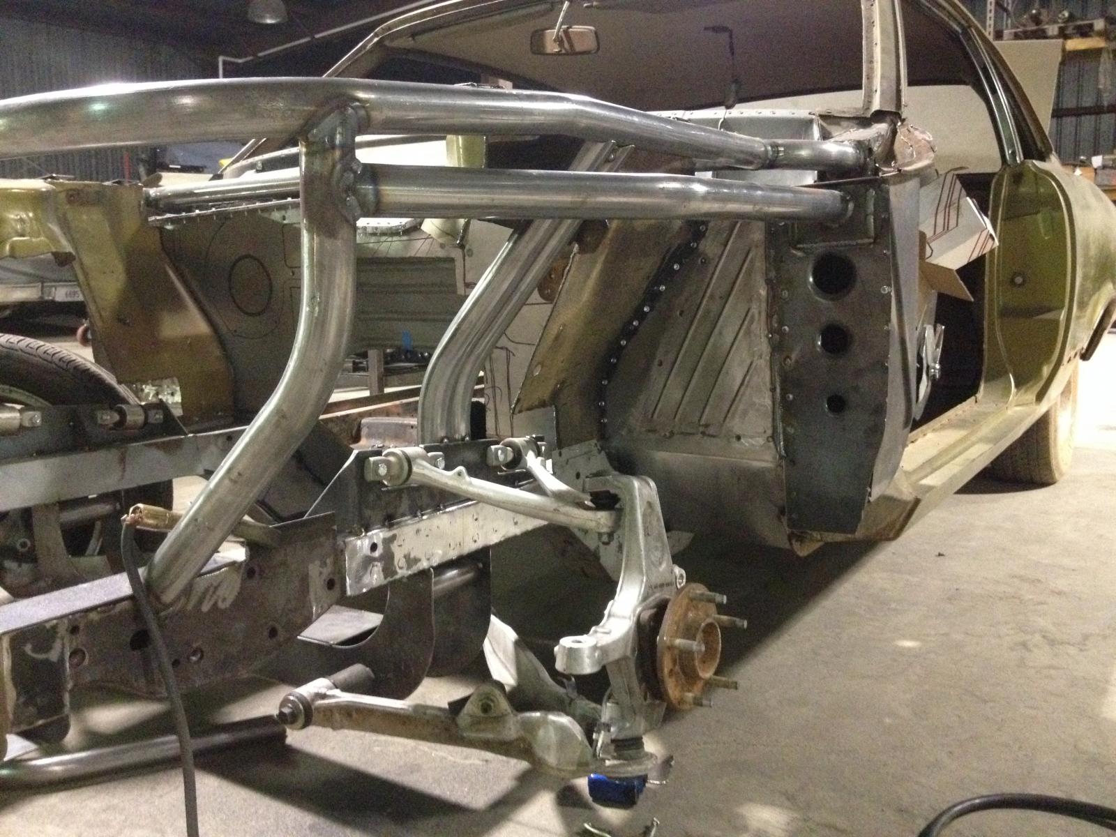

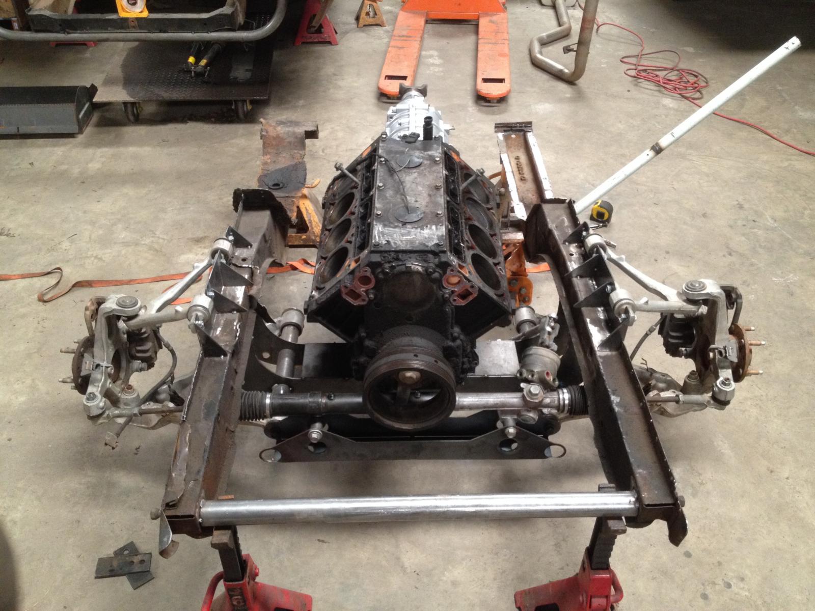

      Once I had the mock up crossmember and upper control arm brackets cut out and tacked in place I started to mock up the motor, trans mission, and the c5 rack and pinion.
      I will be a running 6.0 Ls motor from a previous project, and a richmond 6spd. In the pictures is a 5.3 I used as a mock up block. I bought the pig for $500 bucks running, wiring harness, everything. Me and my buddy layed waste to the 01 Tahoe it was in...good times.
      My 6.0 is nestled safely on the test stand patiently waiting.

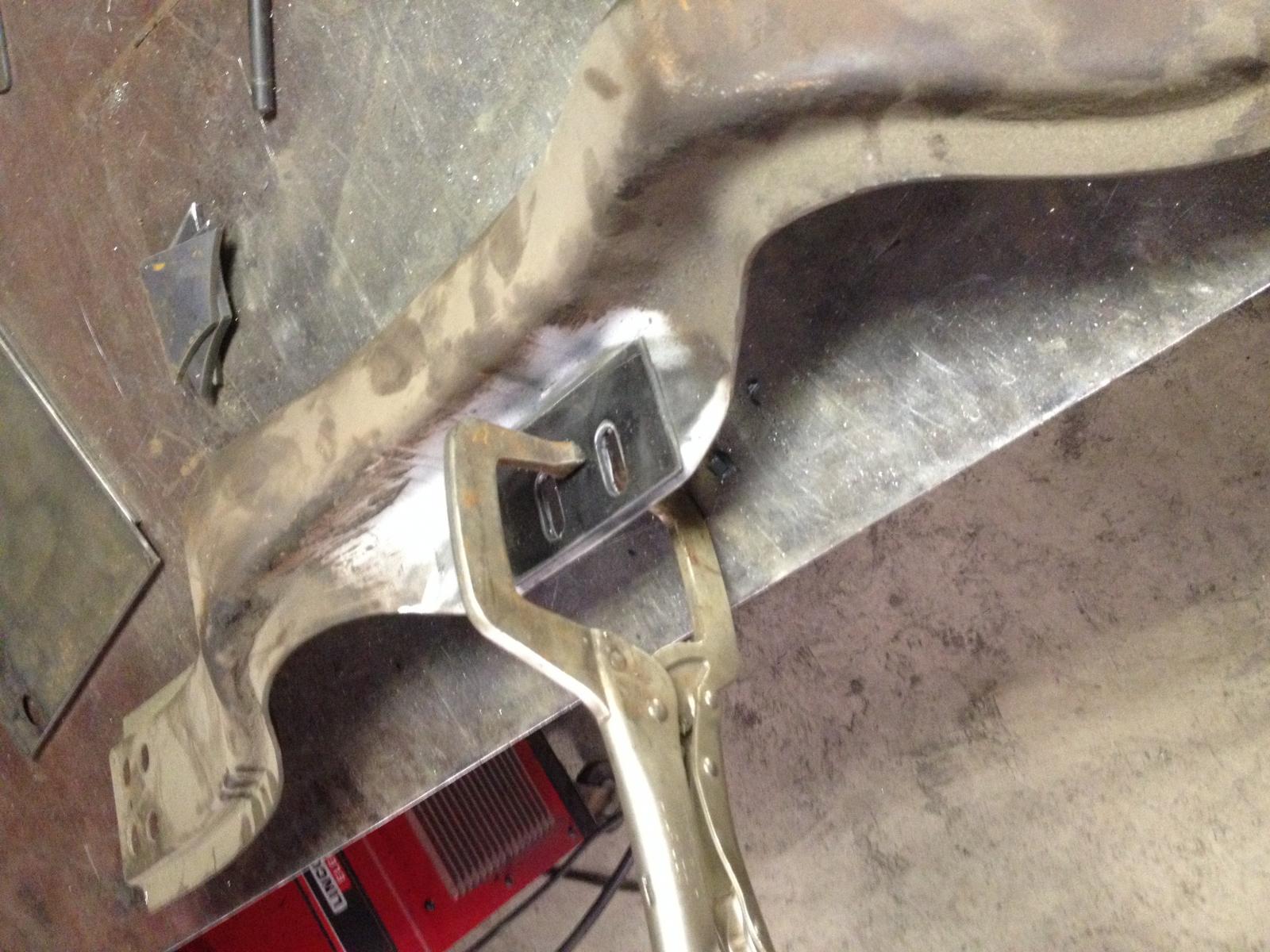

      The C5 rack has been the biggest pain. I have gone through a few of these goofy looking brackets to mount the rack and retain the C5 geometry with no success. The bracket in the picture is version 6 I think.. It worked kinda but I cheated by moving the rack forward 2.5". (not how I wanna do things) Plus all these people smarter than me started sqwauking about ackerman angle. The steering arms are so damn high on the C5 spindles. Long and the short, still muscling through this issue.

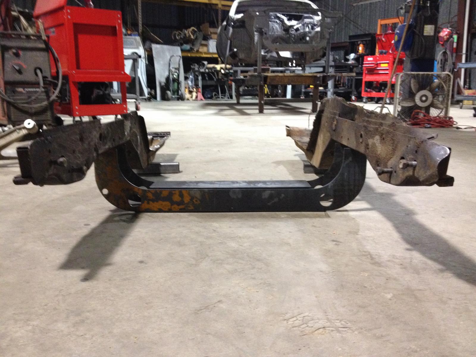

      Still havent cut out the final cross member, the one on the car was cut out of 12ga sheet steel and slapped on there for mock up purposes only. Although it is pretty strong, Im going with 3/16 plate and capping the open curves with sheet metal.\

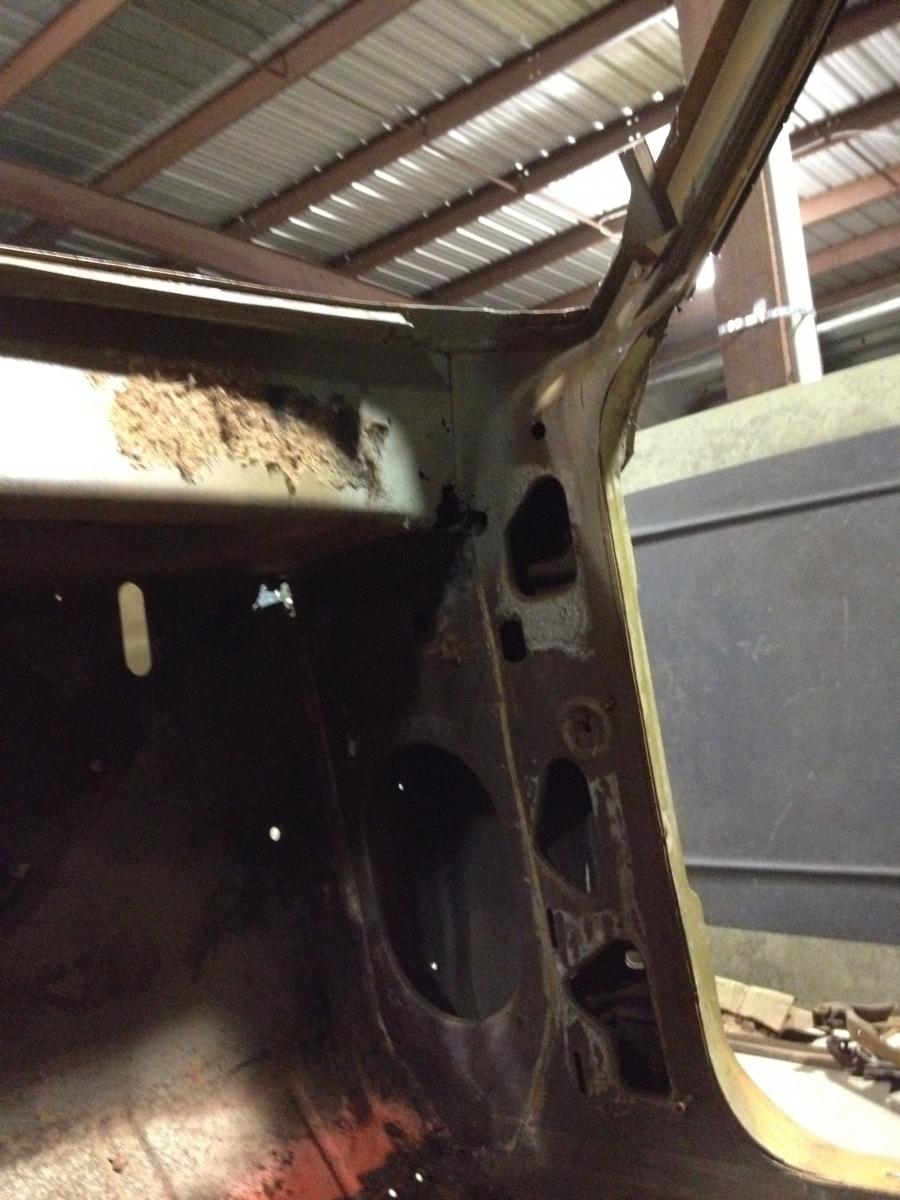

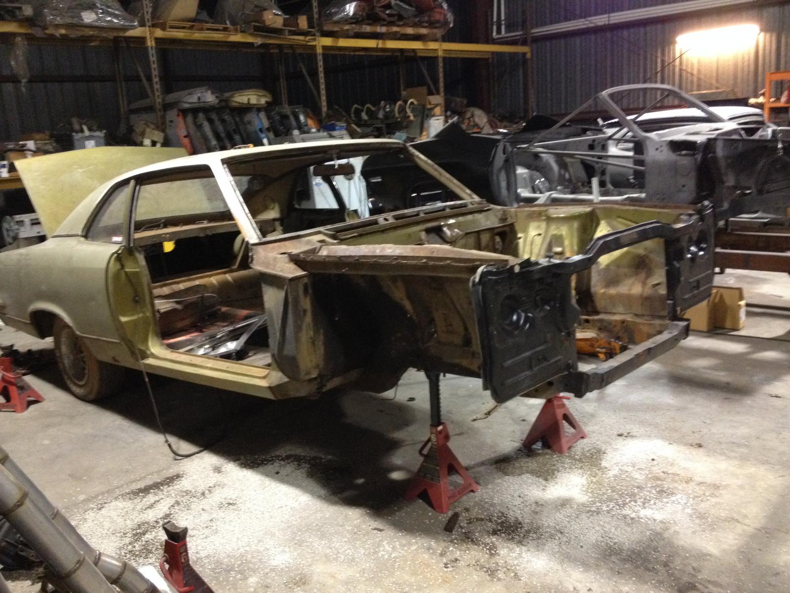

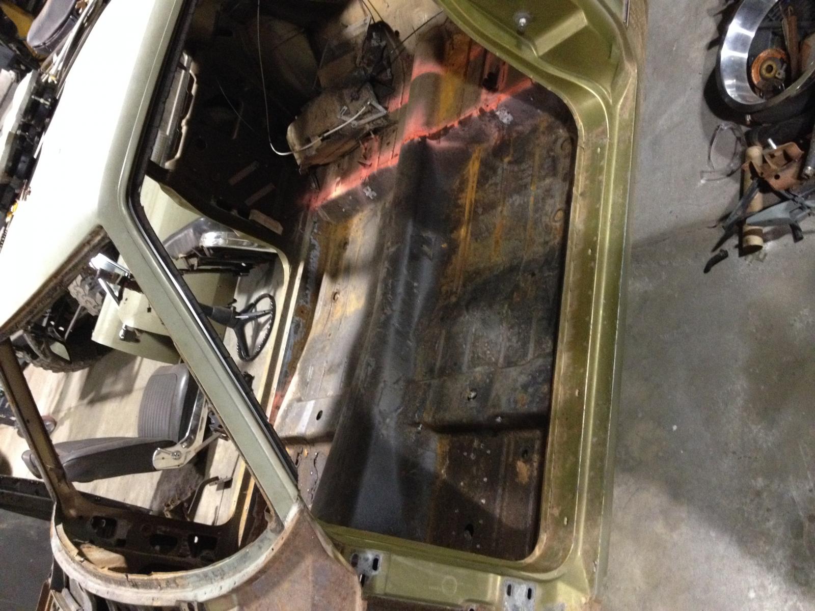

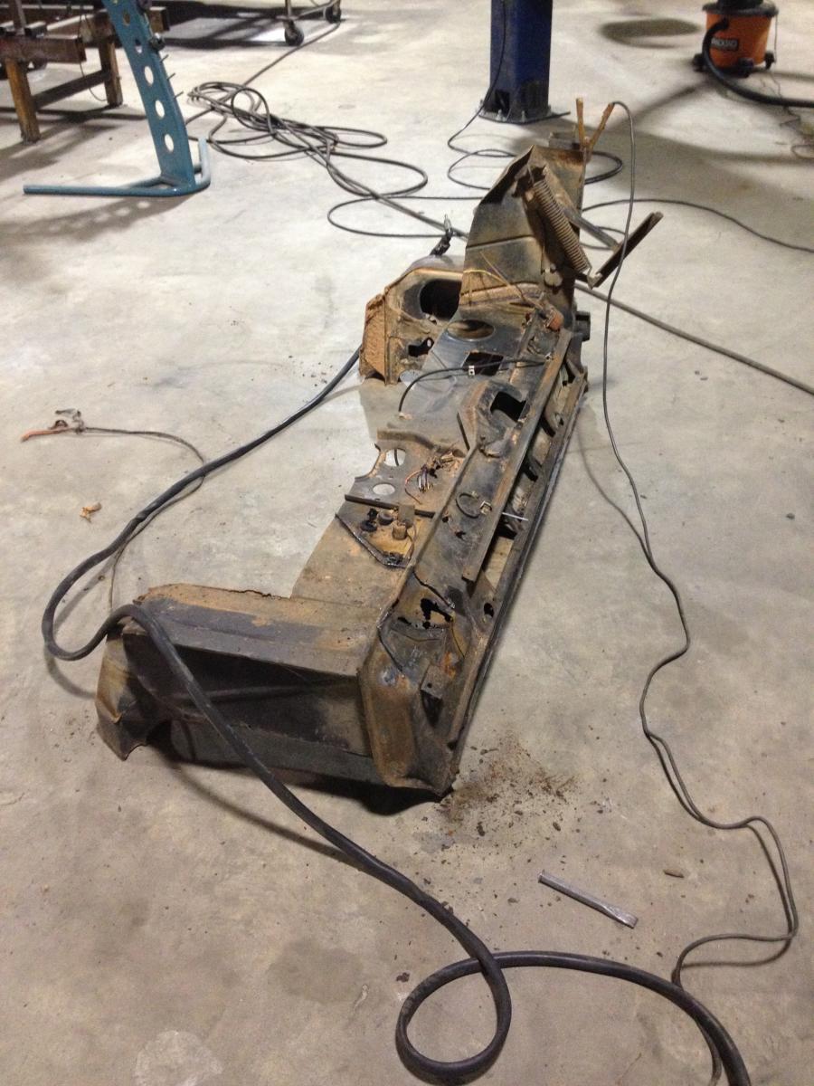

      Cowl and Firewall build
      I wanted to replace the lower and upper cowl with the perfect lower and upper cowl I ripped out of the ambassador. The firewall was a a little crummy too so I decided to build a new one from scratch. Will this car ever get done??
      Right after I yanked the motor, trans, and suspension out.

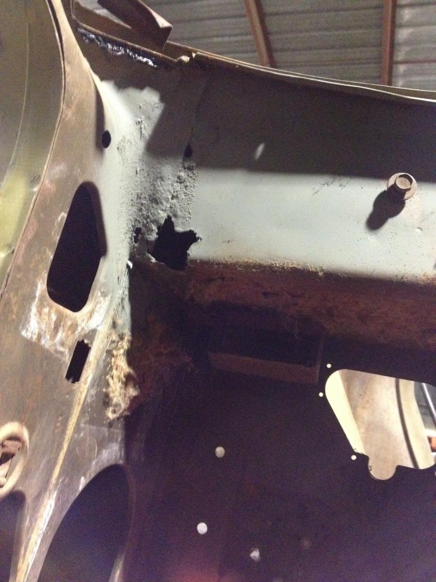

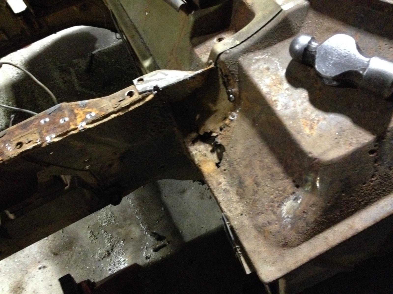

      I found more rust than I thought the car had.

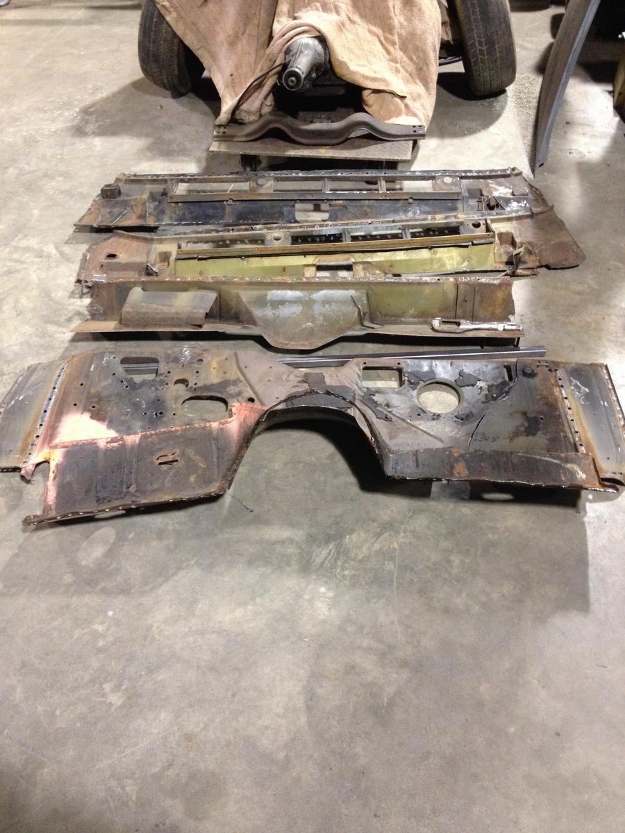

      This is the beautiful one piece floor I dissected from the 69 Ambassador wagon, Fits perfectly. Got lucky on that one.

      I ripped everything apart, after the dust settled it hit me The pit in your stomach feeling when you've reached the point of no return, and you just gotta keep telling yourself "I know what Im doing"..whether its true or not. haha. A great man told me "The car becomes junk only when you give up"

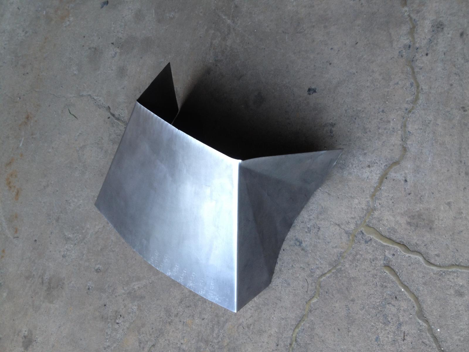

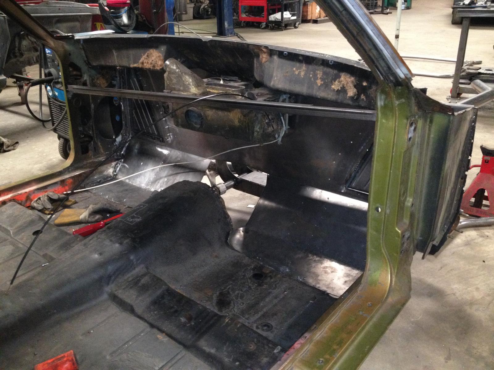

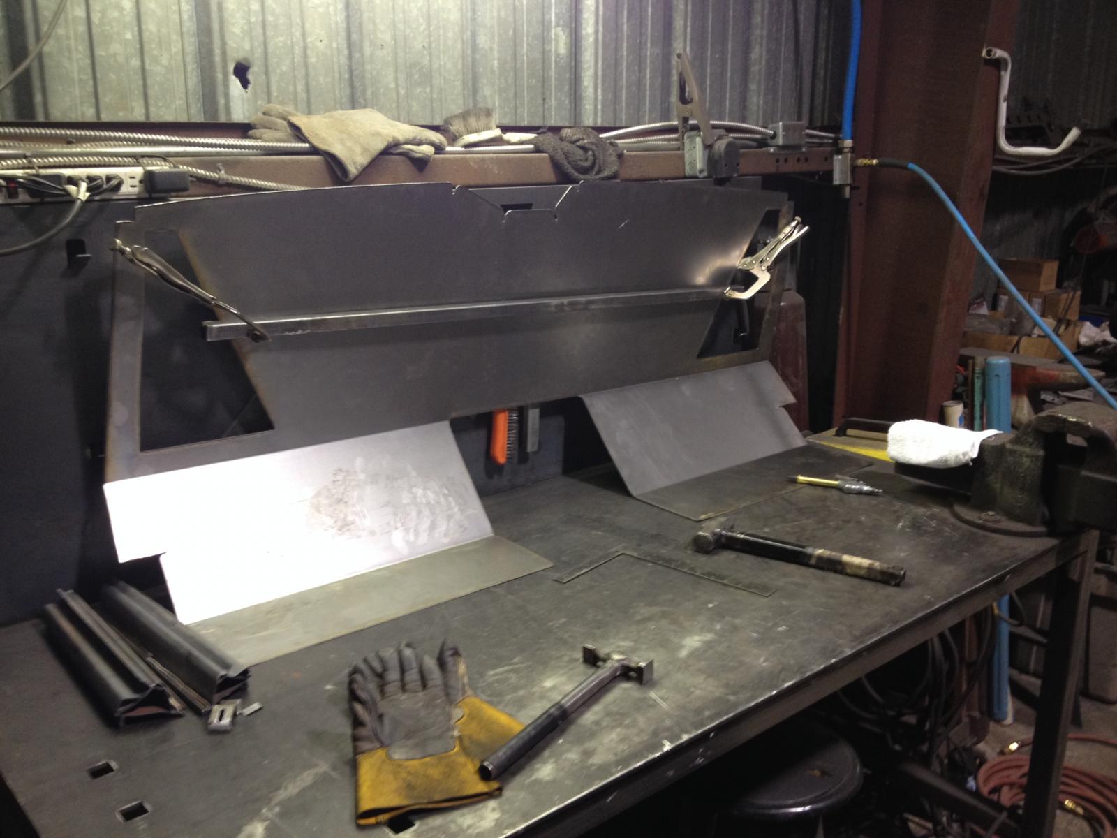

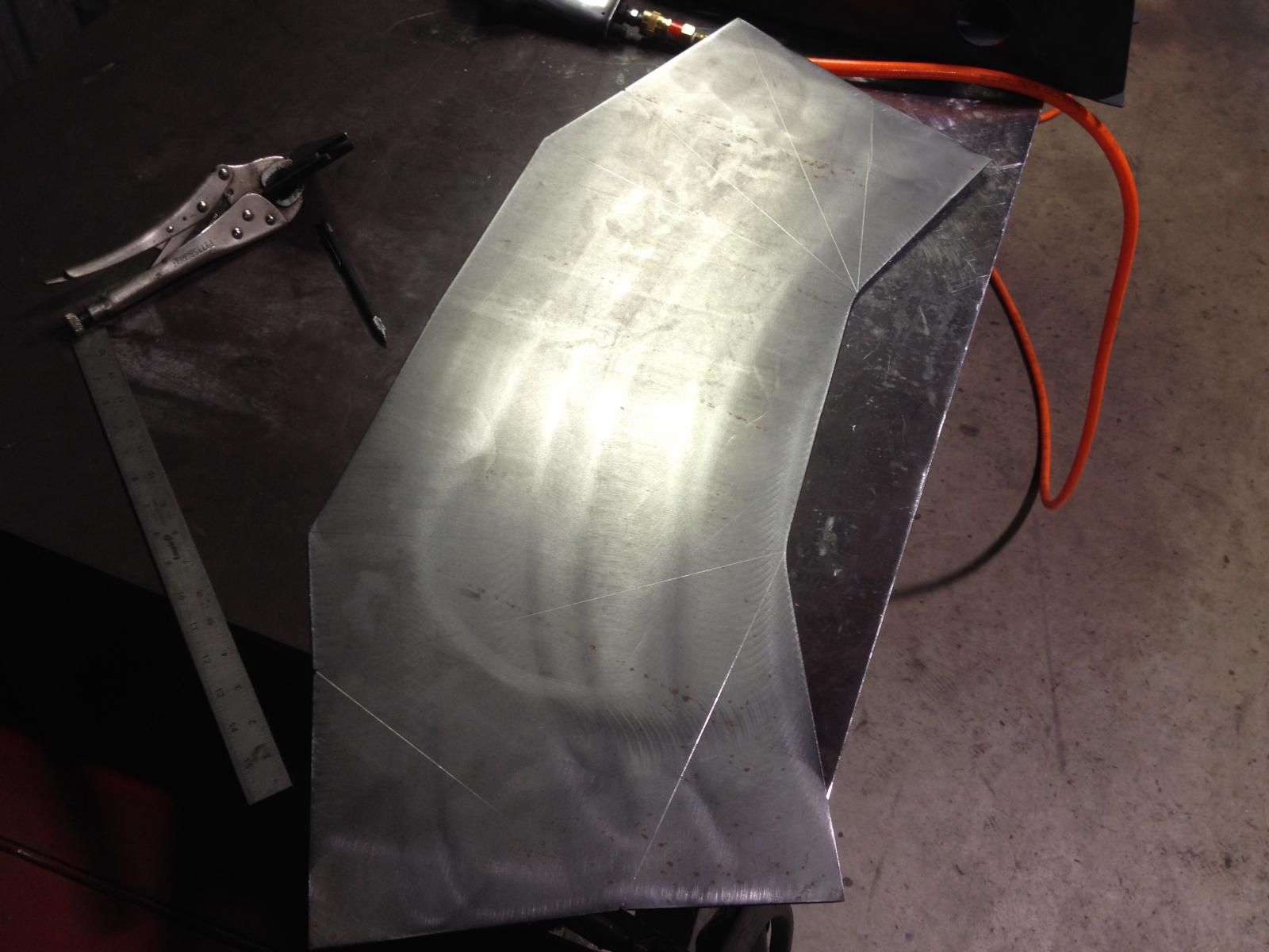

      The firewall panel has so far been the most challenging piece to make. After spending alot of measuring, looking at other peoples work, and interpolating I came up with the drawing in CAD. I wanted the firewall to be in one piece for the most part. I had to cut the notch for the trans tunnel so I could fit the panel in the press brake. I wanted to ad some bead rolls in the panel but I woulda needed 3 people to help me work it but I also wanted to get it done rather than waiting on everyone to sync their schedules. So I adapted and came up with the idea to cut out windows on the firewall and make seperate smaller panels with bead rolls to fill those windows. Worked out great. The bends were straight forward, 45 degrees, just trying to stick that cumbersome thing in the press brake and hold it on the mark was a pain in the you know what.

      Laying out where everything is going to go.
      Mocking up the AC box to figure out how big to make the recess panel.
      The recess panel

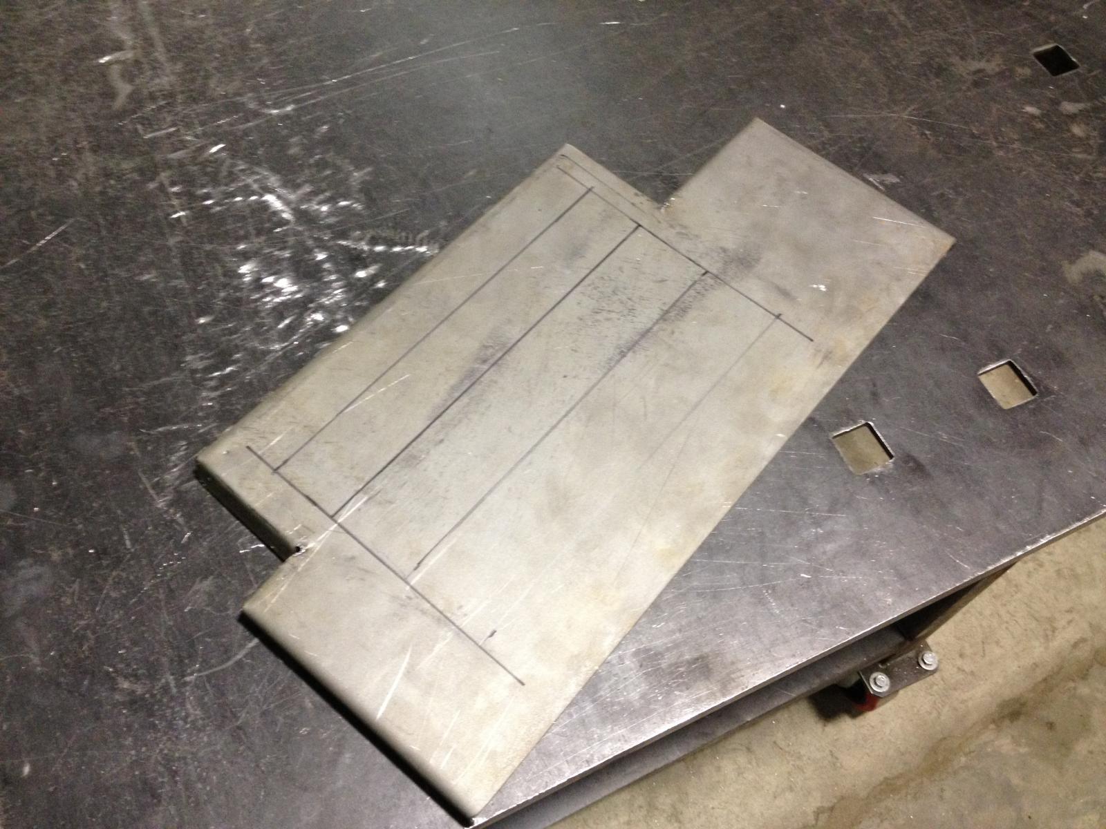

      Recess panel tacked in place on the back side of the firewall. Once welded, I will trim the extra and grind smooth.

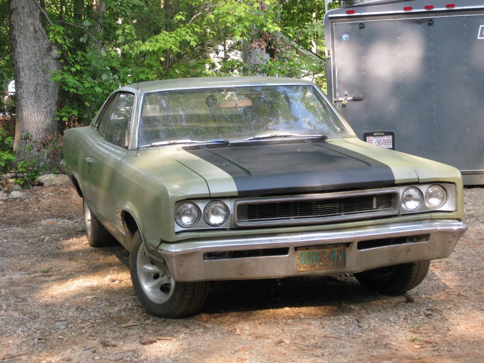

      I used to drive it around with a tired amc 360, rusty floor boards , whooped out suspension and people went nuts over it. I had one guy try to buy it from me and he didn't even know what it was. The. 67 is my favorite year. 68 they went to side marker lights and the belt buckle door handles which I'm not a fan of. I'm gonna do this car right , maybe not right away but I will have it driving for the hot rod power tour. 6.0 ls is going in it for now, and I do have a 401 for it.

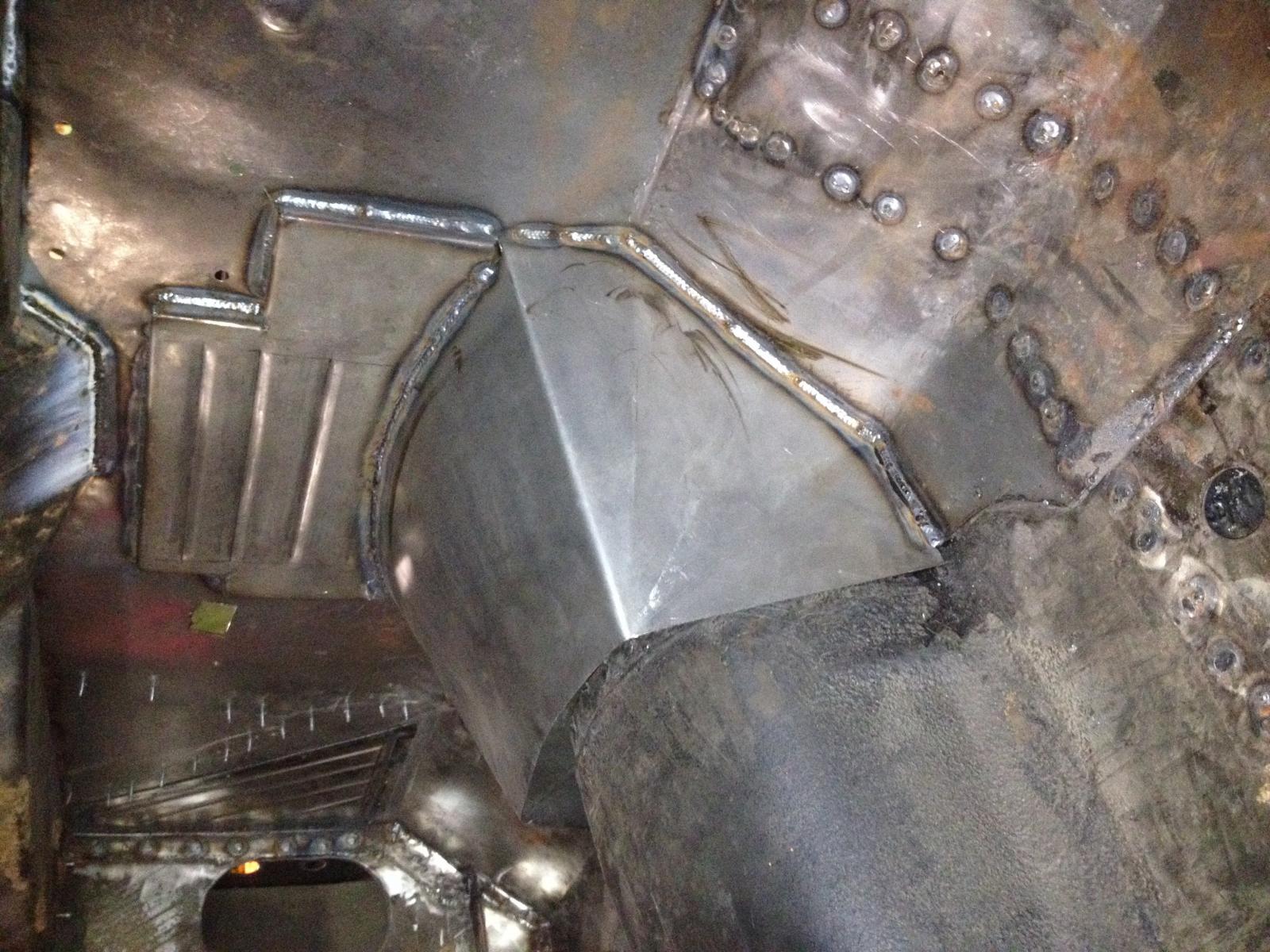

      Another late night

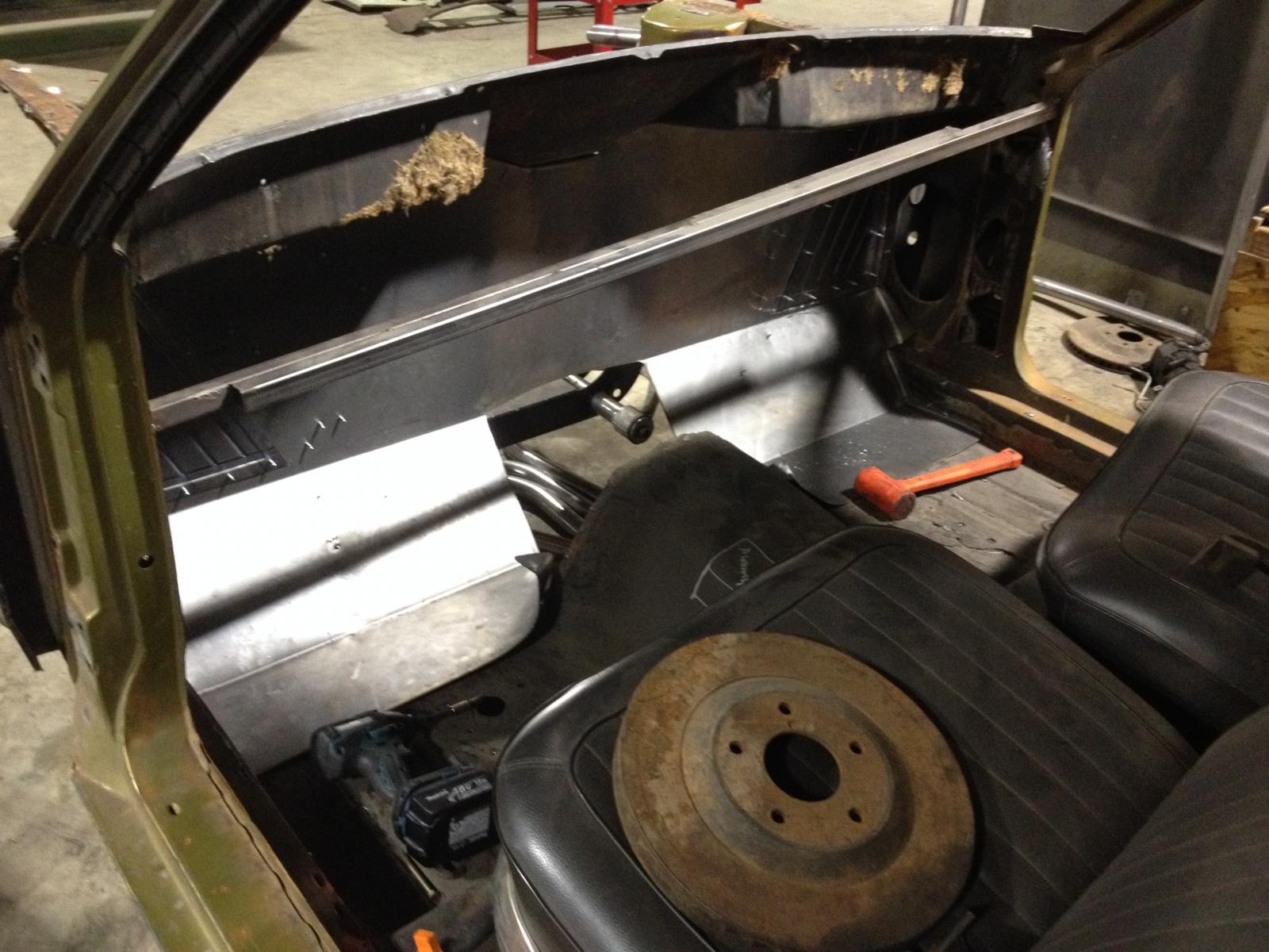

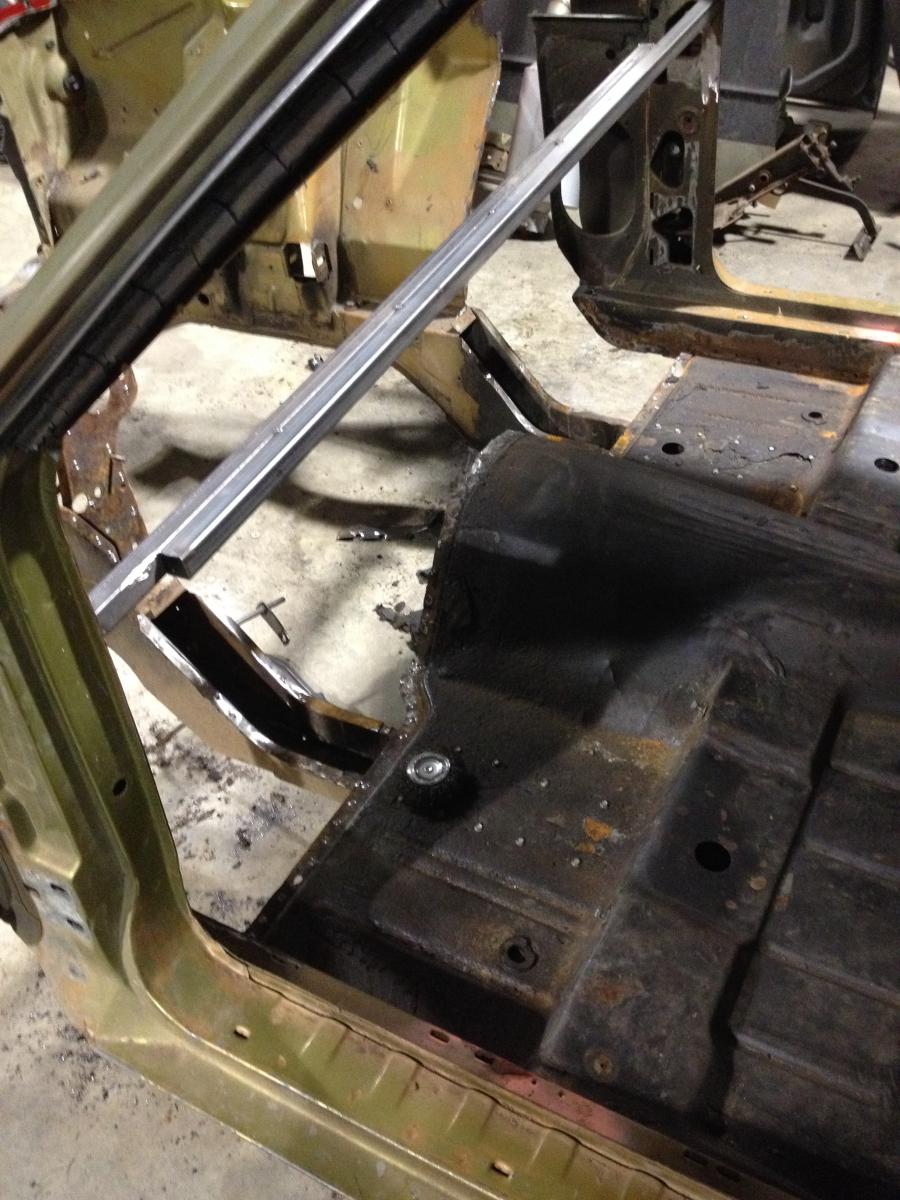

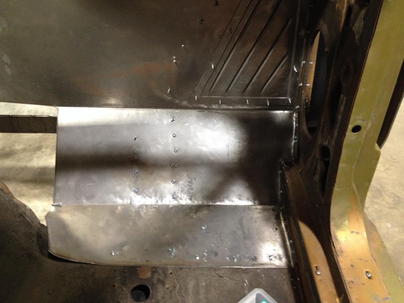

      Finally got the trans tunnel made and halfway welded in, still needs some touch ups and two smaller pieces made. The tunnel was made out of 16 gauge and really ties the firewall together. Subframe connectors are coming up soon.
