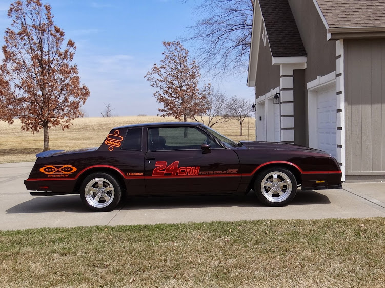

      When Ron Sutton first started helping me with my suspension, one of the first things we did was put zip ties on my shock shafts and ran an event measuring how far the shocks traveled during a run. Choosing my ride height was more of a function of suspension travel than aesthetics. While a lowered stance may look appealing, if the suspension is bottoming out over bumps or is so stiff to keep it from bottoming out due to short bump travel, handling and comfort will be lacking.
      The lowest I've had my car was 25.5" F 26.5" R at the center of the fender wells. At this height, my front shock was about 3/4" from bottoming out. With my new setup (including re-engineered shock mounts front and rear) my fender wells are at 26.5" F and 27.5" R and I have over 3" of bump travel at the shock from that static ride height.
      I guess what I'm getting at is each situation is different, there is no "correct" answer to your question. Putting the whole package together takes some time, thought, and reality checks about what you really want the vehicle to look like and how you want it to perform. Then, how much work and expense do you want to put into it to get it there. Extreme lowered rides look great and perform well...if they've got the suspension setup to still travel even with the lowered static ride height.

      I just measured my car in it's current state for someone else asking for frame height measurements, so I thought I'd pass them along to you as well in case it helps.
      Bottom of frame to ground at #2 body mount is about 6", Bottom of frame to ground at #4 body mount is about 7".
      That puts my fenders at 26.5" F and 27.5" rear measured directly inline with the spindle\axle to the bottom of the fender lip.
      I measured this out in the parking lot, not a perfectly level and square alignment rack...so take that for what it's worth, but it might help steer you in a direction for helping to start mocking up your bare frame.
      Lance

      Your car now has a 26.5" F and 27.5" R at the fender wells? Wow, it sure looks lower! Must be the wheels and tires give me that illusion (looks good!). What size street tires and wheels are you running? ...
      I'm running 275/40/17s on all four, they are just under 25" tall with a load on them. I just remeasured and the front fender is at 26.25" and the rear fender at 27.5" sitting here in the parking lot at work.

      Actually it isn't that uncommon for the fronts of these cars to sit higher than the rears and if you've been hauling things in your bed you mave have squished the coil springs even more with the weight over the years. If I remember correctly, stock height on my fenders was in the 28" range too.
