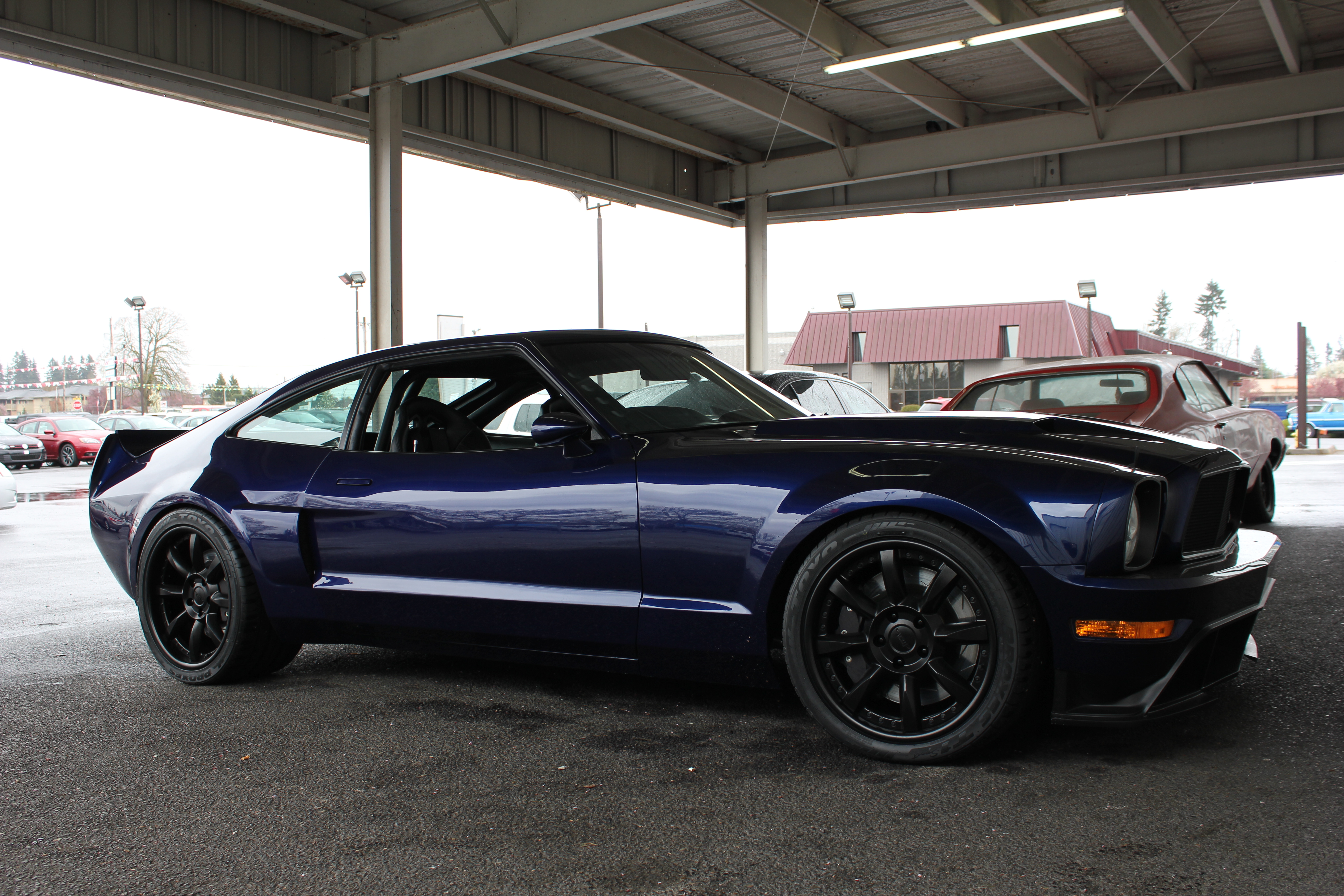

      I've always thought the proportions of the car were good but the front wheels needed to be pushed forward. They did that on this custom build and IMHO is a large part of why this one looks so cool:
      http://www.stangtv.com/features/car-features/a-mustang-ii-we-can-all-respect/

      The best car to build is the one you have. I love the Mustang II and think they are way too overlooked. This is still one of the coolest cars I have ever seen. Would love to know who owns it or more information about it.

      Same with me. That is one bad ass looking Mustang II. I have thought about building one myself. My wife's first car was a MII.

      Definitely need the larger tires and wheel arches too. Any thought to lengthening the wheelbase by pushing the front wheels forward?

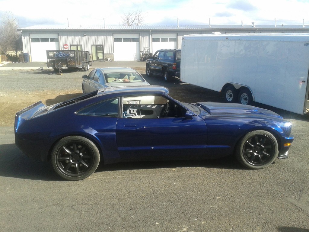

      Just don't go as far as the Mustang Evolution SEMA car did. I love the car but the wheelbase stretched too much in the front for my taste. I would have moved it a couple inches in the back and 5 to 7 inches in the front.

      that Evolution looks bad ass
