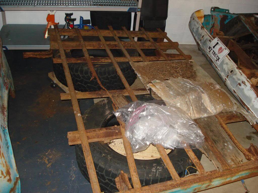

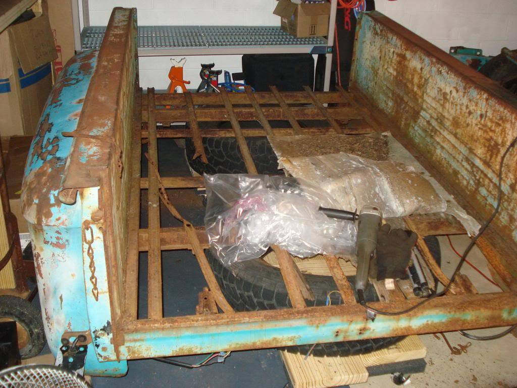

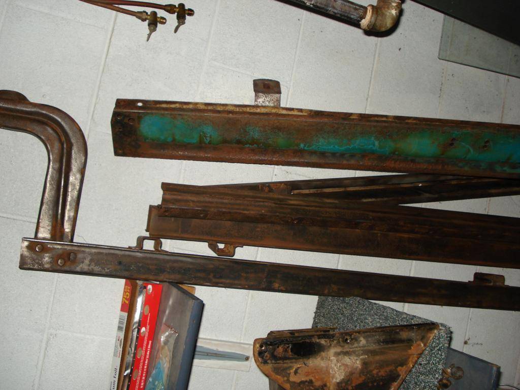

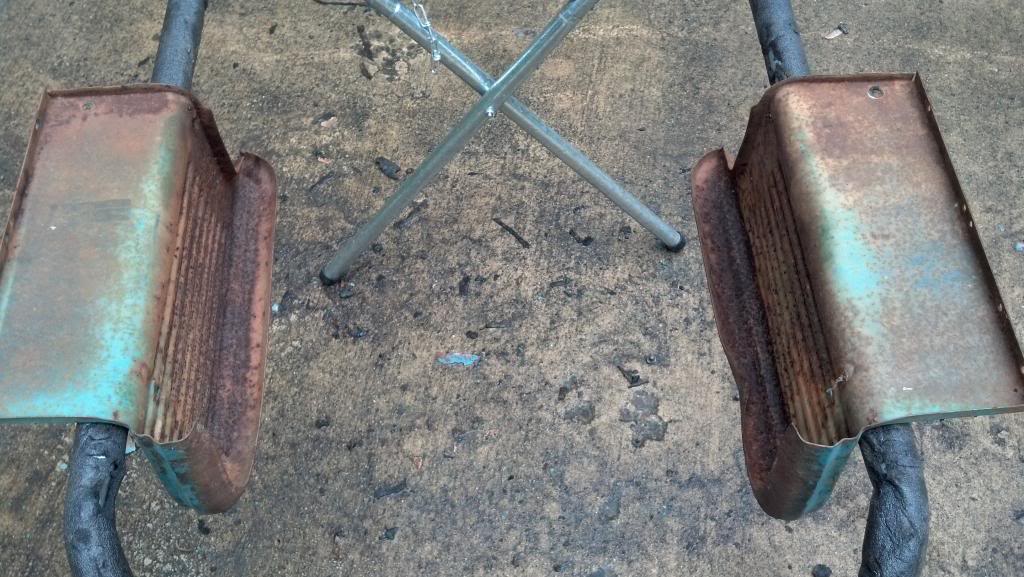

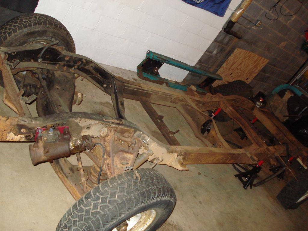

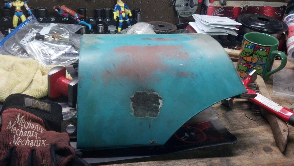

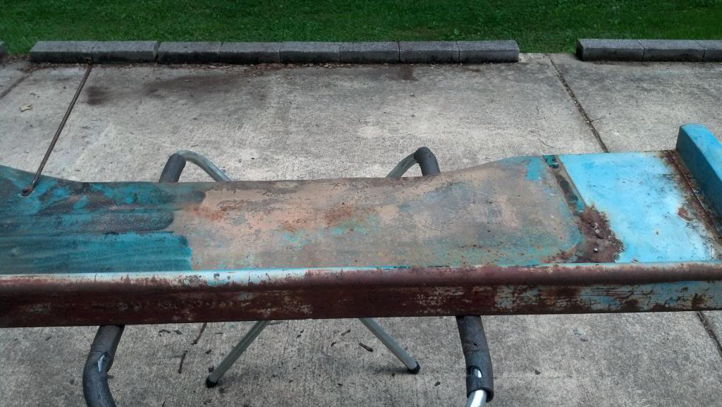

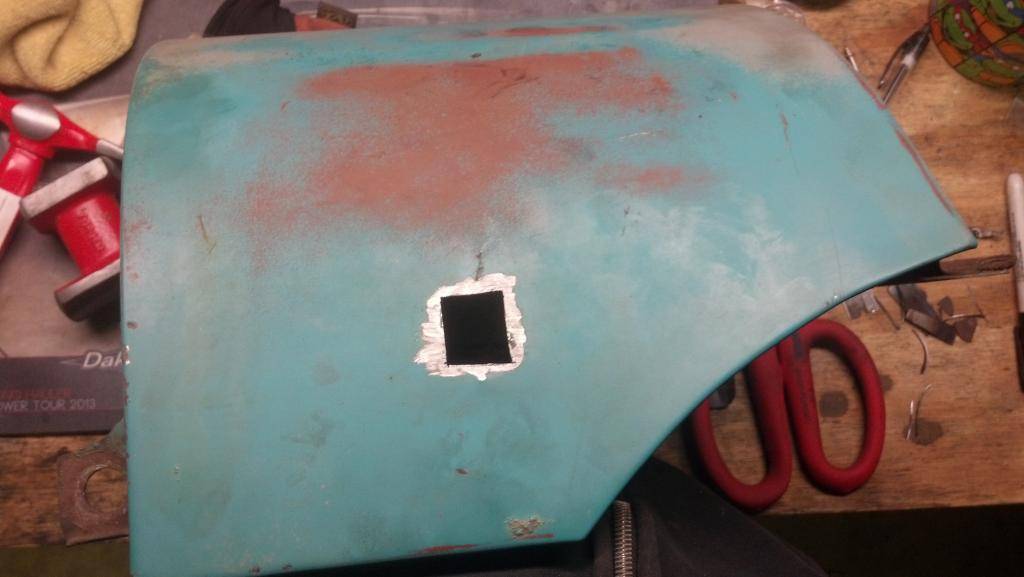

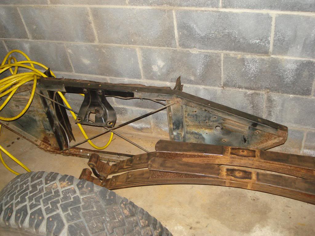

      some updates from about a month ago
      been slowly working on disassembly and cleanup. hard to take pics when covered in 51 year old dirt and rust- but here's what I got this weekend. I fully all the bed parts and proceeded to wire wheel all rust. bed rails will be blasted soon as well. I will be undercoating underneath the fenders and the bed rails. after I clean the parts with the wheel I go back by hand with a scotchbrite pad and CLR.
      kinda what I started with

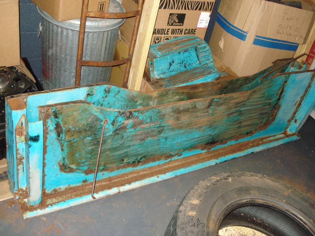

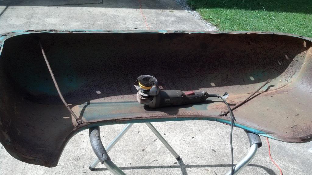

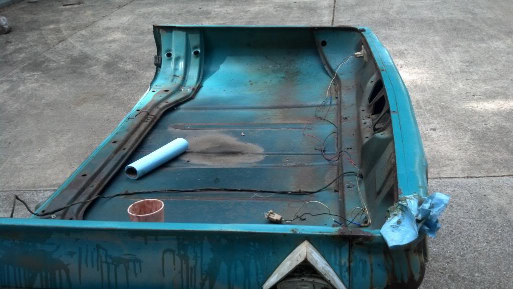

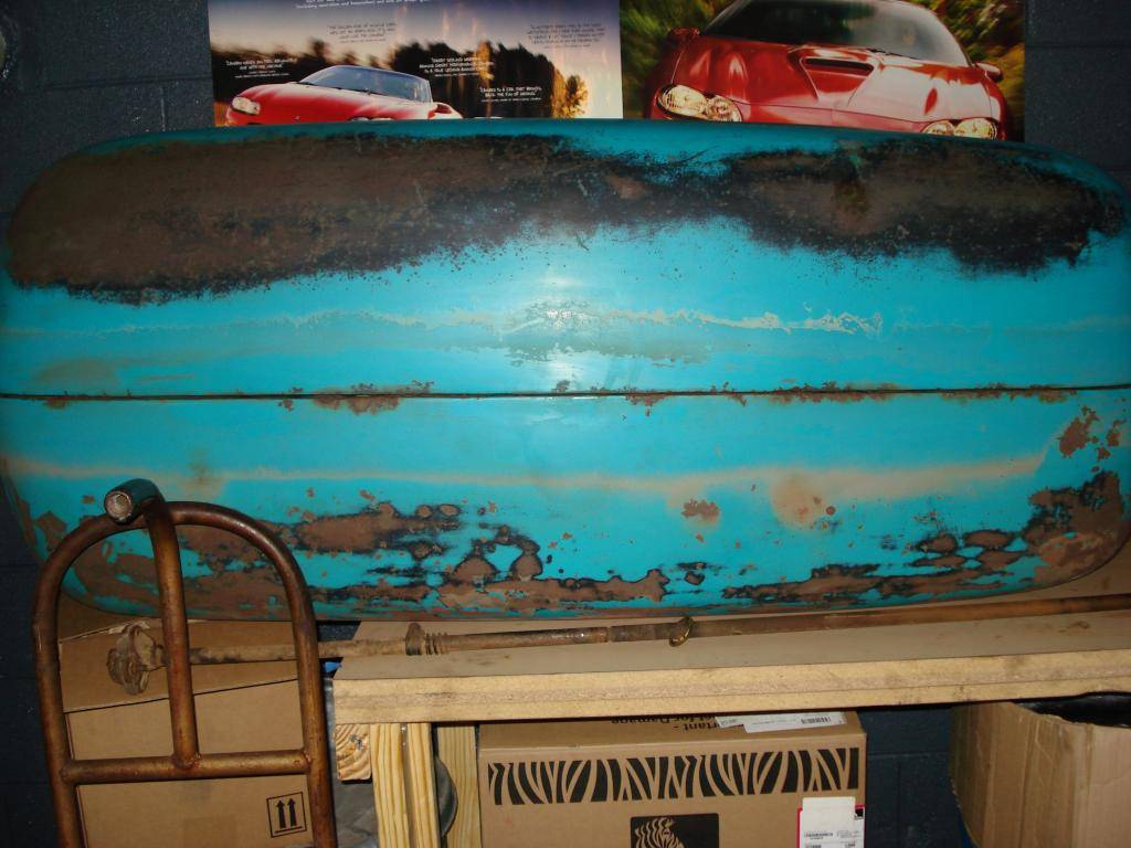

      cleaning outside of bed panel-going to undercoat the portion covered by the fender also
      comparison shot of how the inside of a bed panel looks after scotchbrite and CLR vs before
      underside of steps before cleanup- soon to come with afters
      I will get some aftershots together real soon. I've done a ton of work since these pics just haven't gotten any new ones yet.

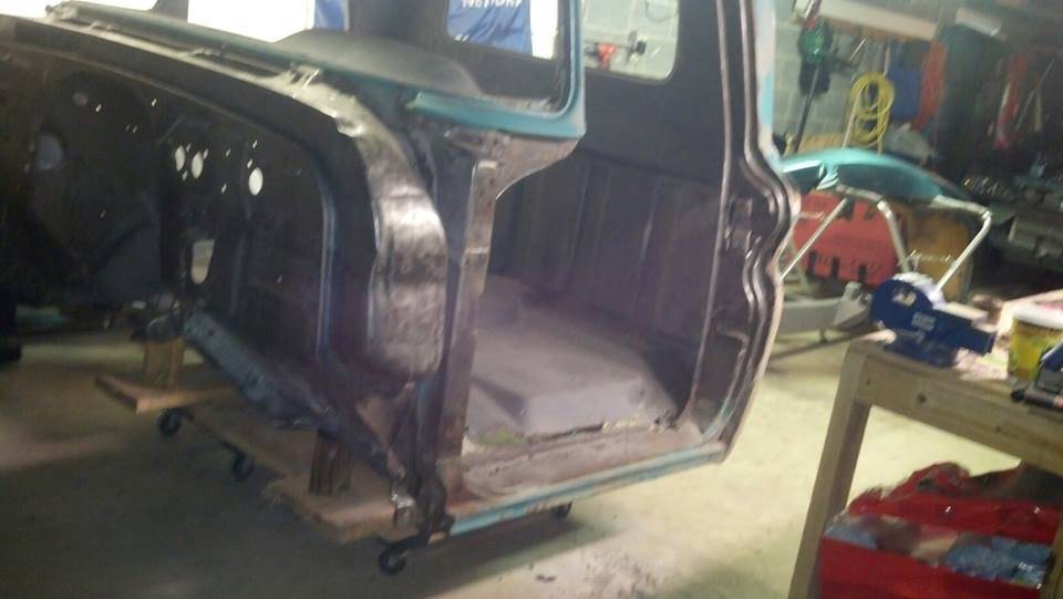

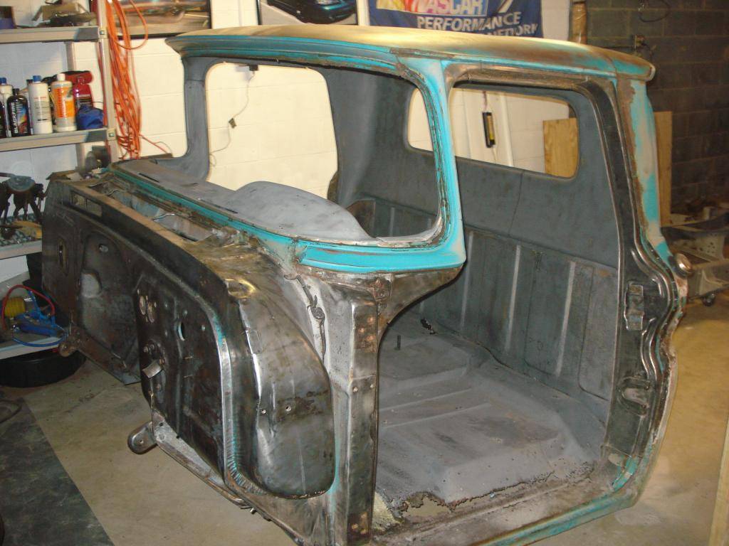

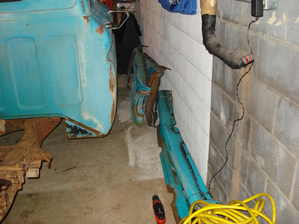

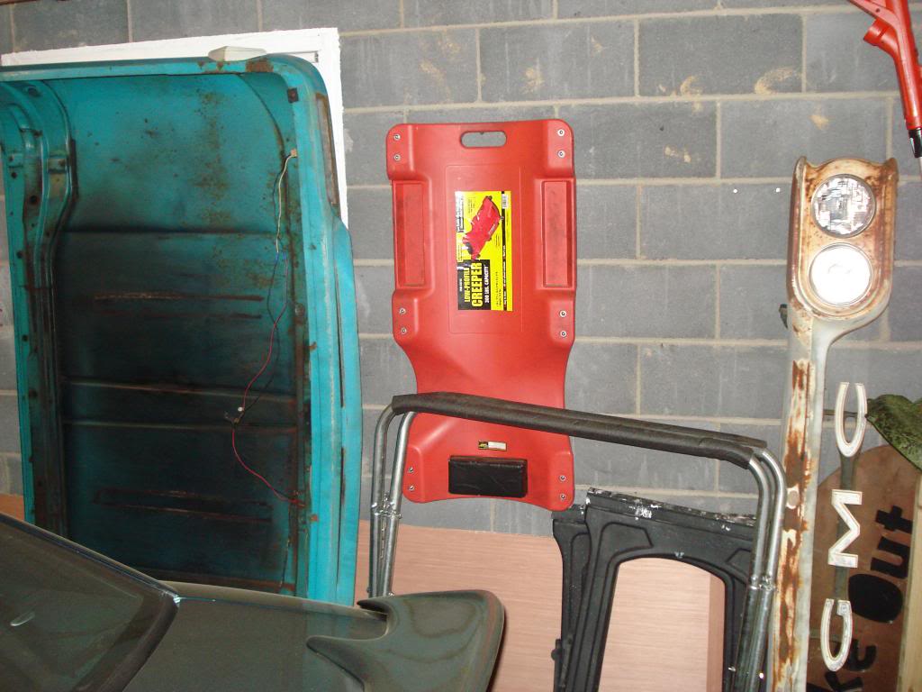

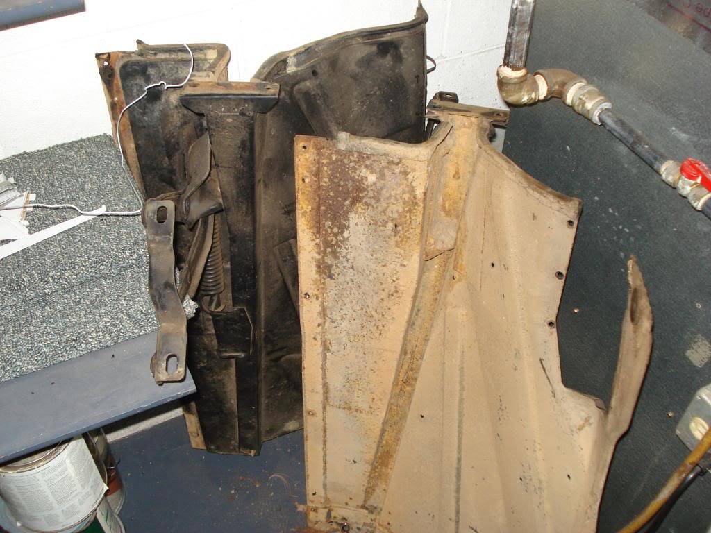

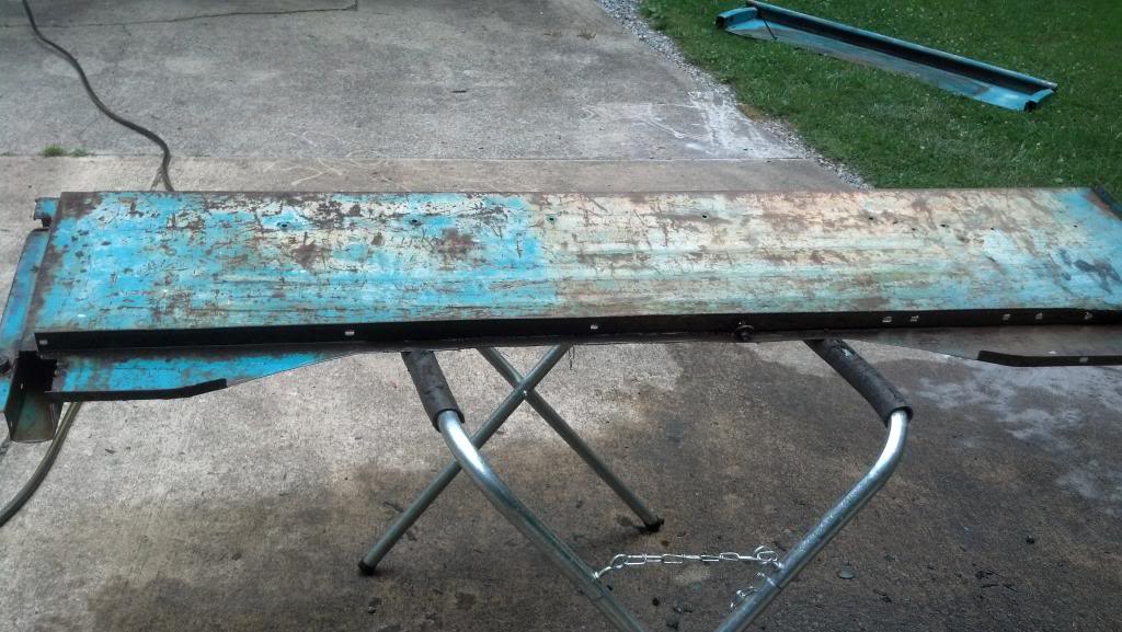

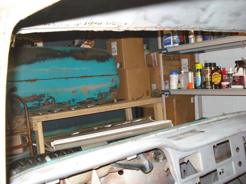

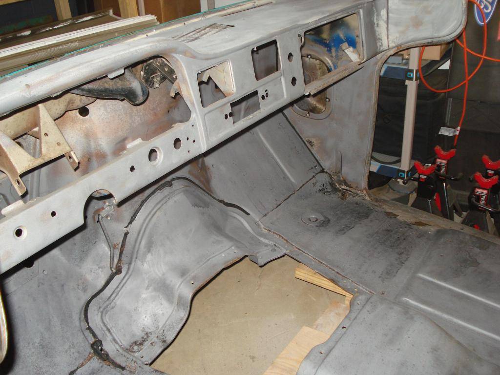

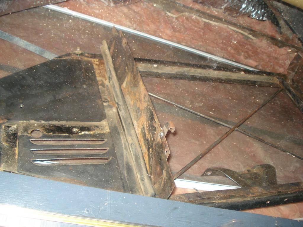

      slowly stripping parts and putting them back in the air conditioned garage. some ssurface rust comes back but much easier to clean (and quicker) than some of the stuff I've been cleaning so far. here's the interior door panels
      and the door with all glass and window tracking taken out- soon to strip the inside of the doors leaving only the skin still painted. I will be painting all parts that I completely strip so when you open the door it'll be like a brand new truck on the inside but old on the outside

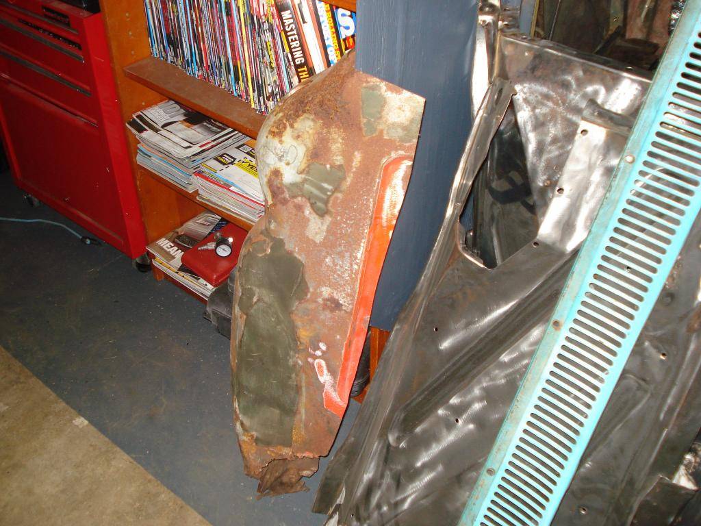

      core support- getting more surface rust here than I'd like so I'm going to do something about that until I get all my painting ready to go- like the inner fenders that I've stripped as well it'll all be painted seafoam green and cleared

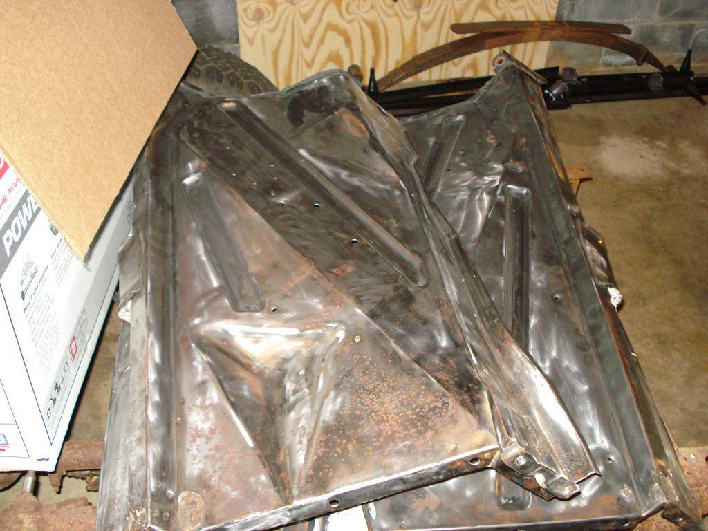

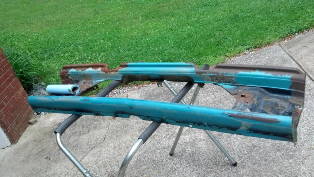

      bedsides and rear fenders that I've wire wheered and scotchbrited with CLR. The large majority of it will be clear coated but the portion of the bedsides that the rear fenders cover, and underneath the rear fenders and steps will be painted with a hammered dark green paint. gonna be cool and match the frame as well

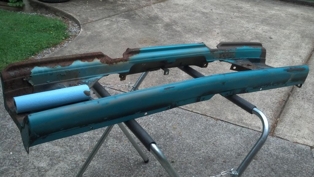

      bed rails all clean (may not look like it) and will be painted hammered dark green

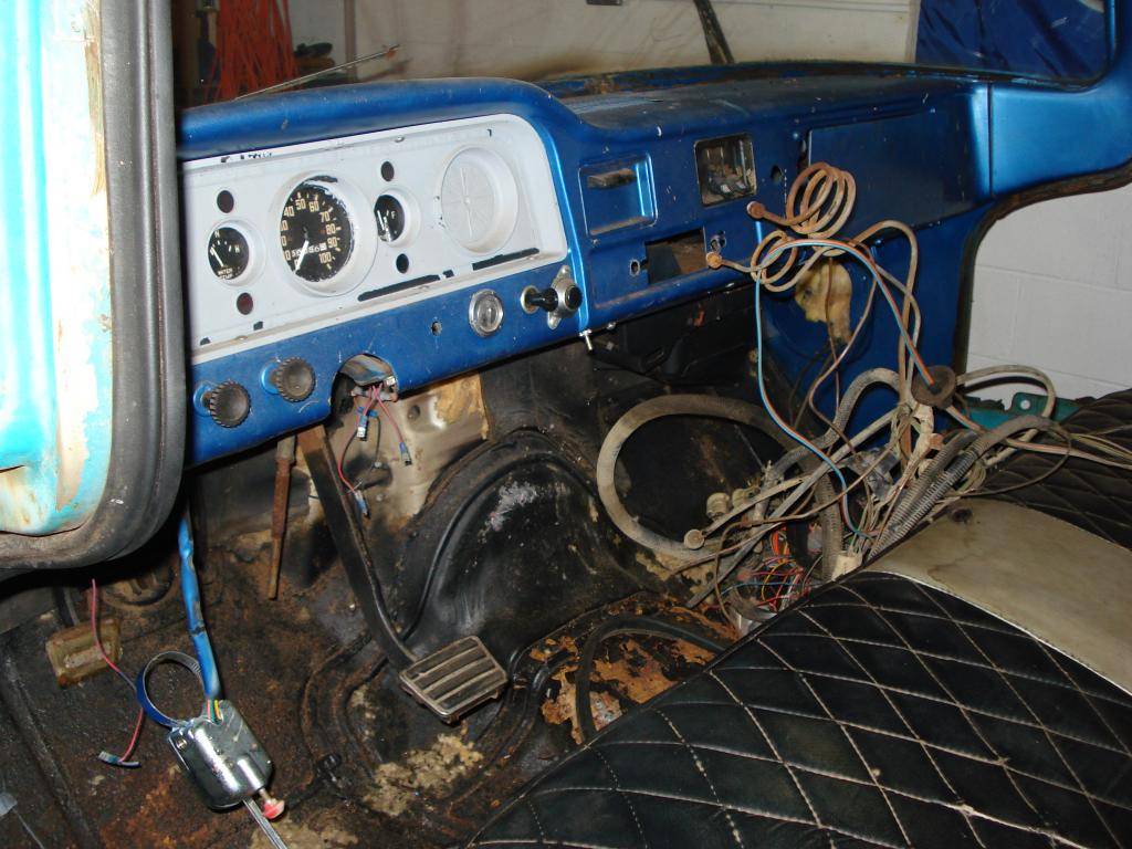

      got the steering wheel off, and ebrake and steering column removed- cab is finally ready to fully come off the frame

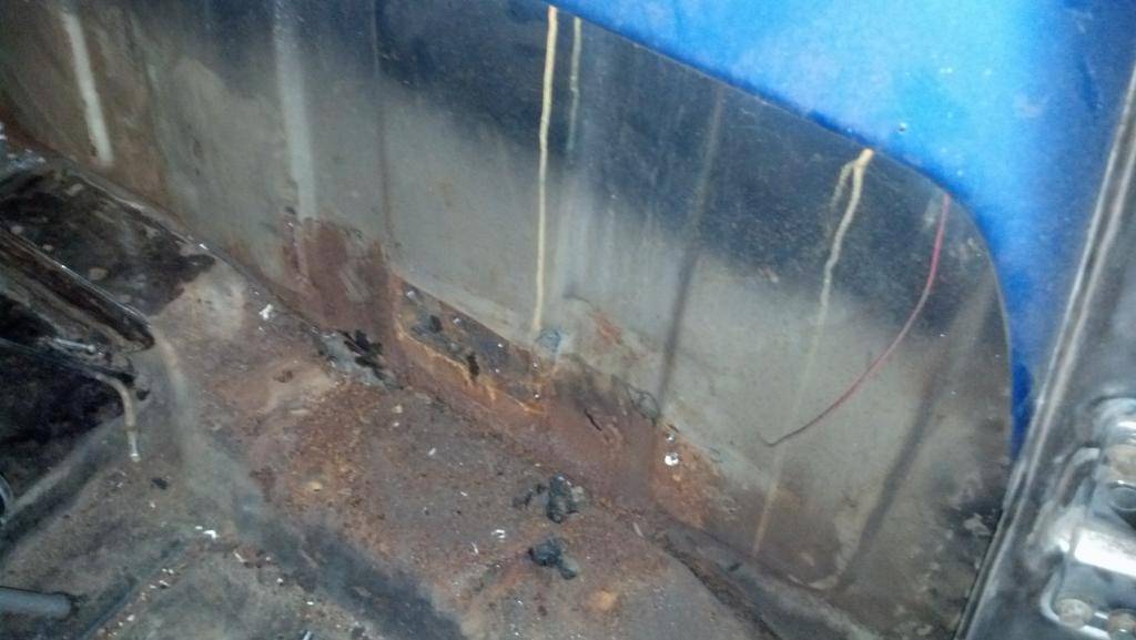

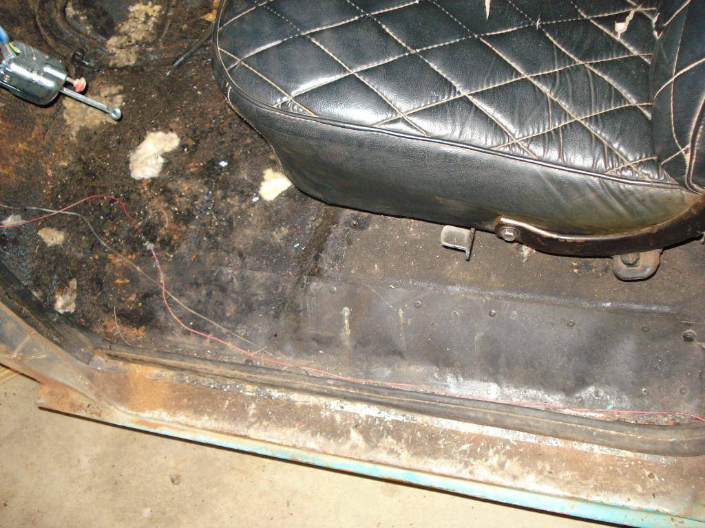

      got some repair work to do to the floors before I strip the inside and paint it all.

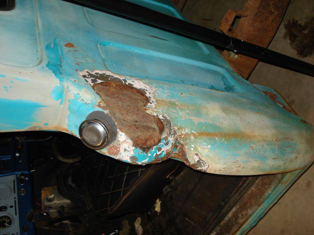

      on the driver's rear corner some PO did a terrible job trying to fix some damage to the cab. I will rectify this as a buddy has a matching section already cut out- and then do my darndest to match the rest of the patina after patching- gonna be hard though.

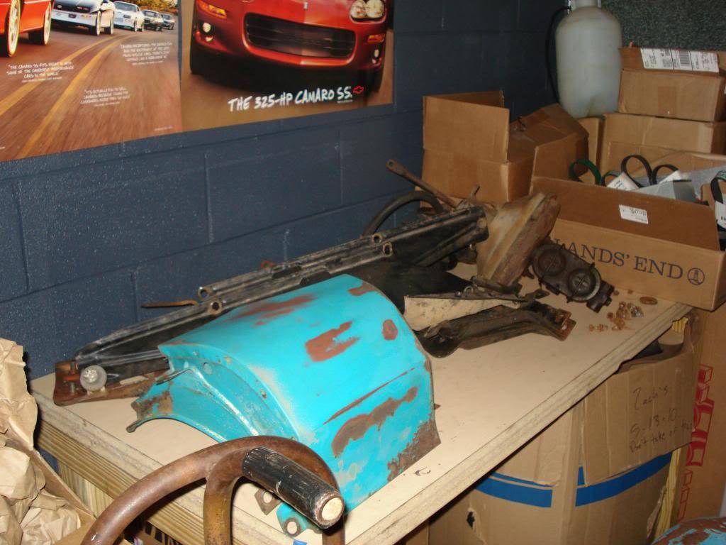

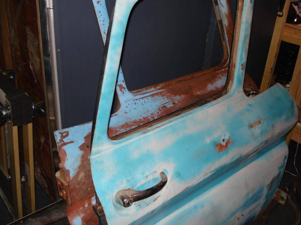

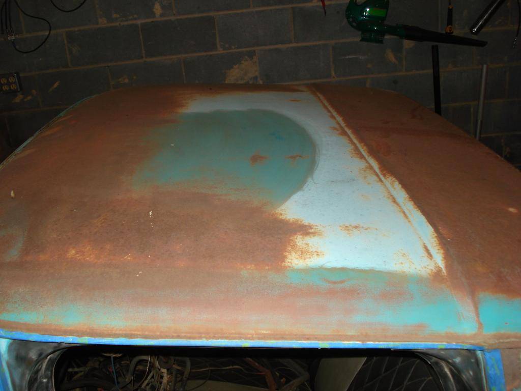

      some updates:

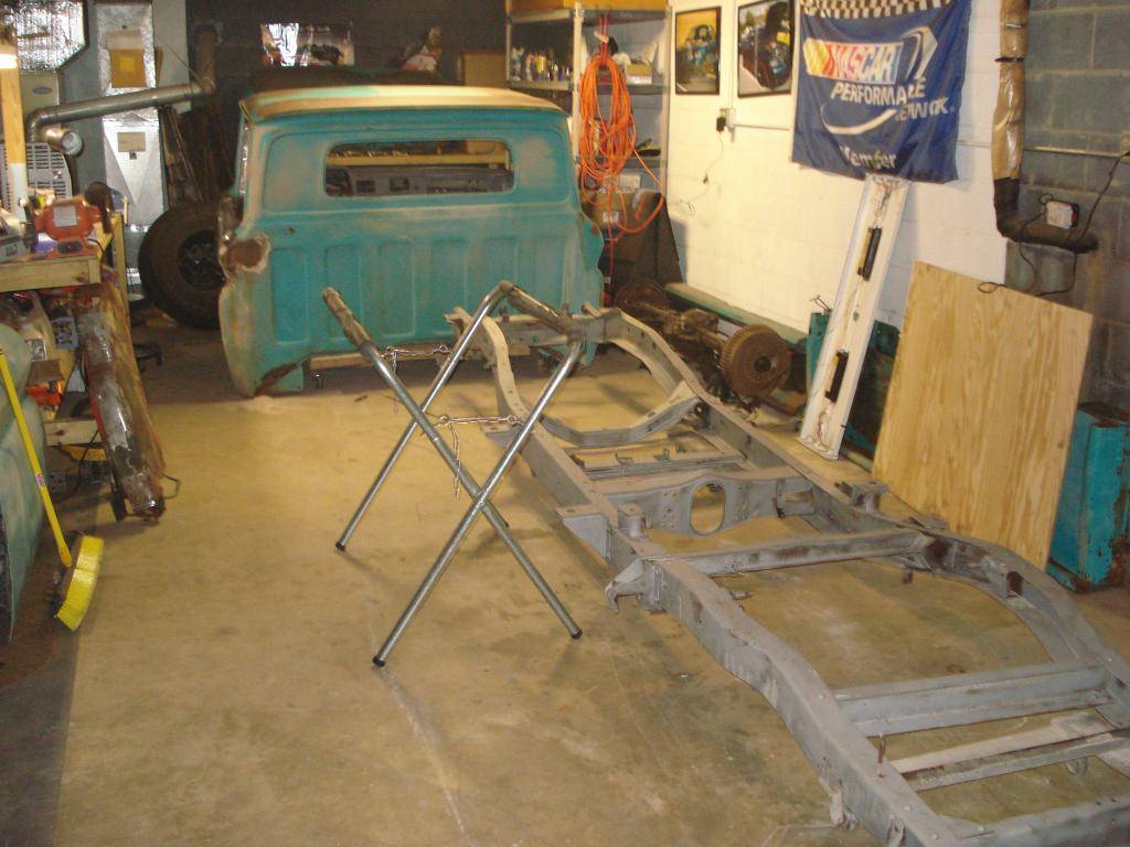

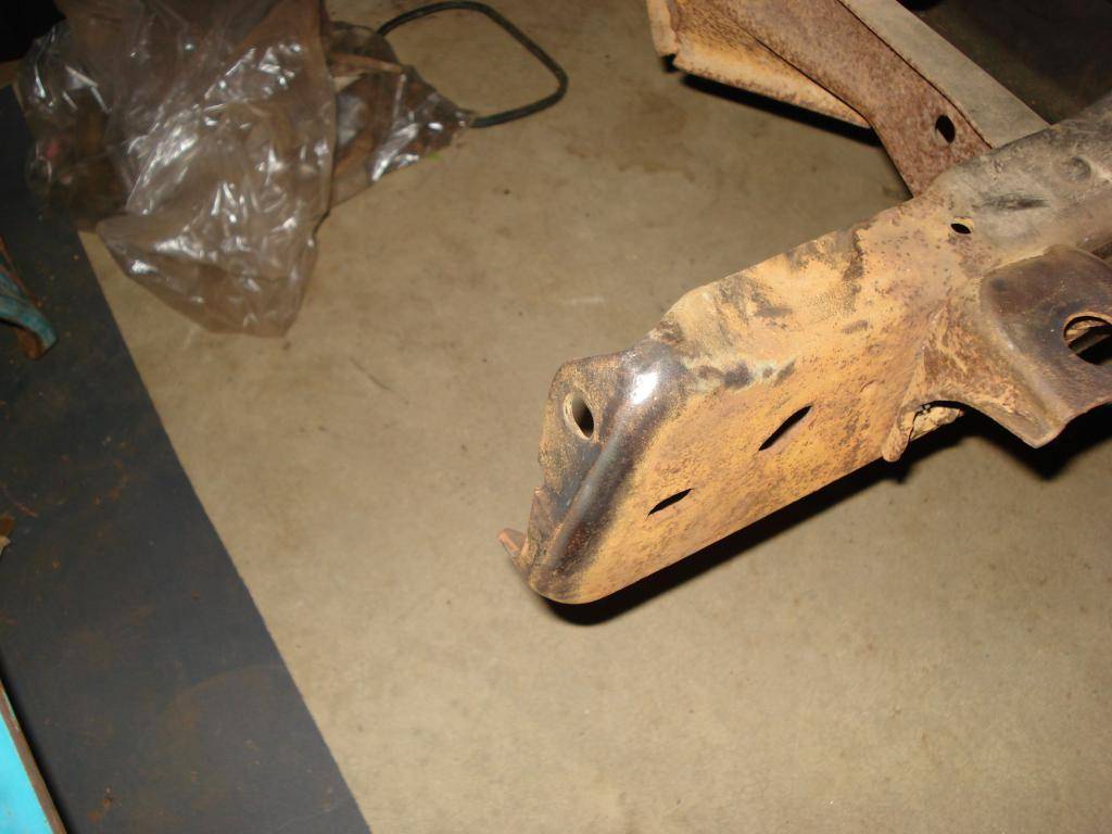

      cab is off- so frame is ready for cleaning
      just a test touch for how it'll clean up with a wire wheel- I'm pleased and will continue

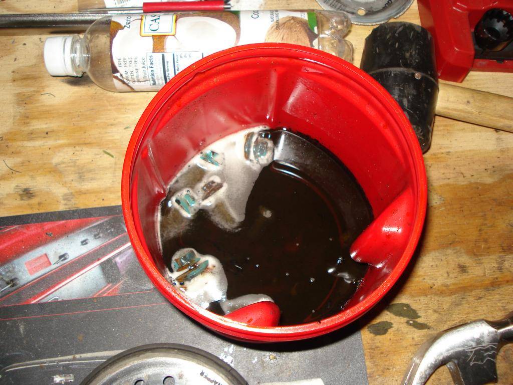

      wanted to show a pic of the eastwood rust remover gel I'm trying out for bolts and little stuff- leaves the paint, doesn't stink, and works great. little expensive though

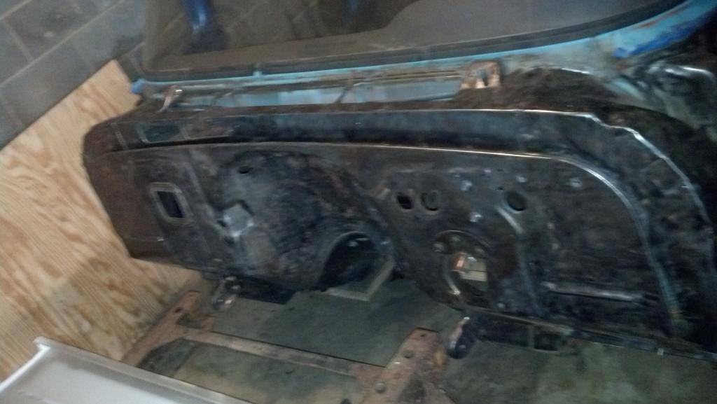

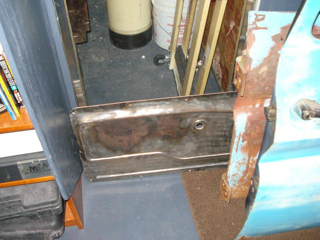

      already started stripping the cab
      will come back to assure true, fine lines but you can start getting an idea of what I'm thinking as far as paint. interior, firewall, under cab, doorjams, and underneath the wiper cowl will all be stripped and painted I'm thinking GM 533 (I think that's the paint code)
      finally got my cab corner piece from my buddy that he saved for me. when i say cab corner I actually mean the whole section around the gas cap down to where most everyone has to replace the bottom corner (I will too btw). but the upper part that I need is not reproduced so I got lucky my buddy got it for me. I am replacing this
      with this
      got doors stripped on the inside- need to finish the fine lines. you'll notice I didn't strip underneath the door insert, or the bottom of the doors- that's because I can just sand the area underneath the insert (it doesn't have to be perfect like the rest of the inside of the door) and the bottom needs to be cut out and replaced- so I didn't waste my time here.
      top looks good and should clean up with CLR and a scotchbrite quite well.

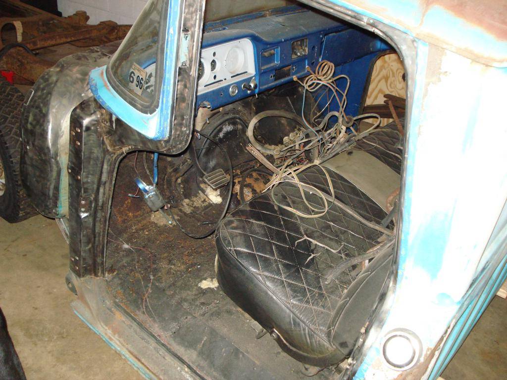

      Progess is going slow as I am working on it as I can and learning as I go. got most everything out from under the dash, removed the low hump panel which is toast. and lastly this weekend removed the in cab gas tank brackets- first spot welds I've ever drilled out and I didn't tear any or drill through so I'm especially pleased with that. Here's some pics of where I'm at on the cab- I've actually stripped more than it would appear since there's dirt/dust everywhere

      over the last few weeks, got the seat out, got the gas tank out (apparently there was still alot of gas in it cause I dumped ****loads into the corner of the cab- which subsequently went onto the garage floor since I need new cab corners). I also drilled out all the riveted in sheet metal a past owner used to cover the floor rot. Also started wire wheeling the floors only to realize it will take forever so I made a trip to harbor freight to buy a bunch of flap wheels on the cheap. might have gotten a little more done but took a break to cut some grass only to get stung a lot by yellow jackets that have apparently made their home in my yard in the last 8 days.

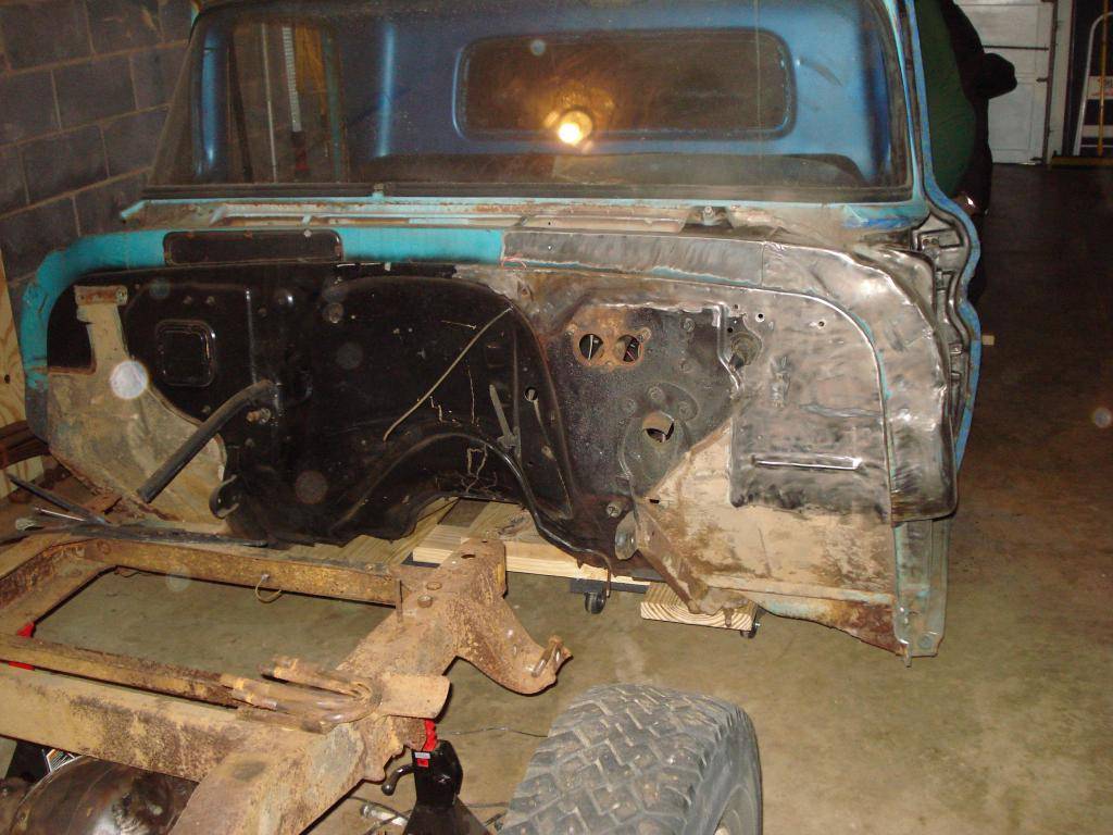

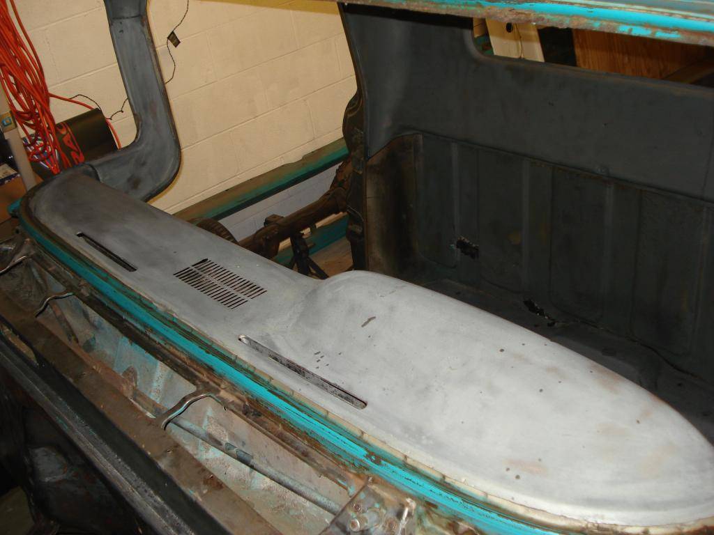

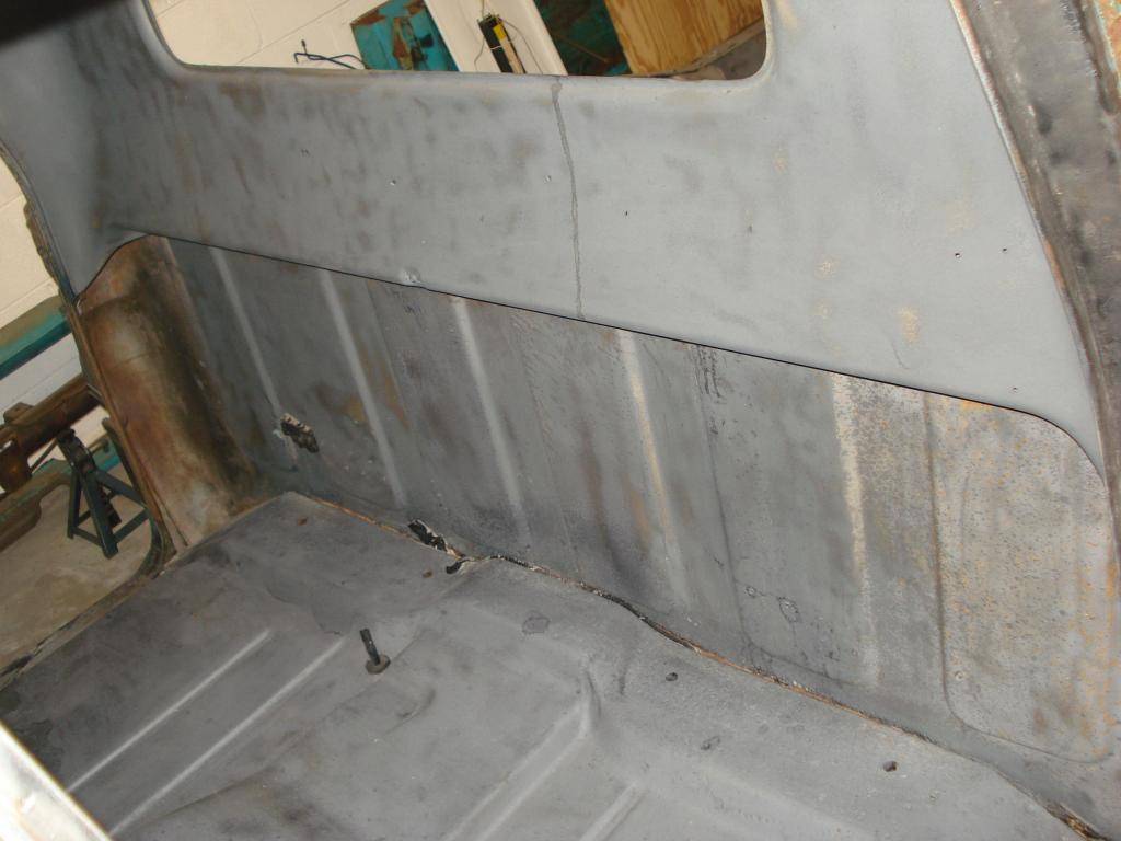

      got the inside of the cab, underside of the cab, the frame and hood hinges blasted. revealed all the trouble spots for sure.
      upper windsheild area needs work
      now I'm at a standstill though cause I don't have any funds to continue working on the truck (I need to buy a welder) until my cobra sells.

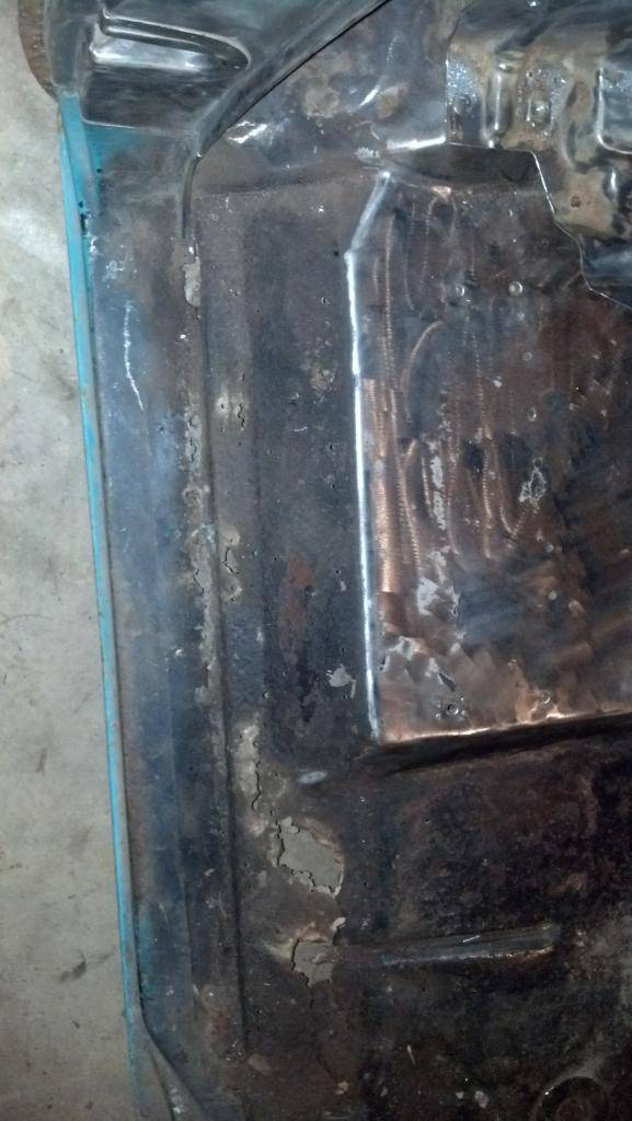

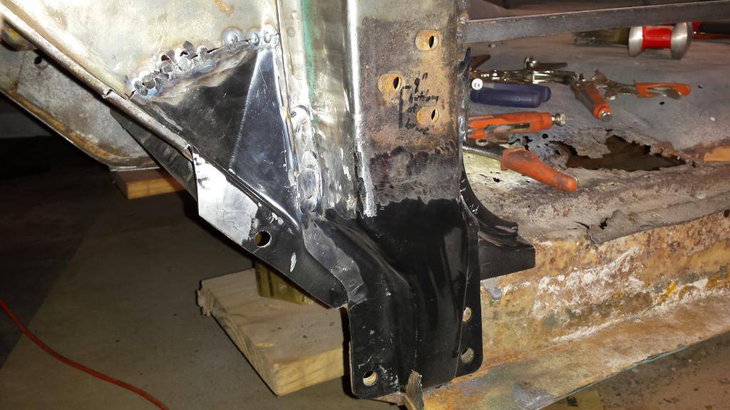

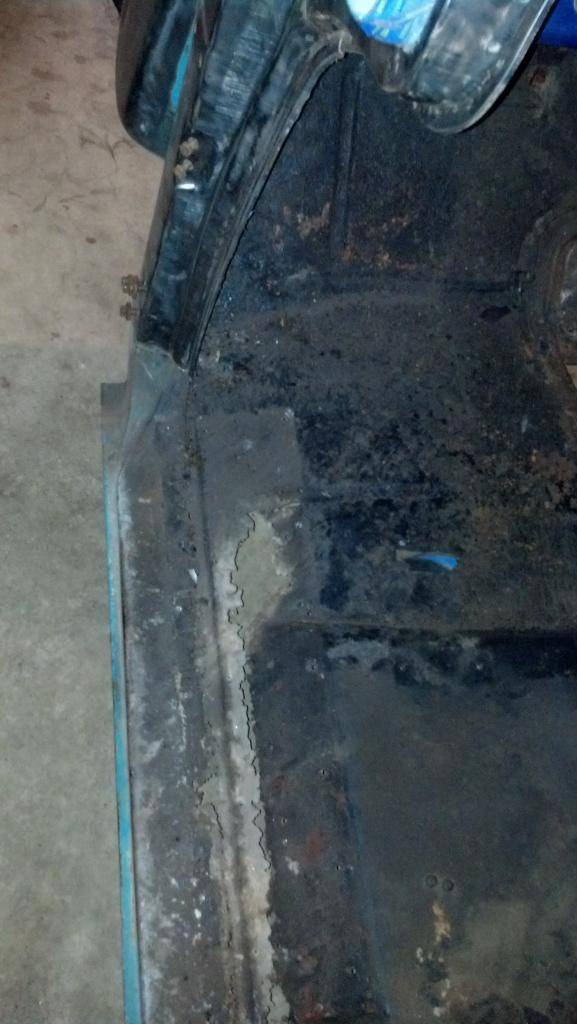

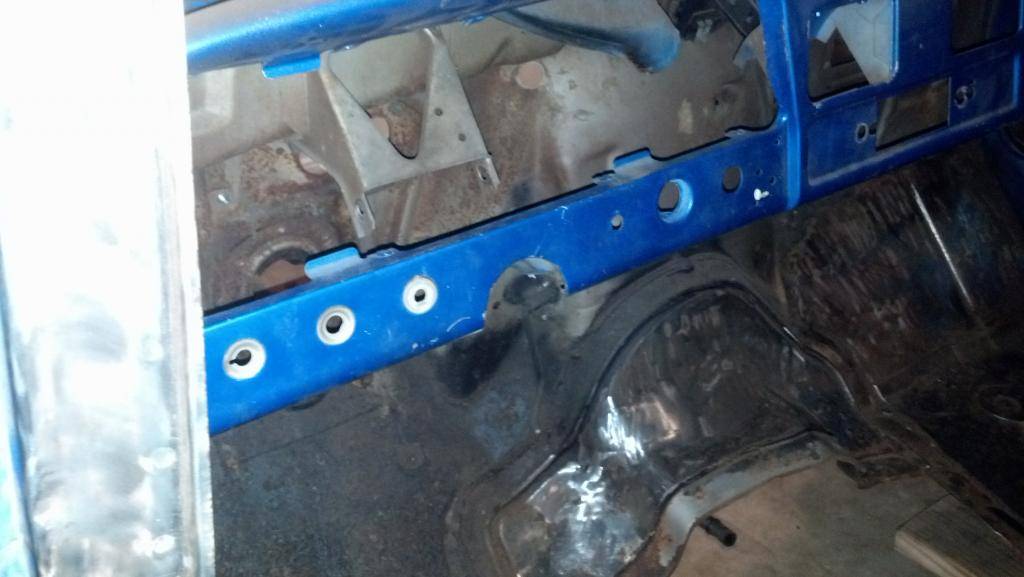

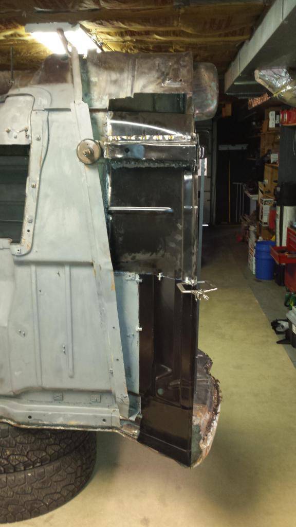

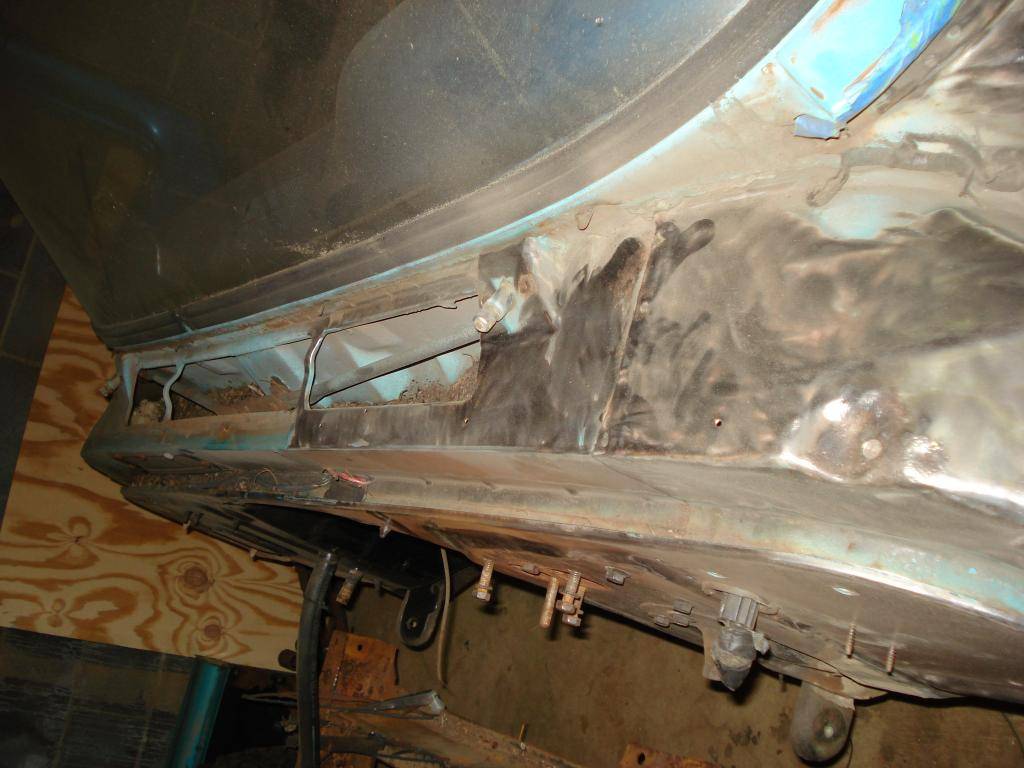

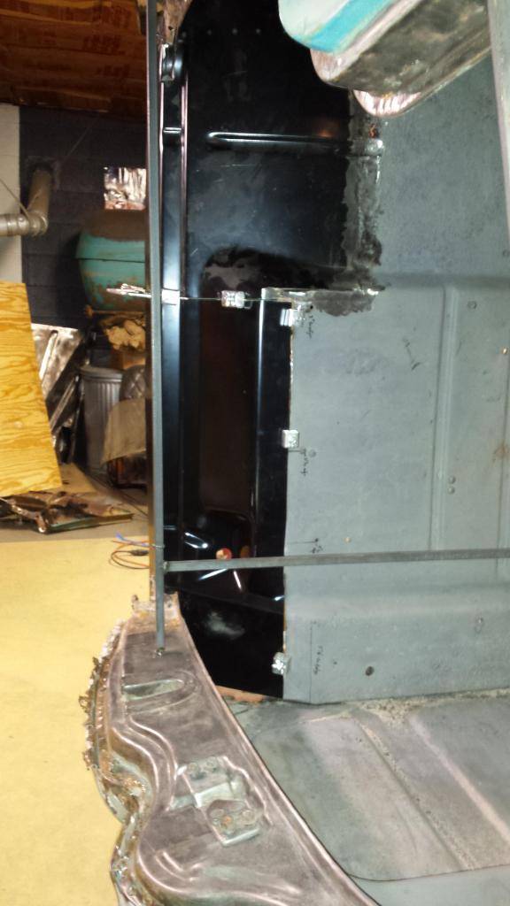

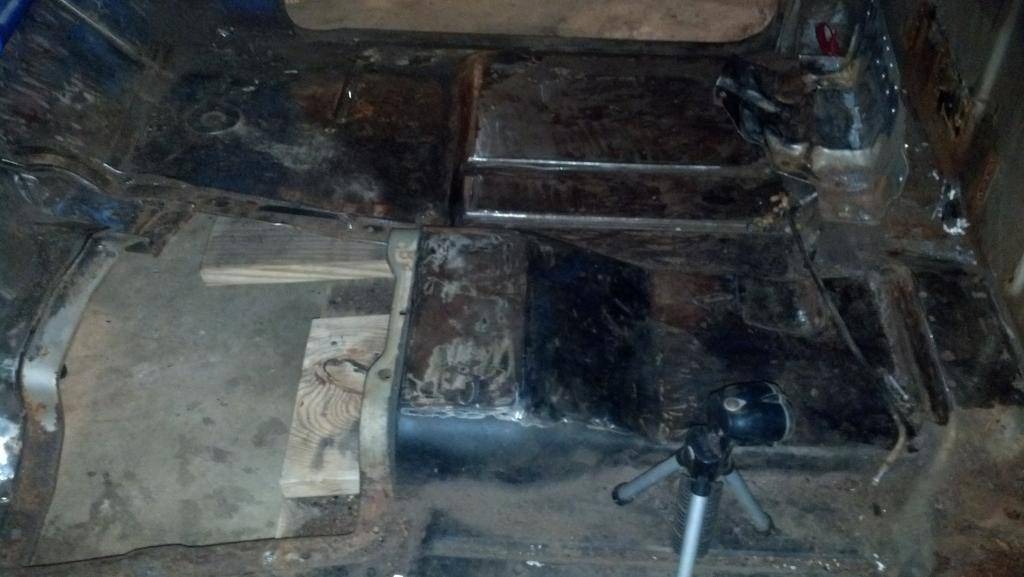

      been working pretty hard on the truck and other projects so it's coming along slowly. I have gotten the front lower A pillar, driver side kick panel done,
      and started on the driver side floor repairs including the cab supports.
      lots more gone than I initially saw. Let me remind you I'm not a bodyman and am learning for the first time. I promise any time I burn through I'm fixing it after the panel cools- just depends on when i take picks. so far it's going well I think and the floor is matching the angles of the passenger side that I haven't cut into yet. the biggest obstacle is going to be the driver side rear of the cab

      Mar 2010
      469
      Respect. I had to do that level of repair on my cab, years ago. It's slow, thankless work.
      With that level of repair, the cab will be out of shape due to flex - do yourself a favour and test fit your doors, correct the gap, tighten the hinges, put the latch in - to make sure you get the back of the cab in the right place. Check the weather strip gap. I did not do this and didn't get it right. You can't see any issues in mine, but I always need to push on my door to lock it, no matter how I adjust it.
      Jun 2014
      asheville NC
      23
      Quote Originally Posted by bovey View Post
      will do- thanks for the insight
