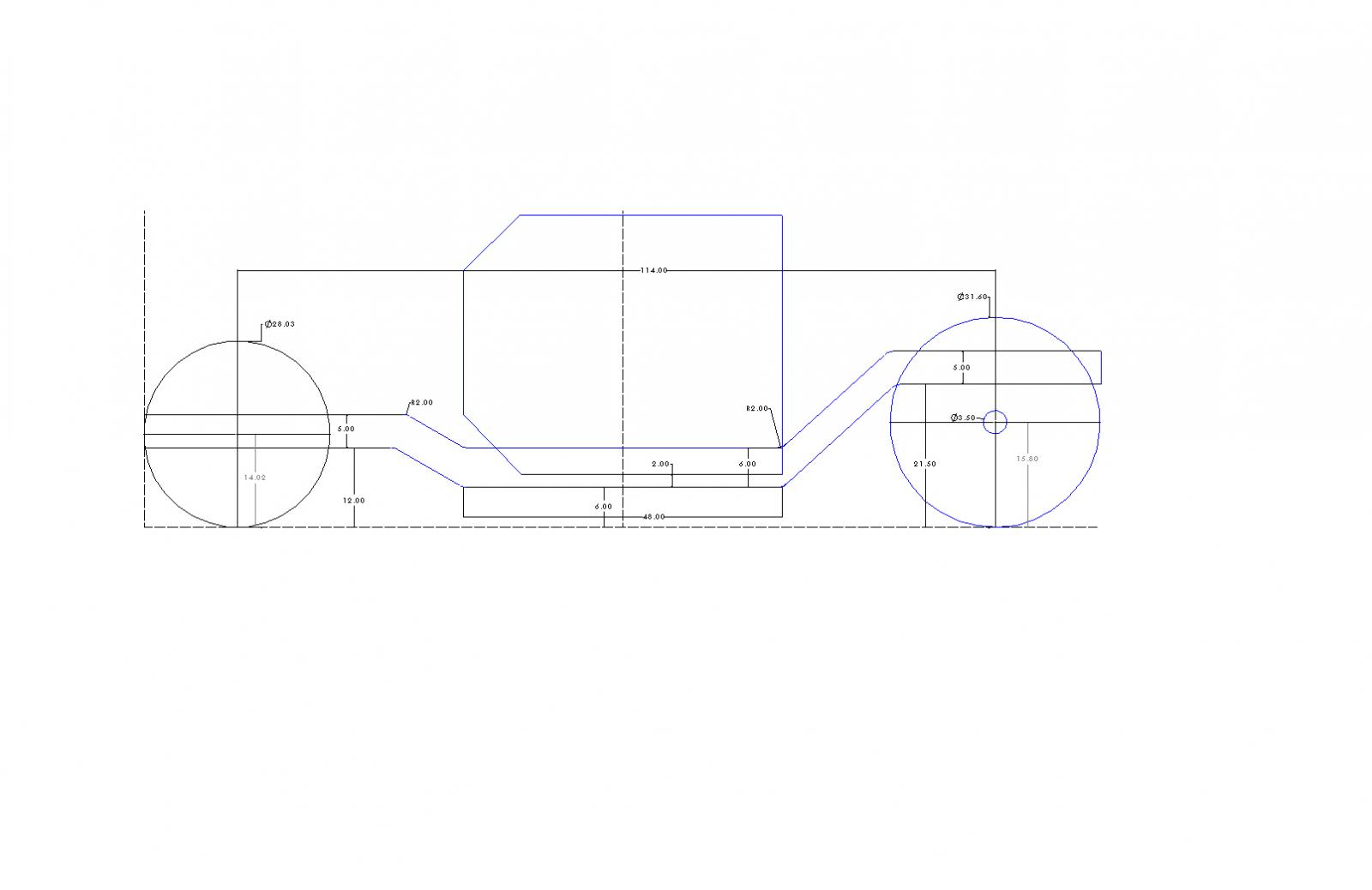

      OK, I think you are going to have to build a frame. In the long run, this would be easier than modding the OE chassis, or another. When I start a project like this, one of the first layouts I do is an elevation sketch. This helps me make a few key decisions. Here are some factors. Lots of torque, and a motor that is a little longer than most. Tire and whee combo is set. 6" rail height under cab, with a 6" tall rail. coil-overs. '67 D100. Looking at the rear tire, at 31.6" tall, that puts the axle CL at 15.8" off the ground. Add 1.5" for half of the axle tube, and 4" for compression travel, you have the bottom of the rail, over the rear axle at 21.3" from the ground. Up front, the tire is 28.03" tall, putting the CL at 14" from the ground. First key decision - You will need to use a drop spindle. This will allow the IFS cradle to sit a little lower, and give you better motor placement. As a general rule, most IFS's, with a drop spindle will set the rail height 2" below the spindle, or in this case, appx 12" from the ground. If you start with 2x6 tubing under the cab, and blend to 2x5 for the front, and 2x5 to 2x4 for the rear, these elevation changes can be easily built into the rails. - see pict. Next questions, what is the bolt pattern, and the big one, what is your chassis budget?
      Nov 2010
      579
      Like This?
      Name:  Side Elevation View.jpg
      Nov 2010
      579
      Rob, I don't think another complete chassis is in the cards ( I have 2 already ), but I do think I can make a good handling street truck out of the two I have. I do like your Fatbar setup for the rear, If I have the necessary space outboard, (I'm pretty sure I will) I will use it. Now all I need is a custom designed IFS built around the SRT10 spindle (or a custom built piece), so I can run the 15" brakes and the factory wheels. Know anybody?

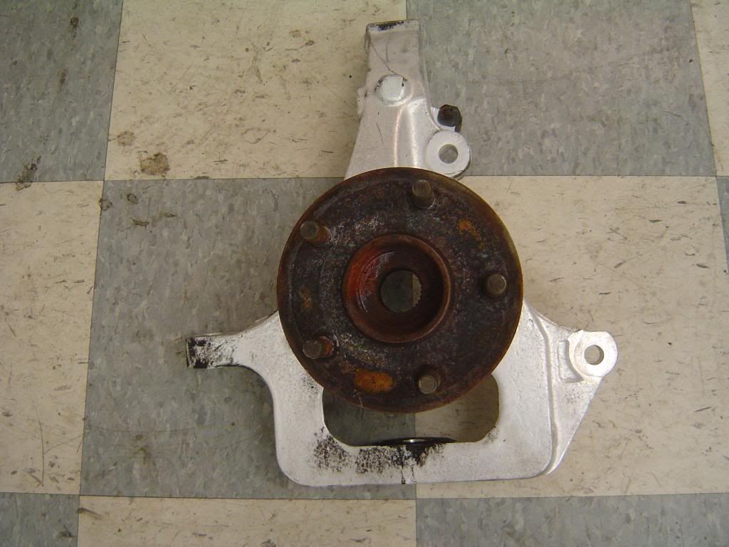

      The only drop spindles I have found are made by McGaughys and they are only for regular Rams. The big brakes of the SRT10 have a different mounting arraignment. I plan on designing up a set as soon as I pull off the OE spindles, I have a friend with a CNC milling station, I'll see how much he'll charge me to whittle out a set from billet.
