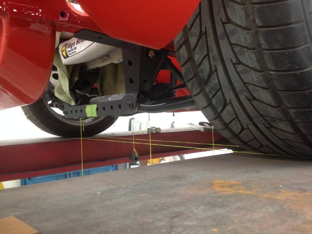

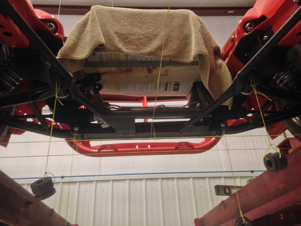

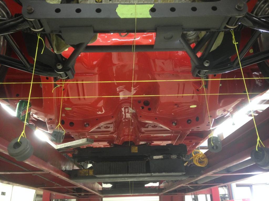

      Started measuring the front up and wanted to see if this is an okay way to go about it.
      Ran the strings in front of and behind the tires and came up with the same distance between side to side. That will be the axle CL. Measuring the control arm pivots to the CL, I just loosened the bolts and backed them up a 1/16". My bolt to hole clearance is zero! Nothing moves when I tapped the bolt back. I just slipped a string around the bolt and tied a weight to each one so I can now measure to the centerline. I used the level, and marked it at the pivot string and one of the centerline strings and just added half the centerline distance. Good so far, or start again?!!

      Craig, I'm not Ron...but having been there done that, I don't think that will get you your proper axle centerline. The amount of caster dialed in will move your mark forward. I believe I dropped a laser line straight from my spindle down for the axle centerline reference. I actually marked it on the ramp, rolled the car back, taped the string down to the ramp and rolled the car over the string again.
      Also this goes without saying but be sure that you haven't jacked the front tires off the ground and lowered them again so they are in bind without slip plates under them.
      Good start though. Do you have enough weight in the engine compartment to mimic the weight of the engine itself?

      Craig's method will work fine. The center of the tire is in line with the center of the front spindle. Caster doesn't show up in the contact patch statically ... only dynamically when loaded.
      Craig ... Lance asked about weight in the engine compartment. Since there is none, just want to make sure you're mocking all four corners of the car up at the desired ride height. I think we discussed this ... but I'm old & forgetful.

      Thanks Lance. My understanding is that if I have the other dimensions, pivots, ball joint, etc. That when modeled will show the caster side to side. This can be subtracted in the program to find the true CL. Your way is probably better for dialing in an existing suspension, but Ron is serving me the Taco Grande and designing new uppers, lowers, and spindles.

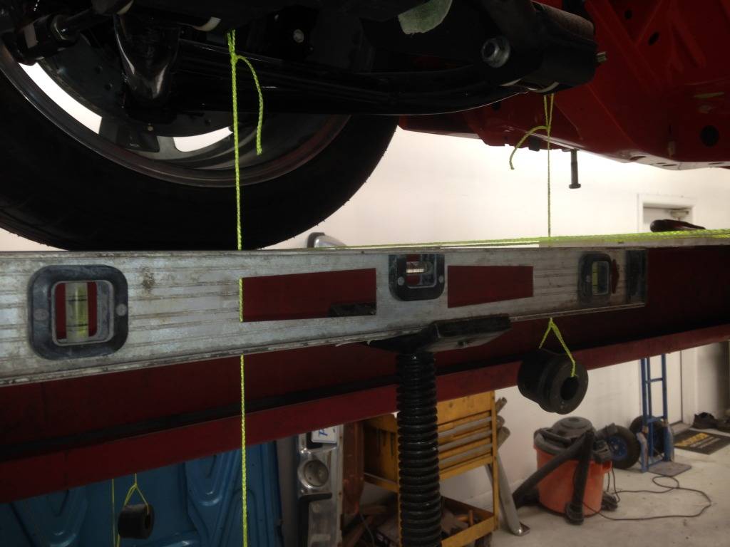

      I just set a level on a T stand about 1/16" off the strings where they intersect. That way I know i'm measuring in a straight line.

      Optical Illusion or is the trans tunnel that far to the pass side from the K-frame centerline?

      Yep, Ma Mopar biased the entire driveline to the passenger side to accommodate a steering box. I have it centered in the car which is why it looks off. Just means more room on my side of the car!

      How accurate does one need to be here? The reason I ask, is for instance in the fourth pic you posted, the string on the front left lower point is looped around the bolt, and it looks in the pic to be hanging slightly off center (easily corrected off course), but does this level of accuracy matter?

      how accurate does one need to be here? The reason I ask, is for instance in the fourth pic you posted, the string on the front left lower point is looped around the bolt, and it looks in the pic to be hanging slightly off center (easily corrected off course), but does this level of accuracy matter?
      Very accurate. I just snapped a pic after I measured and bumped all the strings. Measured 3 times, pulling the weight each time to make sure it would repeat.
