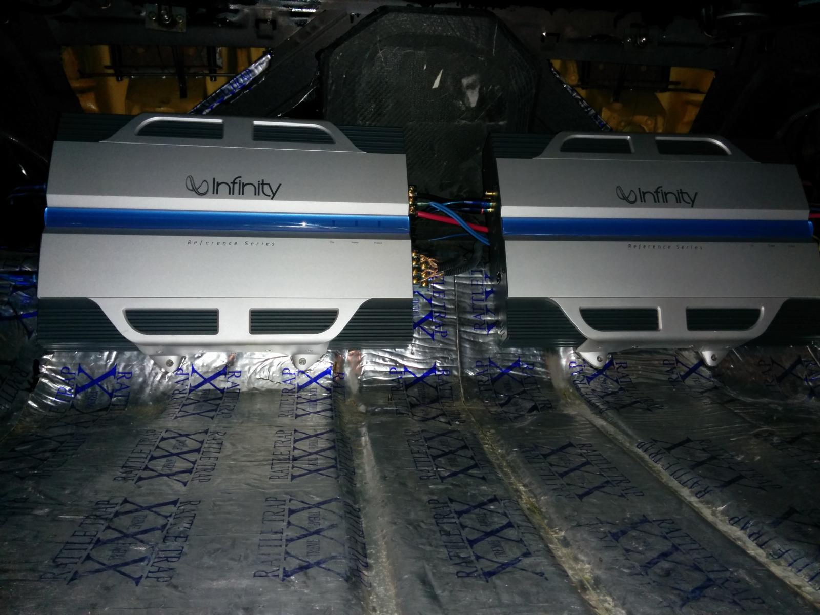

Will running larger gauge wire help stop my amp from clipping or should I go with another battery?
Kenwood -KVT 514 head unit, Infinity Kappa series 60.5 cs (4 pair components) Jl Audio 10w3v3 sub, Infinity Reference series amps a 7541a (111 watts x4) and a 611a for the sub.
The amp that runs the mids and highs will cut out at 3/4 volume for a couple of seconds then turn back on and then cut out -at this point i turn it down, the sub does not cut out. The positive wire run is about 15 ft of 8 gauge into a fused dist block,the maybe 18inches from the block to amp. The amp grounds are about 2 ft . As I am typing this it seems that bigger wire should help but its been suggested to get a 2nd battery. Running an 02 LS1 motor with a Napa 65 battery . The alternator is 102 amps.
any input with logical reasoning to back it up is greatly appreciated, Thanks
