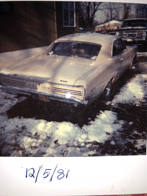

    6. #1466
      Feb 2014
      779
      I have a weakness for '66 Pontiacs......
    7. #1467
      Apr 2014
      803
      Quote Originally Posted by Bob in St. Louis View Post
      Me too! My 1st car;-)

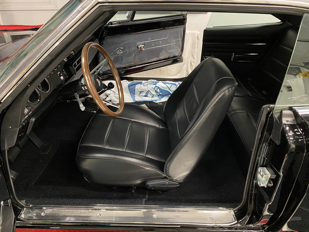

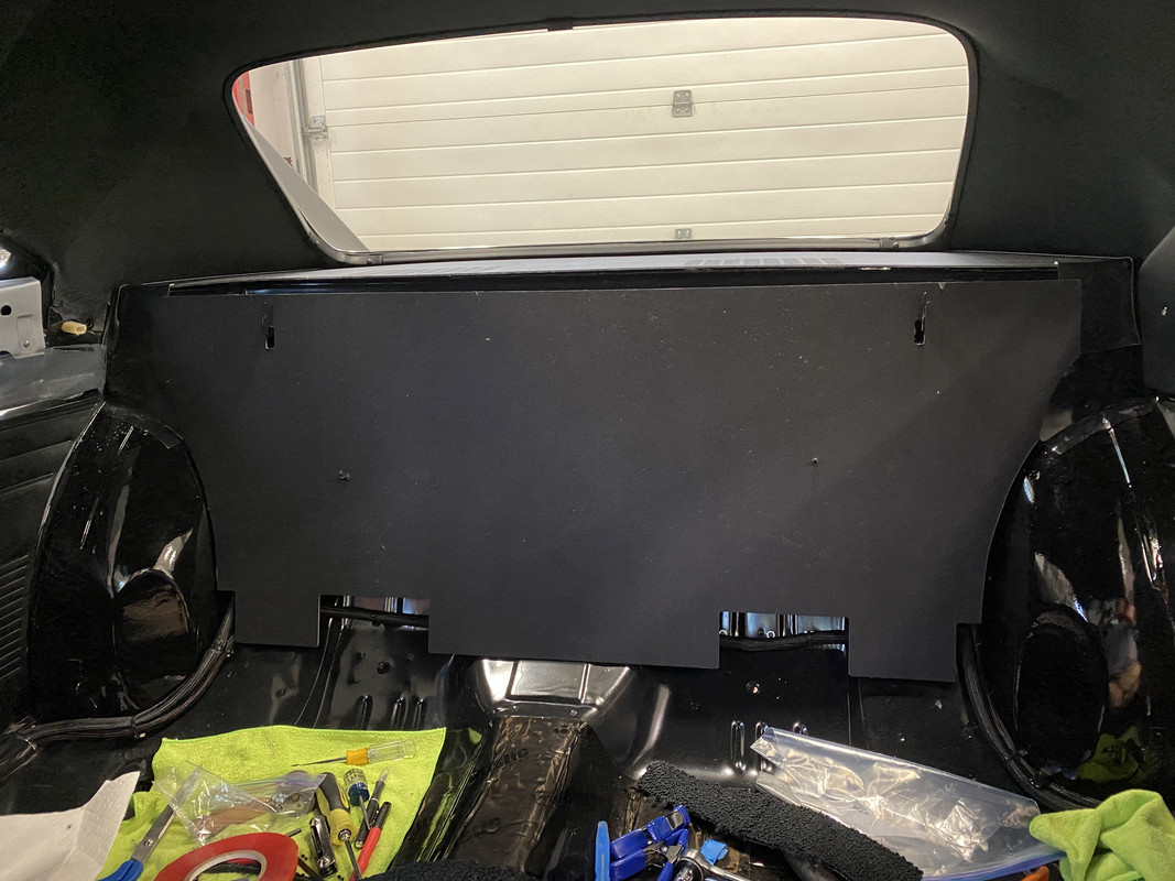

      Starting to look like interior interior, and running out of things to bolt back on;-)
      Thanks
      Pat

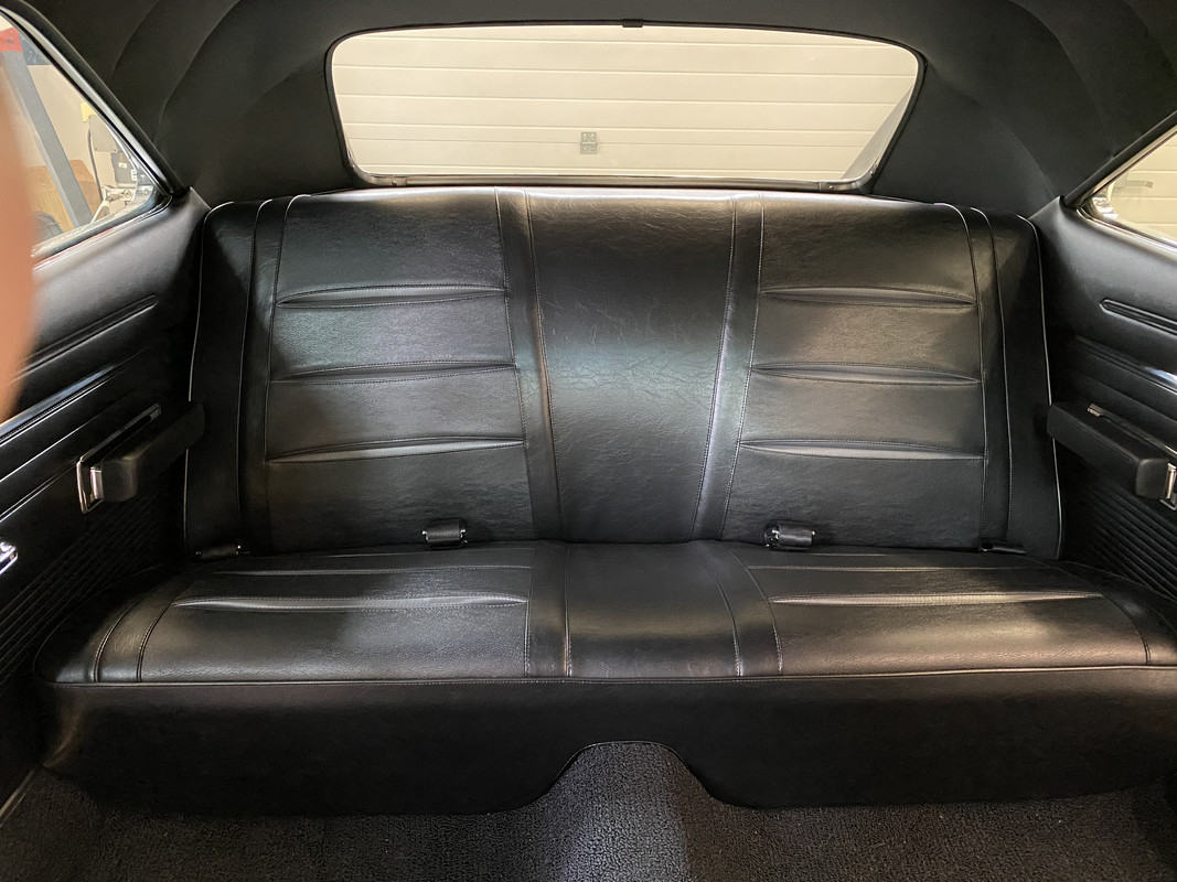

      Quote Originally Posted by keepat View Post
      I think the 68 map pocket is a little big for today’s maps;-)
      What you need is a vintage "Thomas Guide" for that pocket!

      Quote Originally Posted by GrayRaceCat View Post
      Great idea! I went online and found a 1968 map of San Francisco!
      Thank You!
      Pat

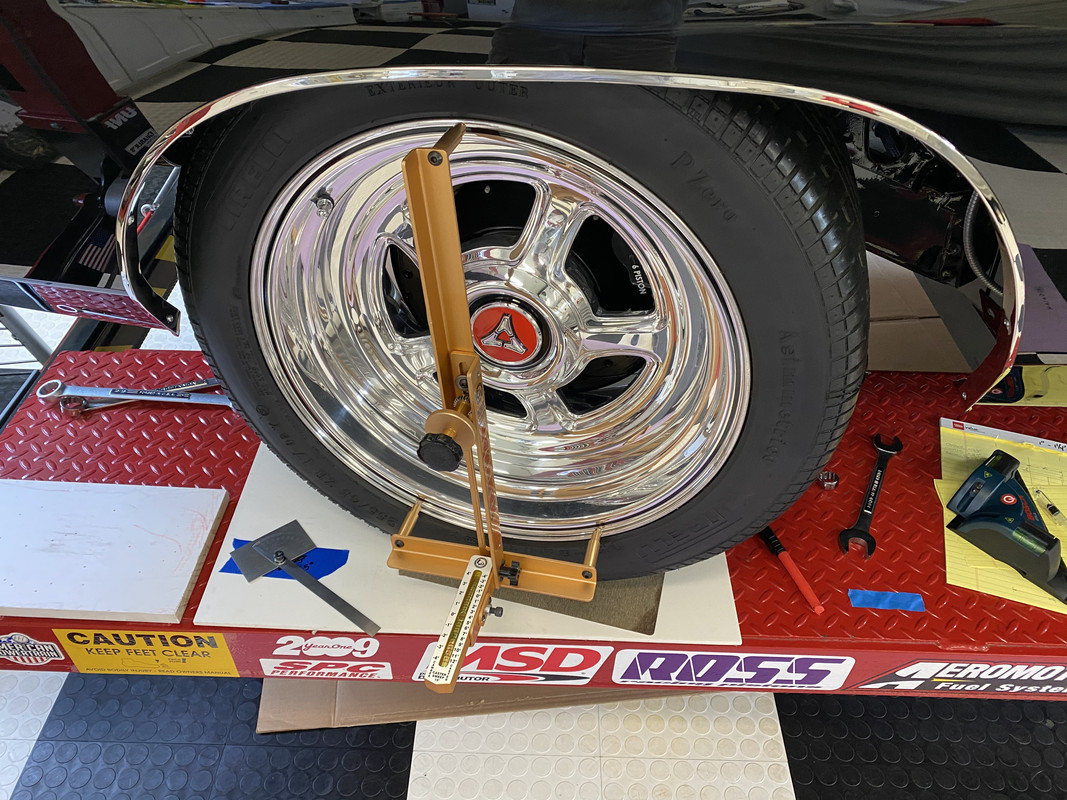

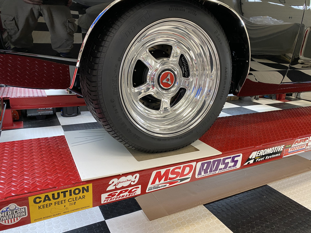

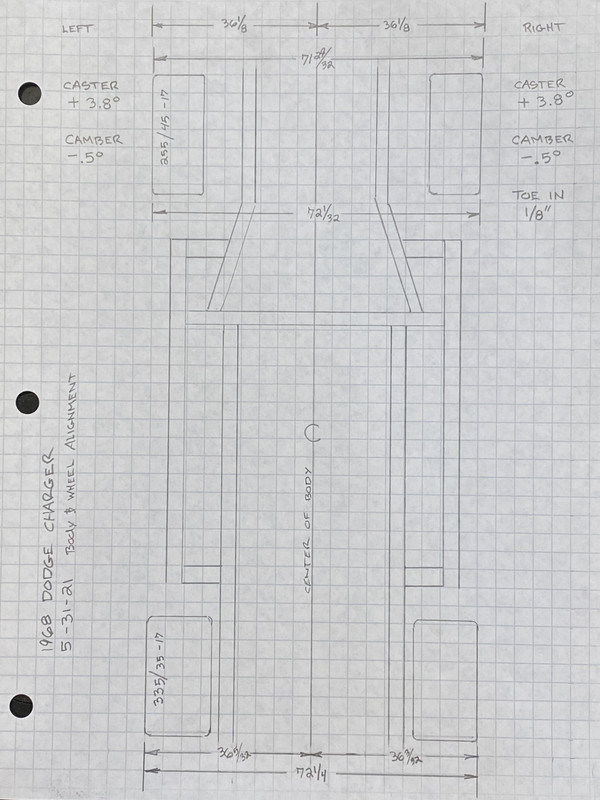

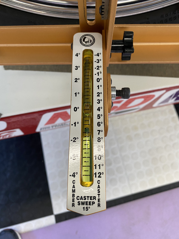

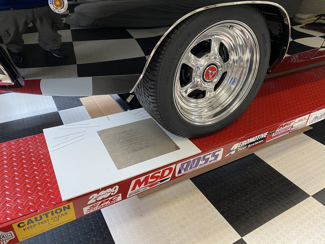

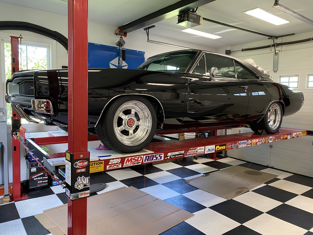

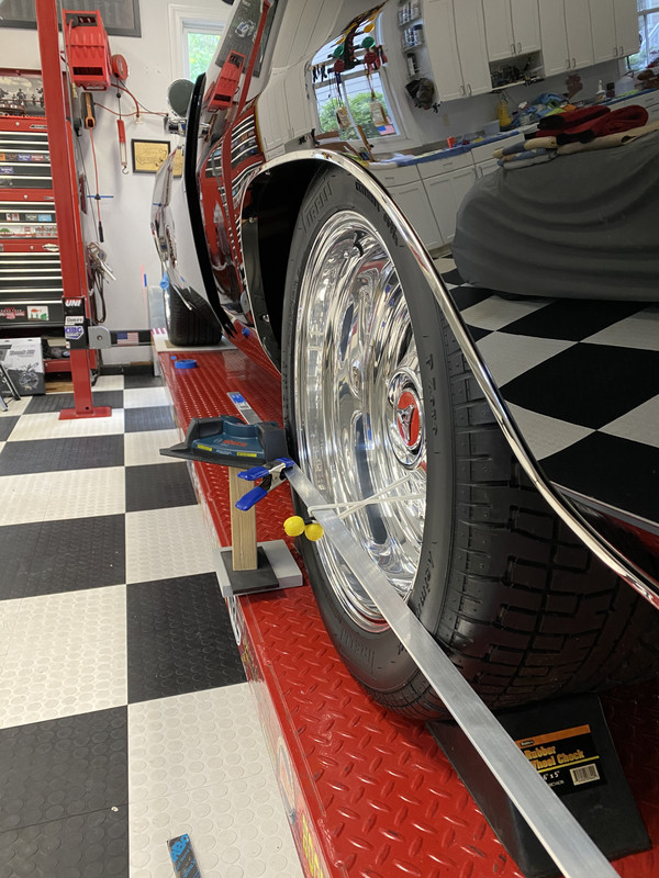

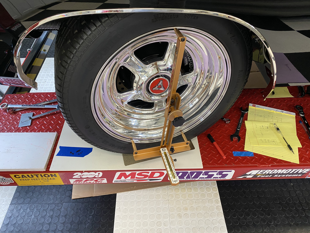

      Today I aligned the rear to the body using lasers. This confirm I welded in the 4 link 5+ years ago correctly;-) Then I did a front end alignment with my Fastrax camber caster gauge. Starting by rolling the front wheels onto a piece of plastic and thin piece of Formica. This allows the front wheels to turn and the suspension to relax. Camper was set to -.5° and the caster was set to +3.8°. Toe in was set to 1/8”. I was very happy with the rear end to body alignment. I guess all that check, double check, and triple checking before I welded in the rear suspension paid off;-)
      Thanks
      Pat

      I understand that the spec for the car maybe .125" for toe in. Have you tried .0625" before? I'm a long ways from a front end expert but I'm finding that caster and camber have more effect on driving than toe in. I have been setting mine up at .0625 for some time and like to think I have less rolling resistance and a slight amount of fuel mileage. You are getting close. Are you going to be the 1st driver?
    19. #1479
      Apr 2014
      803
      I can see having less toe in with more modern suspension would work whether it be with Heim joints or polyurethane mounts! And I’m will be the 1st and only driver for a while;-)
      Thanks
      Pat
