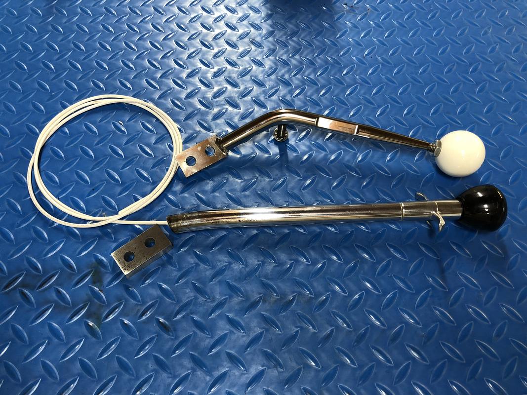

      The original Inland shifter had a mechanical reverse lockout which was disengaged with the T handle. The Tremec 6 speed also has an reverse lockout, but it is operated by a 12v solenoid. So I modified a door jam domelight switch to fit inside and added a top spring to hold tension on the T handle. This will either directly operate the negative side of the solenoid or a relay? I haven’t quite decided how I will wire that in yet. I just need to add a slight dogleg bend to the shifter, weld on the 2x1x1/2” mount block and then send it out for Chrome;-)

      Lookin good brother! I like that you're keeping the inland shifter - most people punk out and just go to a Hurst

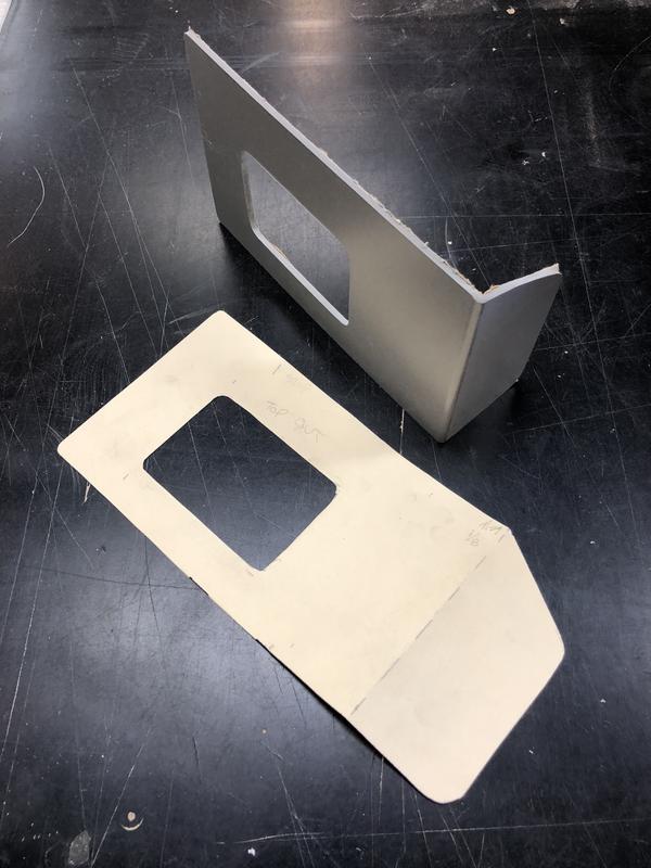

      I’m using the American Autowire classic update series harness. Very nice harness as it uses all of the original connectors. None of the ends are installed so you can adjust the length of the wires as you see fit, along with having all of the additional wires needed for a modern car such as electric fan, electric fuel pump, door locks, power seats and power windows. It looks original with the same color code, but with one nice addition all of the wires are labeled every 4 inches. Instrument panel worked out great!
      A few modifications along with a couple brackets I made to hold the new fuse box securely, with access from the glove box.
      Need to paint the gray plastic face plate black to finish it off.

      Wow the dash looks beautiful, and the painted part look great too. Wiring looks neat. As usual excellent workmanship.
