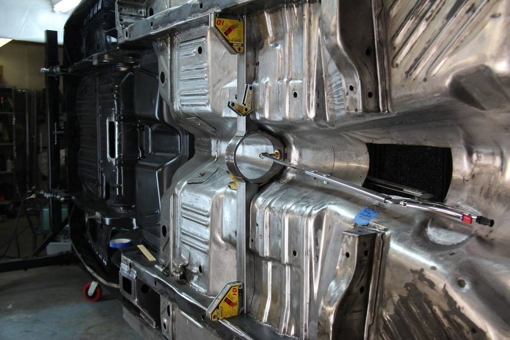

      Yes it is close, about 2" from the lights and 4" from the ceiling.
      Had some help at the shop today ;-)
      Thanks

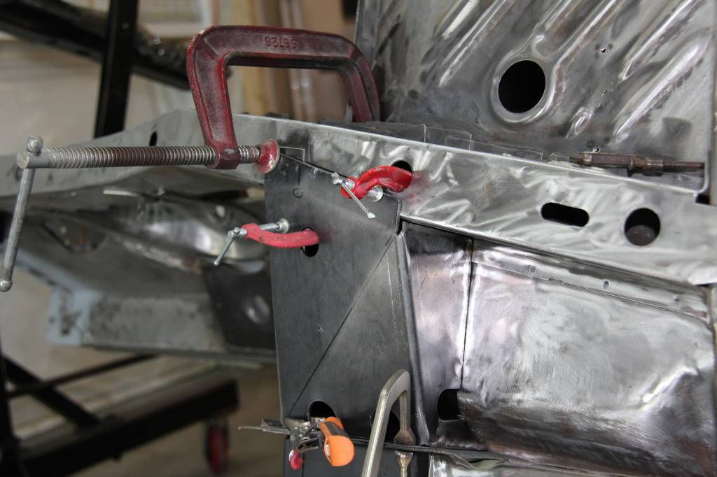

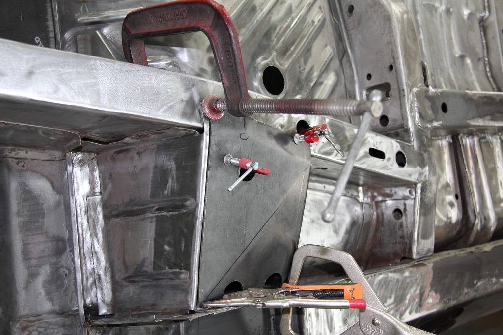

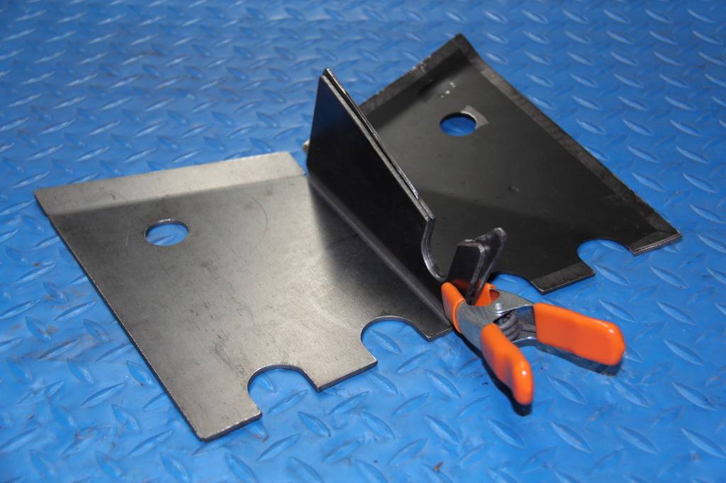

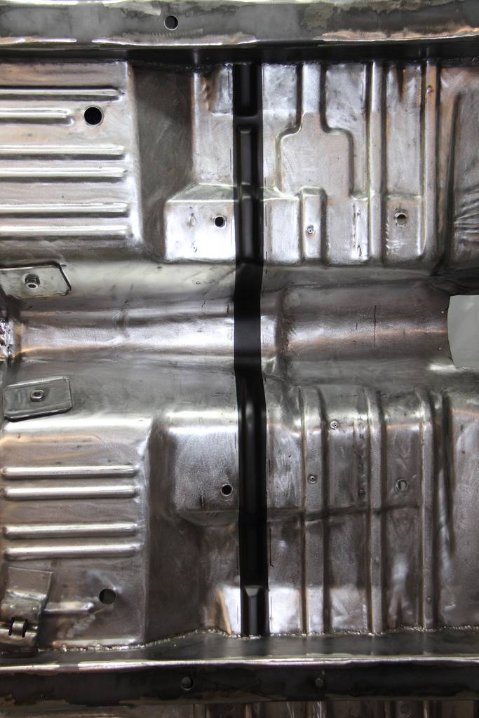

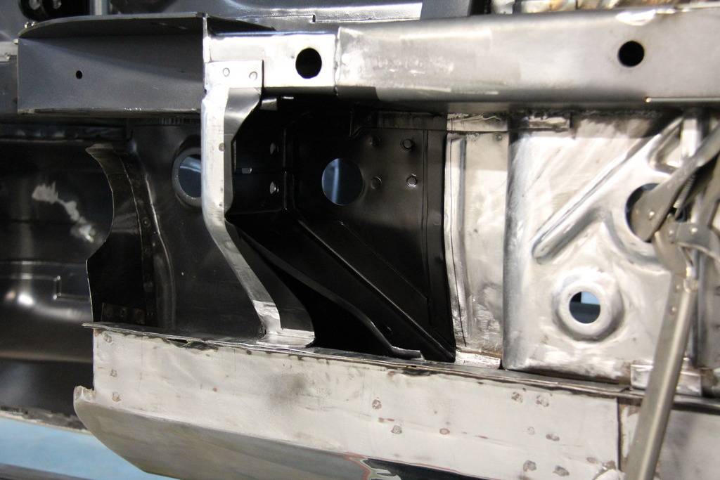

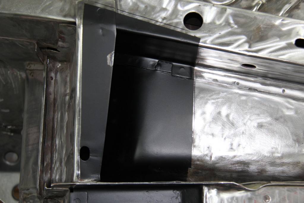

      Started installing the torque boxes and have the left aft welded in. The US Car Tool boxes fit nice and only need a little adjustment. I added a 1 ½” hole for a future rear brake vent.
      Thanks
      Pat

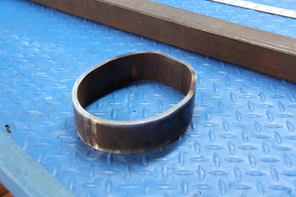

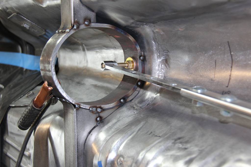

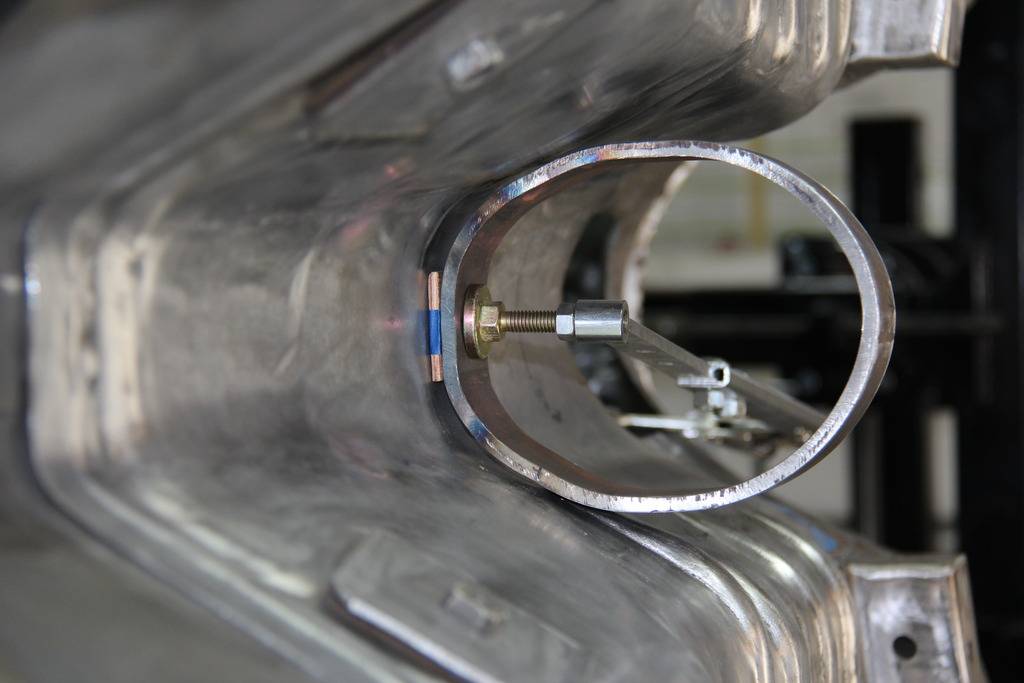

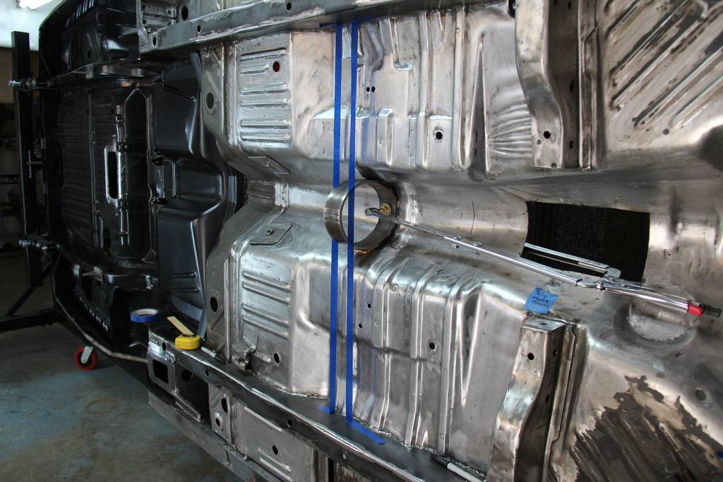

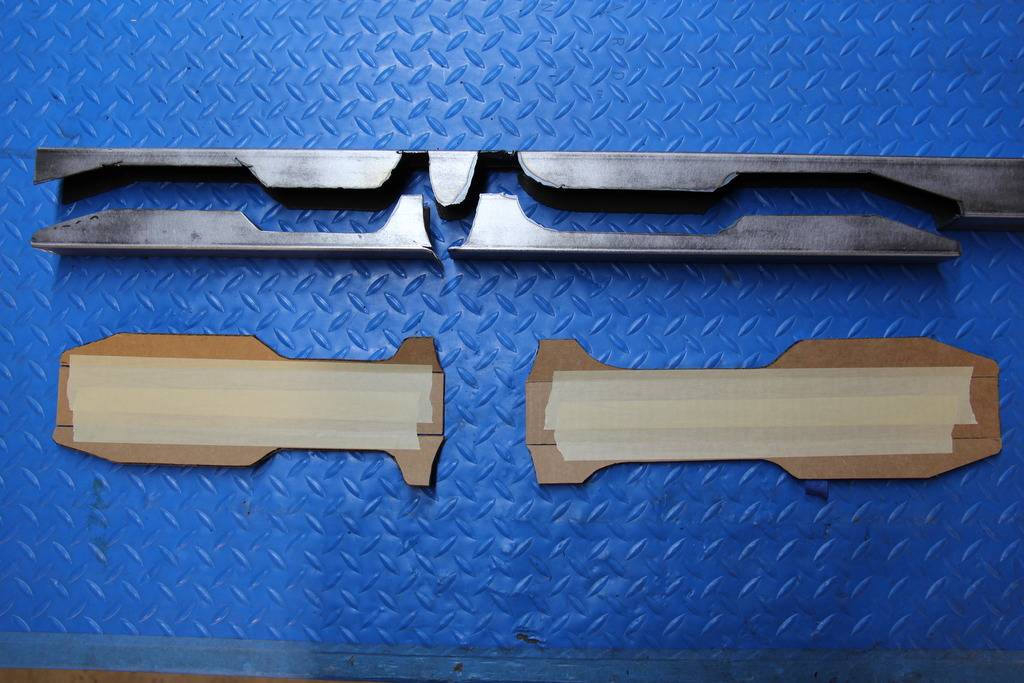

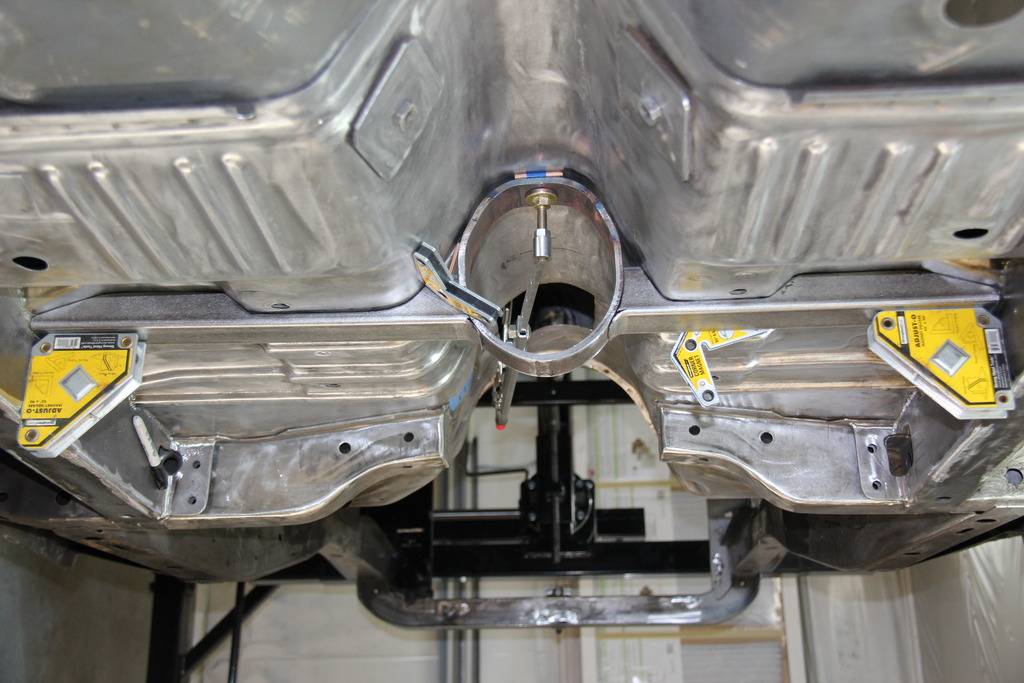

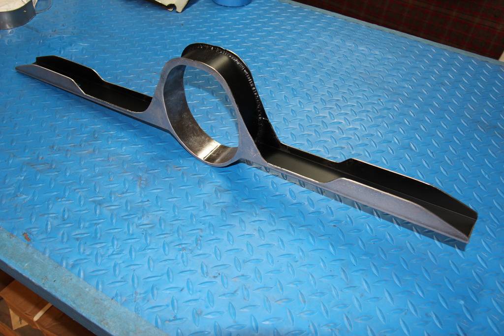

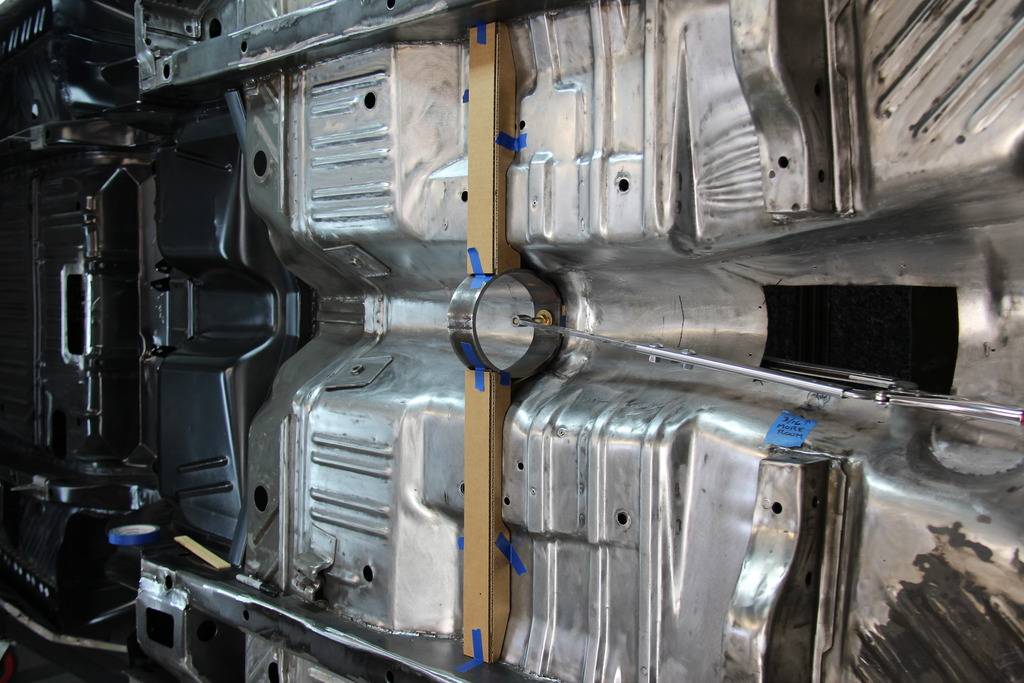

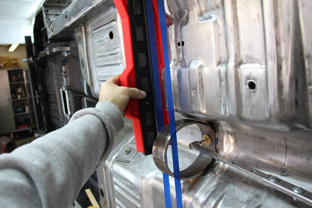

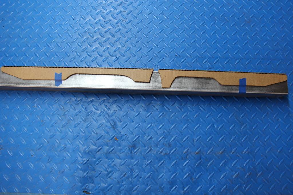

      I started on the driveshaft loop/crossmember today. Using a press I oval a 2” section of 6” pipe and hammered the top half to match the shape of the driveshaft tunnel. With the loop clamped in place and using a 15” contour gauge (a must have tool) I made two cardboard pattern for the crossmember. With the cardboard center section of each pattern as wide as the square tubing (2”) I was able to lay it over the tubing to get a precise line to cut with the plasma cutter. I still need to make the pattern for inside the tunnel above the loop before I can weld it to the floor.
      Thanks
      Pat

      Wow, very nice job matching it up to the floor.
    8. #428
      Apr 2014
      803
      Thank you Wayne!
      Pat

      I like your multi extended vice grips. I wanted a contour gauge for a while. Now I see why I need one.
      It's the first time I had a real need to use those vice grips and I have to say money well spent! And the contour tool is from Eastwood and I have used that on a few other projects.

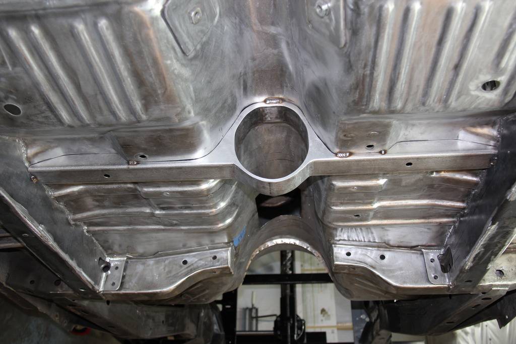

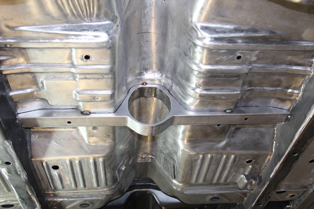

      The drive shaft loop/crossmember is made and tack welded in place. Back to the torque boxes.

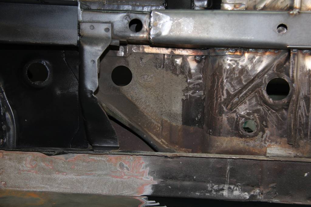

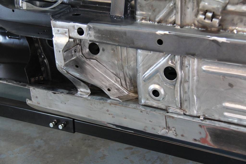

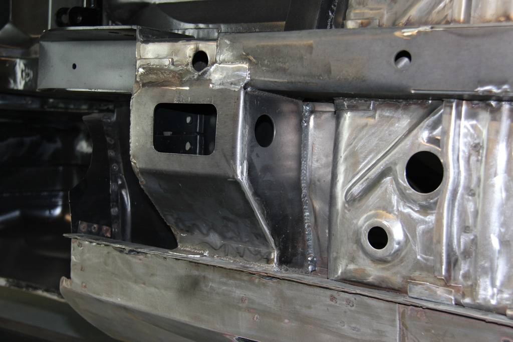

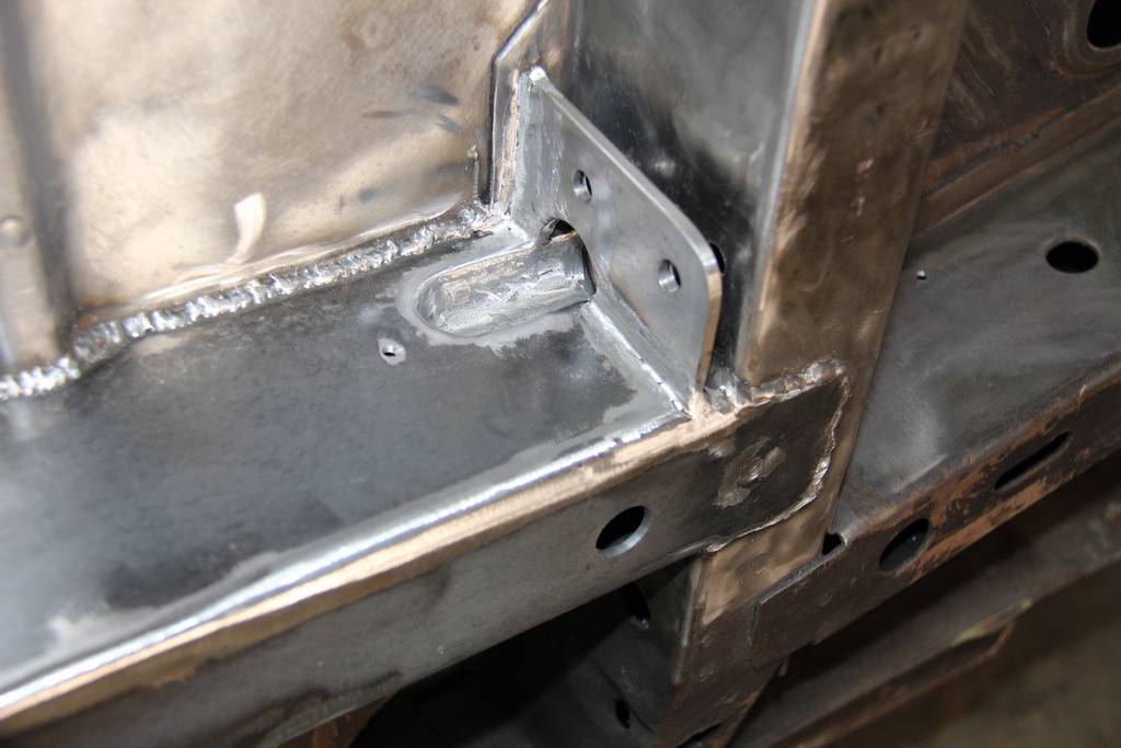

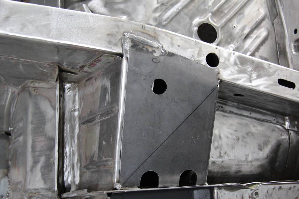

      Finished up a few details on the front of the frame connectors today. Front torque boxes are next.
      Thanks
      Pat

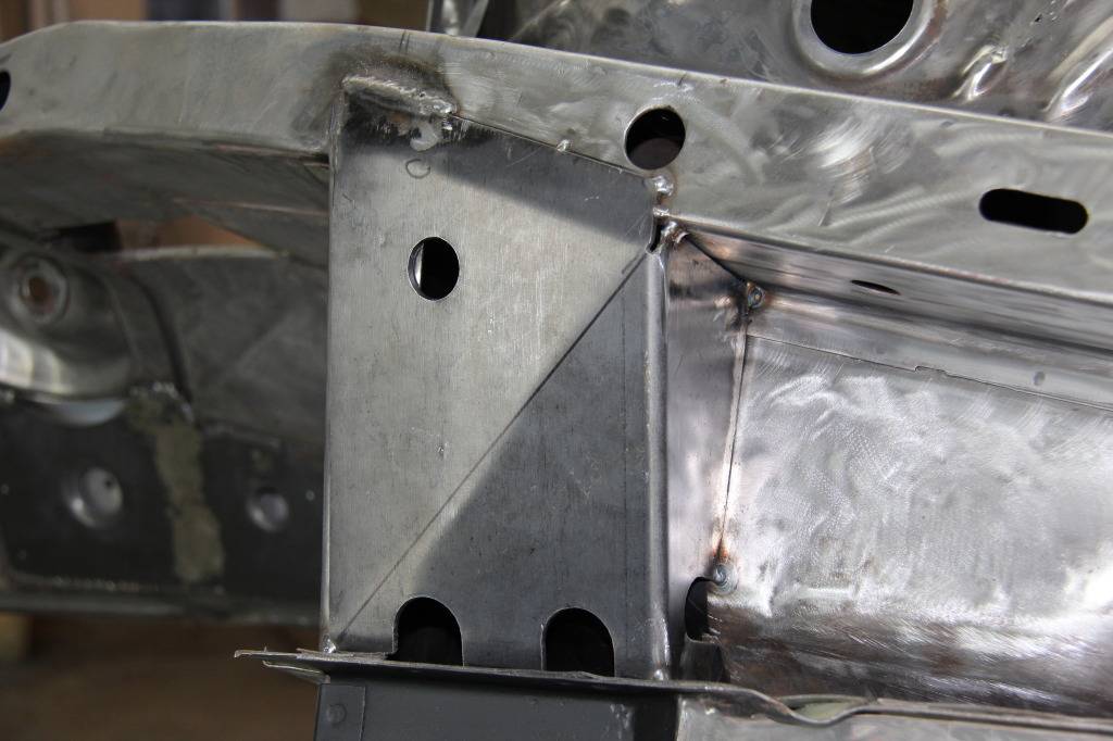

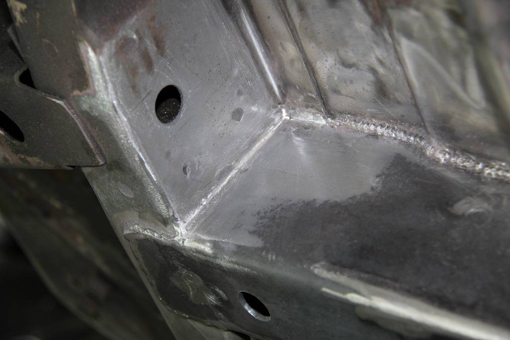

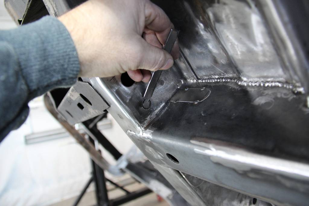

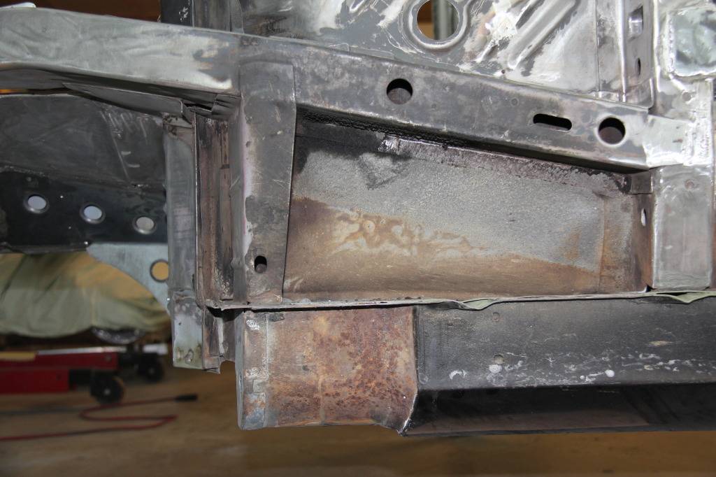

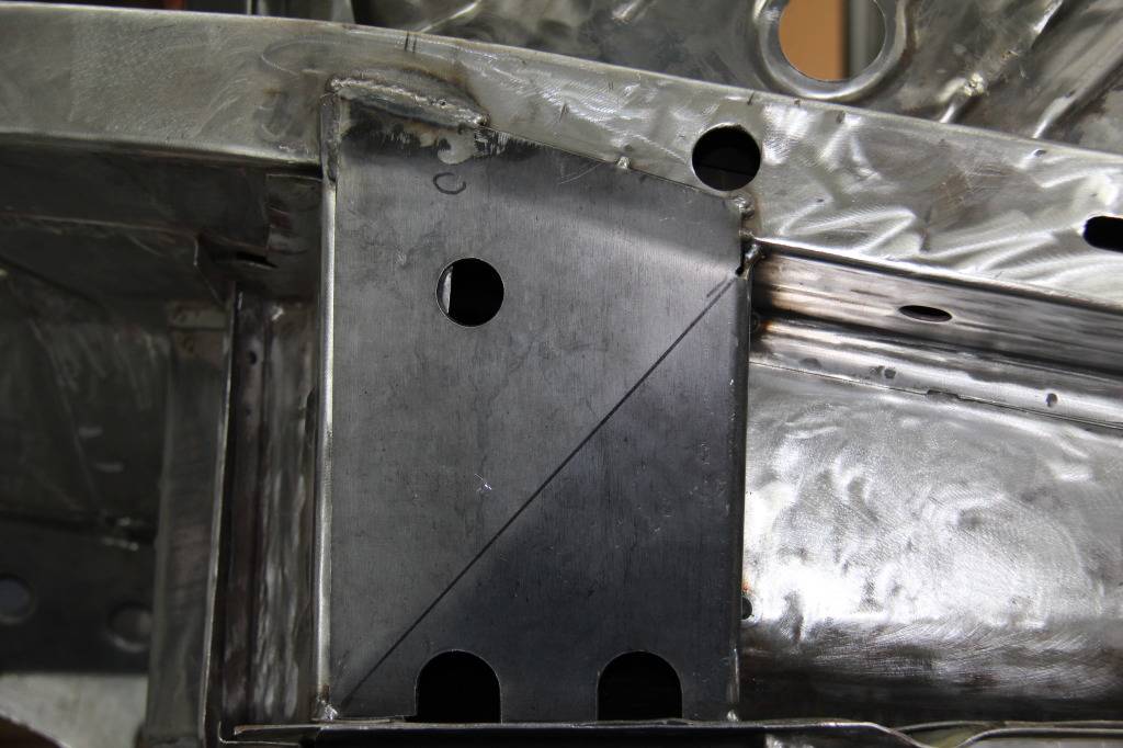

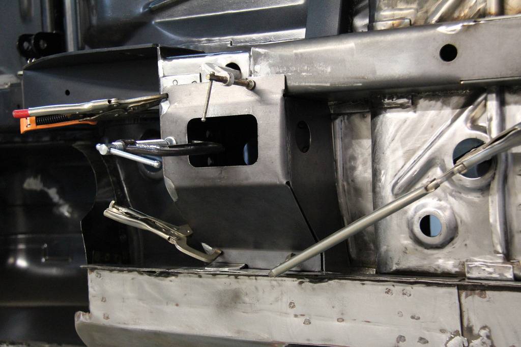

      Fit and tack welded the right front torque box. Had to bend the US Car Tool torque box on an angle and added ¼” along the floor side to get a good fit. Both sides will need the same alteration to fit correctly.
      Thanks
      Pat

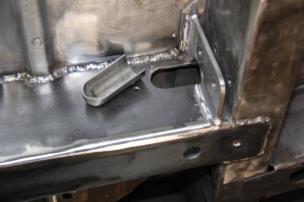

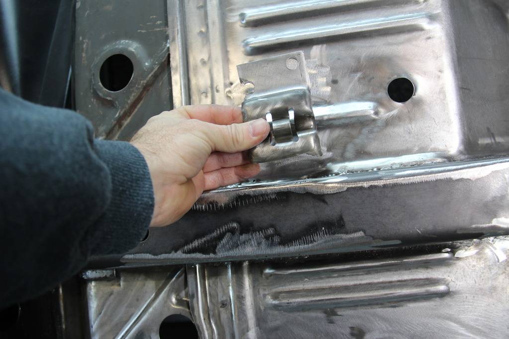

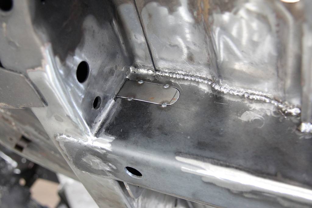

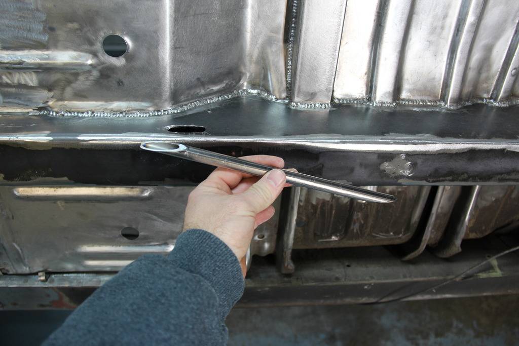

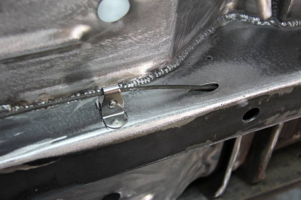

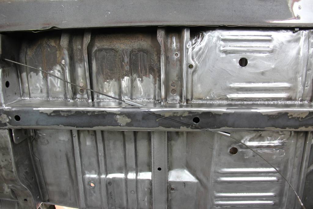

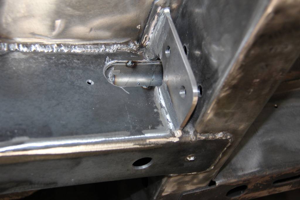

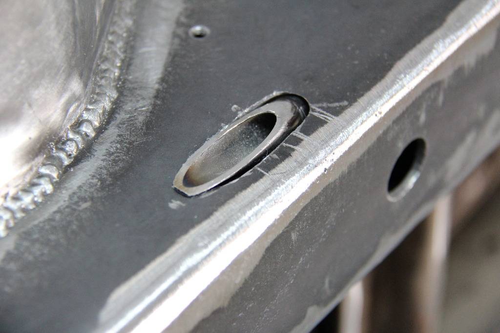

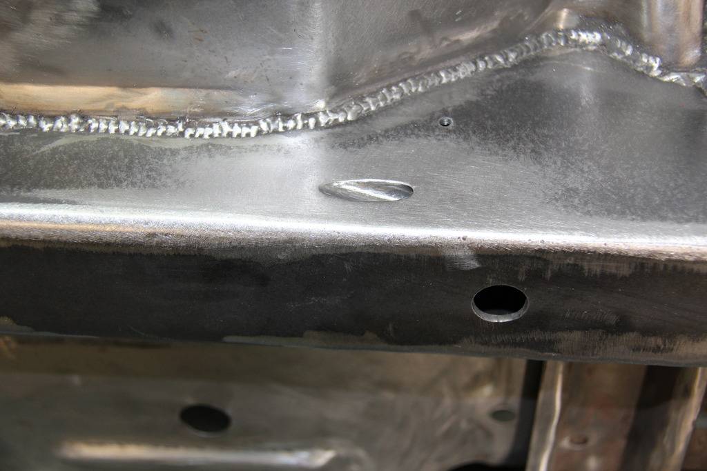

      Installed the parking brake cable pass-through tube in the frame connector. I also remove the original floor mount for the parking cable as I’m going to install a small roller to redirect the cable along the frame.
      Thanks
      Pat
