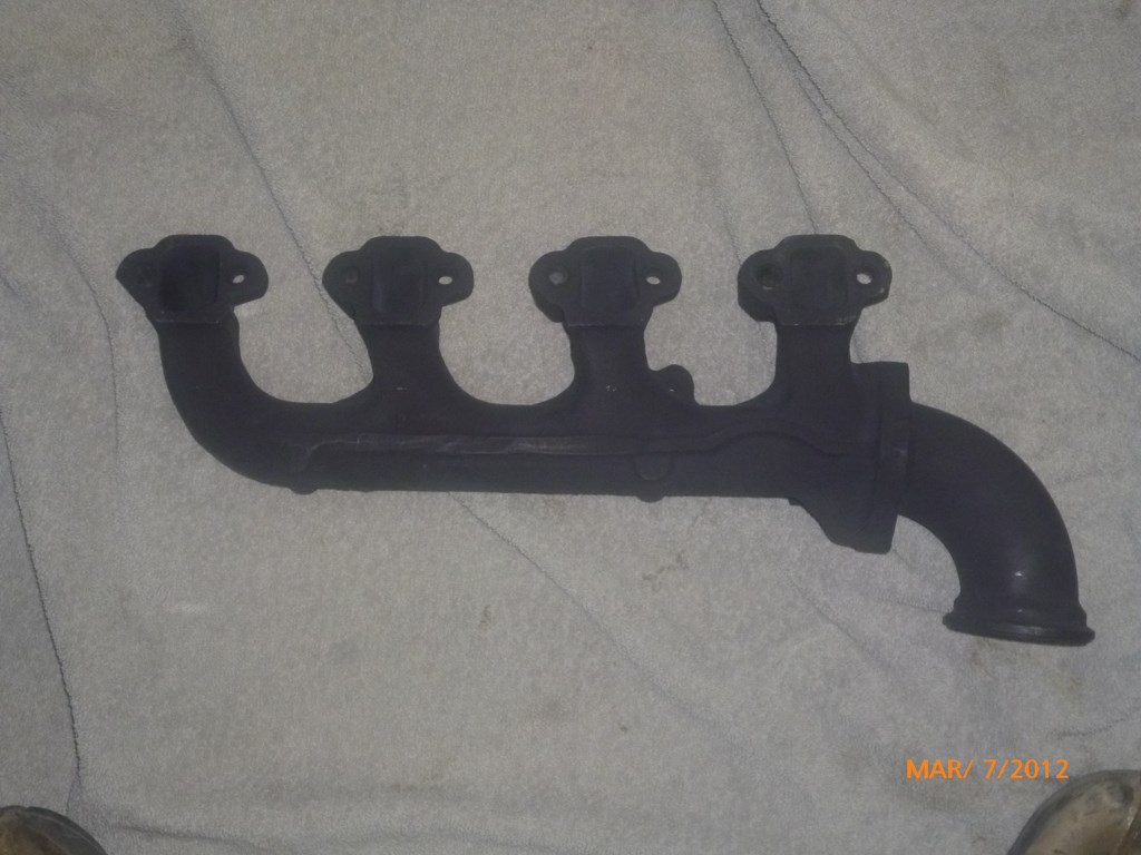

      I turbo charged my 68. Used some stock manifold, ported them and welded some elbows on.
      Here are some pics, hope it helps.Name:  P1010330 (Copy).JPG
