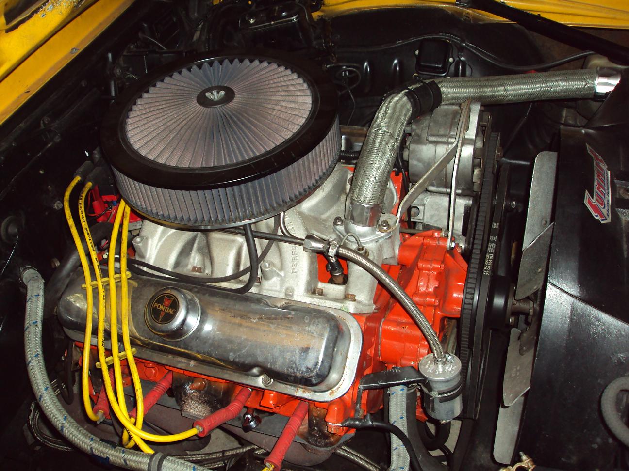

      Motor is 455 meca pump with 750 carb.
      Originaly fuel filter was in the carb in Pontiac Firebirds but as you can see in the picture, previous owner change carb. & add a big fuel filter before the carb
      Just curious, as my tank is not so new if this was a good or bad idea to add a fuel filter just after the tank ?
      Thanks
      Gil
