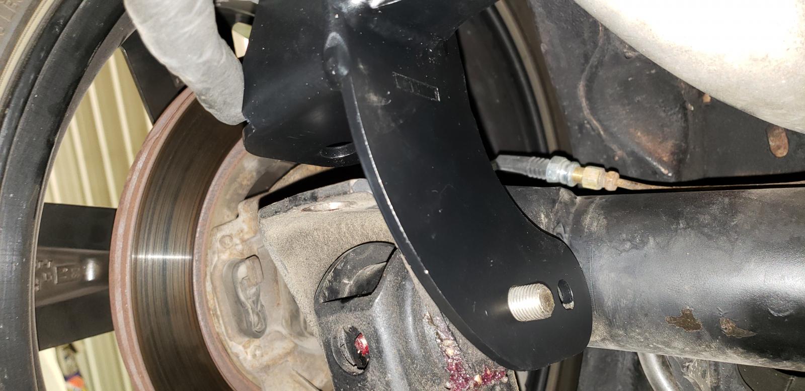

      Adding some more pictures. I added a monster stage 2 clutch over last winter. Added some more pics of my 3" exhaust x pipe to 2.5" mufflers and ,3" cutouts. Couple pics of the air compressor. I added Johnny joints in the rear axle housing for better articulation. And upgraded to the Holley crossmember. And added a oil pan trap door baffle.

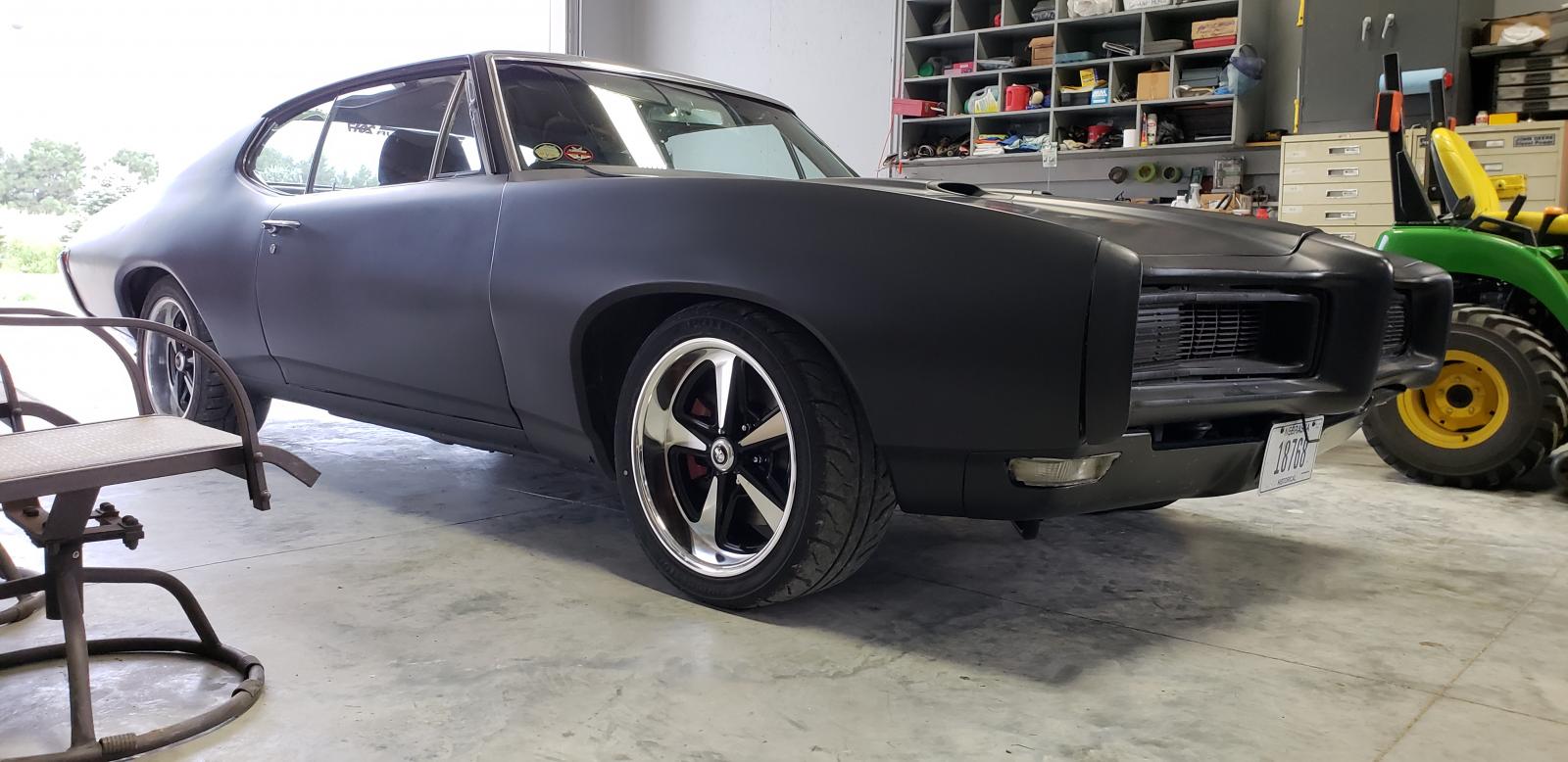

      Fall is here and driving days are literally numbered. Actually had some snow already. I wanted to dodo so real testing of the new spindles before posting. It drives much better and I believe there steering arms changed the rate or turn in. The front feels great. I did have to add all my shims into the lower control arm to get ride height back up where it was before with stock spindles and tall ball joints. The steering arms with ball joints installed rubbed my 17"wheels even with 6mm spacer. so after going back and forth with speedtech I purchased 18" fronts with 275/35/18 re71s I can tell they are stickier than the falkens. I had the spacer machined down to 3mm just to have more than 1mm between the spokes and 13" GTO/c5/c6 brakes. I was planning on going to 18s anyway so I knew what I wanted but wasn't planning on spending the money so soon.

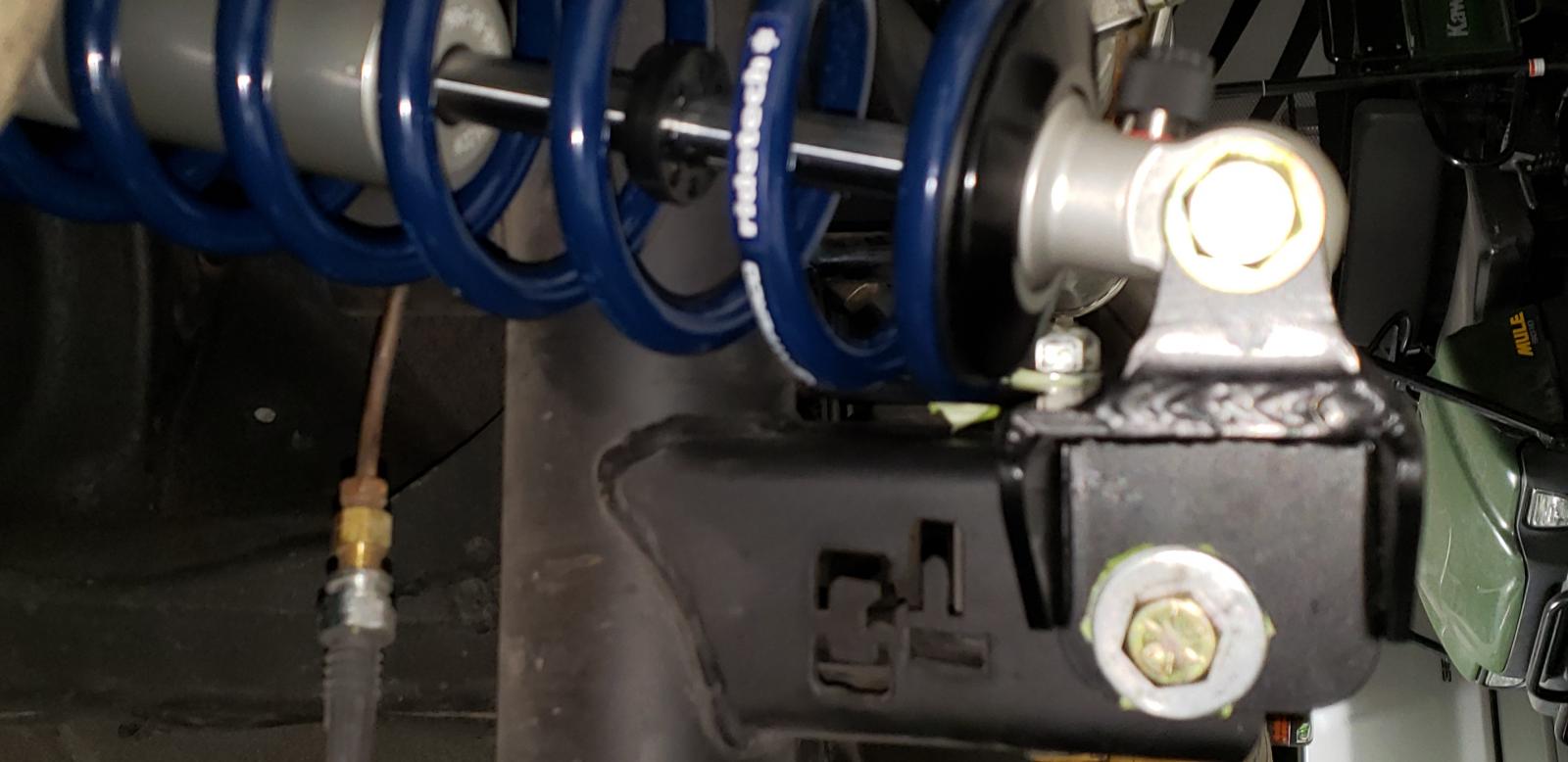

      Sometimes I wonder if anyone else works on A body cars. I researched on here all fall about ridetech shocks and ordered rear coilovers on a Xmas discount. When I got the car out of storage to put them on the ridetech moser bracket doesn't fit my quick performance housing so I'm making plates and spacers to make that bracket fit. And flipping the shocks like the g body thread I saw so the rest are in the trunk and the rebound is behind the tire. My tail pipes have to come off and need modified to not hit the coil overs. Name:  20190416_213533.jpg

      The lower mount caused some head scratching. I have a quick performance 9inch and ordered with Moser style axle mounts which are very similar but not quite. Quick performance said they are developing a mount with ridetech and advised to just make spacers to make the one I have work.
      I will have to redo my tailpipes to clear them but that's probably a good thing cuz they were prebent and not the best anyway.
