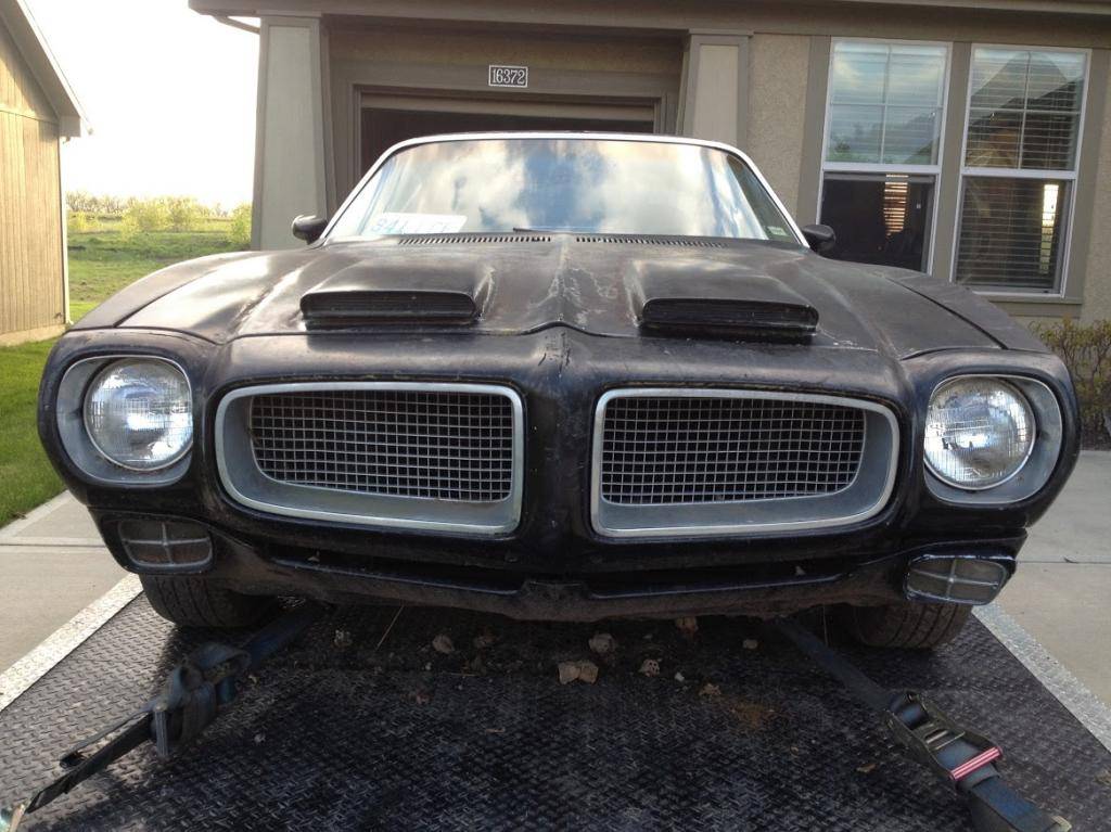

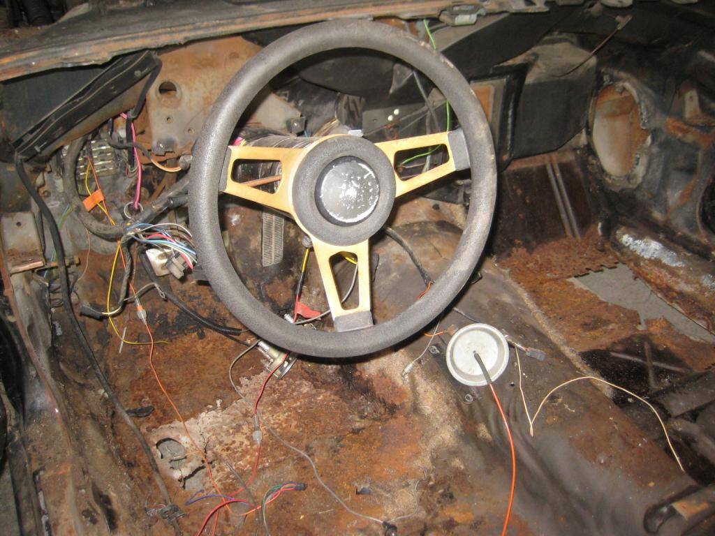

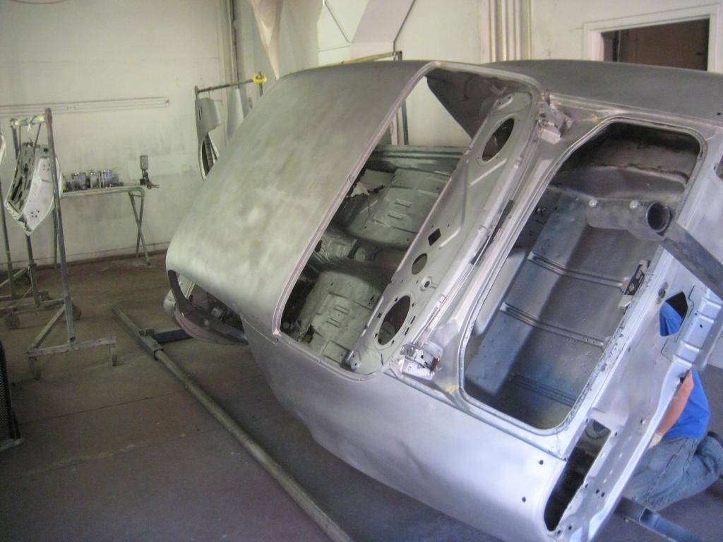

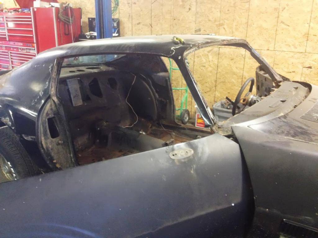

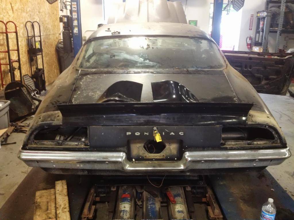

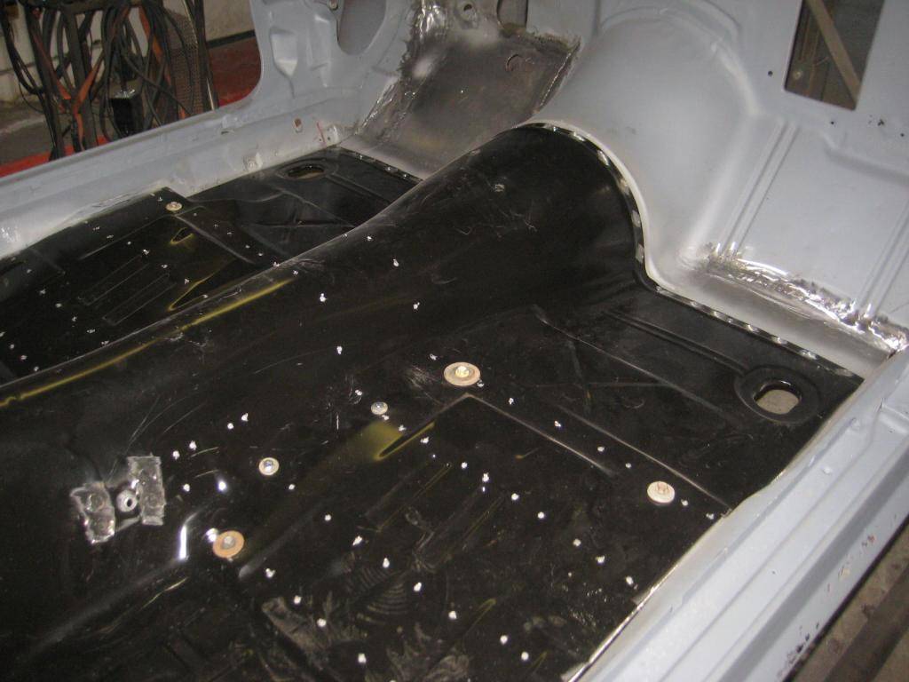

      Hey guys new to the community and wanted to share my project. Its a 1971 Firebird Formula 400. The car has been in the family for the last 30 years and has been sitting the past 12 years or so. The resto shop will be ready for subframe and suspension in the next few months and I need to figure something out. I want to go modern but not sure if I can spend $10k on everything. Has anyone looked into the speedtech performance torque arm setup? Or does anyone have suggestions on a complete setup that will get rid of the leaf springs and go full coilover? Thanks!
