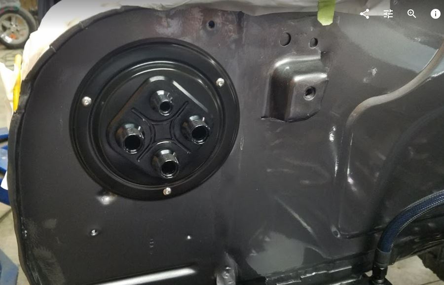

      Or you could kill two birds with one stone by putting the bulkhead in the hole. This in on a 2nd Gen.

      mklinger - where did you get that piece? Is that a single piece or is that a block off cover with the bulkhead then attached to it as a 2nd piece?
