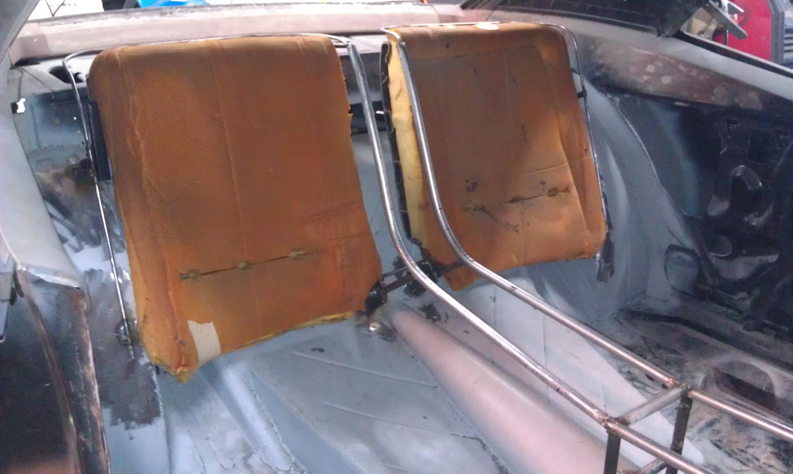

      Iroc -Z seats front and rear fold down
Size:  140.5 KBName:  IMAG0393.jpg
Size:  191.9 KB1988 Iroc-Z seats
      The seats are pretty beat up but I plan on having the foam re-done and add extra padding to make the seats look more modern and beefy.
