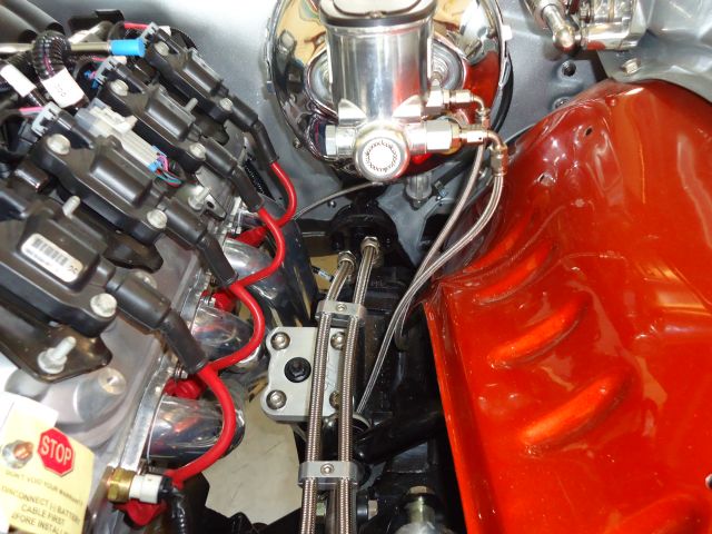

      ok....I was thinking there are some studs etc. that attached to the valve cover and then the FRC attached to the studs. Pictures are of the driver side of my engine.....dont see any studs long enough for the covers to attach too if your reasoning is correct. Maybe I am just missing the big picture on this....helpName:  DSC01048.JPG

      Have you tried clipping the covers on? They are pretty tight when attached to only the rails. Many aftermarket covers I've seen only use the fuel rail and not anything else.

      It may be different with the LS3 stuff, but there is extra hardware that was needed with my Vette LS2 covers. There is a post that screws into the valve cover that has a ball top that fits into a socket in the cover. I will try and find a P/N.

      GM part number 11609319
      $2.77 a piece at Pace Performance Parts.

      Awesome....I guess there is just 2 required per valve cover? Thanks!!

      Yep, 2 per side.
