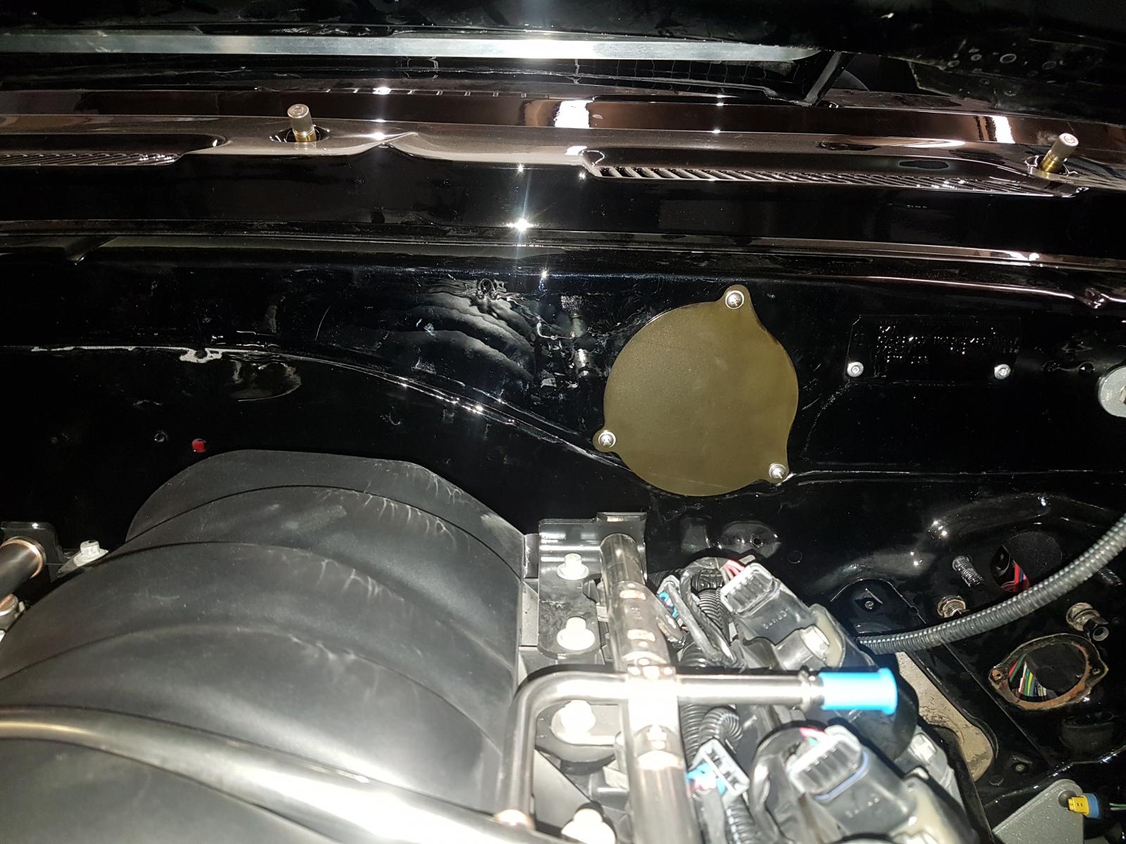

      Installed the rain gear, hidden wiper motor, fits great, easy to install and very well put together. I got the variable speed version, the metal knob and retainer were also a nice touch. Now to paint the cover, starting to wish I would have smoothed the firewall... Oh well.

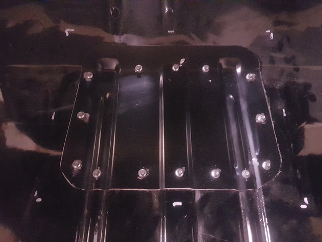

      Started on the rs buckets, things seem to be pretty straight forward, only thing not working out great is the AAW rs harness seems way to short ,routed it every possible way and can not get it to work, try again tomorrow,small update pic, i know this is basic stuff and not at all new, but hey its progress.......i can not believe how guys here are so capable of real fabrication ,i find it an uphill battle just to add bolt on stuff,but , it is fun, and frustrating..lol
      Edit: was able to get AAW rs wiring to work by taking apart some of the zip ties that they use and it made the runs longer in some areas, enough to make it work.

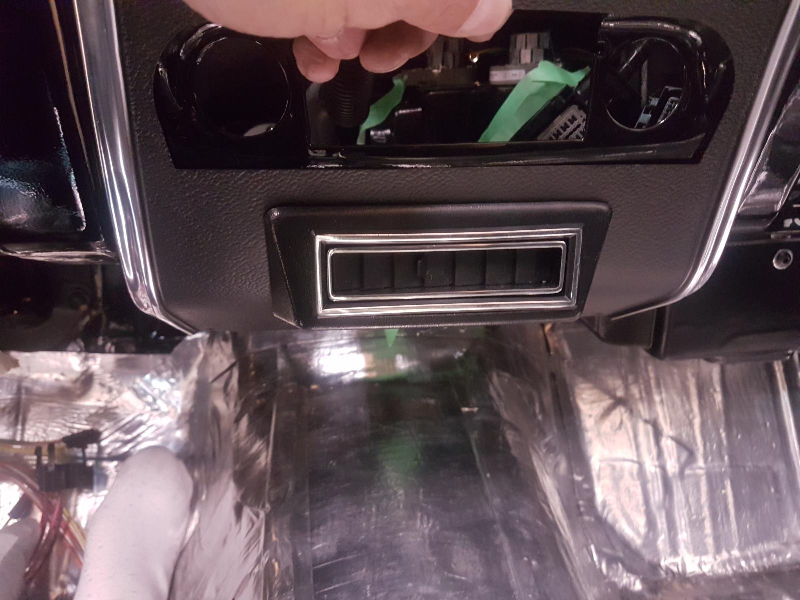

      Installing the vintage air, not going to put the centre vent in it's original spot, thinking about putting it in the ash tray spot.....

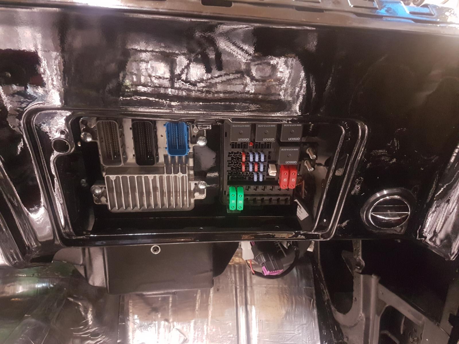

      Small amount of progress , test fit va, hoses are measured but not crimped yet, unit is fit, wow it's a tight fit for the ecu and fuse box if you mount them in the glove box, the vents are in, and I think I have a great fit for the vent to go in the ash tray location ,i still have to run the wiring but.....slow progress..

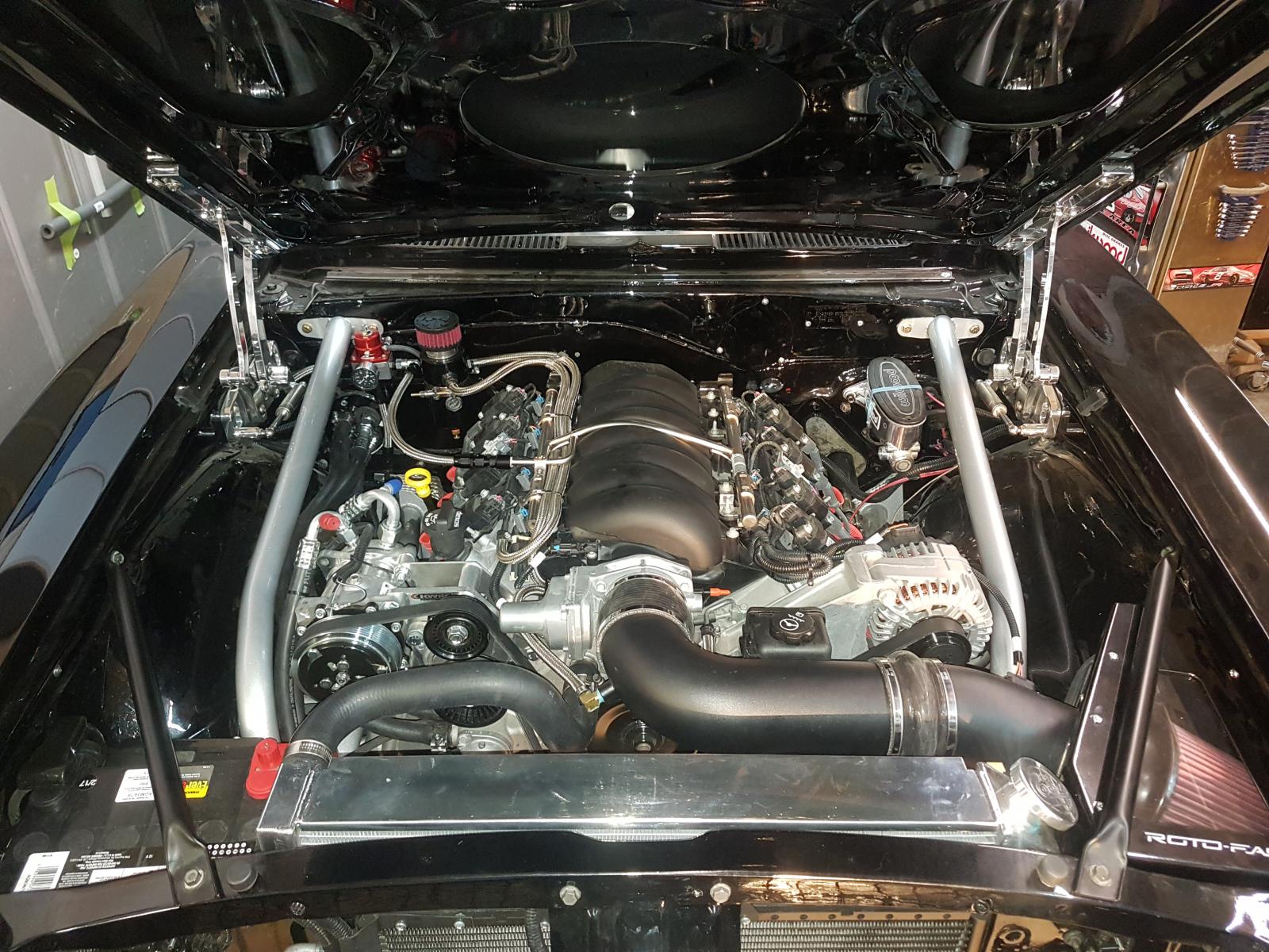

      Well i have finally finished front end wiring, which has allowed me to install some stuff in the engine compartment.
      -Installed-
      -cold air intake
      -fuel reg.
      -fuel lines
      -catch can
      -air cond/ heater hose lines, rad upper/lower hoses
      -battery
      still have to do brake master and clutch master,not a great pic but...progress

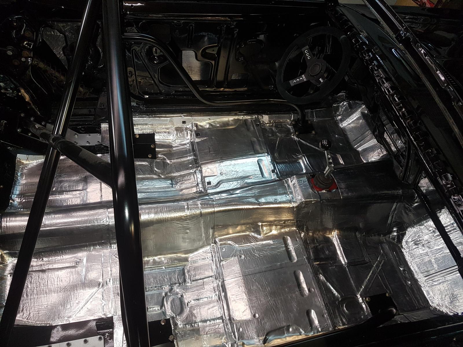

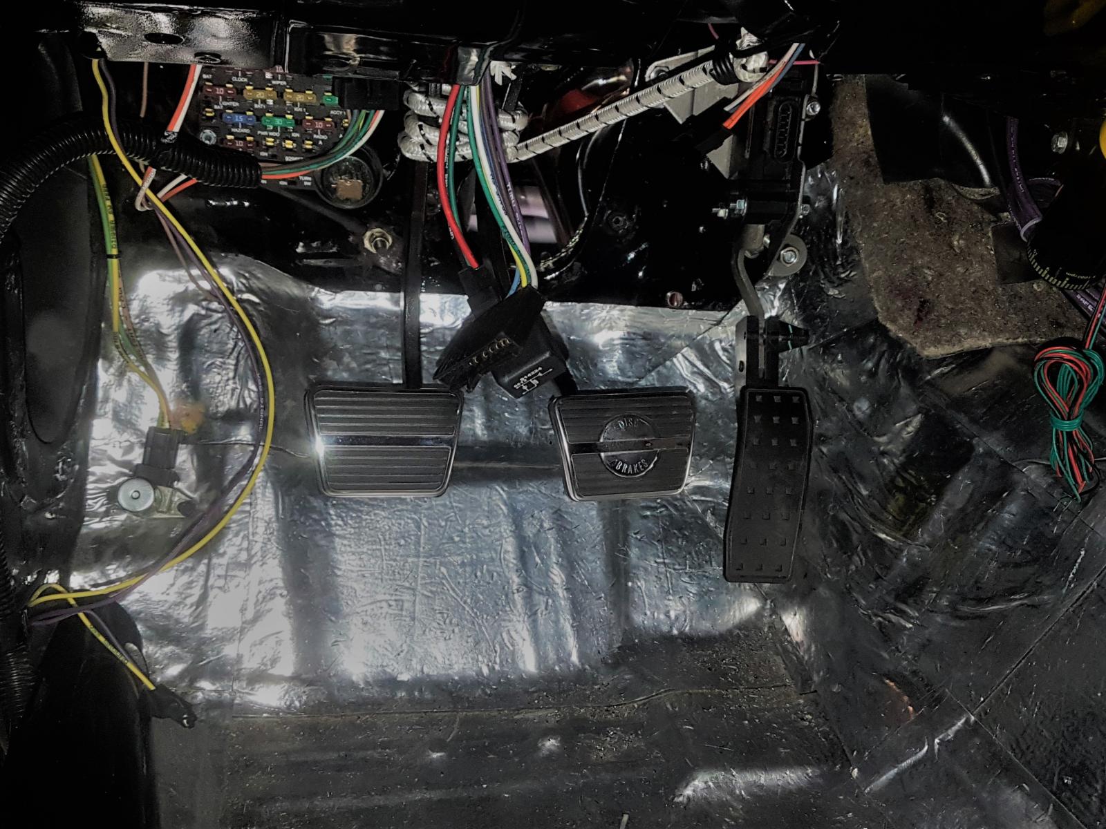

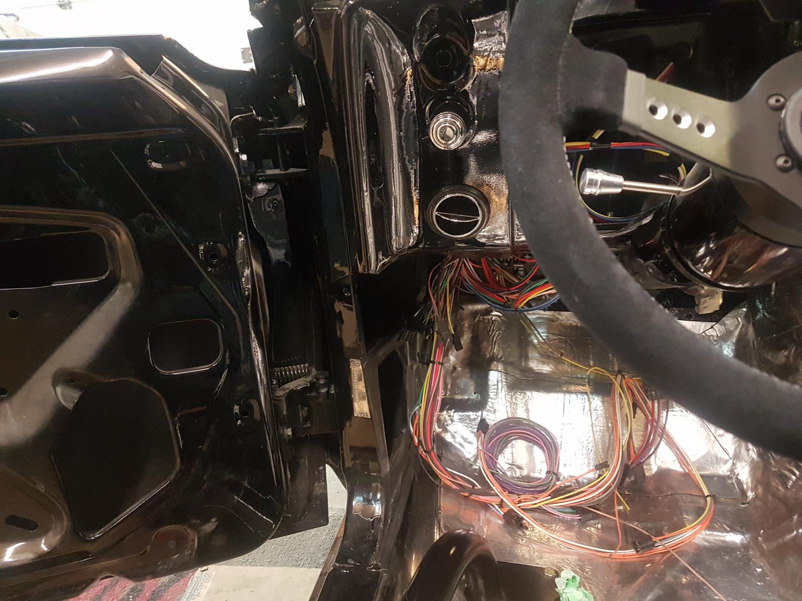

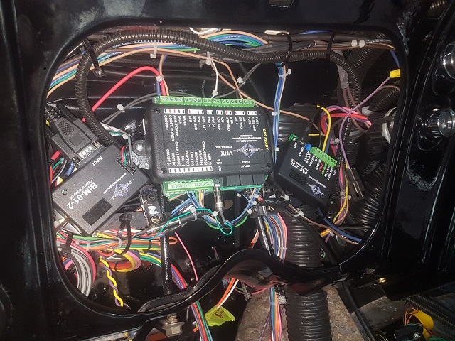

      Finally... winter is back and i am able to focus on the car again, i've finished the fuel tank , trunk access to tank , fuel lines, wired the pump and sender, rear of car is wired and now i am tackling the dash.... it looks cleaner than what the pics show but here is the dash area so far
      Name:  20171128_181133 resize.jpg
      This was not the final look , added sound deadener to floor and used different fasteners

      Very, very nice!! How do you like the Roto-Fab CAI box ?? I just ordered mine. What Radiator is that ?? Thx!
    13. #73
      Feb 2013
      Saskatchewan, Canada
      157
      Quote Originally Posted by DT69Cam View Post
      Thanks, i am totally impressed with the Roto-Fab CAI, it fit well and blends in nicely, over all quality appears to be exceptional, the rad is a BeCool .

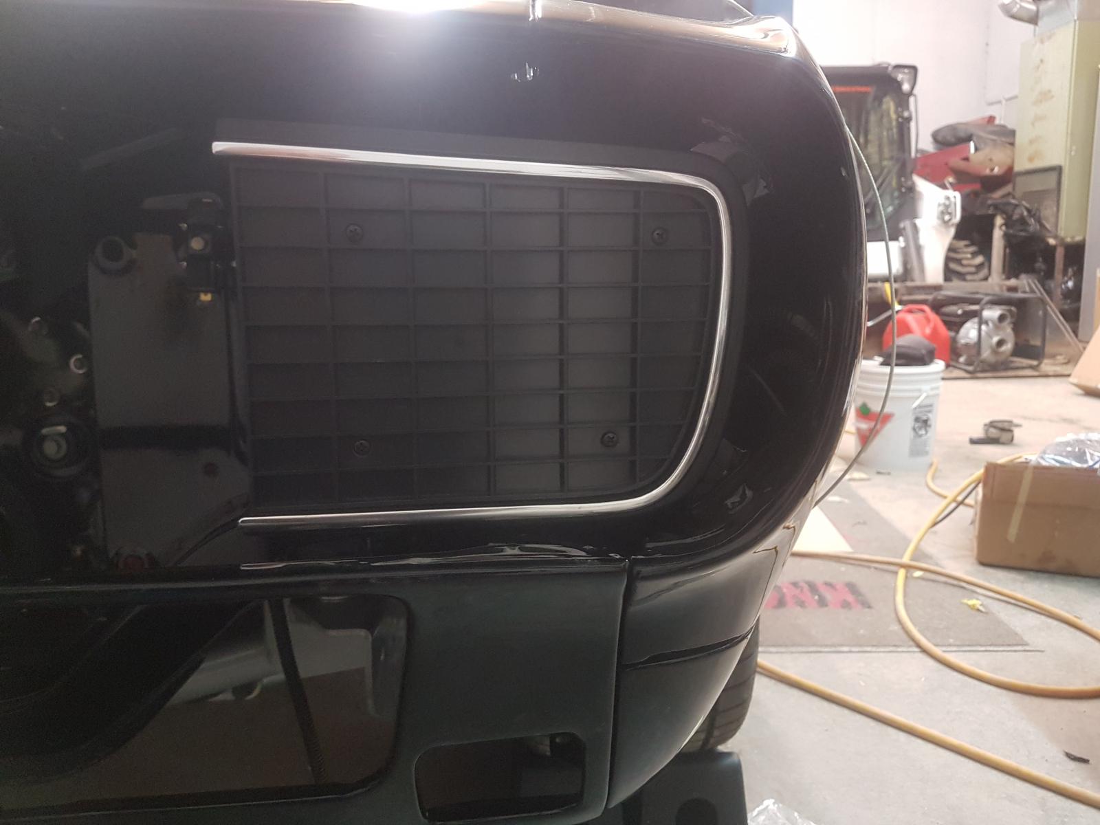

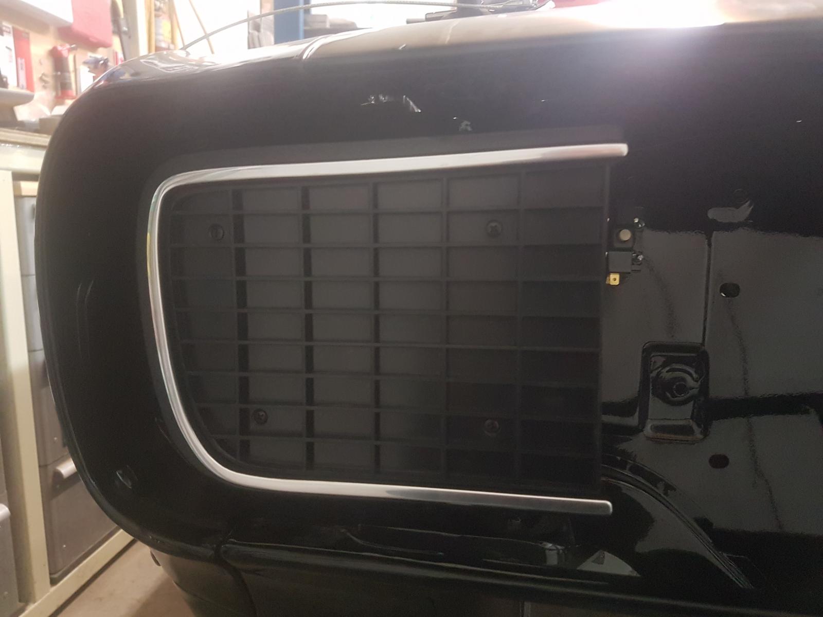

    17. #77
      Feb 2013
      157
      Made the decision that i'm only going to use hood pins and ditch factory hood latch and catch.... so i figured that the bright light indicator on factory gauge cover isn't used with a DD cluster, it may work for a warning light if hood isn't shut..
      using a Alarm Security Adjustable Pin Switch at the hood, it should be a good way not to forget hood open, its very bright and impossible to ignore.. i hope.
