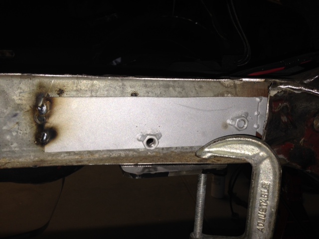

      I am doing the same ridetech 4 link in my Camaro. Is your mini tub complete or are you doing it simultaneously? I am mini tubbing mine at the same time as the 4 link install, so I made a brace to slide inside the frame rails while they were cut open with nuts welded to it. I rosette welded the brace to the inside of the frame rails. This way the ARP bolts will engage into a full grade 8 nut as opposed to a sheet metal screw into a 16ga frame rail.
      I have seen others run a bolt through the frame rails. If you go this route, you will have to weld in a sleeve so the bolt doesn't compress the frame rail when tightened.

      I can't take credit for installing the braces inside the frame rails. While researching the install of the 4 Link, I came across a few threads on this website of others that have done it this way.
      If I were not mini tubbing my car, I would bolt it in the manner that Randy recommended AND weld the bracket in at a few spots.
