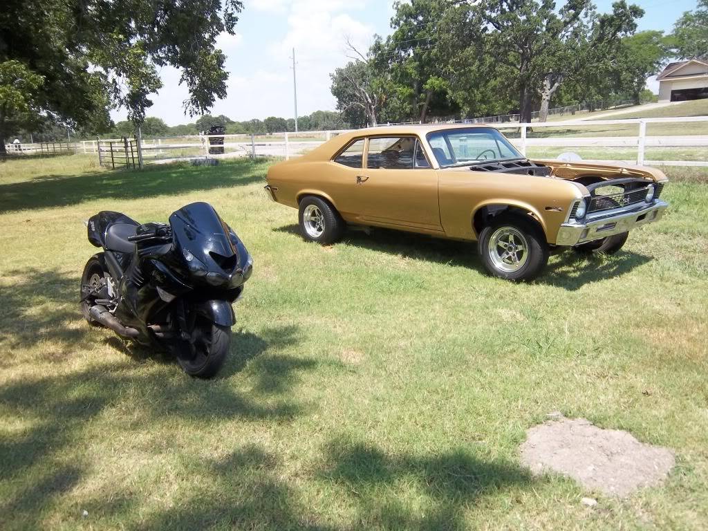

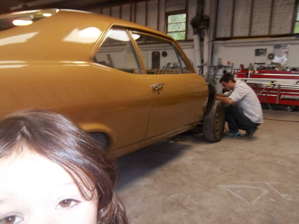

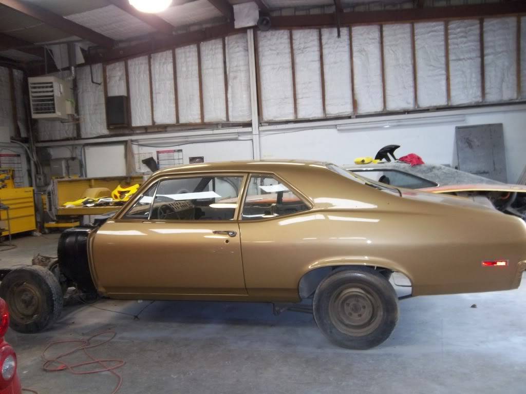

      I worked and in my spare time the girls would come help me after school. I tore the car down had it silica sand blasted and the same day pulled it into the paint booth zchromed the body and por 15'd the undercarriage and bedlined the floor pans. I proceeded to block the car the following day then primer that day block again that night and put a thin coat of primer one last time before calling it a day. The following day I blocked the car after work pulled it into the booth and sprayed it. So from the day they sandblasted 3 days later it was painted with all work being done by myself.
      Next I purchased bumpers and a set of wheels and new taillights etc... Also I forgot to mention I had installed a 1969 Nova taillight panel the morning before they sandblasted it.

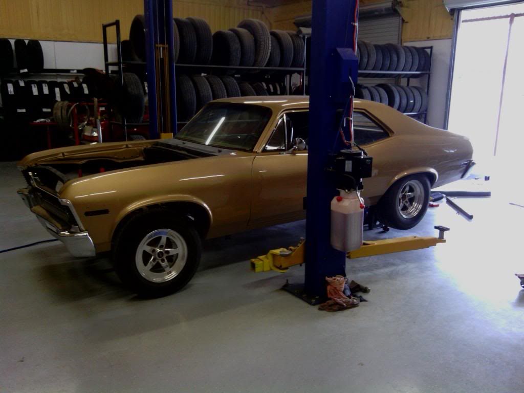

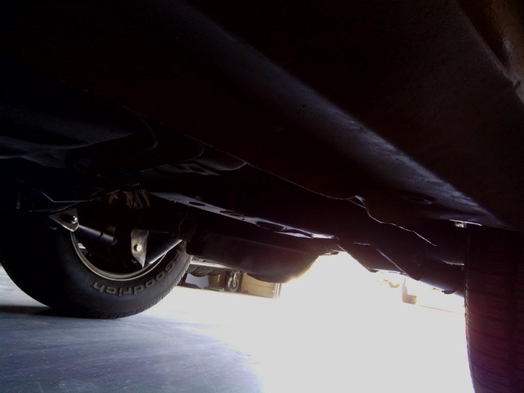

      I loved the wheels and had planned on removing the caltracs and leaf springs and going with a ridetech kit but after much research I decided the ridetech kit not being as strong as what I needed for the amount of power and launching the car will do. So I mocked my sheels up and looked for an alternative and something that would handle good and be what I needed. I came to the idea of a gbody or 8.8 factory style 4 link with adjustable arms. I called many shops and most said it was a dumb idea etc and after much frustration decided i'd just do it myself.

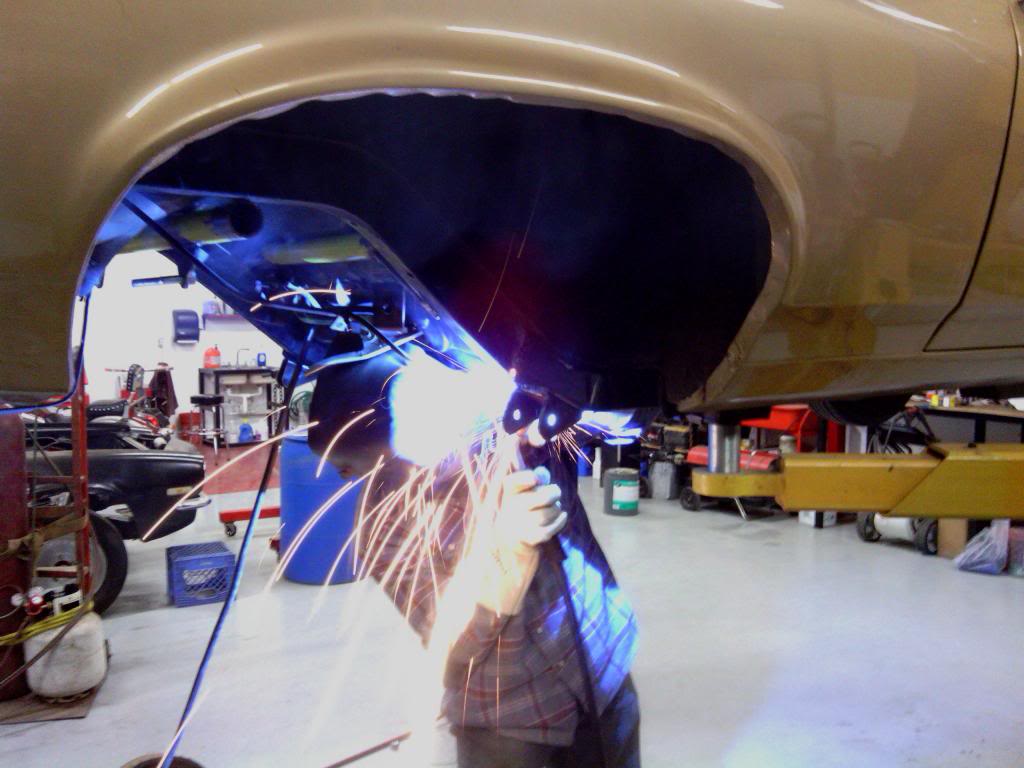

      I looked at the dse wheel tubs but couldn't bring myself to spend so much on sheetmetal.. I talked to a fellow car enthusiast and decided i'd build fiberglass wheel tubs 1/2 " thickness. Which work great. ;)

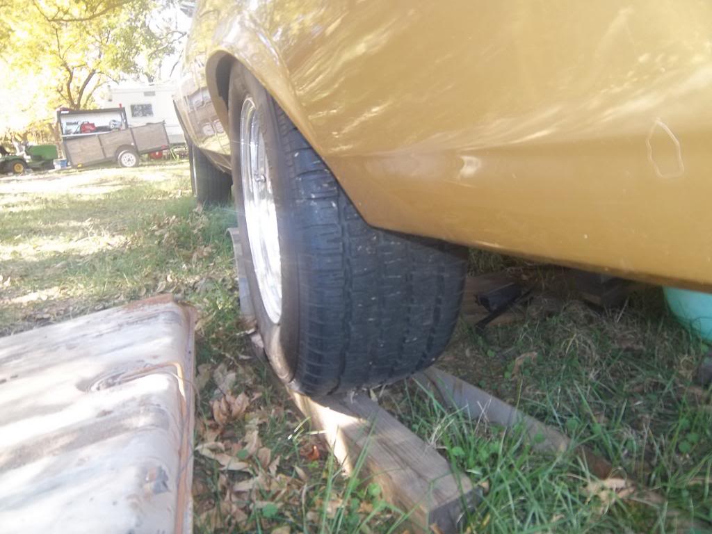

      The lower arms I had to remove 2.5 inches to get them where I wanted the uppers just had to be turned in alot to get the placement and movement where I wanted. Normally with a softer suspension this would pose a problem but im running the suspension stiffer and knew it would compensate. After installation I had to wait for my upper coilover mounts to come in so please excuse the coilovers being at such a steep angle it was just temporary.

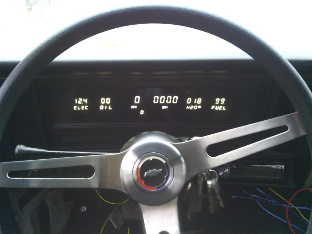

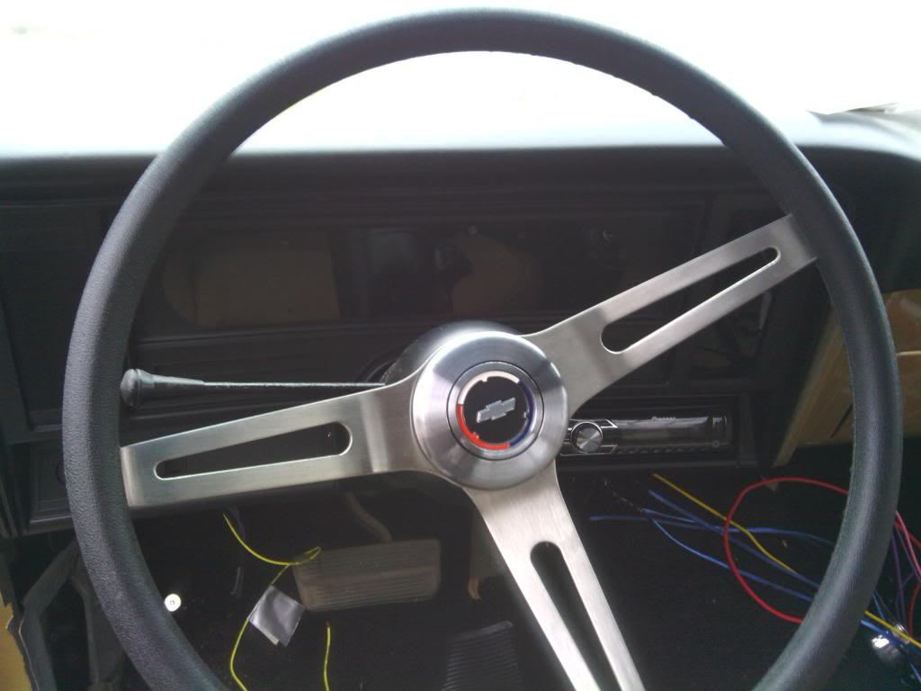

      I installed new interior in the car along with a custom guage cluster. Not feeling like spending so much for dakota digital I went with a all use made intellitronix cluster and made it to fit.

      love the gauges.. planning to purchase them for my build as well... how tricky were they to get up and running? Heard they'er pretty painless.

      Great build love the do it yourself moto. What color code is the gold?
      Feb 2014
      6
      The color was actually a landrover orange gold I added silver to to get the orange out and get the tine I wanted. Dupont for the win. ;) Im a painter/body guy..
