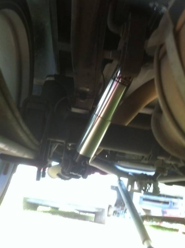

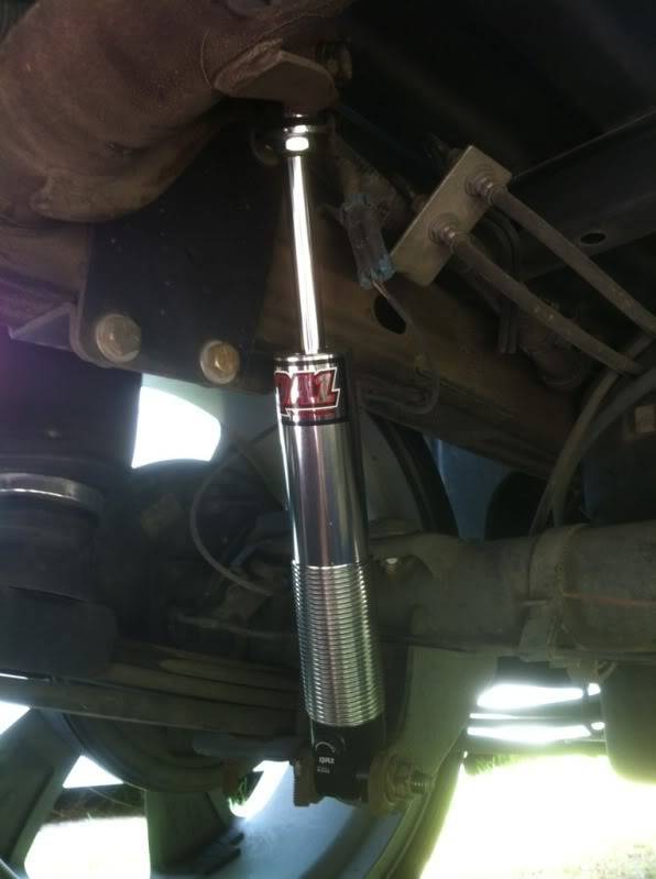

      Thanks for the reply... This is what i have now

      It is hard to see in your pictures what you have there. I am having a hard time finding some pics of the different ends. You should not notice a huge difference between the two when driving
