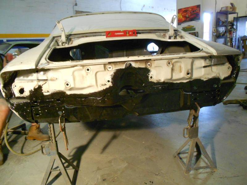

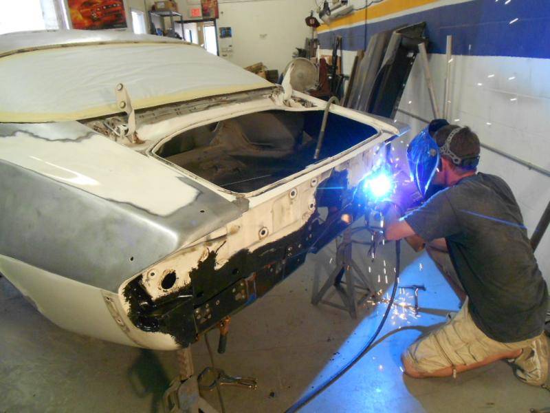

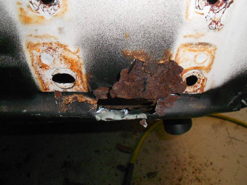

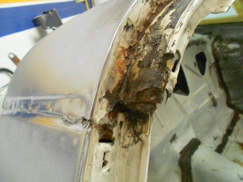

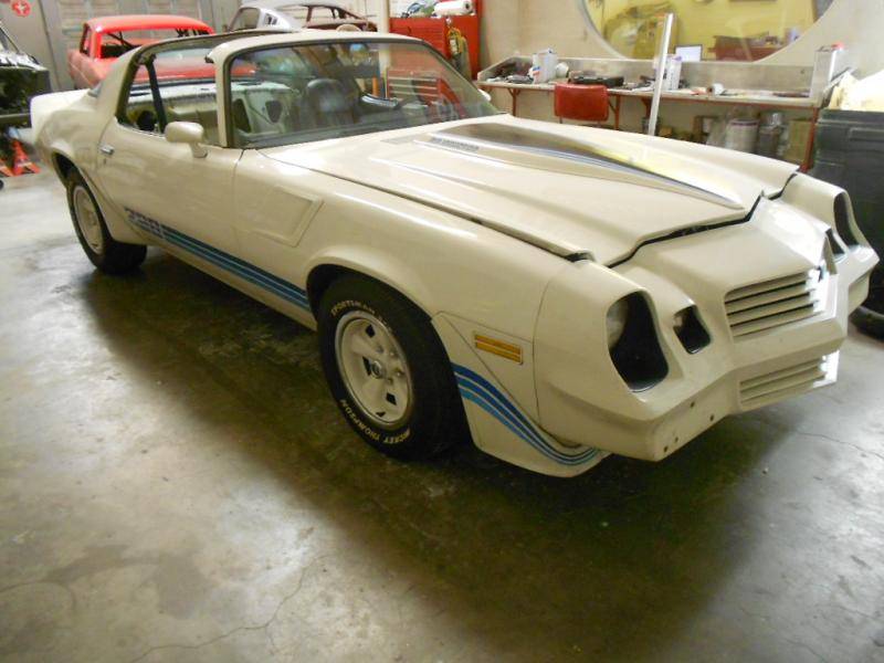

      When this first came in we thought we could do a quick paint job, update the suspension and brakes make it a roller so the customer could install a GM crate engine. The owner bought it sight unseen but had it inspected. At first it looked great.

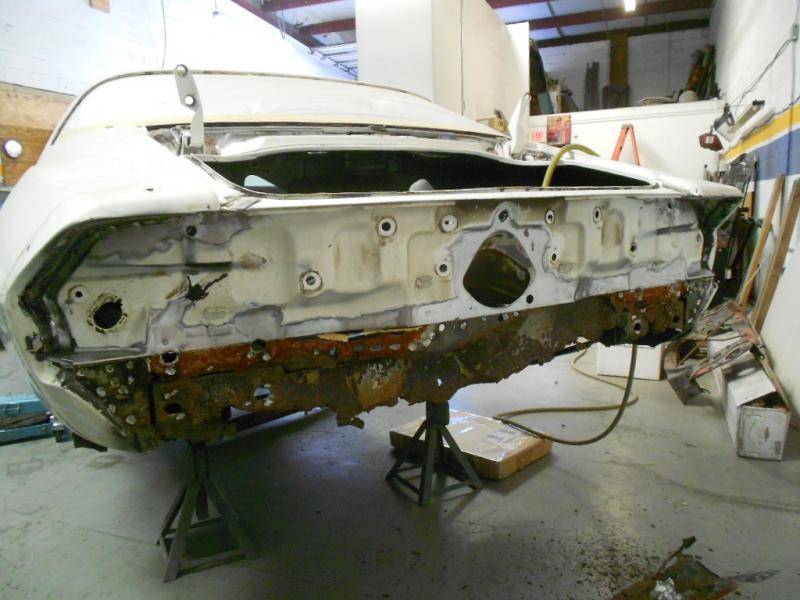

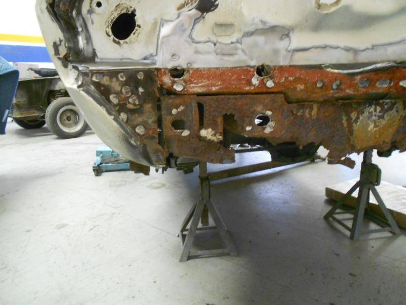

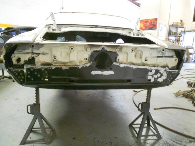

      We removed the rear bumper and found this.
      Cut out the first layer of rust

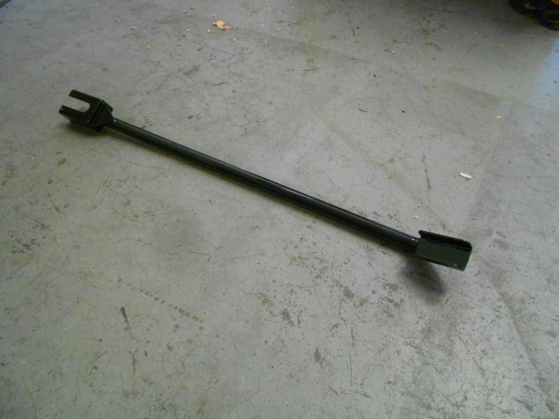

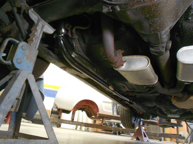

      One of the first things we did was install Global West subframe connectors

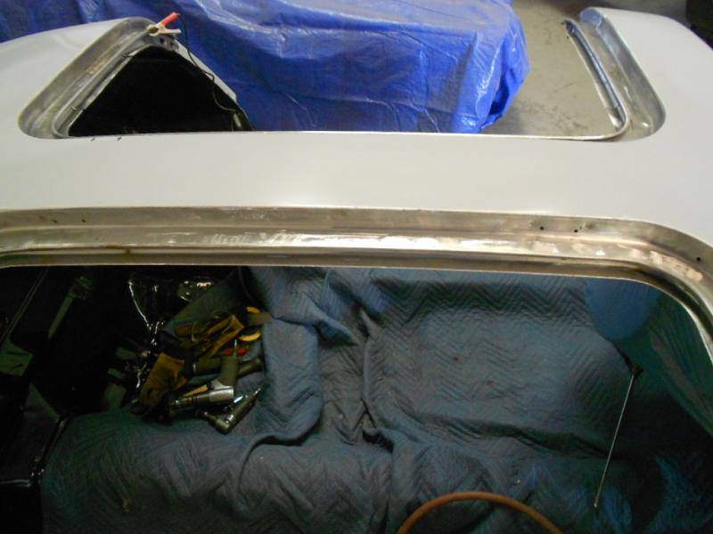

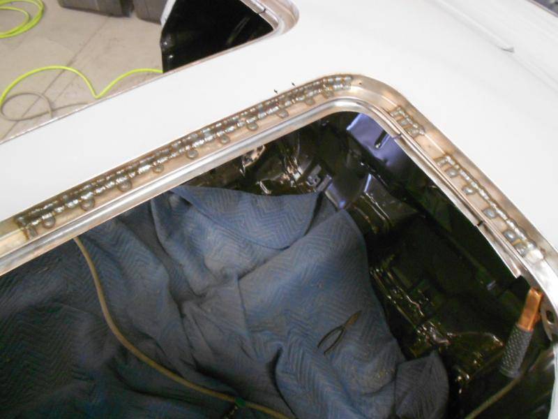

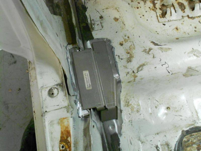

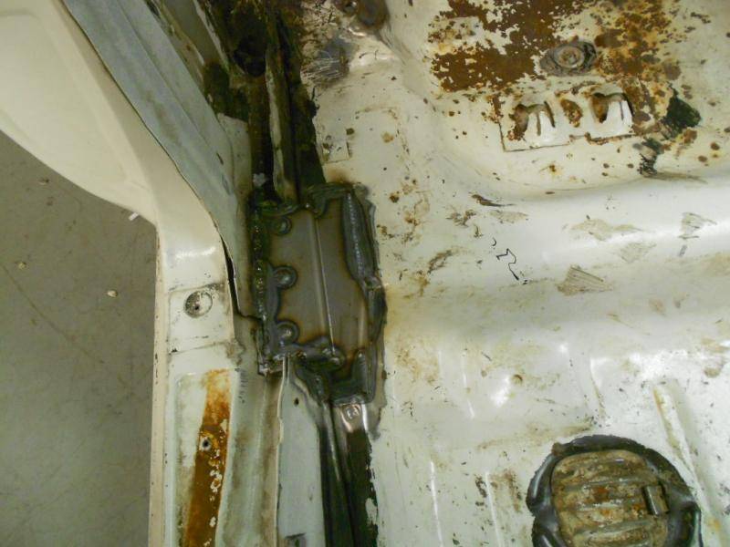

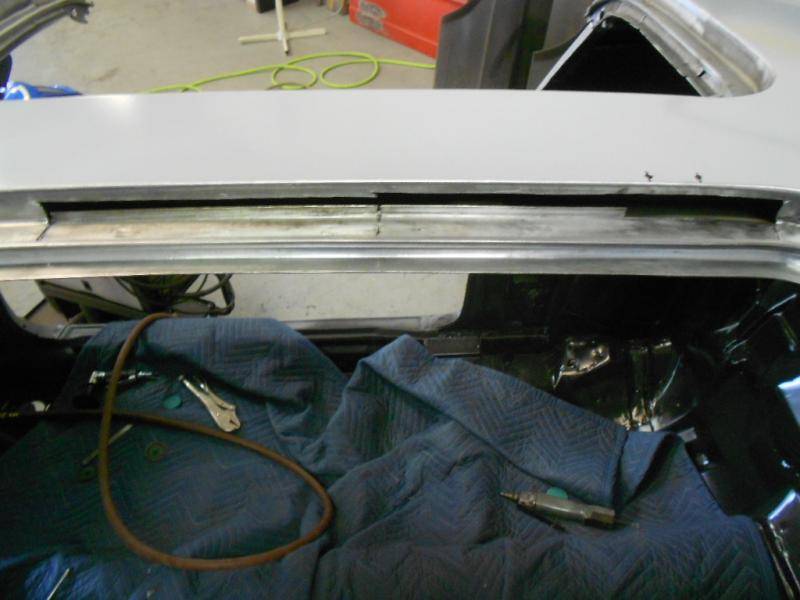

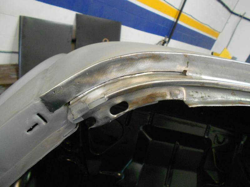

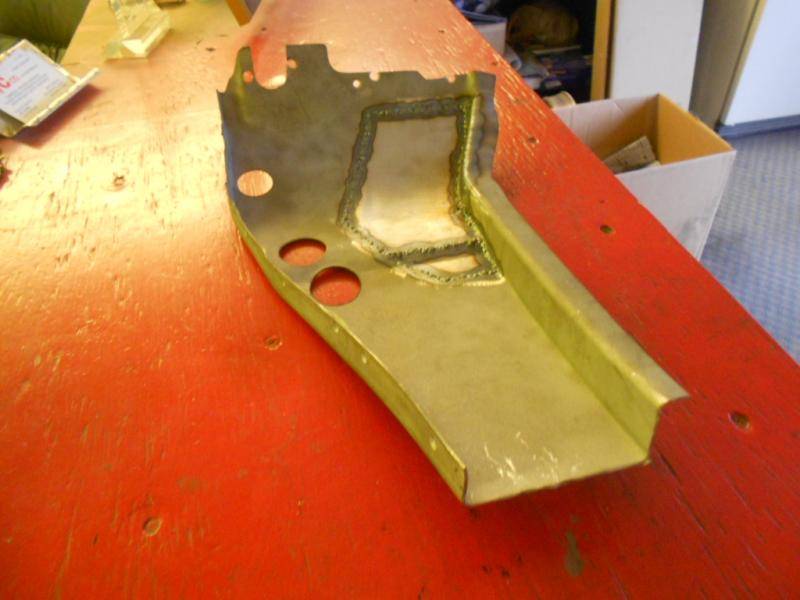

      The T-top channel had rust that Brian had to cut out and fabricate patches

      Wow, those repairs look great!

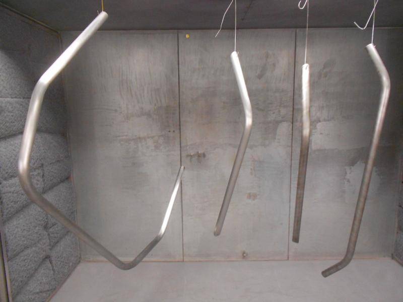

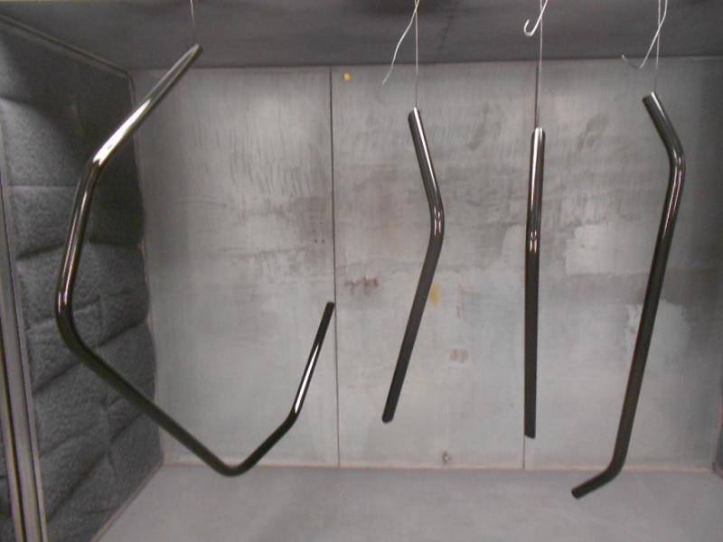

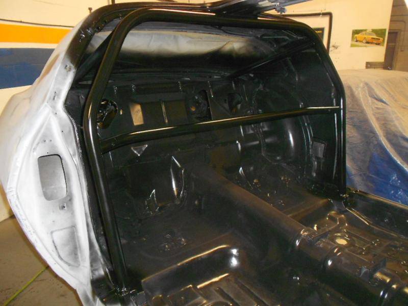

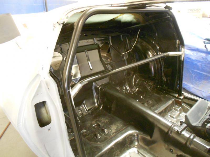

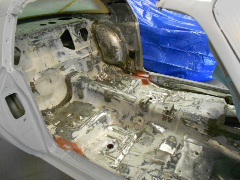

      The owner ordered a DSE roll bar made for a 1980 Camaro.

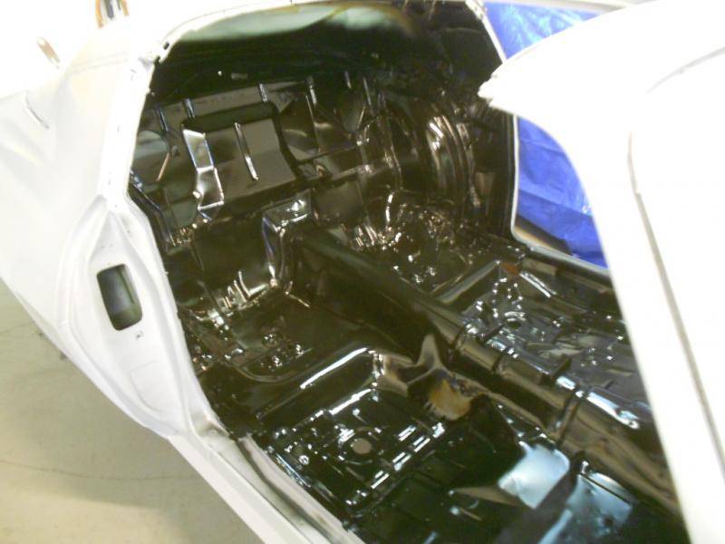

      Sanded and epoxy primed
      Before installing the roll bar we had to patch a few small holes in the floor and sand followed by a couple coats of epoxy

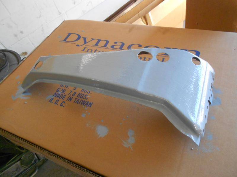

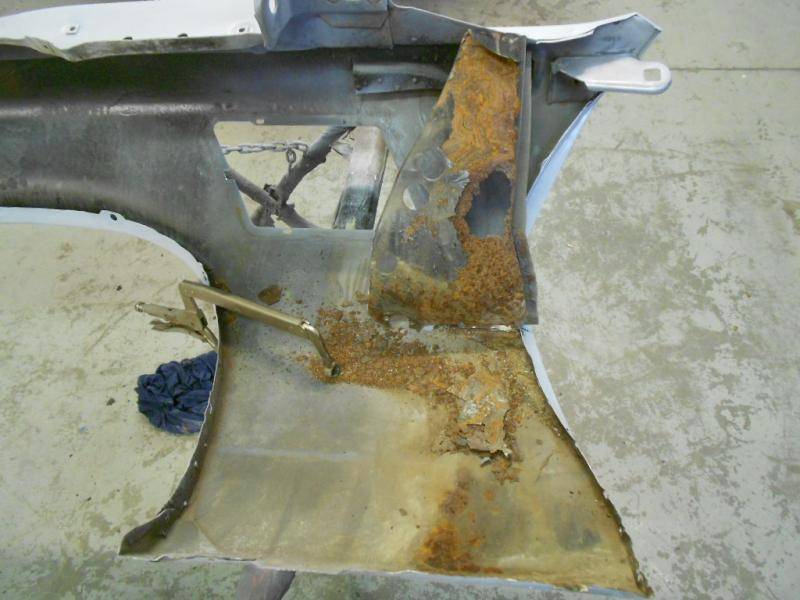

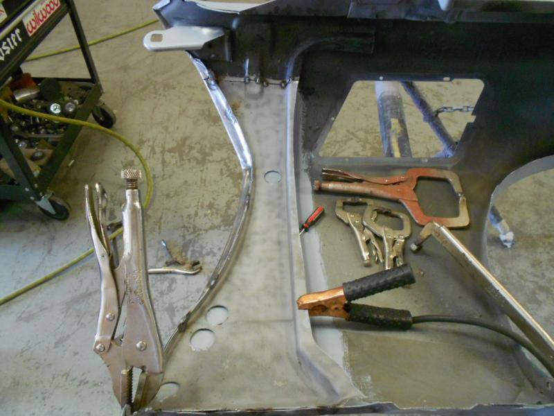

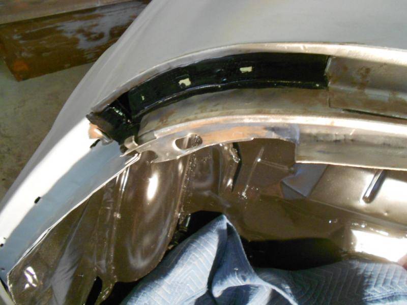

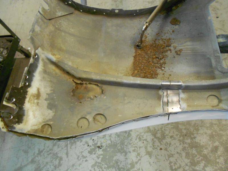

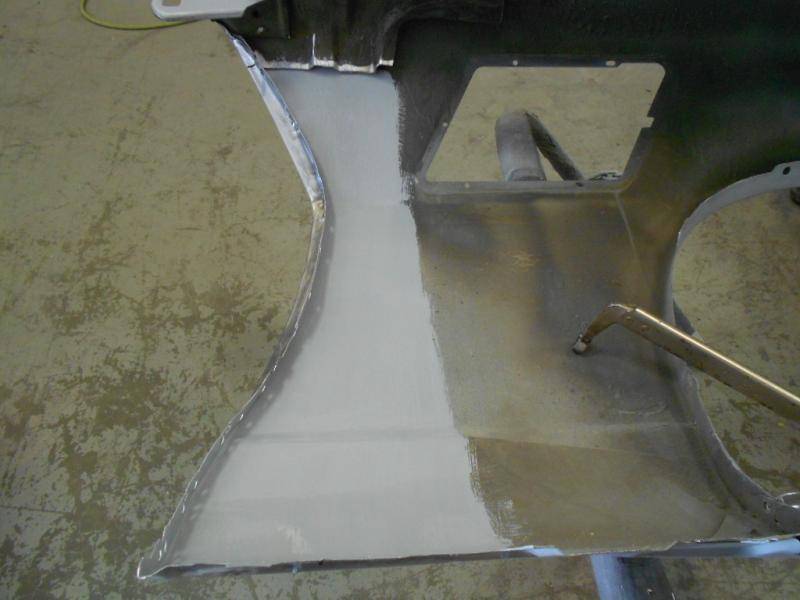

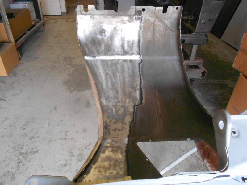

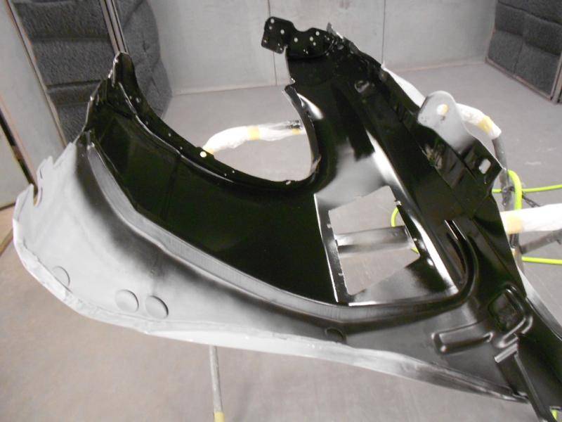

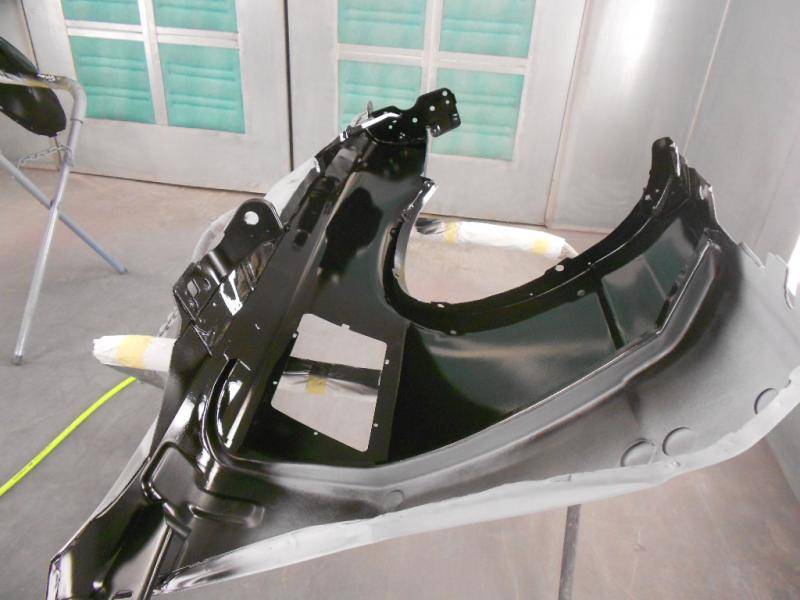

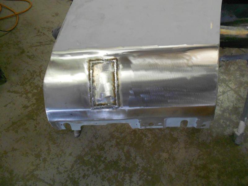

      The right fender had rust in the brace plus a small spot on the fender. This is what it looked like under the brace.
      The left fender did not have any rust showing but the owner wanted it taken apart and epoxy primed also.

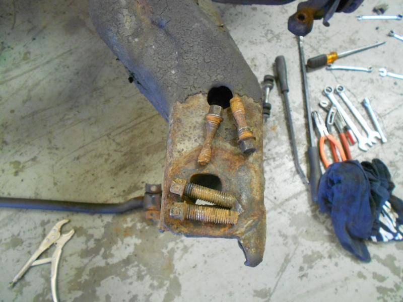

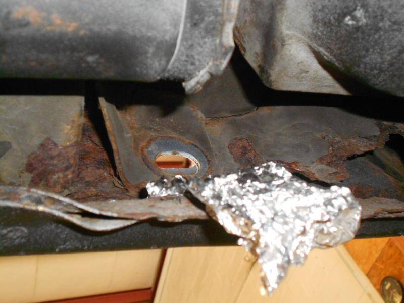

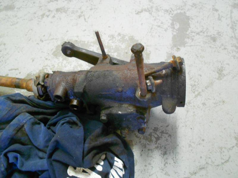

      As we were taking the front end apart we noticed we had a rust problem where the steering box and sway bar bolted to the frame
      Sway bar bolts
      There was a lot of rust inside the frame

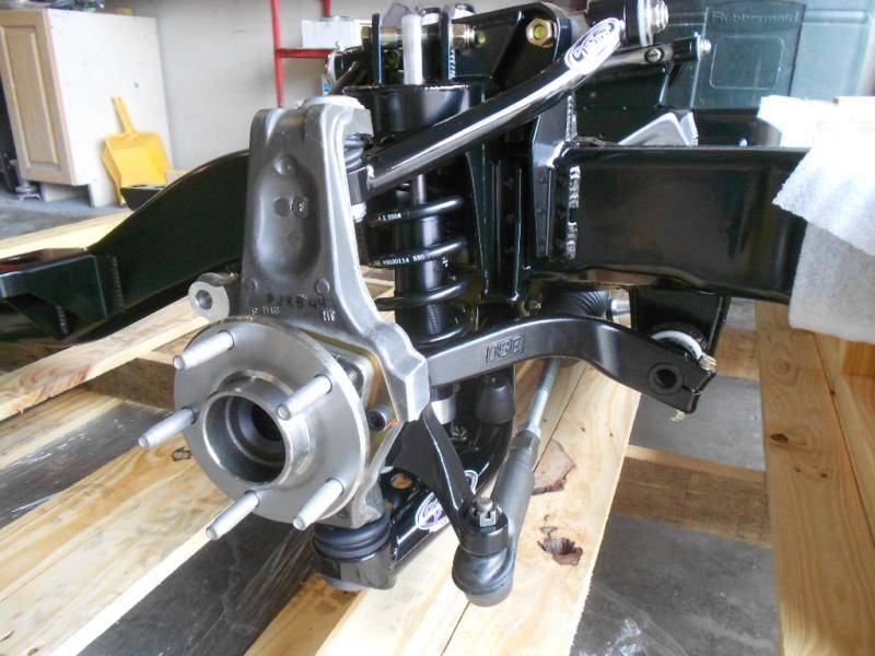

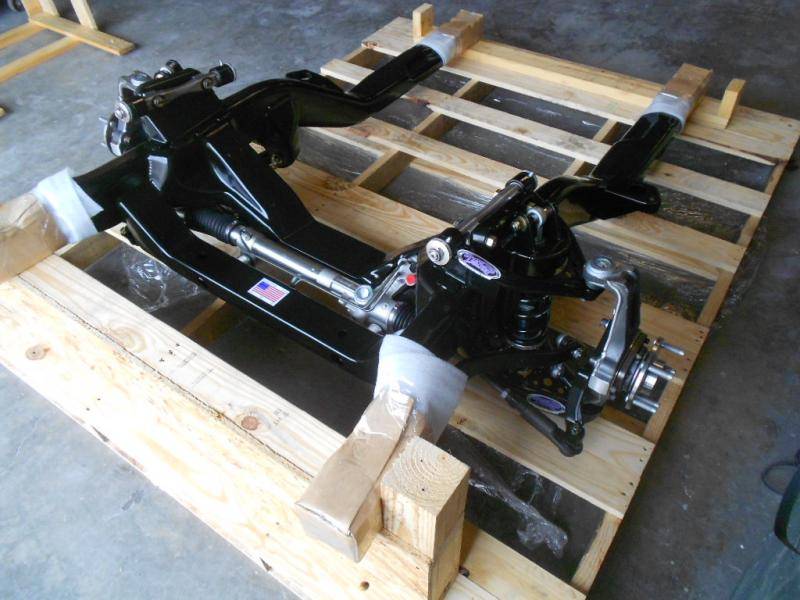

      Last Friday a semi delivered this DSE powdercoated assembled hyrdoformed subframe with rack and pinion steering and coilover shocks.

      We bought a 78 in 86 in Florida. 10 years later the body was still perfect but the rear frame rails were shot. You could poke your finger through above the axle.

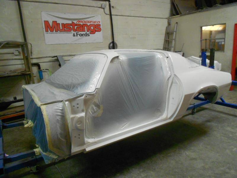

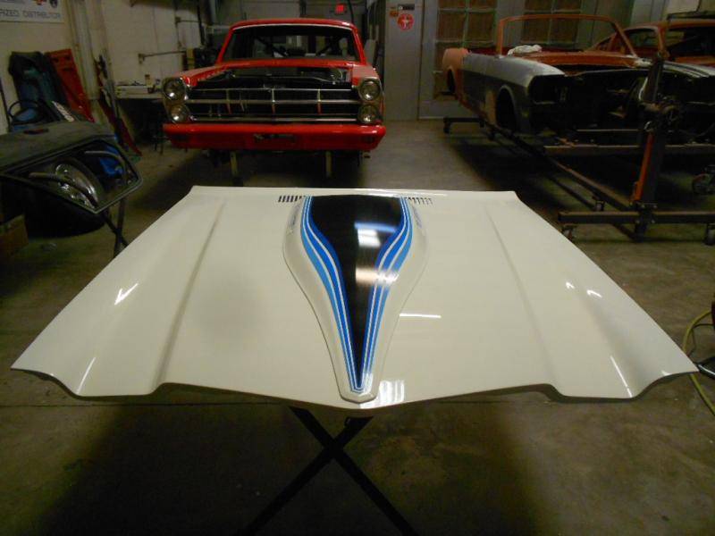

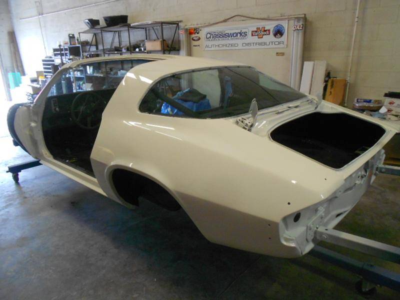

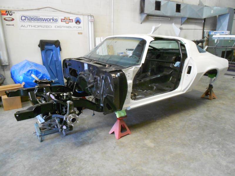

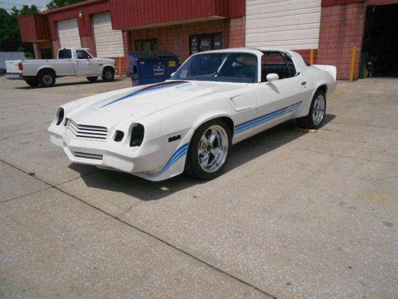

      Painted the original color
      Brian wet sanded and buffed the body

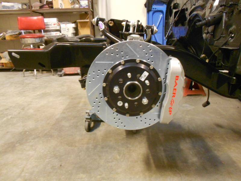

      Unpacking the DSE front subframe assembly
      Subfame installed
      14" 6 piston Baer brakes

      Nice T-top repair.

      The subframe connectors were done before we found out the subframe had rust. This started out he just wanted a quick paint job and a little suspension and brake upgrade. As you can see things changed.
      He has those wheels but they don't clear the brakes need 18".

      Hate that you had to find all of that hidden rust though. The pics of the steering and sway bar bolts made me shudder...

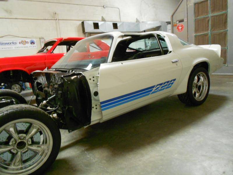

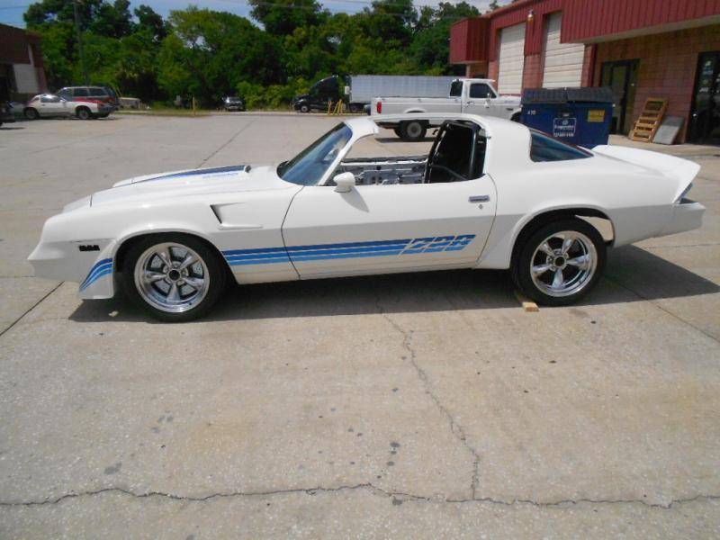

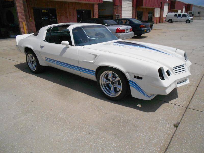

      We finished wet sanding and buffing now fitting the Z28 decals
      Fenders, hood and nose lined up

      We are finished except for installing the windshield and back glass molding that the owner has. He will finish putting it together. I'm not sure what he is going to do with the rear suspension.

      Nice result. I hope the owner keeps us updated.
