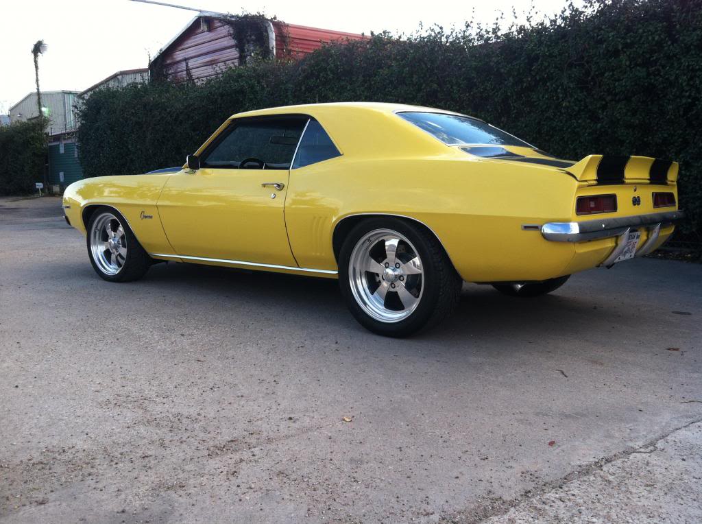

      Here is the car that we started with

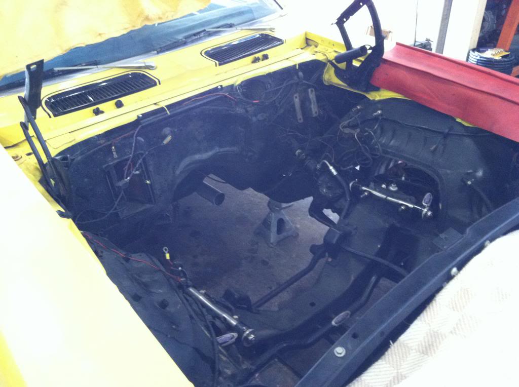

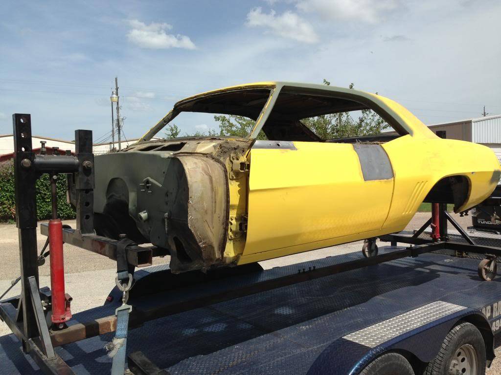

      The tear down begins

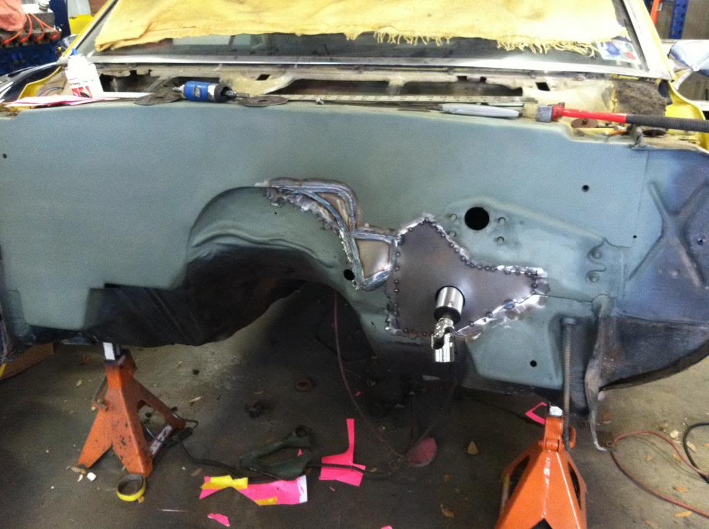

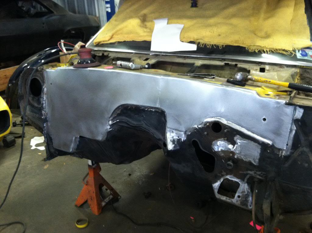

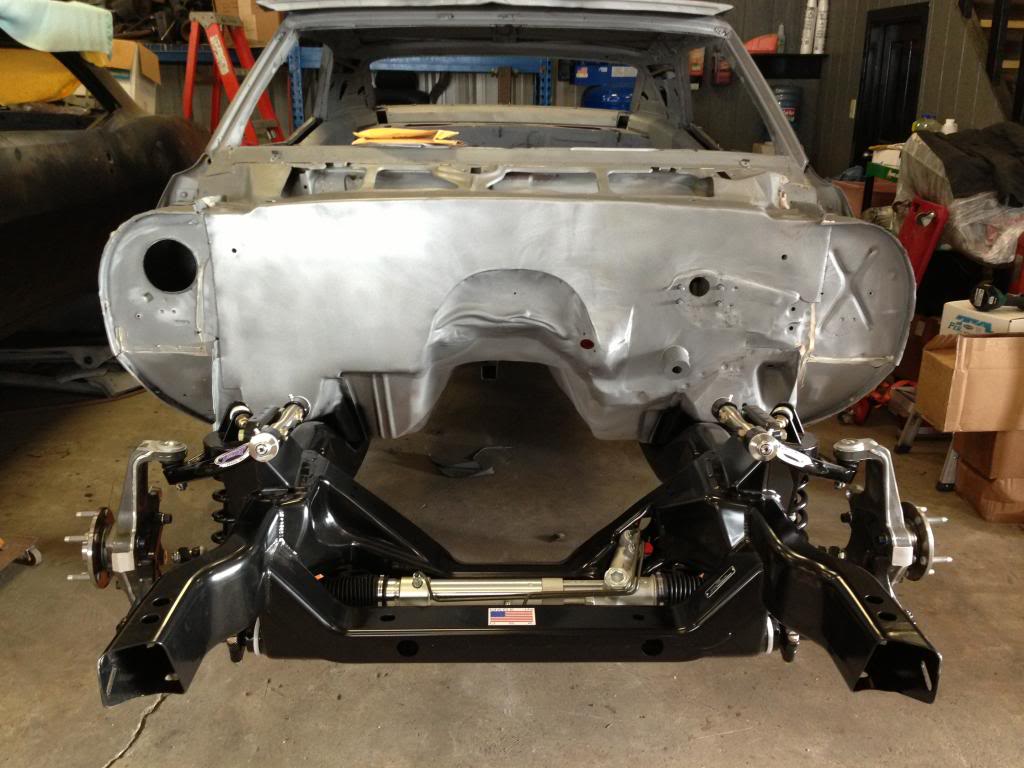

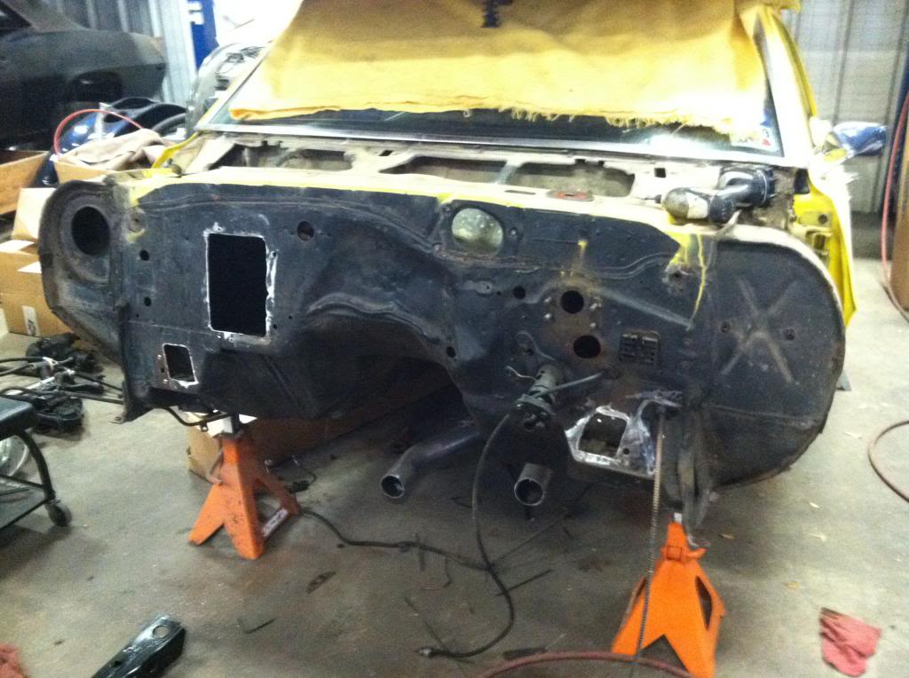

      We started to smooth out the firewall and then ended up modifying the column area too

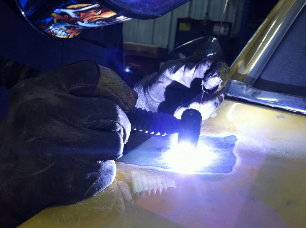

      Then we welded up a few items like side markers and the antenna hole

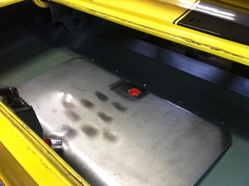

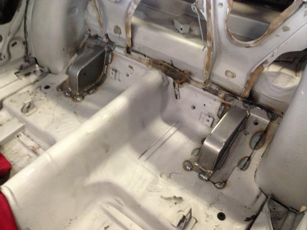

      Mini Tubs and trunk floor/fuel tank

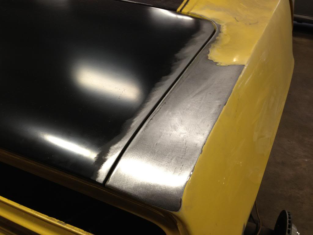

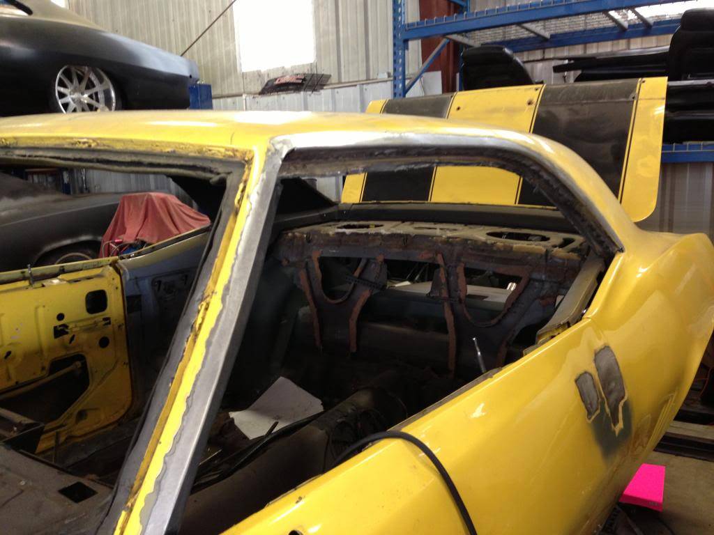

      Shaved the Drip rails

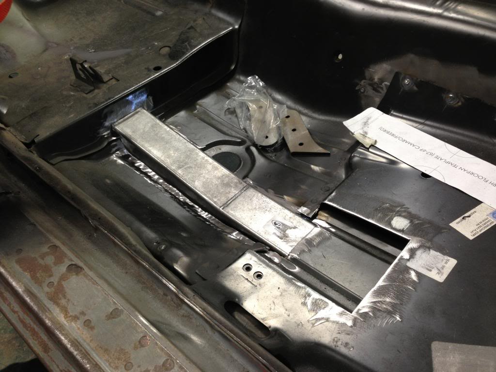

      DSE Frame connectors going in

      The new DSE Subframe arrived while the car was out getting blasted

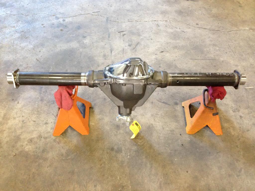

      Moser 12 Bolt rear end was ready to be welded up too

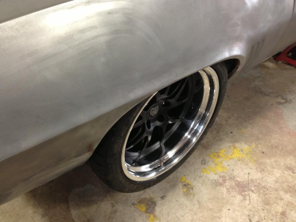

      Now on to the good stuff

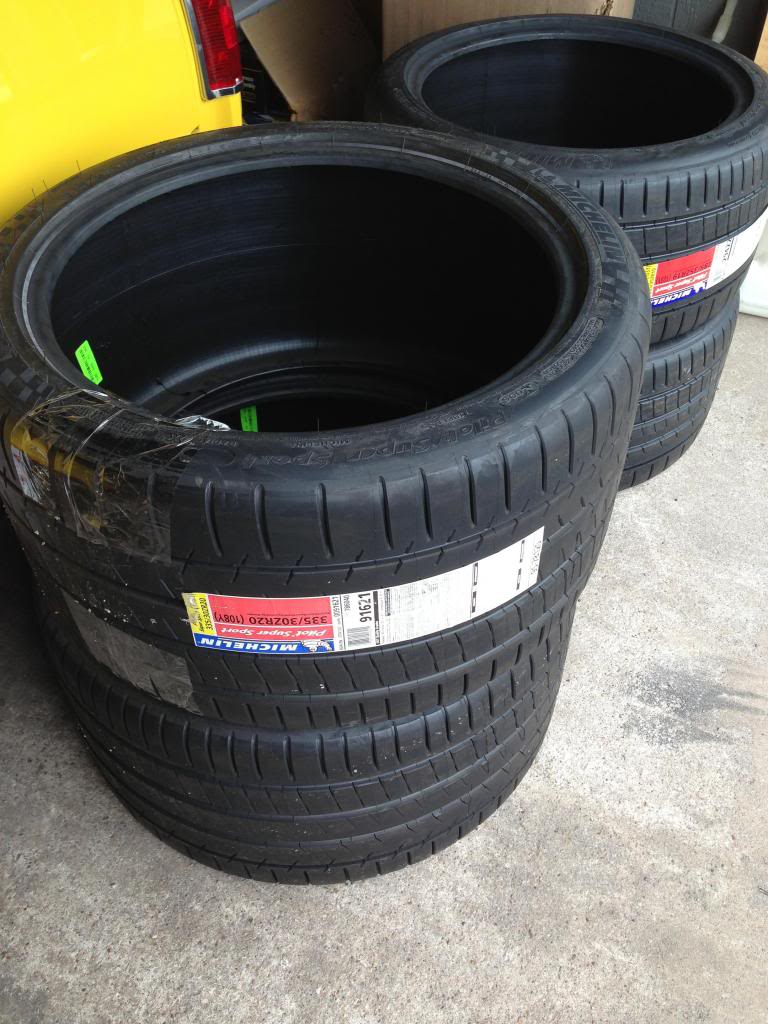

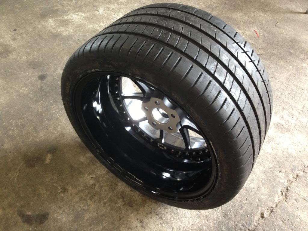

      Tires arrived so we could use the Wheel Works tool to get the correct backspace
      335/30/20 and 285/35/19

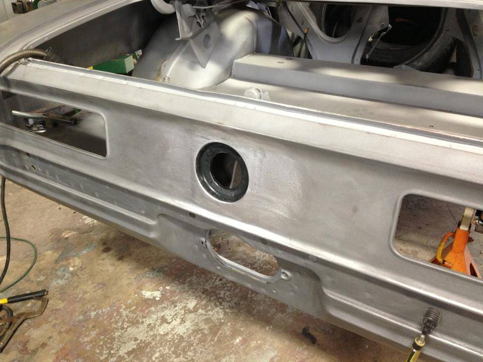

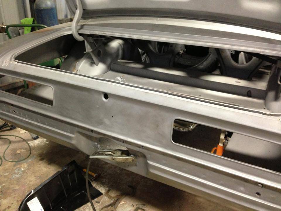

      Started to mod the tail pan

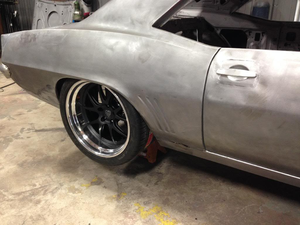

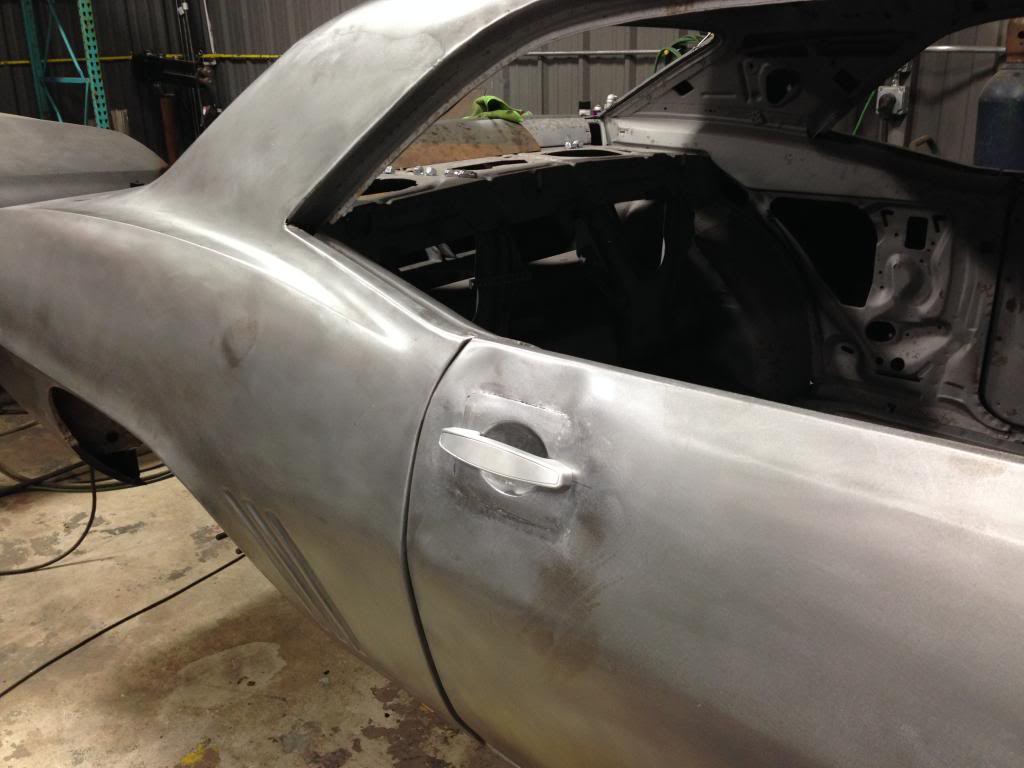

      Goolsby Handles installed
      and a better shot of the drip rails

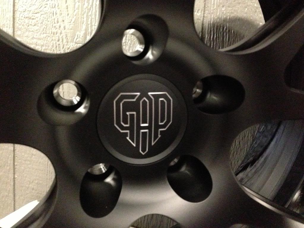

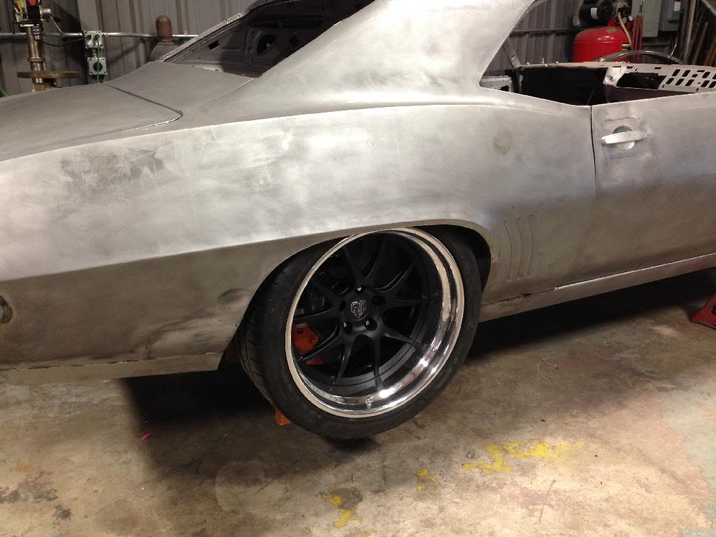

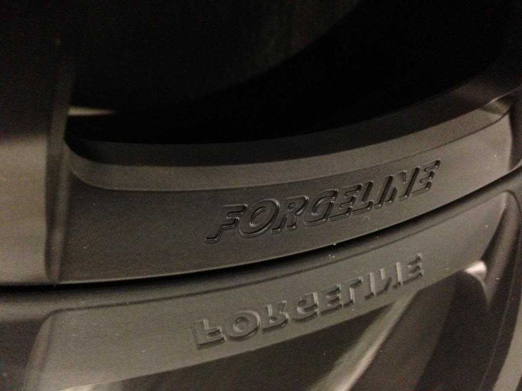

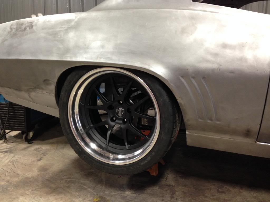

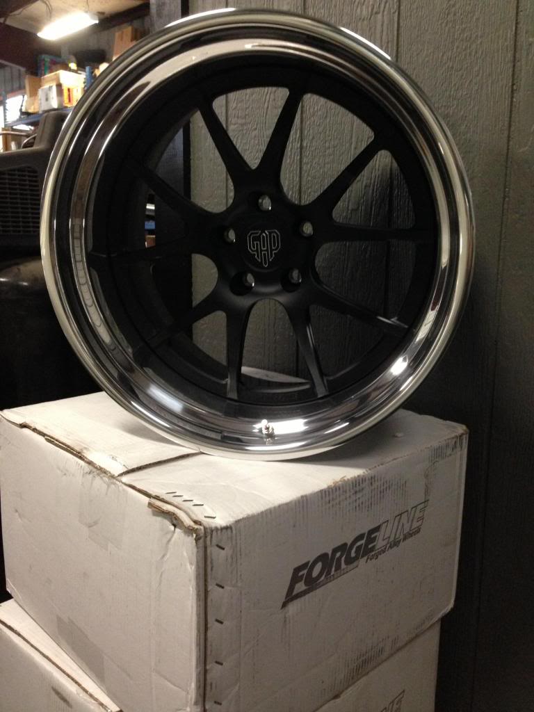

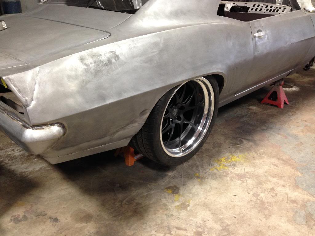

      Forgeline GA3 wheels 20x12 and 19x10 with a custom center cap

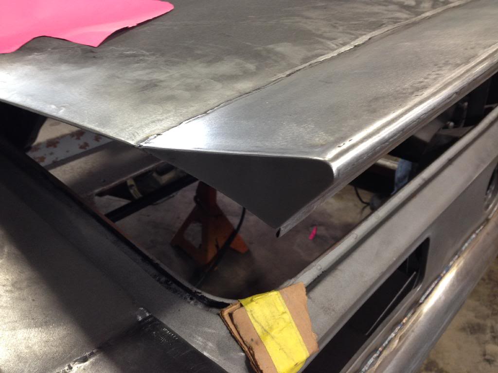

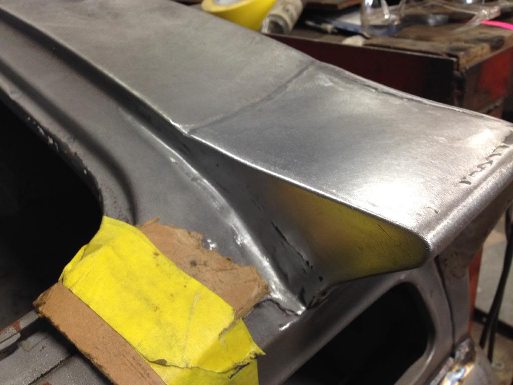

      Started working on the rear spoiler. Still have a lot more work to do on it
      Aug 2009
      Houston TX
      111
      Spoiler is pretty much finished up. Cut it open, now we need to cap the ends

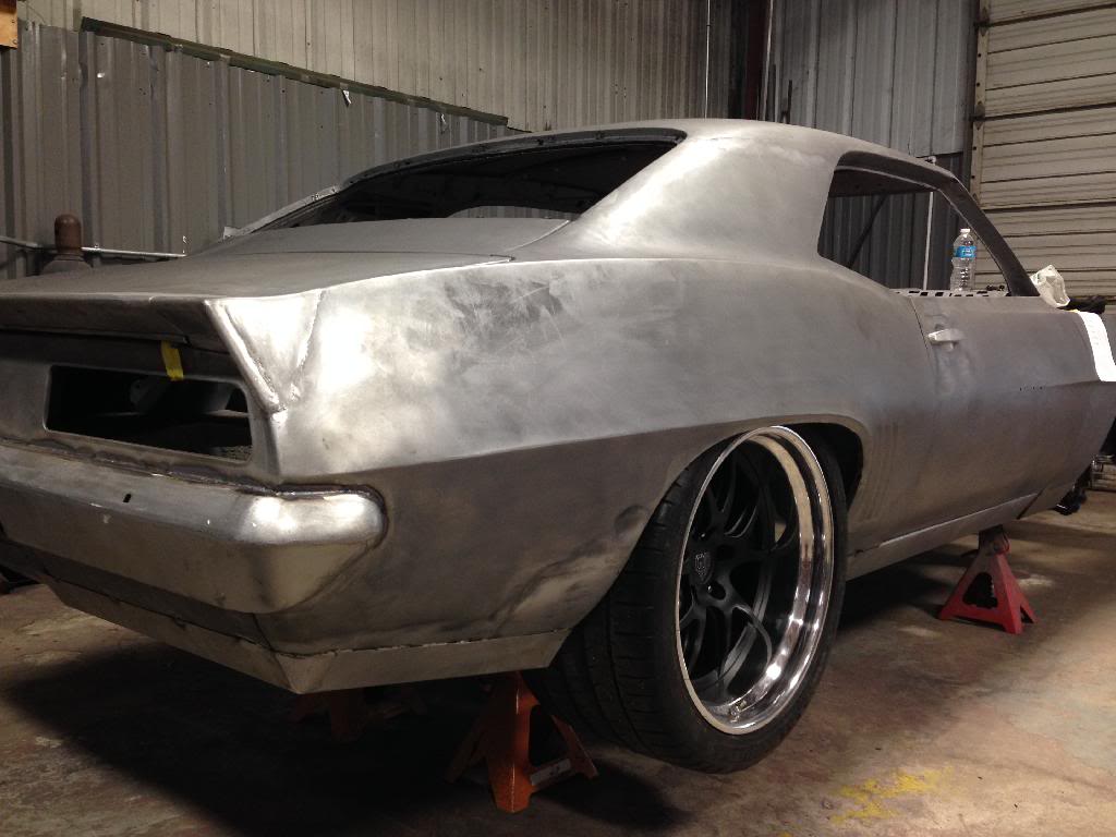

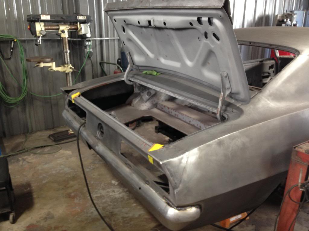

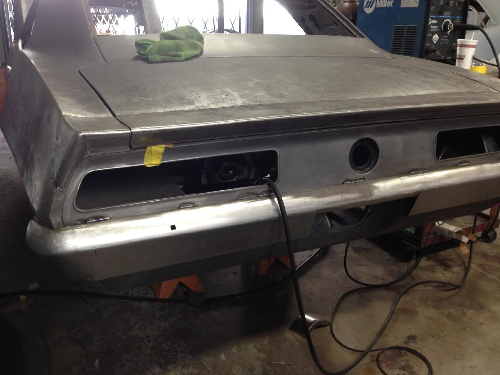

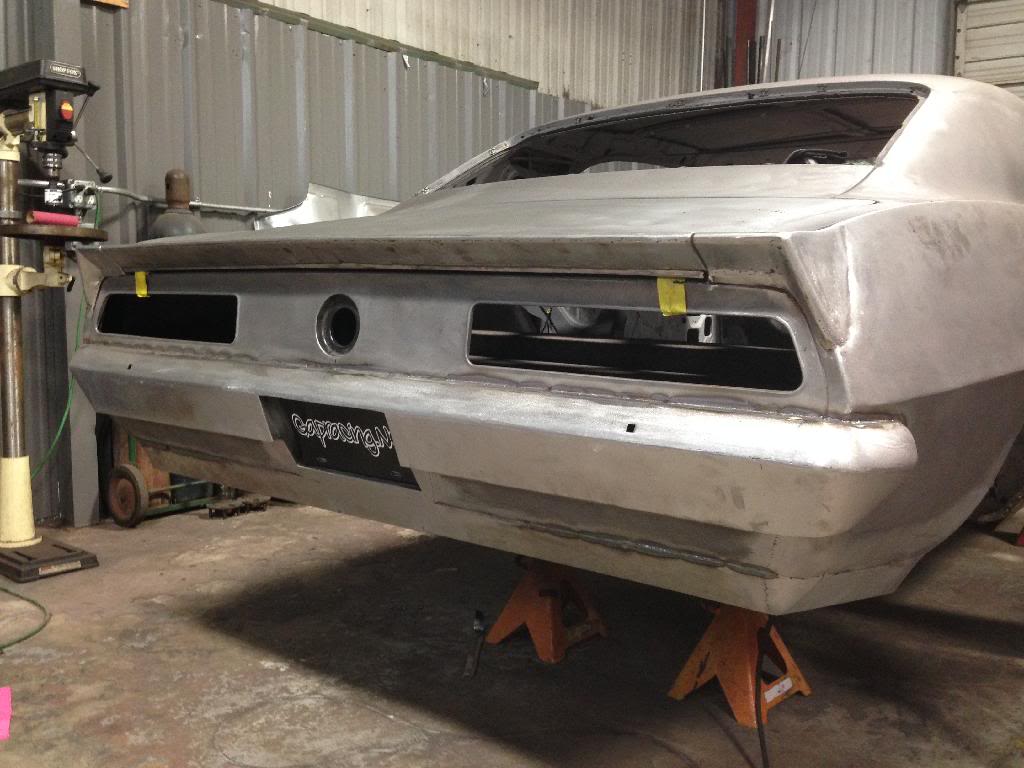

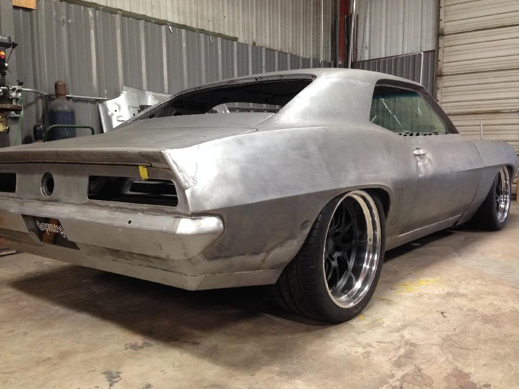

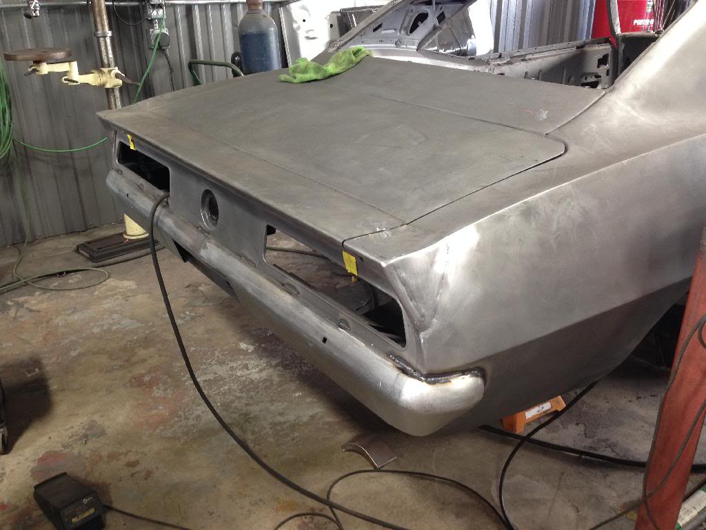

      Also did more work on the rear bumper. We cut it down and made it tight to the body. Also added a little length to it to make it fit the look we were going after. Still need to build the license plate area and raise it up so we have room for the center exit exhaust. The bumper is going to be molded into the car.

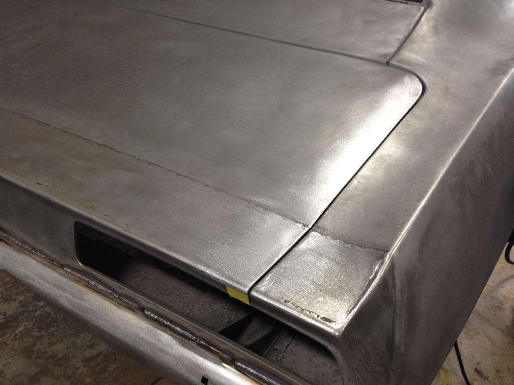

      We tightened up the trunk gaps and capped the ends of the spoiler. We can check that off the to do list

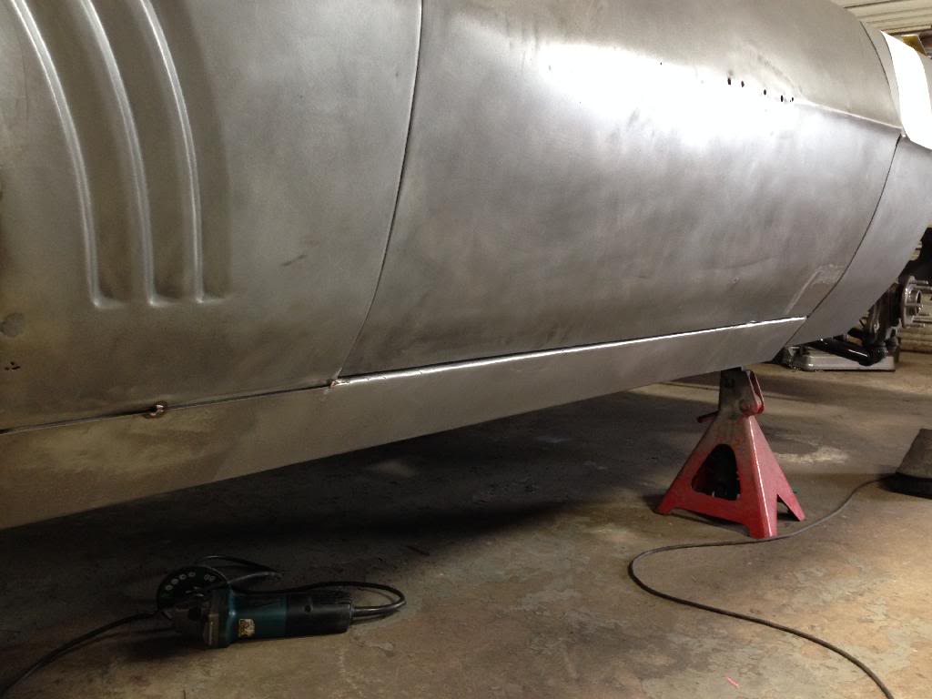

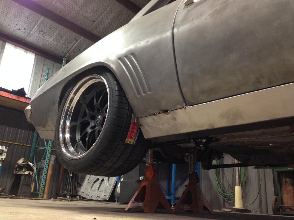

      Started on the extended rockers
      Aug 2009
      Houston TX
      111
      Here are more photos of the rocker progress. Still have a lot of finishing work to do
      Still need to finish shaping the rear transition too.

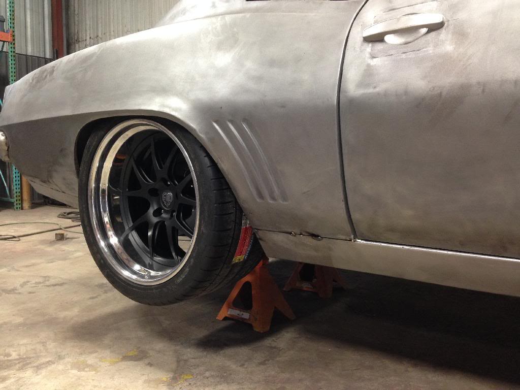

      Got the rocker welded up and re-shaped the rear section a bit

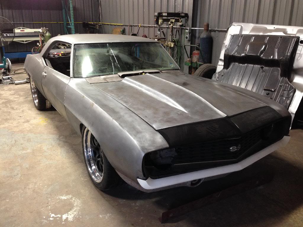

      Got it on the ground. Made some coil over adjustments. Still have a lot of metal fab to do. Next we will work on the twin turbo setup, the engine bay area, and start on the roll cage.
      Also finished up the license plate recess on the rear bumper
