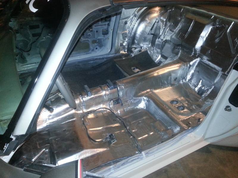

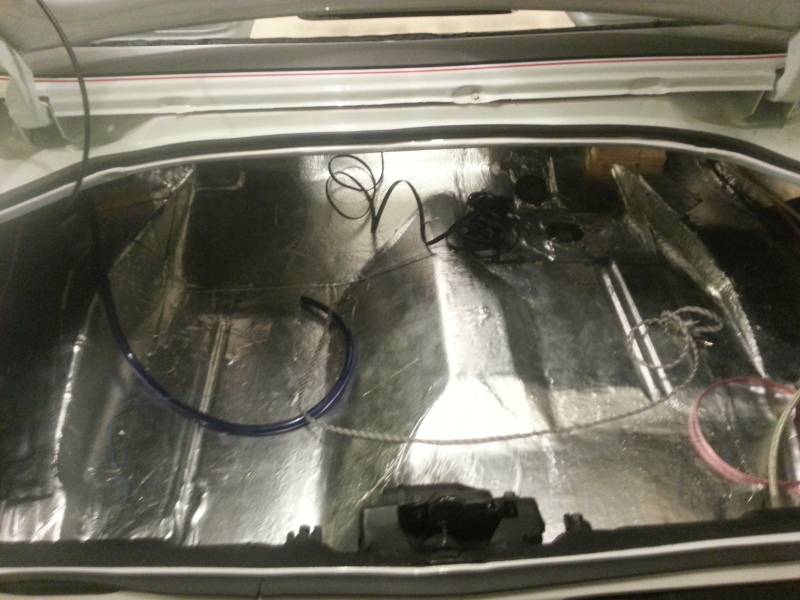

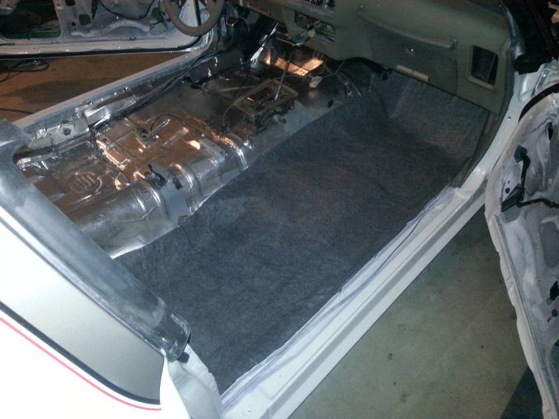

      the obvious first, sound deadener and thick pad throughout, even in trunk.

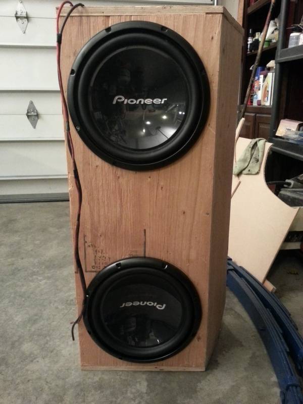

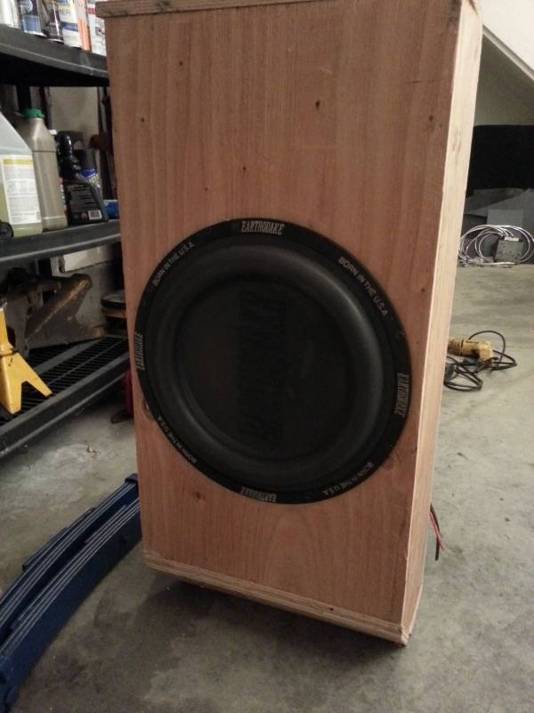

      sub box. the 12's are firing down, and the passive 15" is firing up. i did cut some of the rear deck (had to! ugh) for it to fire through.

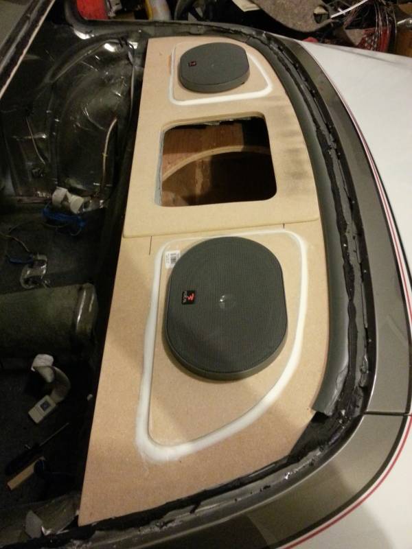

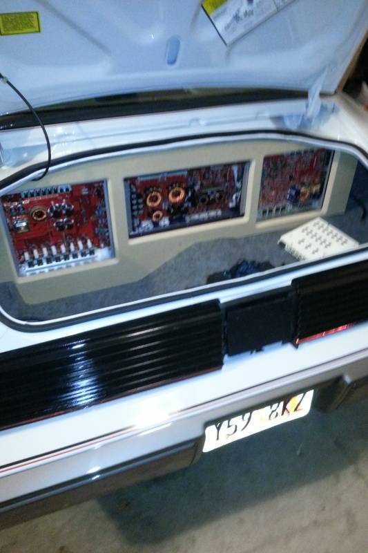

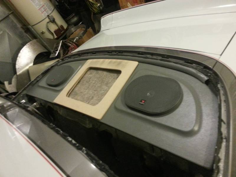

      rear deck-
      wrapped and grills painted to match interior color. still need to wrap center piece in grill cloth

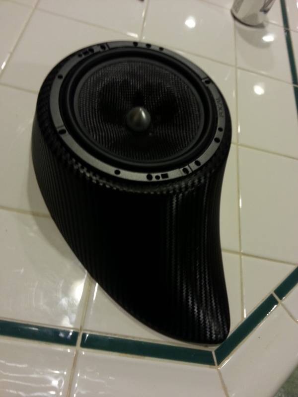

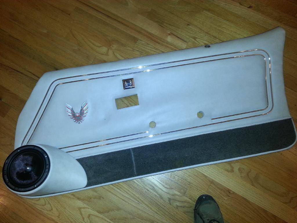

      door pod design with cf wrap on it.
      i really did not like the black on the door pod at all. i was able to contact pui that makes the repro door panels and seat covers and buy more of the matching vinyl. recovered them in the same material. there is a bit more work to do to have them blend good with the door panel, but there will only be a few screw holes through the lower part of the carpet holding them on. so they can be removed and brush the carpet a little and boom, the door panel will be stock again! it is not nearly as blended as i would like, but placement is good and was not going to cut up brand new door panels.

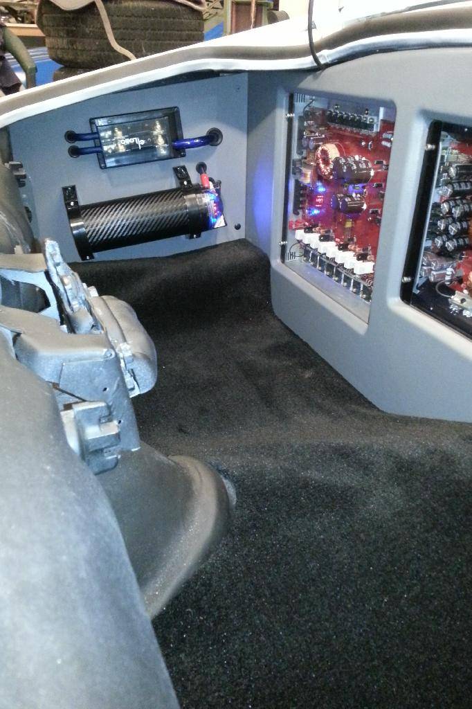

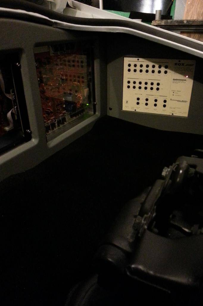

      here is the rear amp rack. acrylic bottoms on amps. still need to wrap the pieces, they will be in the grey material. eqx is mounted in right side, cap and fuses are mounted on left.

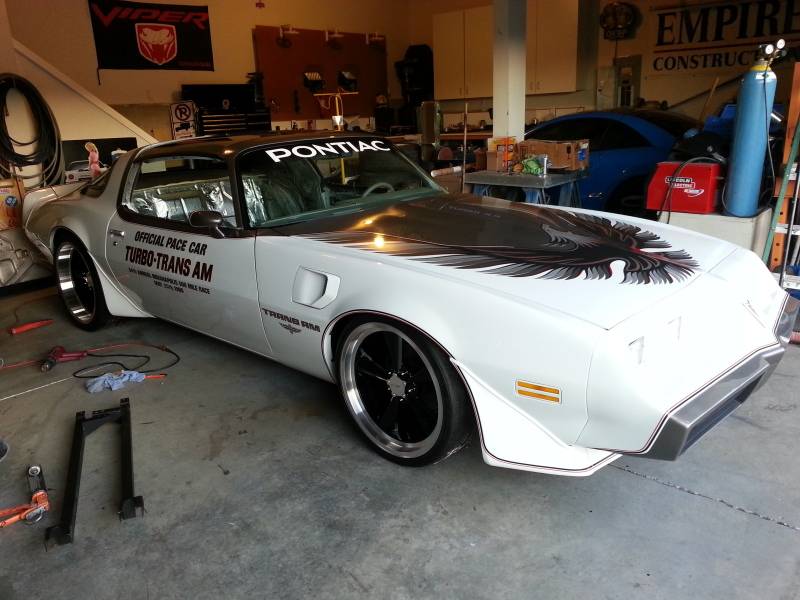

      will snap off a few more pics as work progresses. hoping to be wrapped up by early next week. here is a pic of the outside of car.

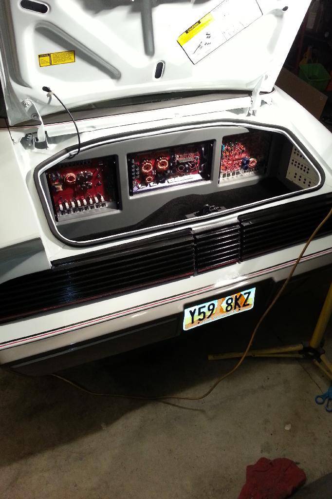

      finally able to close the trunk and move onto the rest of the interior. luckily i have zero background noise or ignition noise! still missing the front 6.5" right now, but sounds incredible already. can't wait to start tuning and get time alignment set.

      looks great. i feel like that thing could time travel by looking at the trunk. I like how you have the opening for the sub on the rear deck.
