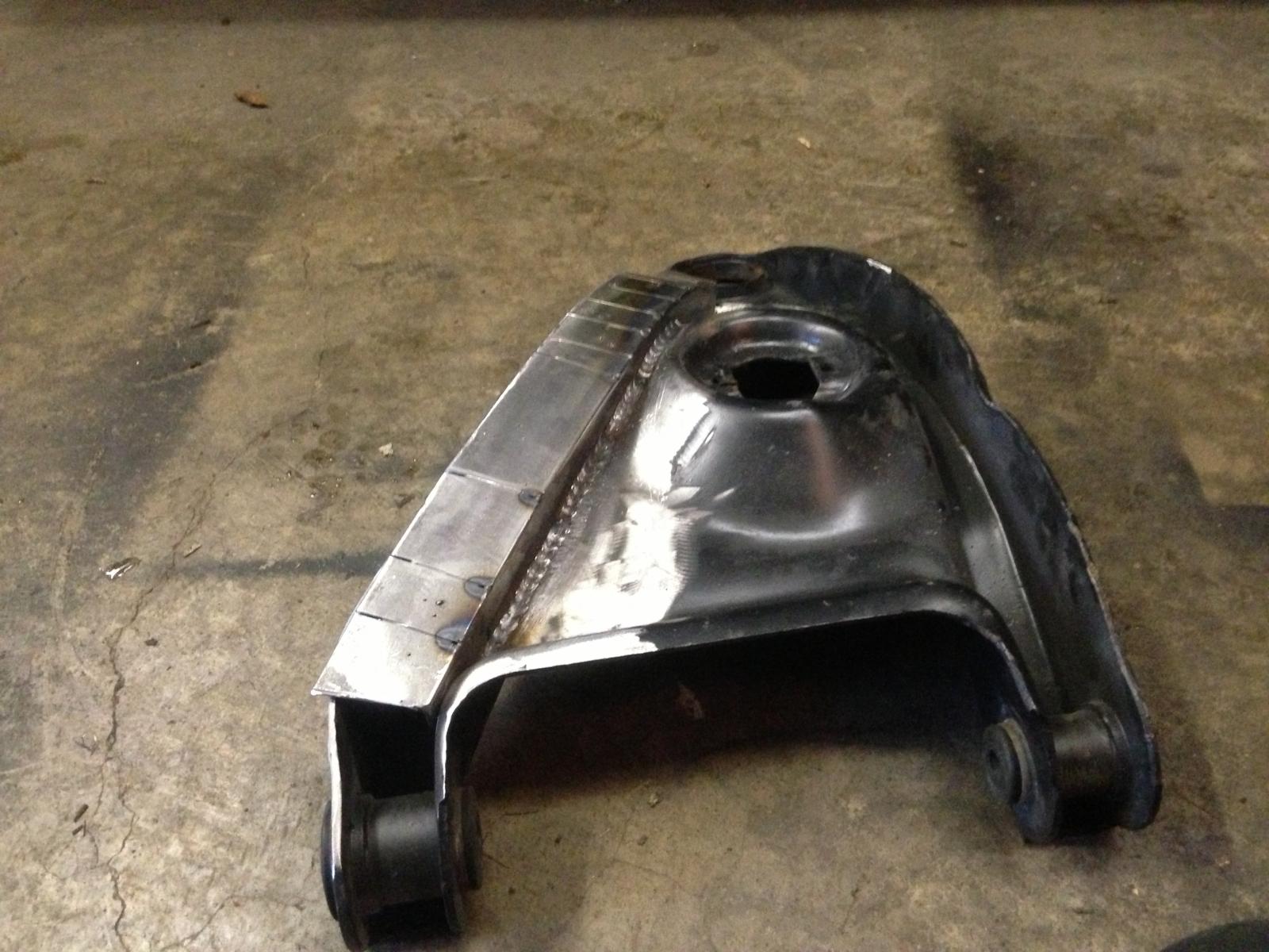

      I remember a while back seeing a post on reinforcing the stock lower control arms, but when it came time to actually do it I had a hard time finding anything so I decided I would share how I went about it in hopes that it might help some of those guys (like me) on a tight budget and looking to save a little $$ by reinforcing the stock lowers.
      If I remember right, the method I saw was to completely cover the bottom of the control arm boxing it in. After looking at the control arm stamping I decided to go a different route since one side of the arm is raised a little higher than the other so covering it with one piece didn't seem like the best method to me.

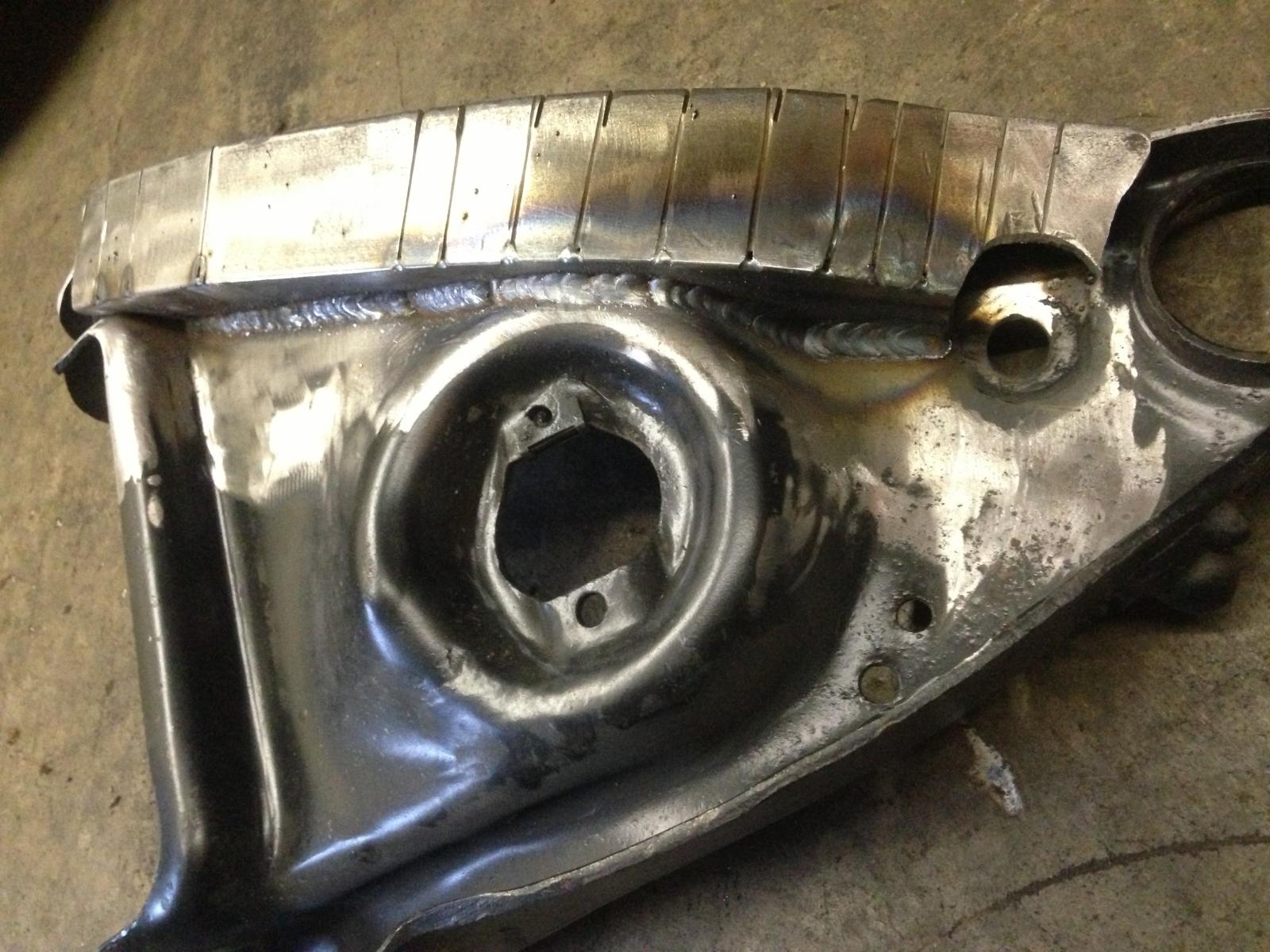

      I used 1/8" angle steel and followed the indent on each side to create a square tube frame. I made a number of cuts down the side of the angle and scored the top of the piece to form it. Before welding the pieces in I welded the cuts up and smoothed them out. I am not the greatest welder, but I'm learning.
      (I straighten the dent out on the other side.)

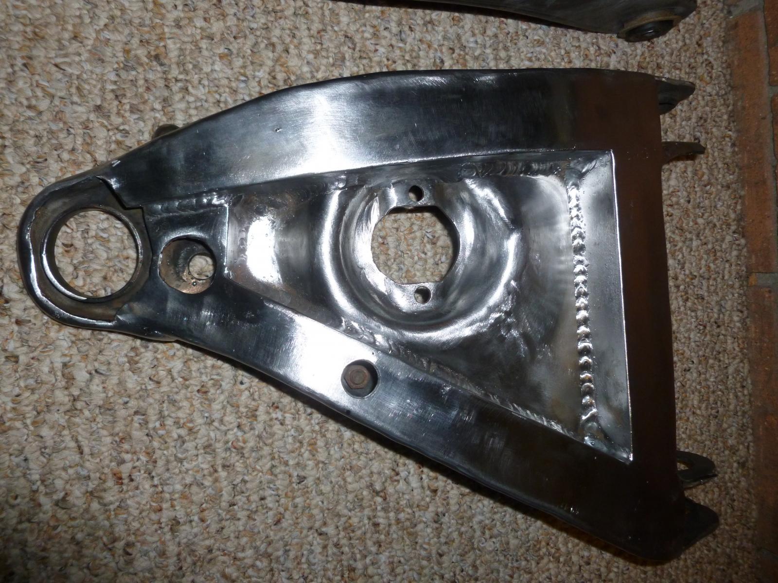

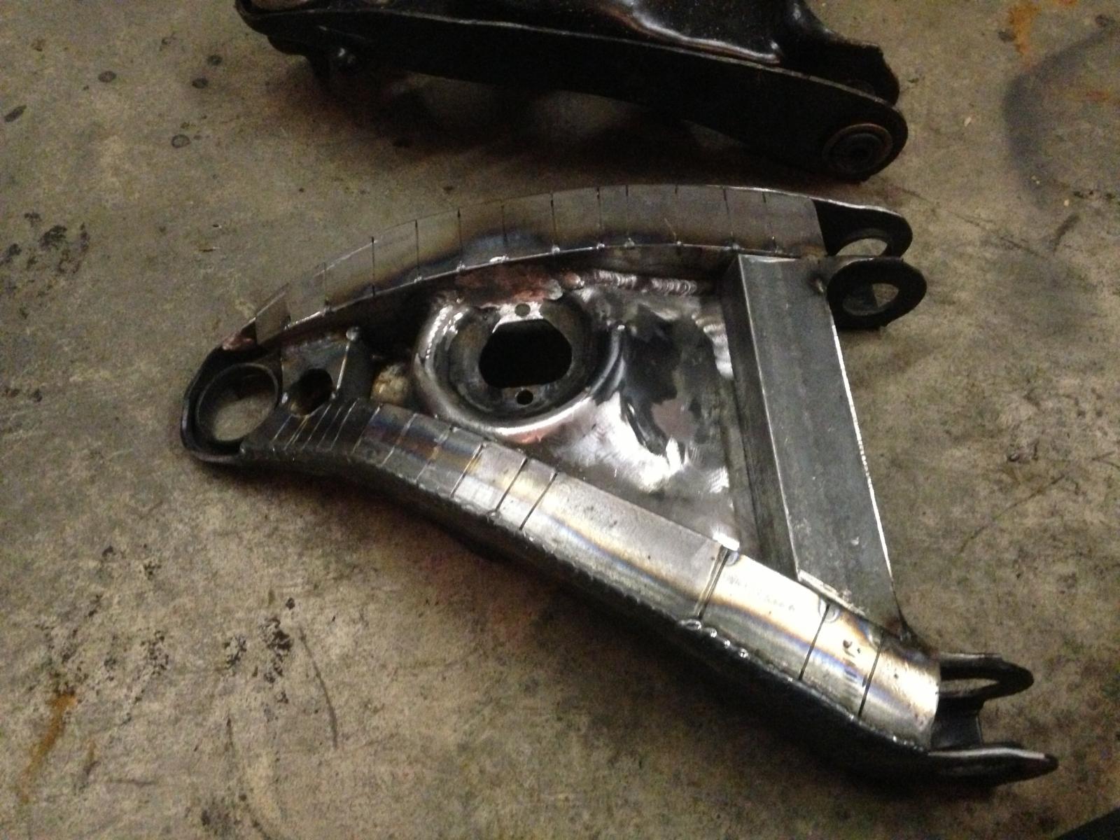

      Same thing was done on other side. Also created a piece for the front and back to complete the triangular frame.

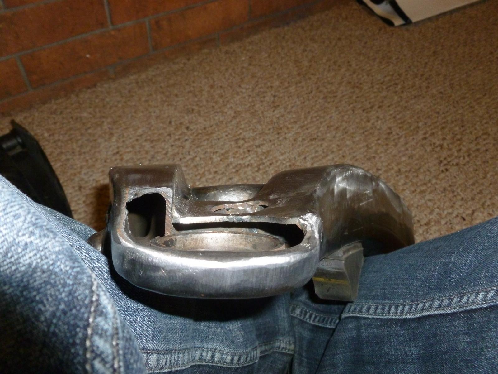

      I also wrapped a strip of 1/8 steel around the ball joint pocket then welded and smoothed of course.

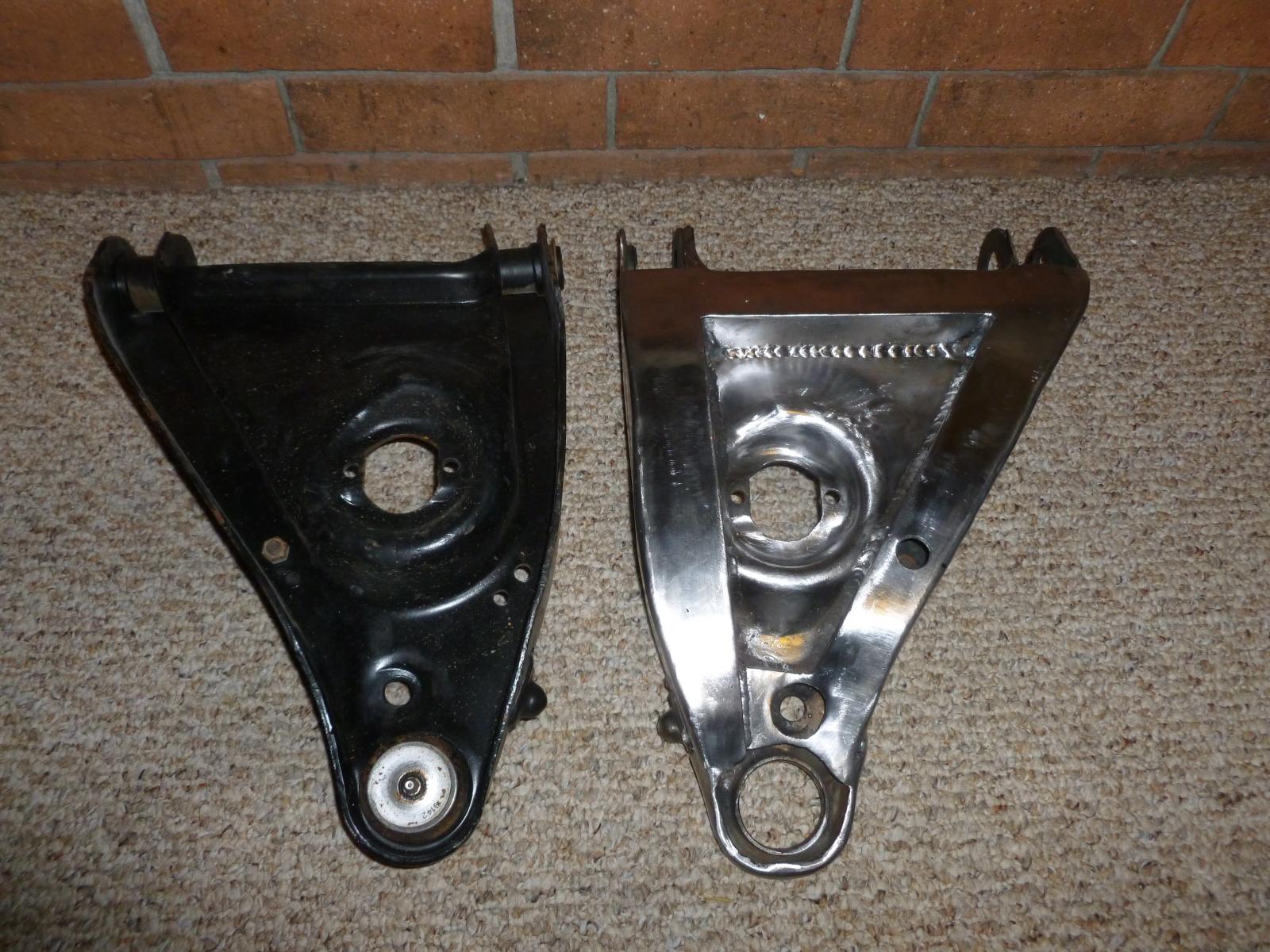

      And the finished product vs Stock.....
